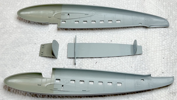

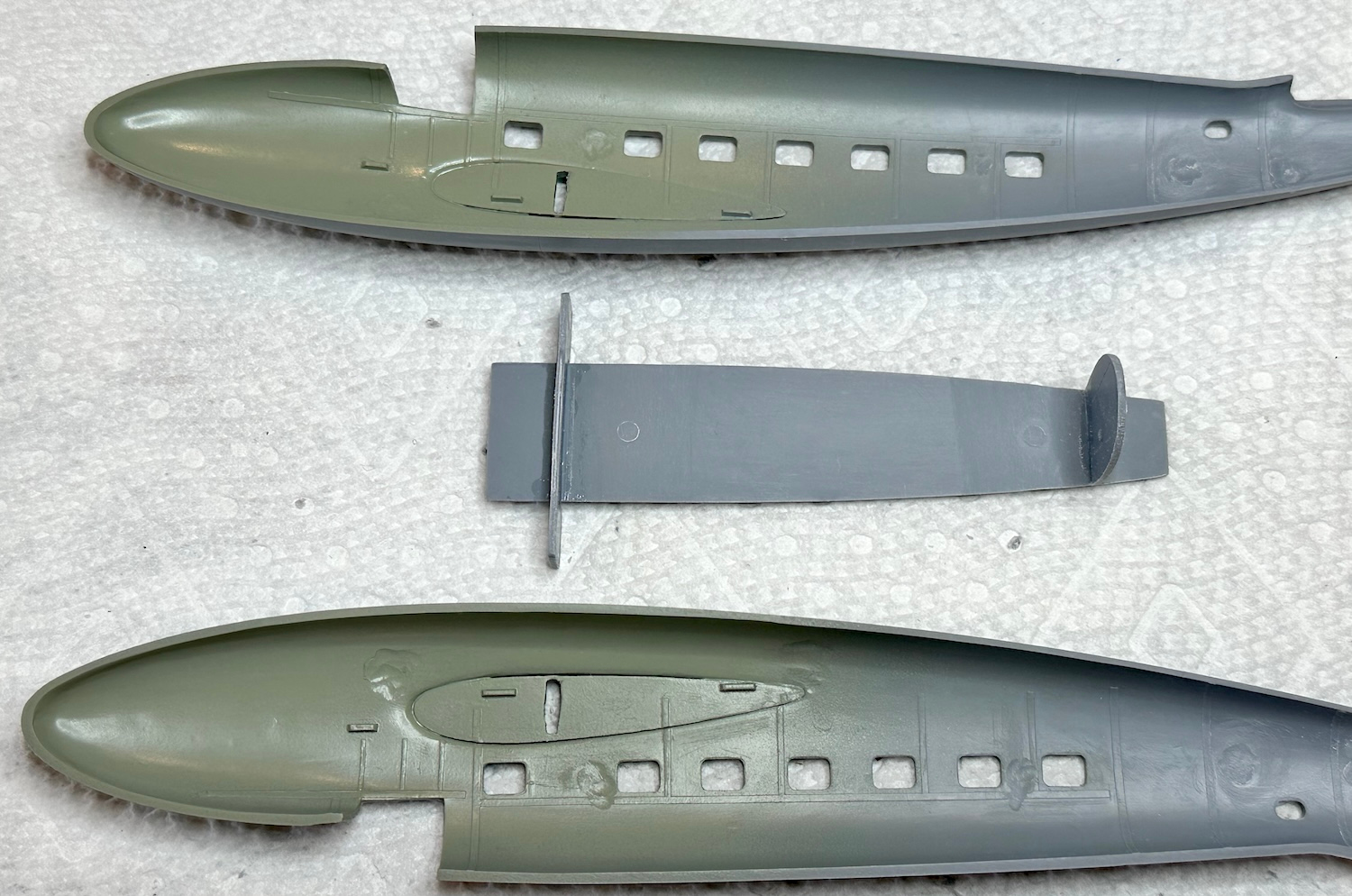

When the makers made the C-60 kit they gave the builder some blessings and at least one curse. First, the correct nose is already molded to the fuselage halves, second, the smaller airliner door with the arched top is engraved into the plastic.

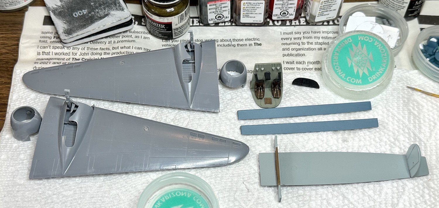

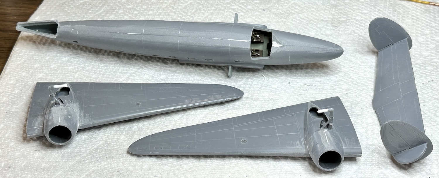

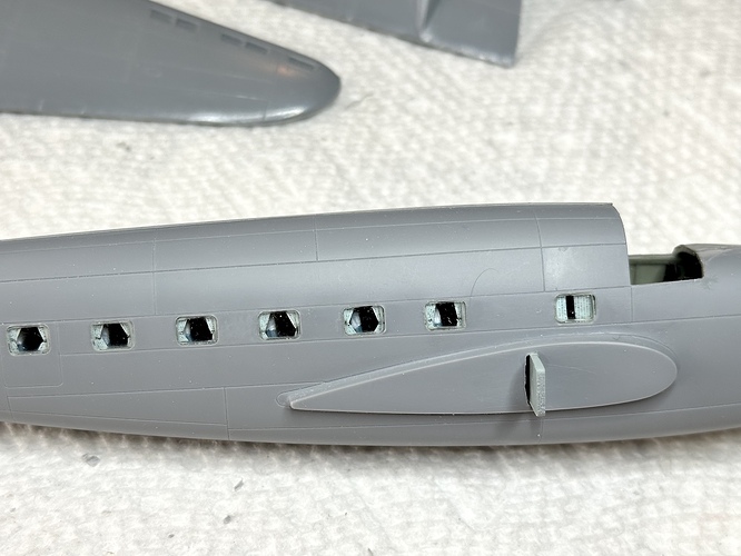

On the other hand, the small wing spar used in the Hudson kit to help locate & strengthen the wings was omitted! As designed, the joint reverts to the much hated (by me) butt joint.
Happily, the Hudson wing spar with its attendant bulkhead was included with the C-60 kit. I decided to reengineer the C-60 with the Hudson spar minus the bulkhead. This project was made difficult by the poor locating of the parts, very much in the “short run” spirit. I could find no sure datum to measure against outside of the leading edge of the wing itself. I mic’ed the location of the spar on the Hudson kit and transferred it to the Loadstar. This allowed the other interior bits to be nailed down and construction started.
The C-60 kit adds an airfoil shaped filler piece to the interior which not only fills in the space but acts as a brace for the wing spar in my conversion. The Hudson bulkhead was cut off.

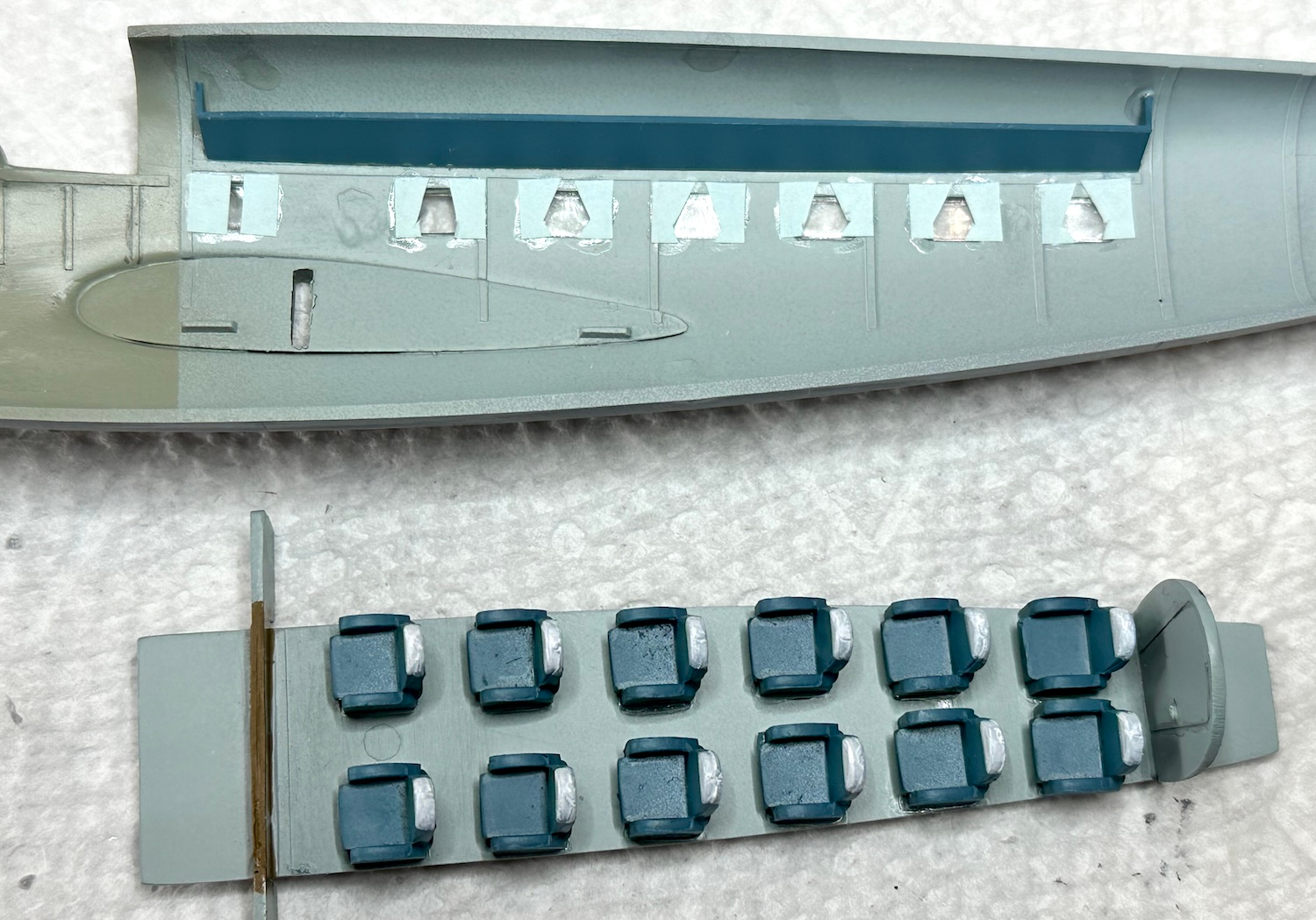

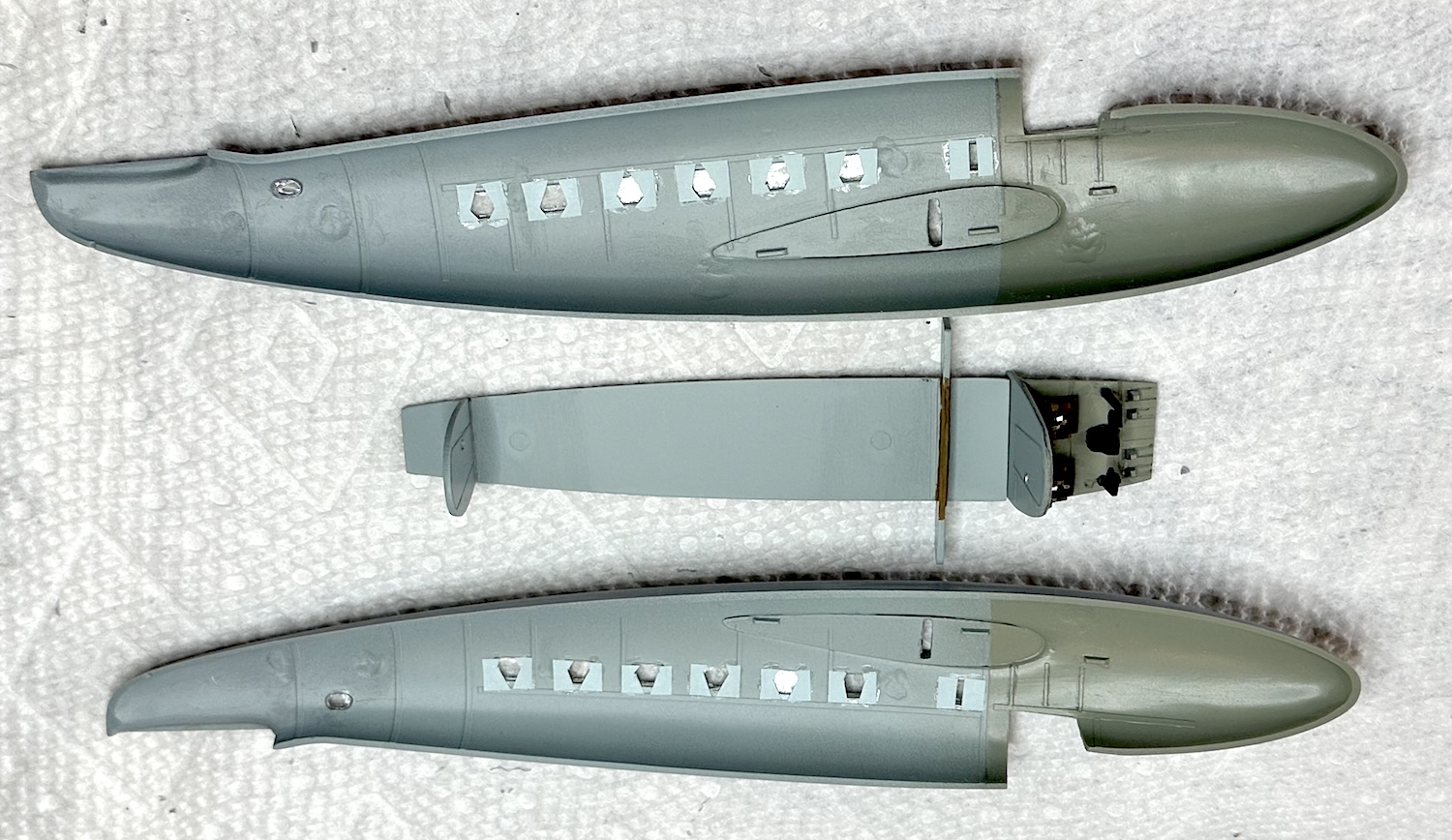

Another blessing of the C-60 kit is the inclusion of 12 passenger seats! With the location of the interior bits settled it was time for some color. Not having any information, I decided on a gray green for the cockpit and a bluish gray for the cabin. The seats & hat rack (included also!) will be a medium blue.
I spent a lot of time with the wing spar & location of interior parts but now hope to make more rapid progress.

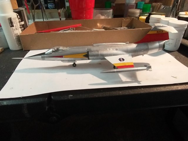

Here’s where the F-104 stands now. Decals are beginning to be applied. There’s some touch-up paint work left. The canopy needs done (it’s only placed in position). We’ll see about weathering.
A note about the pilot: the figure supplied was less than stellar, so I took a pilot figure from a Monogram F-105G Wild Weasel spare. Say what you will about Monogram, but they had some nice figures.
Let’s hope it’s not much longer till she’s complete.

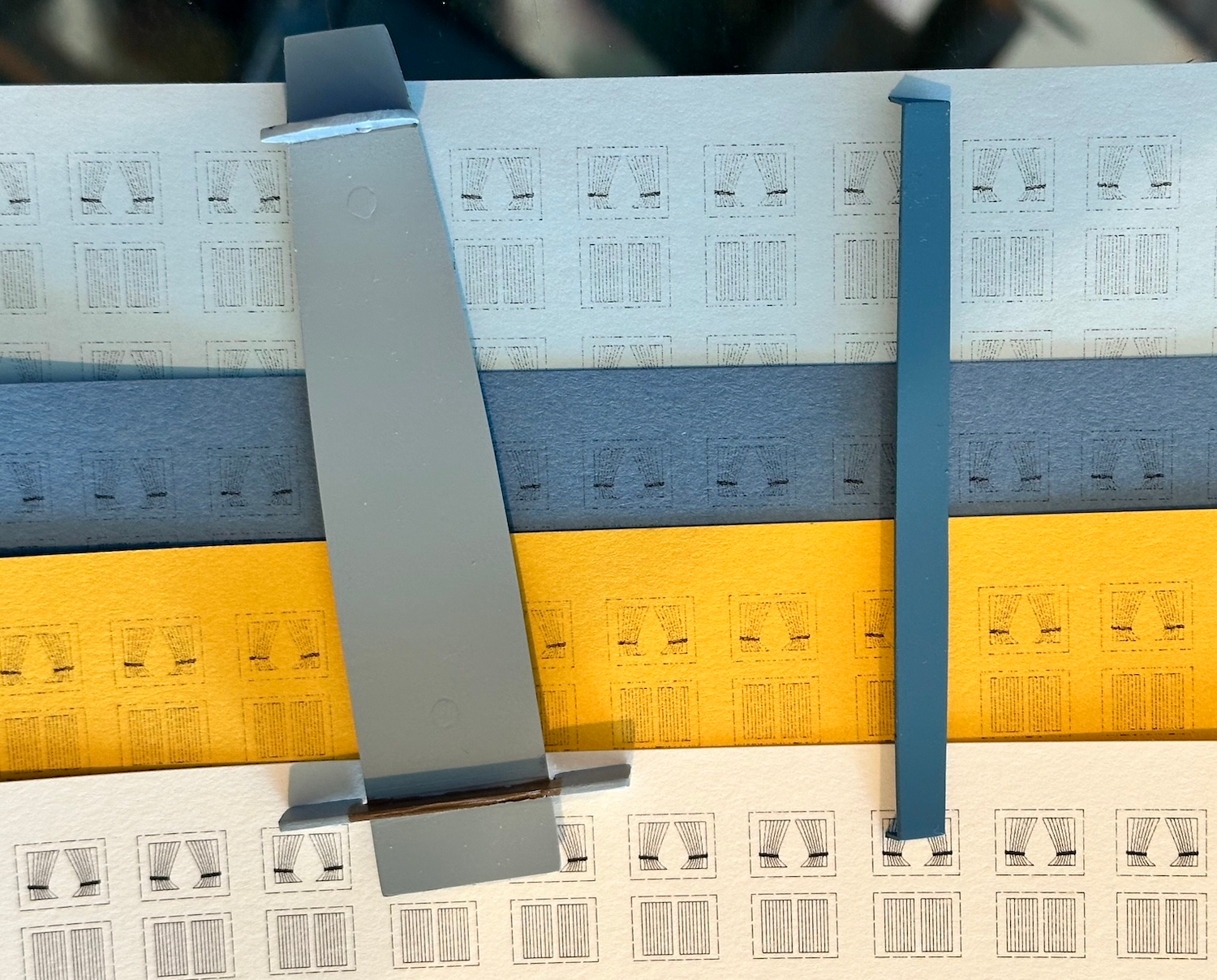

A bit more work done on the L-18 Loadstar since last week. A few months ago I drew up a set of curtains in Illustrator and printed them on sheets of colored paper that seemed likely candidates for airliner curtains to be used on various projects. Looking through the sheets several possibilities were chosen for a look-see with the painted model parts to see what might look good.
I choose the powder blue to blend the pale blueish gray cabin color & the medium blue seats and hat shelf together.
Some of the parts together.
Curtains installed with School Glue.

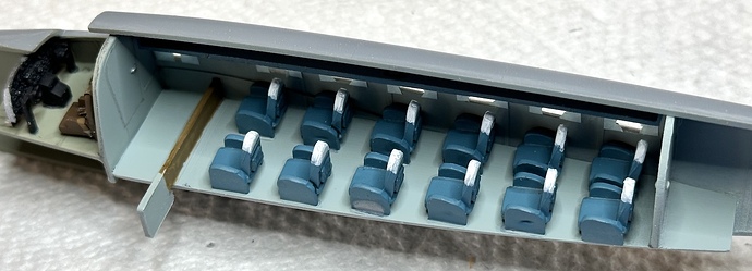

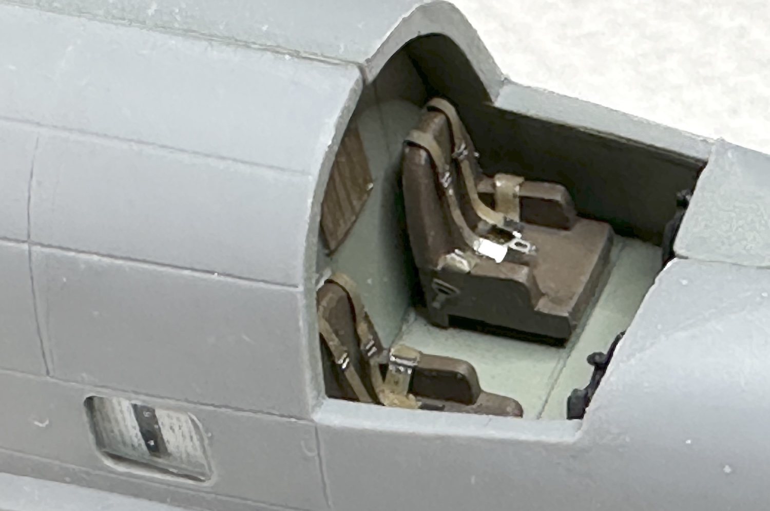

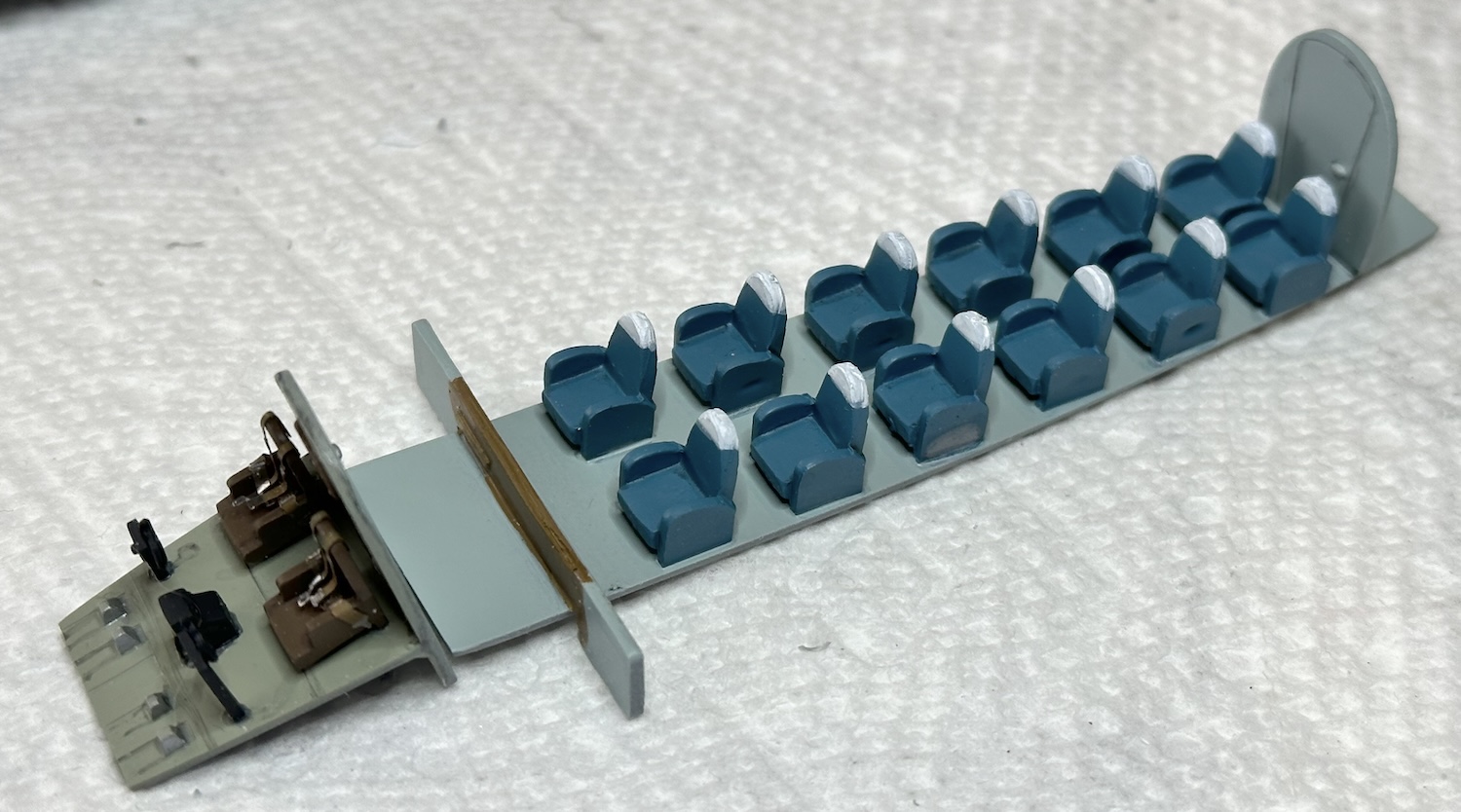

There were no locators (of course) for the seats so the floor was mounted to the fuselage half with BluTac and the location determined by eye. The seats are out of scale too wide. There is no way for anyone to squeeze between those rear seats! Once installed, that lack of clearance will not be seen with only the photos as a reminder.
Flight deck and cabin interior ready to install.
Note the wing spar carries right through the cabin floor! I read that the Boeing 247 had this spar upholstered in leather and thought that might be appropriate here. The passengers and flight crew had to clamber over that spar to reach the front two seats or the flight deck. There were two seats in front of that spar that were not supplied in the kit. I wonder why Lockheed didn’t make this design a low wing model?
The flight deck installed, curtains as seen from the outside.

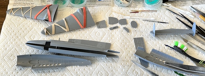

The project as it is now. A lot of time was spent fitting the nacelle bits together. They were close but that last little bit required a lot of time and even then still needed some filler. The wheel axles were ridiculously short so were extended as shown here.

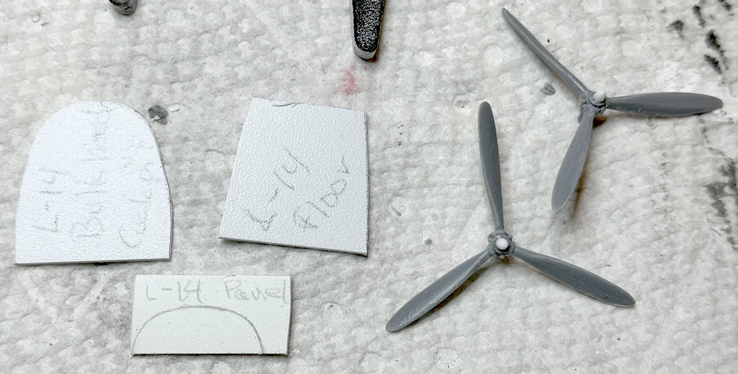

While building this L-18 I traced out some of the parts that would be needed on the upcoming L-14 Super Electra build. The kit had some nice propellers but the dome on the front of these Hydramatic units was clownishly too large. I made new ones out of plastic round stock.

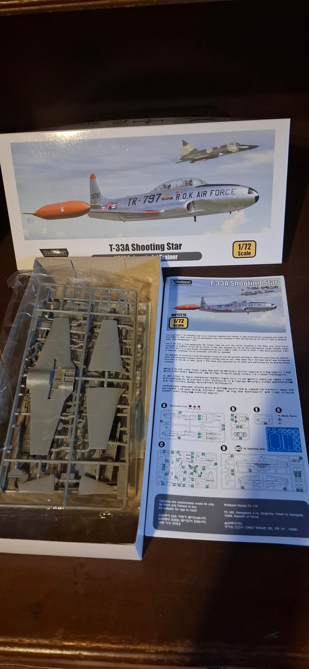

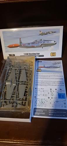

Hello Everybody, for this group built I’m going with a T-33 in the Ecuadorian Air Force colors :ecuador: :ecuador: :ecuador:
Great looking camouflage :+1::+1::+1::+1:
