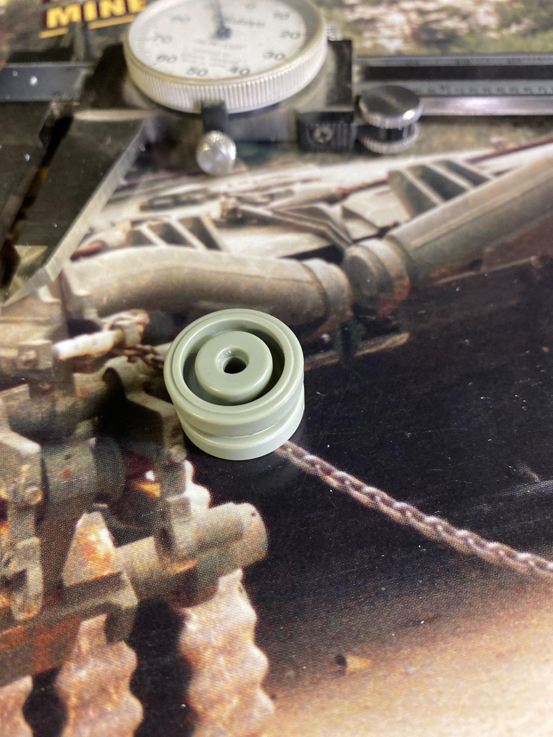

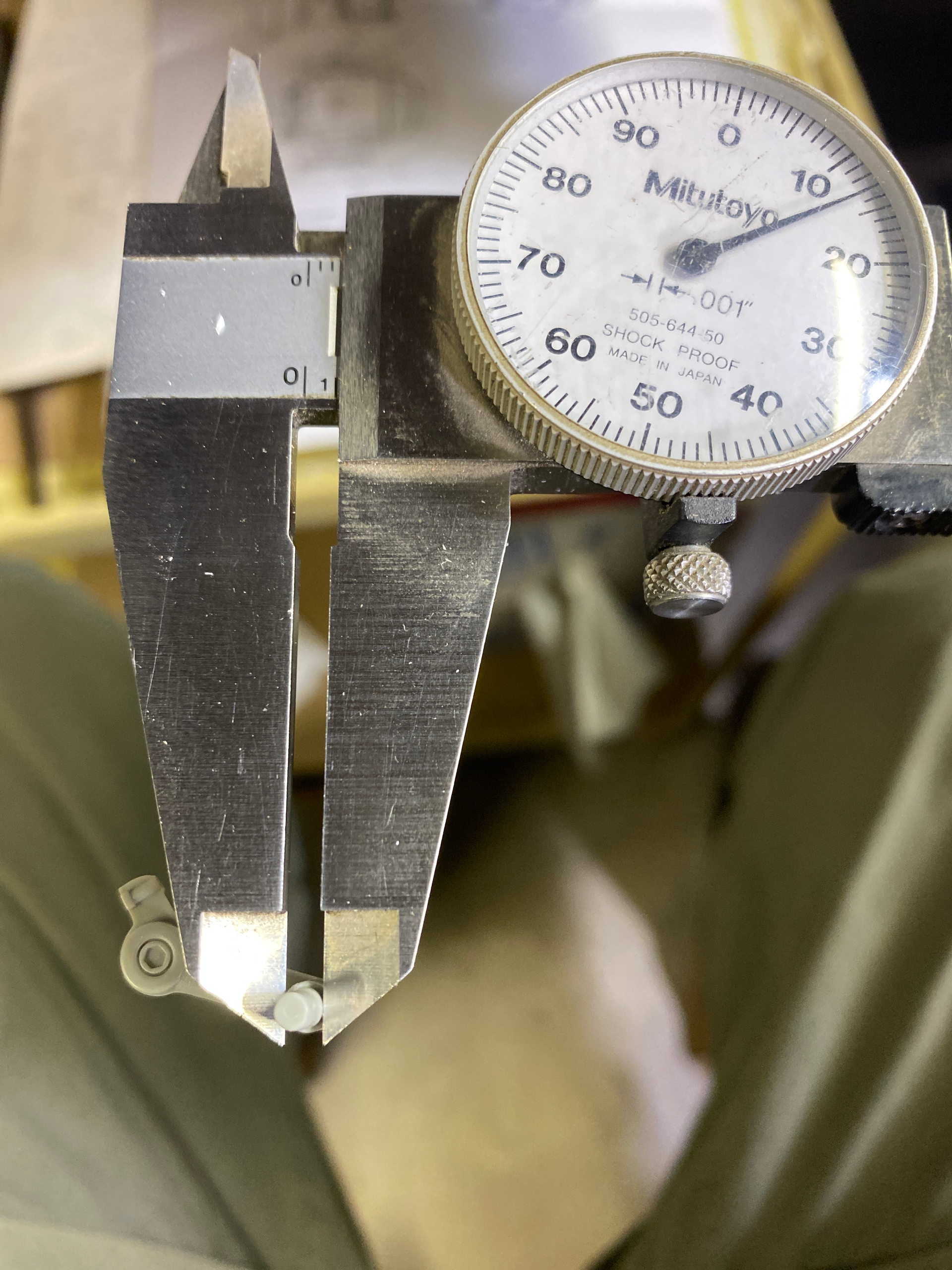

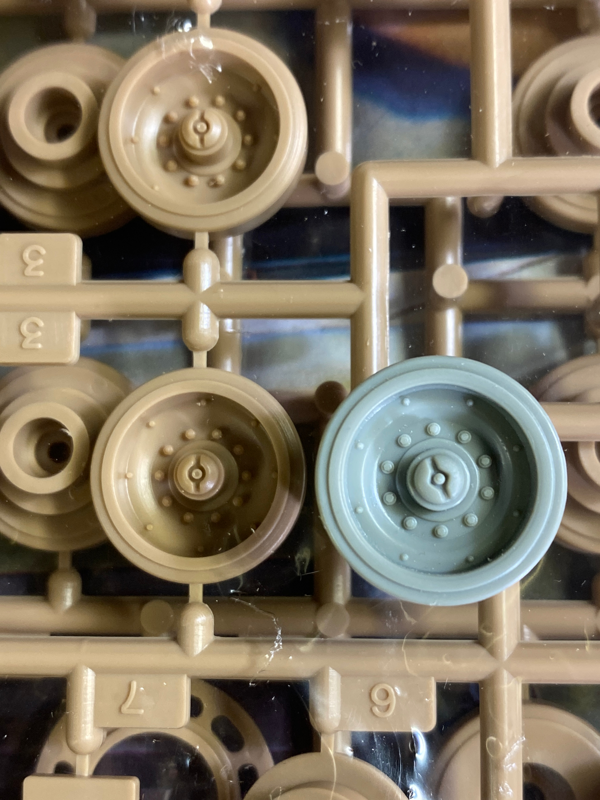

Tamiya on left, Dragon on right which appears larger as it’s sitting on top of bagged sprues.

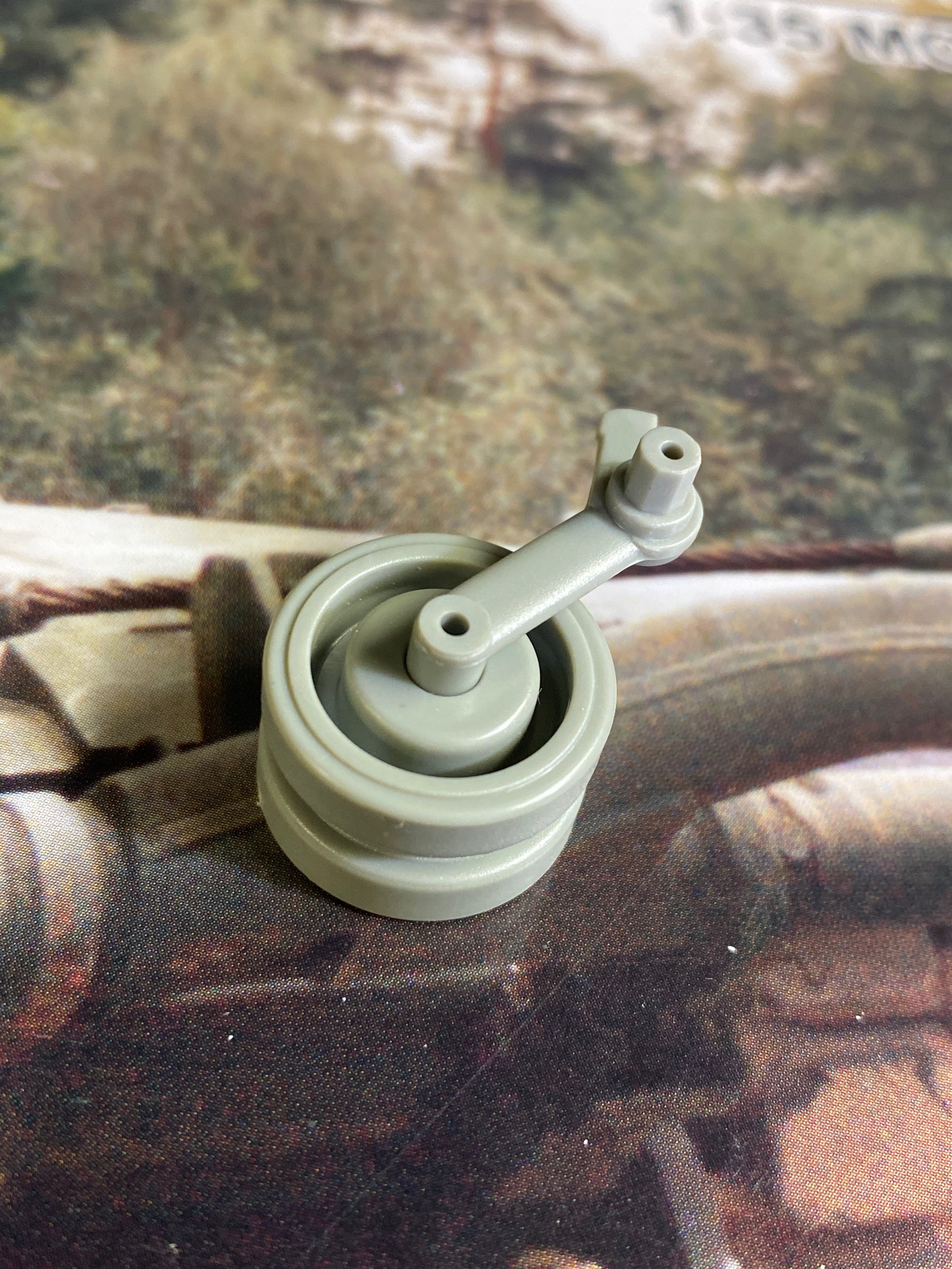

Do you have a pic of the back of the dragon wheels? I dont rememeber what the back of the dragon wheels look like
Dont think that will wotk on the rye field kit
