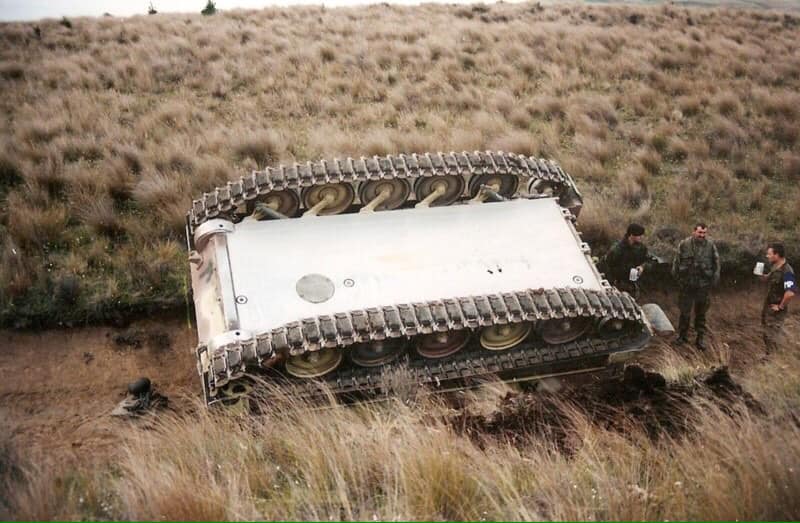

only just seen this post as i have just joined. i have a couple of pictures. quite often they are very smooth and unpainted underneath with going over lots of different terrain over years and the paint will just get striped off. this is an Australian carrier in Vietnam about to get a belly plate fitted (Australia fitted full length plates not the 1/3 plates like the US ACAV’s had
another getting ready for belly pan, you can see there is some paint nearer the tracks but not much
53231518_2211639138900026_1852769636462886912_n
having belly plate fitted
4144060
a Kiwi carrier having a rest
hope these help
