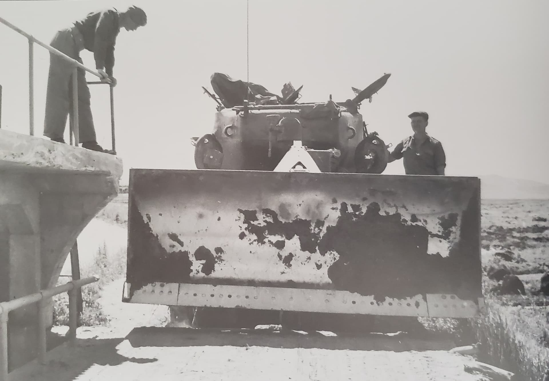

Here are training images of the Dozers that would be employed by Canadians in Korea

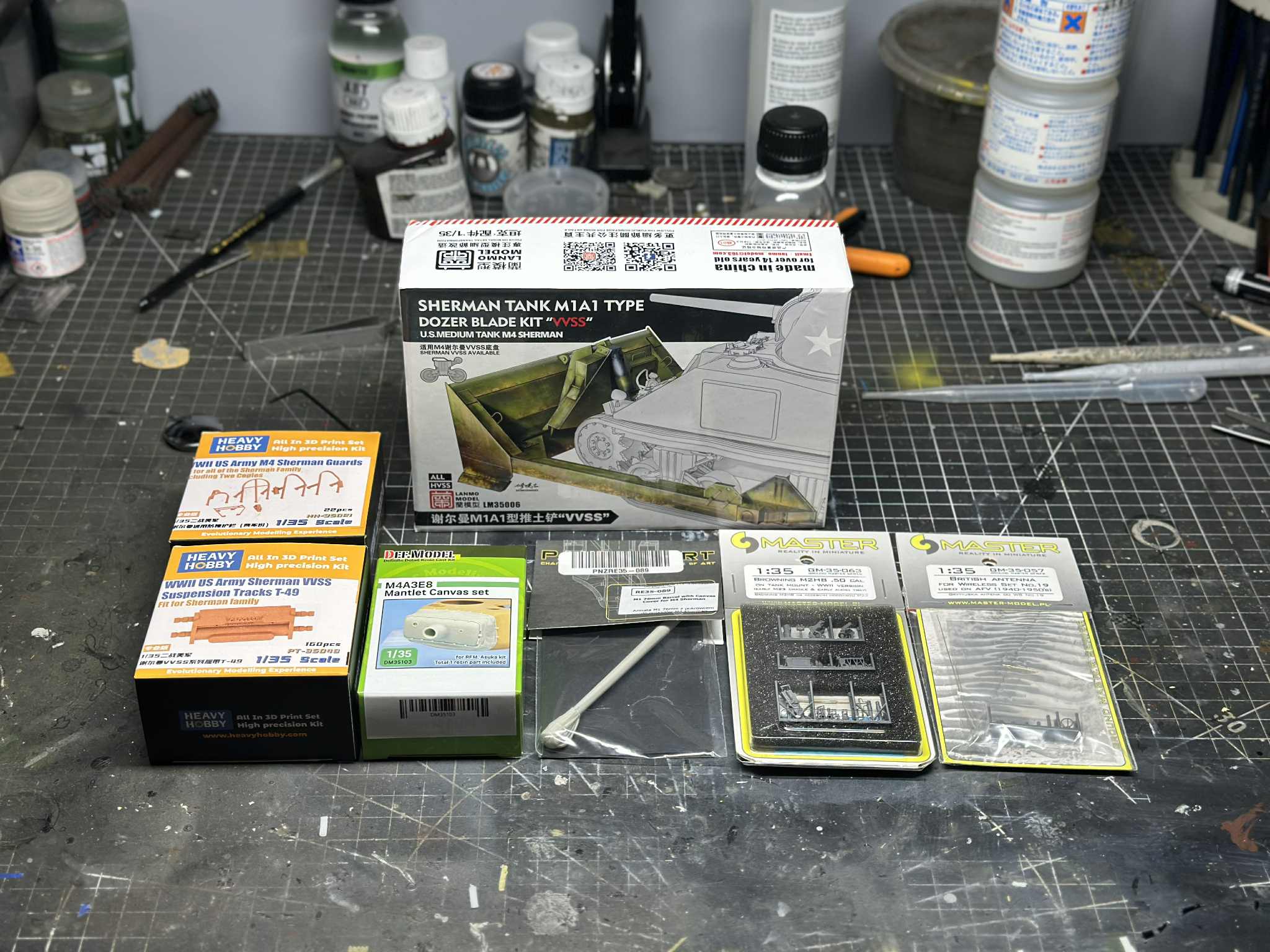

For the kit I will be using the Asuka M4A3(76)W with Star Decals for the markings.
To correctly depict Cuddles aftermarket is required. Heavy Hobby 3D printed T-49 Tracks & Guards, DEF Models Canvas Mantle, Panzer Art Barrel w/Cover, Master Models M2 and No19 Wireless set and finally the Lanmo models M1 Dozer for VVSS

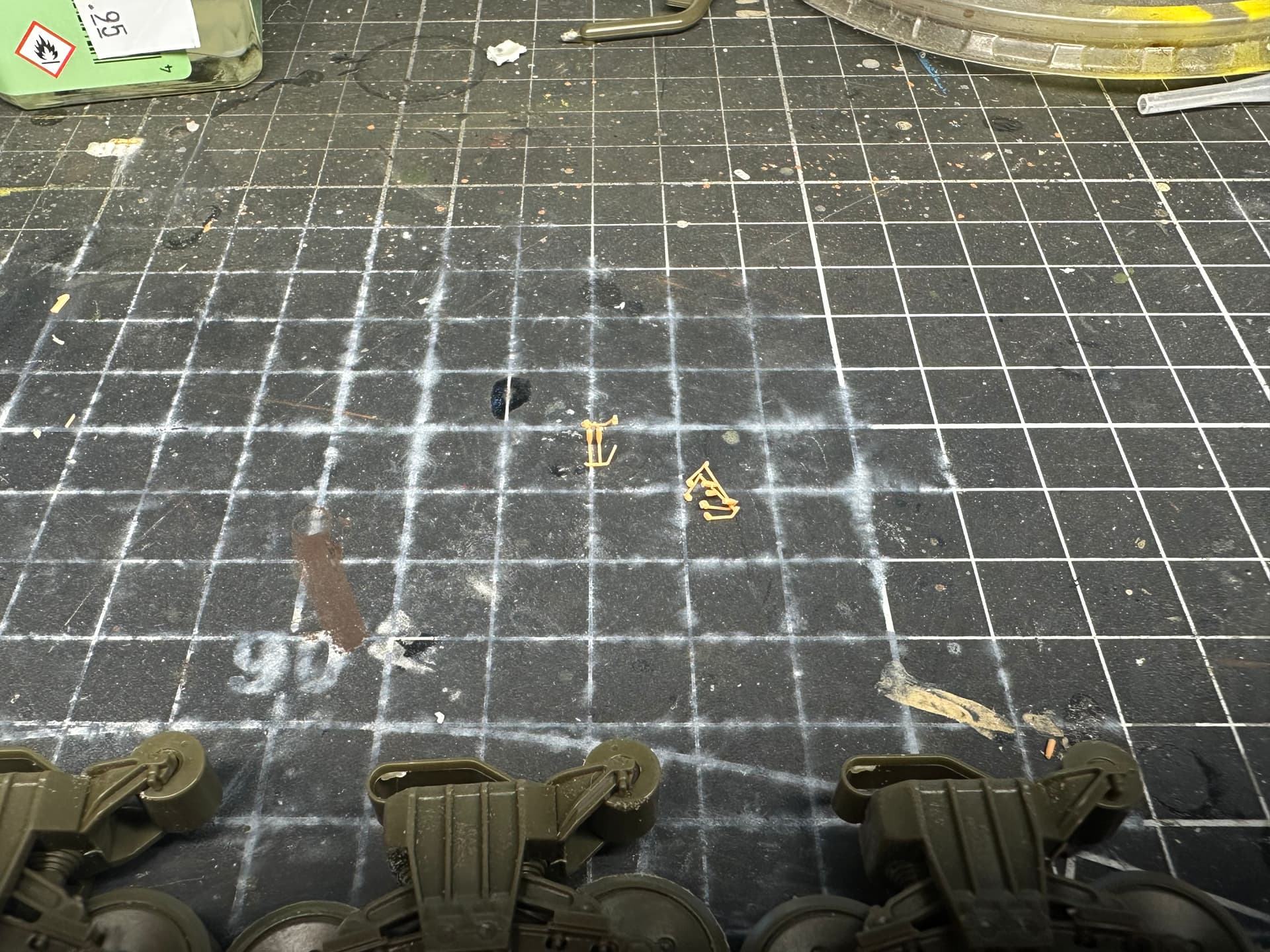

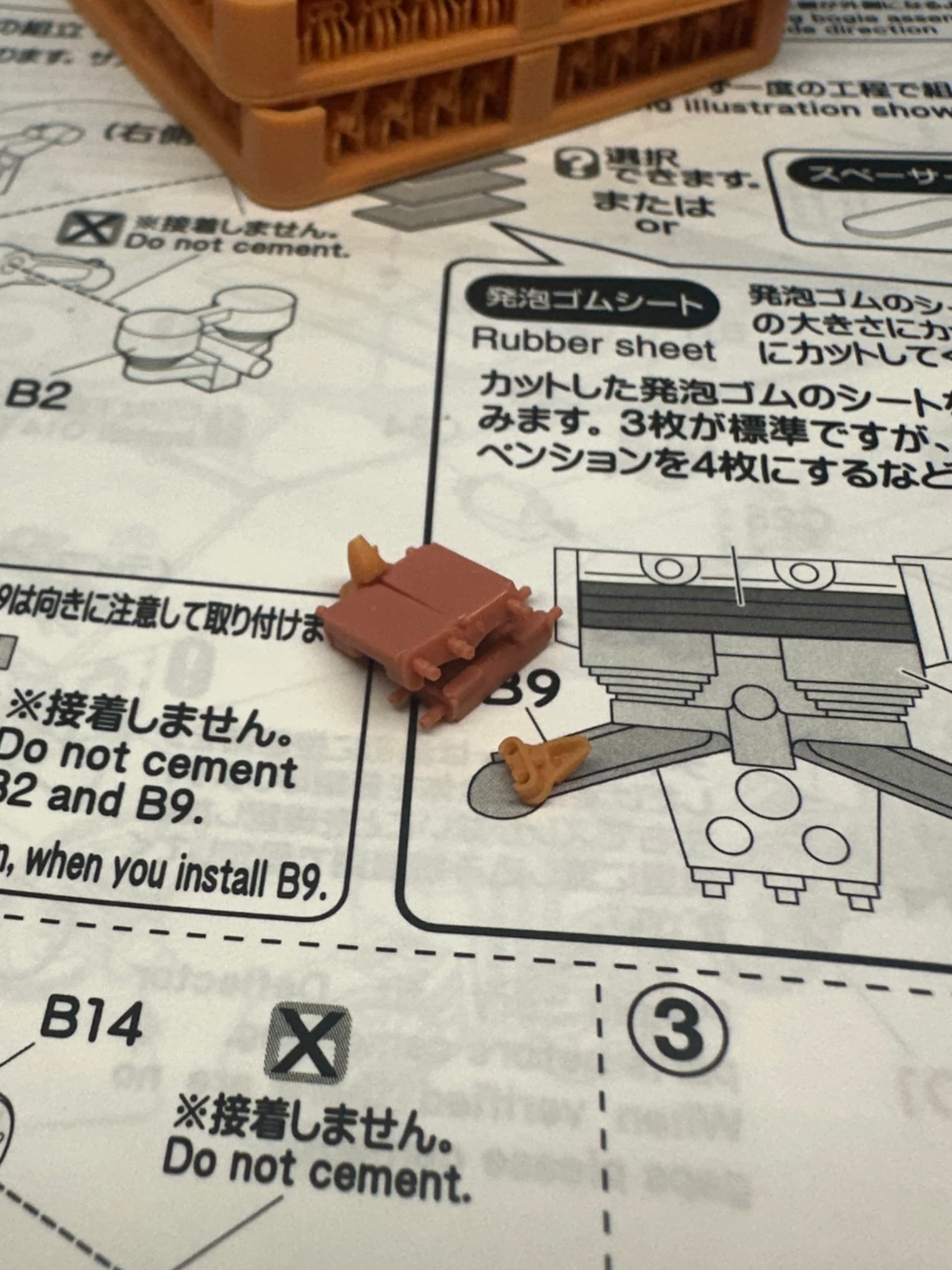

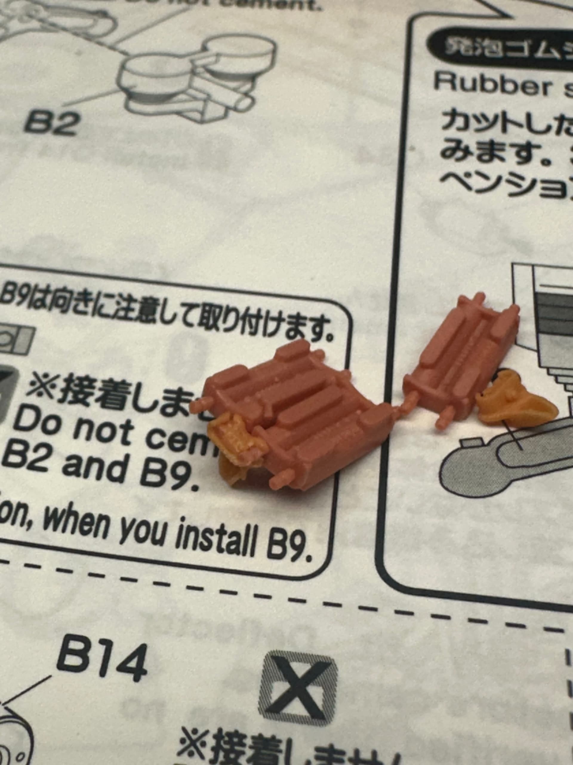

Well already hit the first snag. The Heavy Hobby tracks and end connectors are incredibly brittle. The pins are supposed to friction fit into the end connectors but they require quite a bit of pressure. I have already snapped 2 end connectors and broken the pin on one track.
I think these will end up being more trouble than they are worth which is disappointing. I am going to try and few more and if the issue persists I will bin them and use either Quick Tracks or the Gecko plastic
Not sure you want to hear this, but of those two links you do have together, one is also the wrong way round …
That might be the problem.
D’oh. But sadly the problem persists regardless of track orientation.

I am just going to replace the tracks with Quick Tracks. I tried to build a further run and had 3 end connectors explode on me. Oh well not all 3D printed parts are created equally.

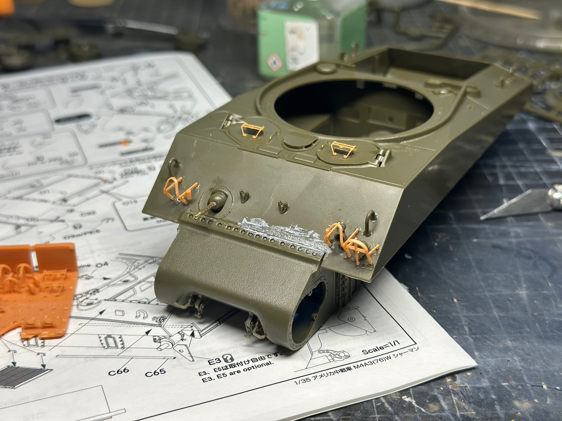

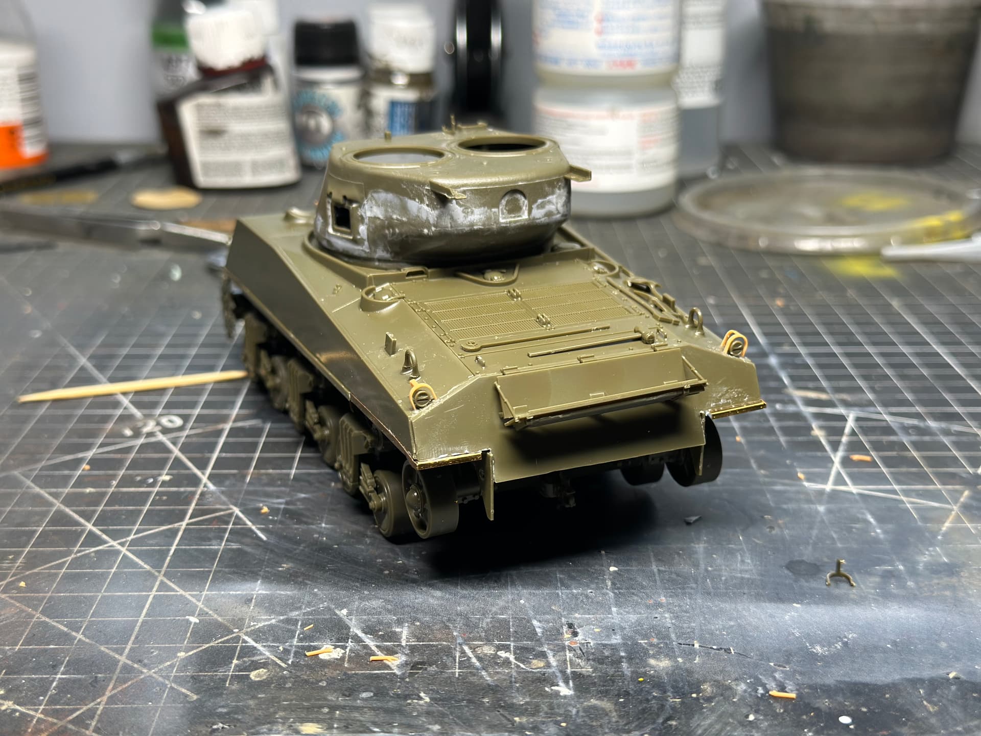

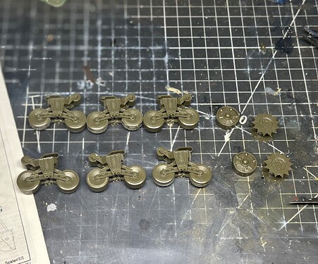

Well progress is being made on. Assembled the boogies, drive sprockets and idler then moved to the hull.

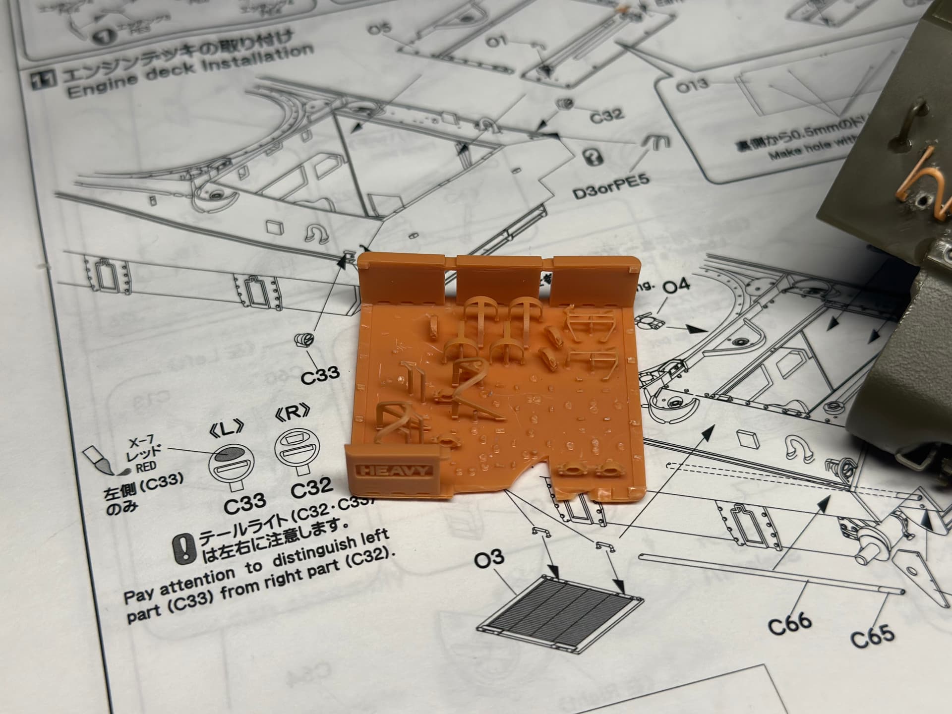

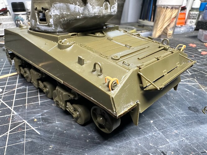

On the hull the Heavy Hobby guards were used, as well as a master model 1919 barrel. I added the hatch grab handles with 0.3mm wire. Upper glacis has some sloppy gap filling work but it will be covered with cast texture next.
Heavy Hobby is 0/2 in my book. The guards are printed in a single block and packed super close together. Using a fresh Hobby Blade and fine nippers still resulted in 3 periscope guards and one light guard falling apart. I think if they printed the periscope guards on one block and light guards on another this could have been avoided.
It’s not cast, though :slight_smile: The nose is cast, and so is the plate with the drivers’ hatches, but the glacis is a plate of rolled steel.
GAH, thank you for your info. My sherman knowledge is clearly not up to snuff. Guess I have some clean up to do

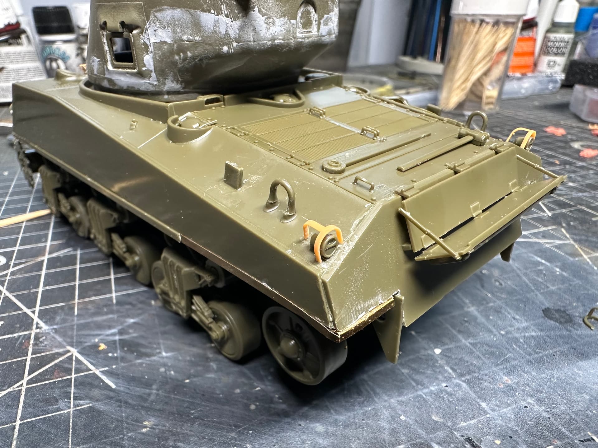

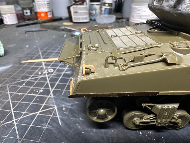

Okay hull is done. Had one slight snafu and dropped the hull destroying the 3D printed horn guard :smiling_face_with_tear:

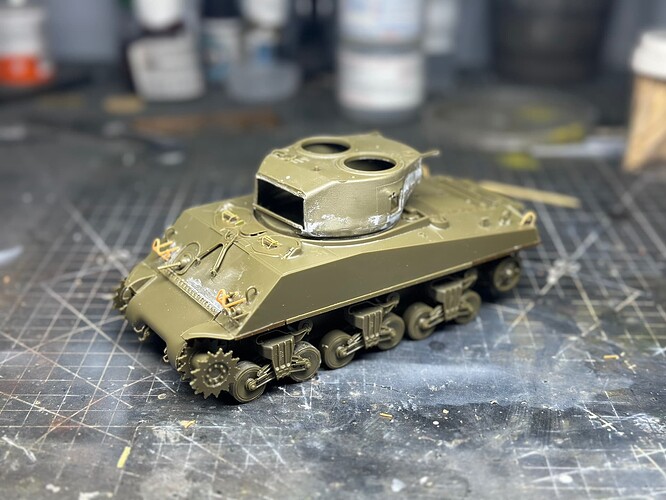

No major updated but I tried my hand at enhancing the cast texture on the model. I used Nightshifts method using Tamiya glue and Tamiya putty and I think it came out alright.
My QuickTracks also arrived and these are much nicer to work with then the Heavy Hobby ones.
I would agree.
You can also leave out the putty and just use glue and an old brush in a stippling motion to get texture.
