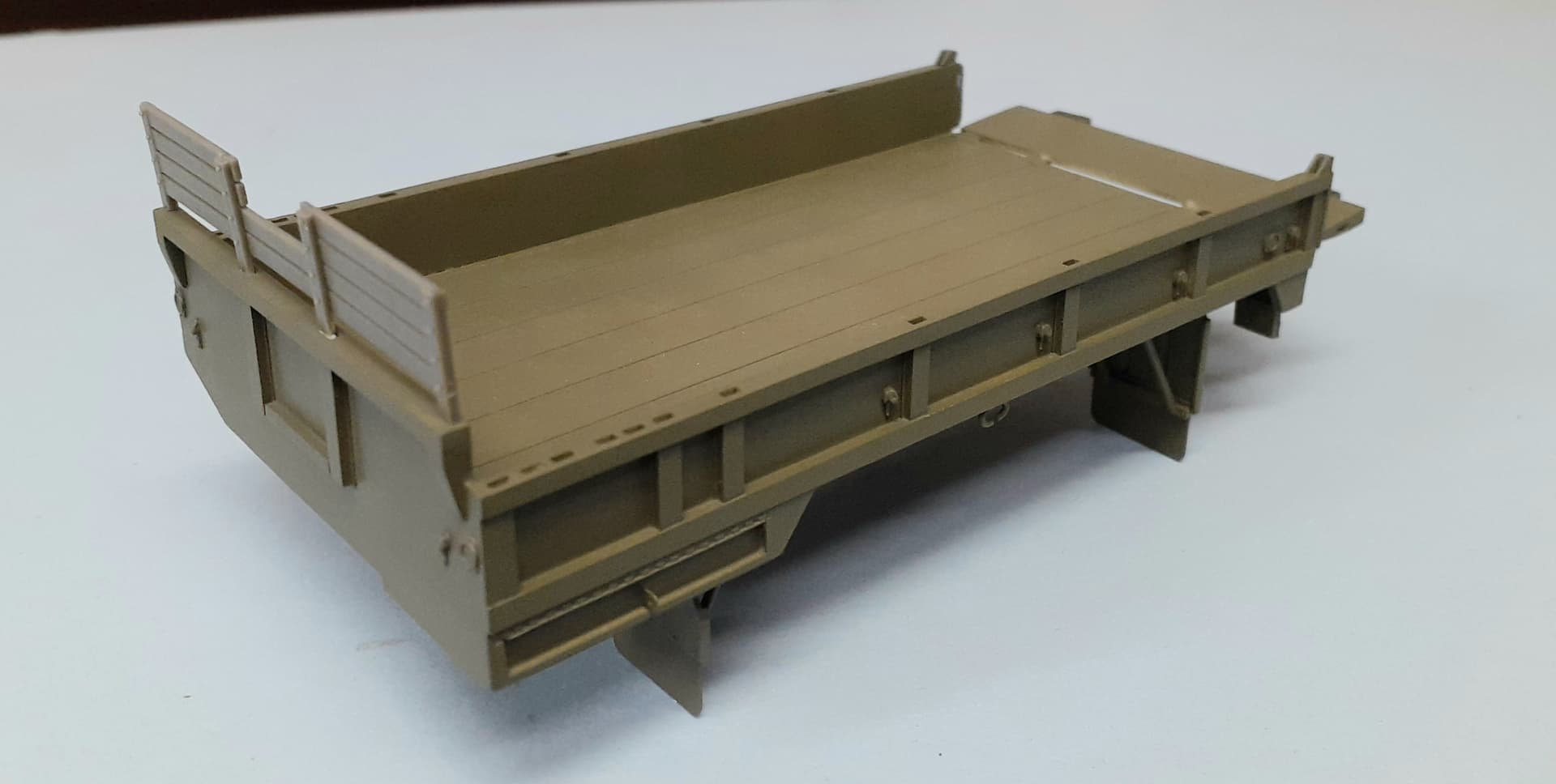

Here is the 3D printed cargo bed backdate in place. The parts are awesome. They only took a light sanding where the supports attached to clean them up. No Issue adding the parts to the kit either. They fit perfectly.
Here it is with the proper bed.
Even the slots for the canvas bows are hollowed out.
I highly recommend this set. I may have to get another for a future build.
That looks pretty darn good, Gino. I am going to have to get one of those truck bed conversion kits.
Thanks James. It is a really nice set and looks great.
