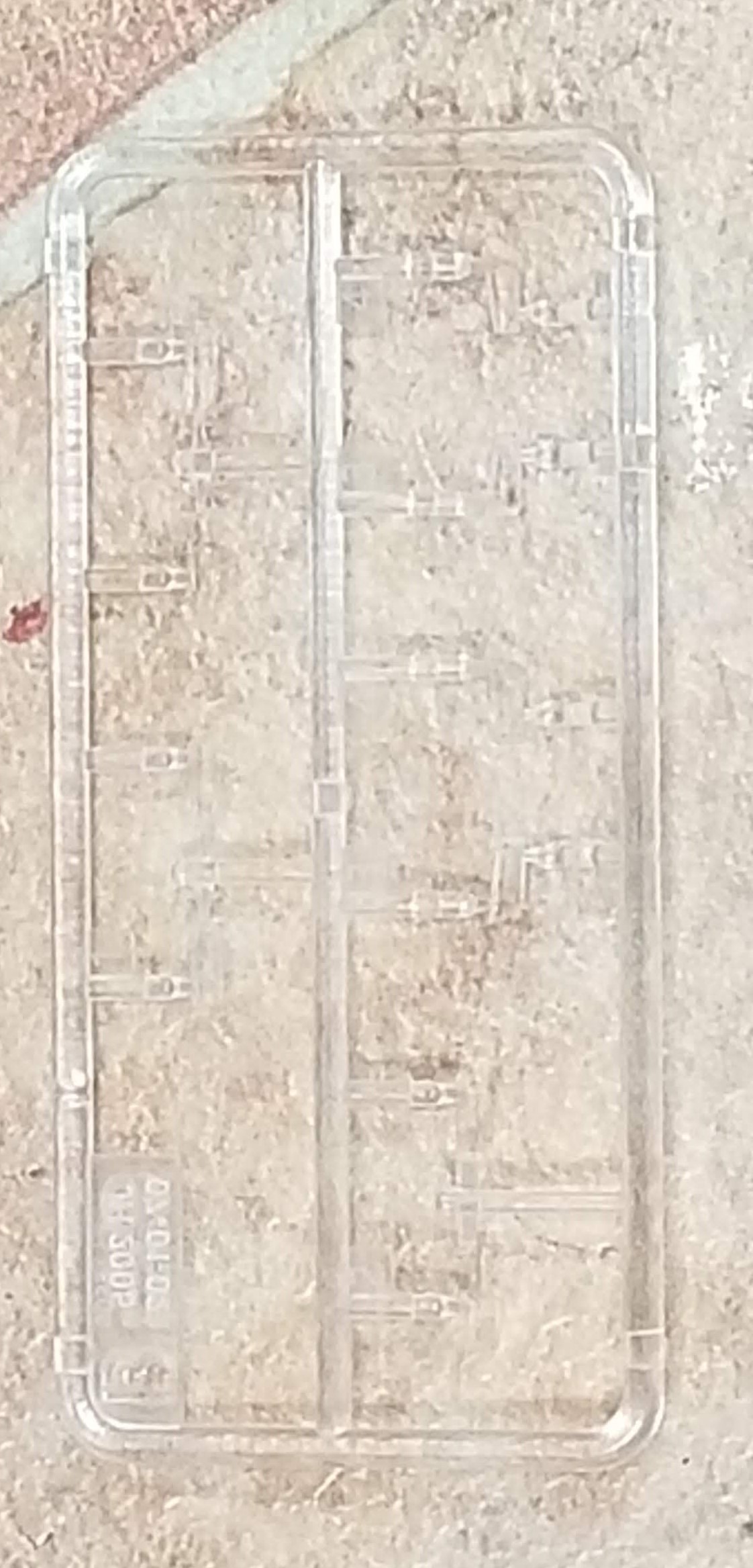

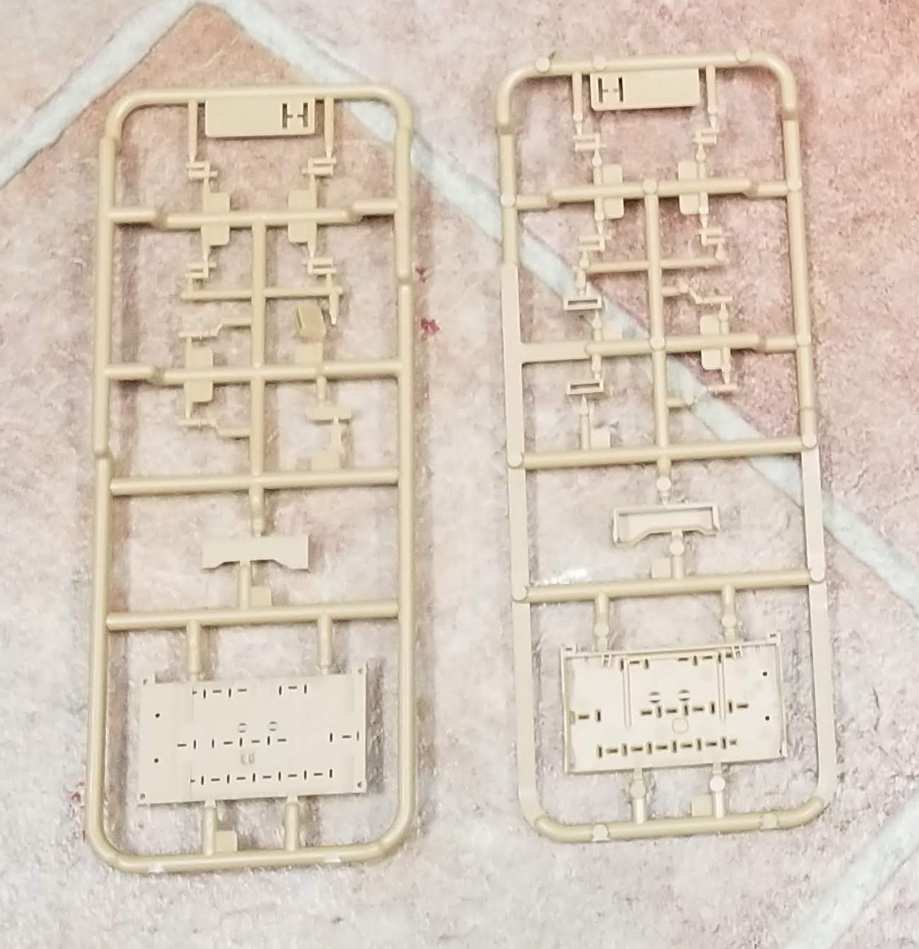

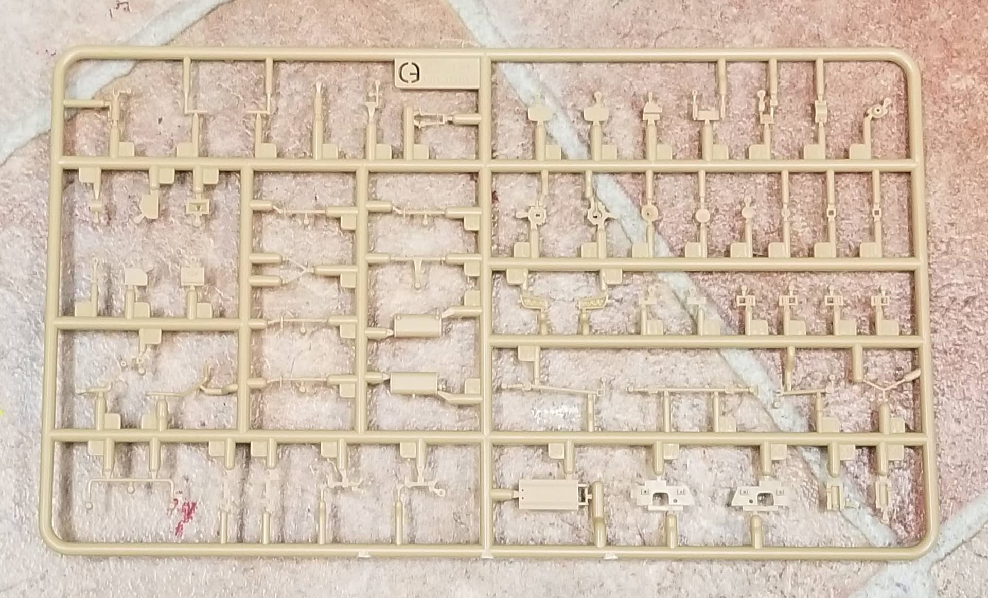

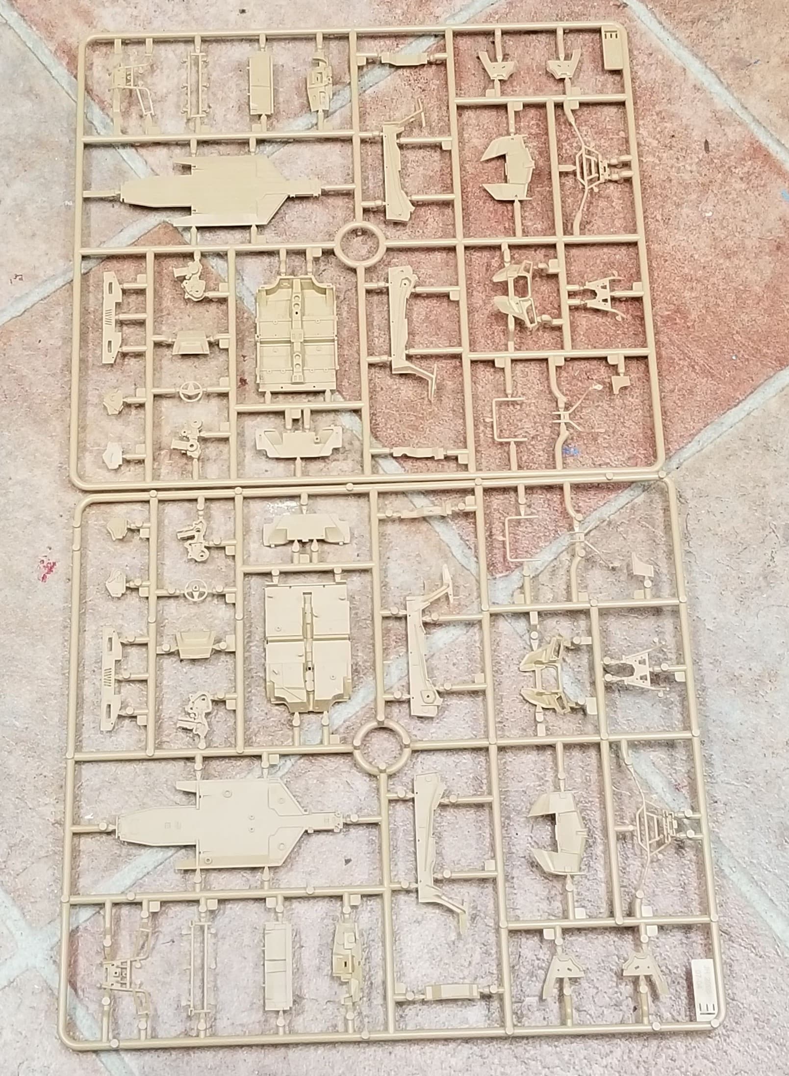

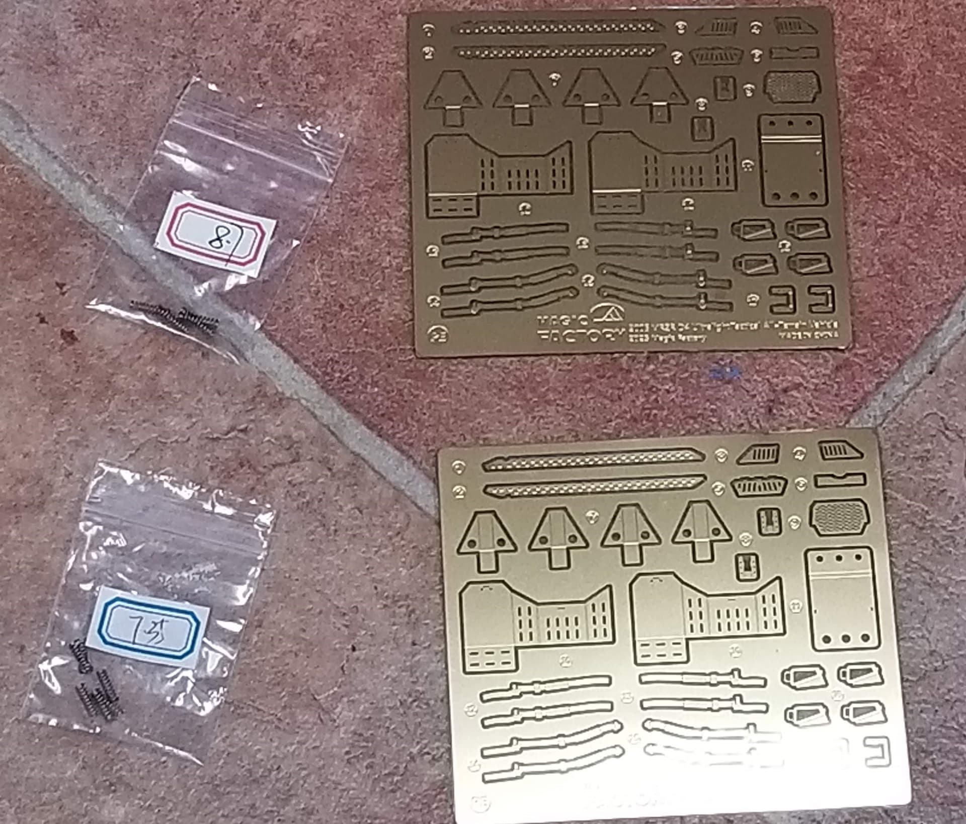

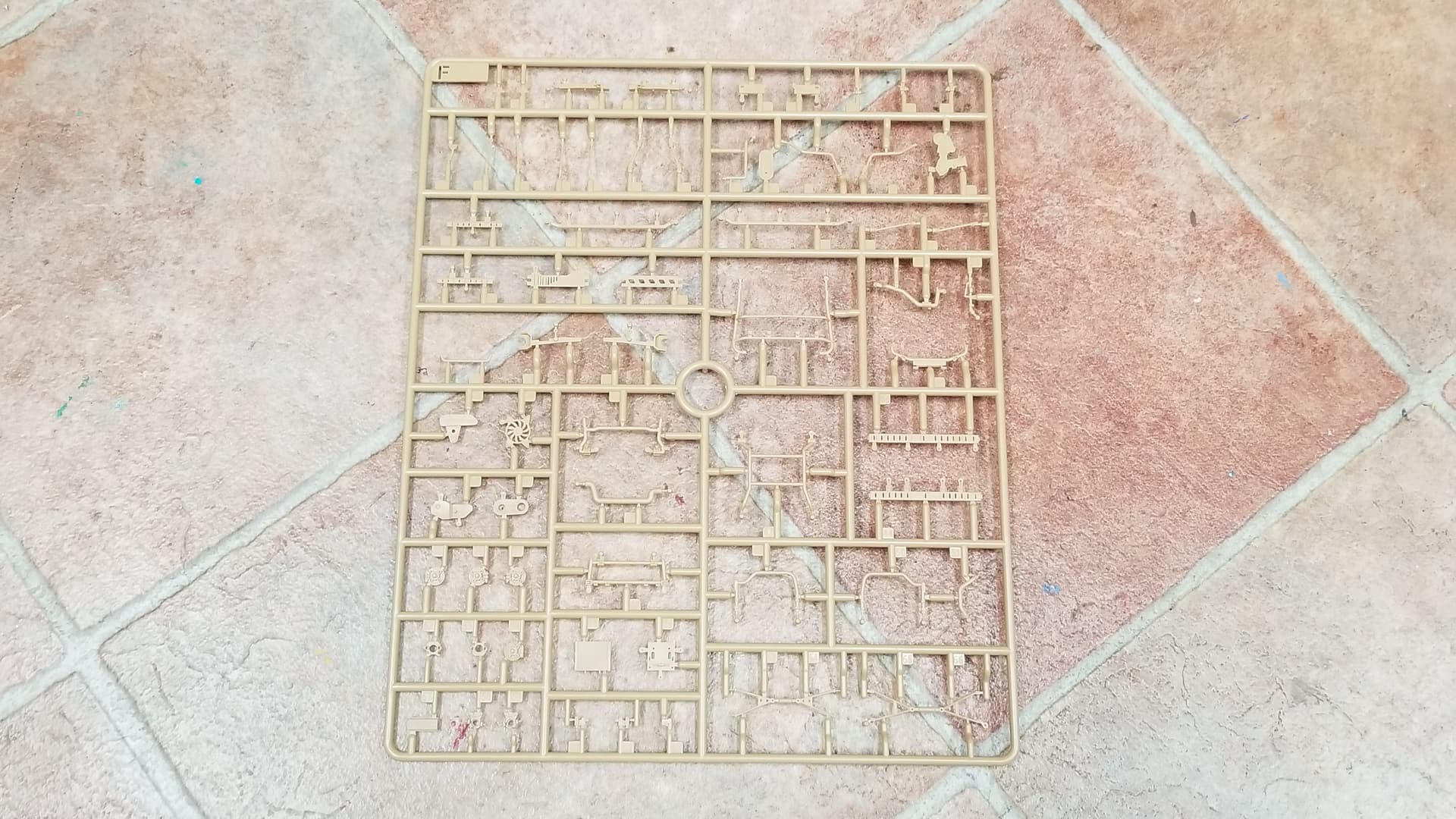

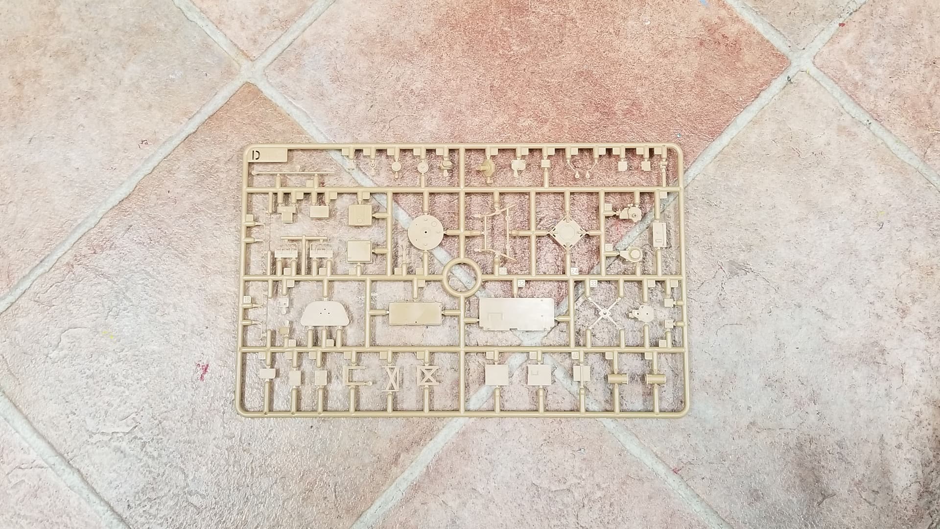

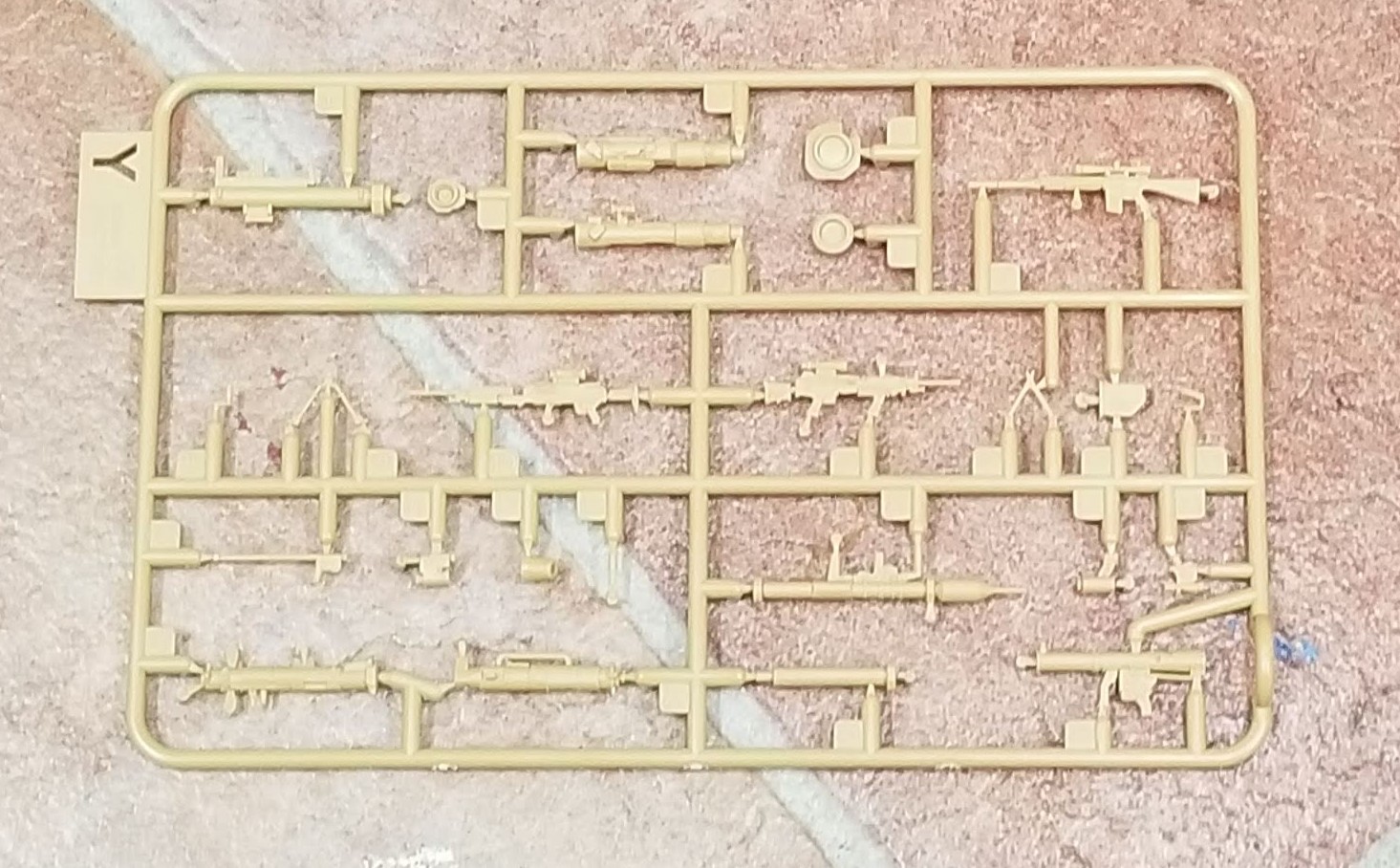

As promised/requested, this is what you get in the box. There are multiples of each sprue, except for the sprue for the trailer and the anti-drone variant.

One gets TWO of the weapon spues (sprue Y) so there are plenty of weapons to stock both MRZRs.
