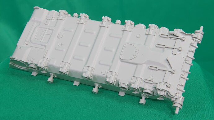

The hull was started next, fit was good with some minor flash on some parts, possibly because some of the sprues are seven years old?
The complete lower hull was primed with Mr Surfacer 1500 thinned with lacquer thinner.
