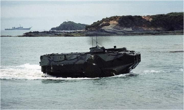

What about this one ?
U.S. Marines, aboard tracked landing vehicle (LVTP-7), land during Valiant Blitz, the amphibious assault landing phase of exercise Team Spirit '82. Tok Sok Ri Beach, South Korea.

Hi HP - that one looks overall green to me. It’s tough to work out if the color variation is paint or just water creating the pattern on the rear of the vehicle.
But some bits of black stripes are visible both on the front and the rear of the hull…

Looking at it again, the contrast between the two ‘major’ greens on the Amtrac is almost non-existent (but visible if you squint) in the photo and I can’t see the third (‘minor’) green. The black crowfeet are the only elements that really stand out from am an overall background hue.
That leads me to a further conundrum - in USAREUR, the sand (minor) color seems to have been dropped later in the MERDC era, leaving just two major colors plus the black crowsfoot patches.

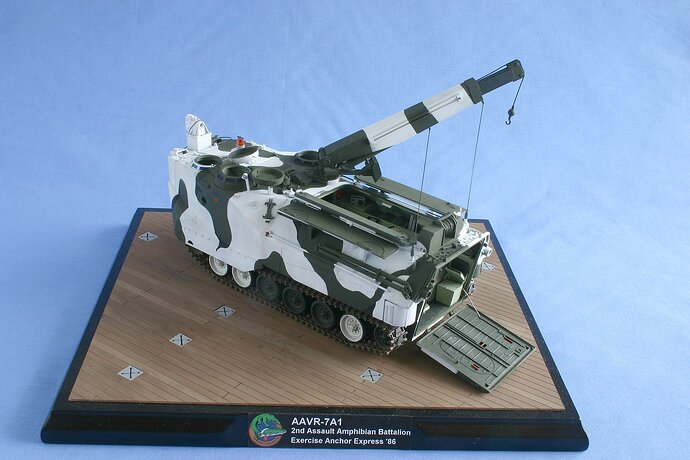

Did this happen with Marine vehicles too I wonder? I’ve seen the three-color variation on Amtracs with a partial arctic scheme, but had always assumed the sand had been temporarily blocked out with the white - maybe my assumption was wrong?
Looong-term members of Armorama may remember this Amtrac conversion I did way back in the mists of time (on the Tamiya kit, just before the Hobbyboss kits were released…).

Because the Amtrac is wet, the contrast between the greens is much more visible.
