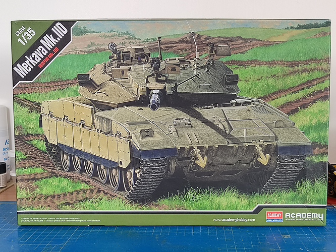

Hi all
Waiting for the decals for my VPC, I decided to start another project.
I wanted something easy and as close as possible to an OOB build.
Academy issued this model in 2014. It includes 2 sprues dated 1991 for the suspension and the running gear and 6 new sprues. It also comes with vynil tracks, a small plate of photoetched parts, a sheet of decals, a length of tread and the instructions.
The detail is quite good but sometimes simplified like for the turret bins locking handles which are molded solid.
There is no clear plastic sheet for the driver vision blocks. And the antislip coating is missing.
The fit is good. However several parts do not have any marks to be positioned. Cleaning the mold lines is mandatory.
The instructions have you deal with the upper then the turret and finally the lower hull.
At the end of step 4 you have the upper hull and the side skirts assembled. I still need to add pieces of plastic for the vision blocks.
