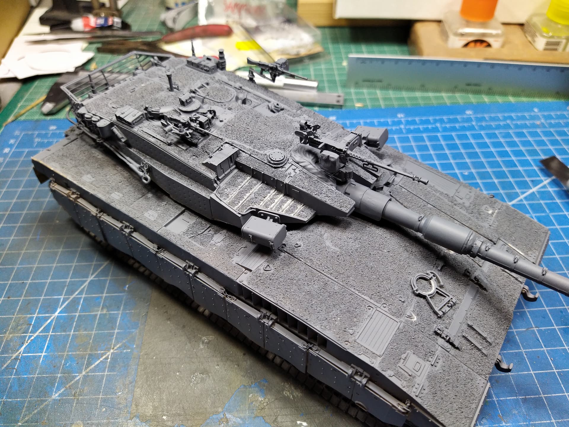

For the antiskid it is easy, some mr surfacer 1200, choose the appropriate aquarium sand or whatever one can find and then prime.
Before primer
primed
Take in mind that the surface is a bit rough because I use many paint layers and varnishes so I have to make up for that.

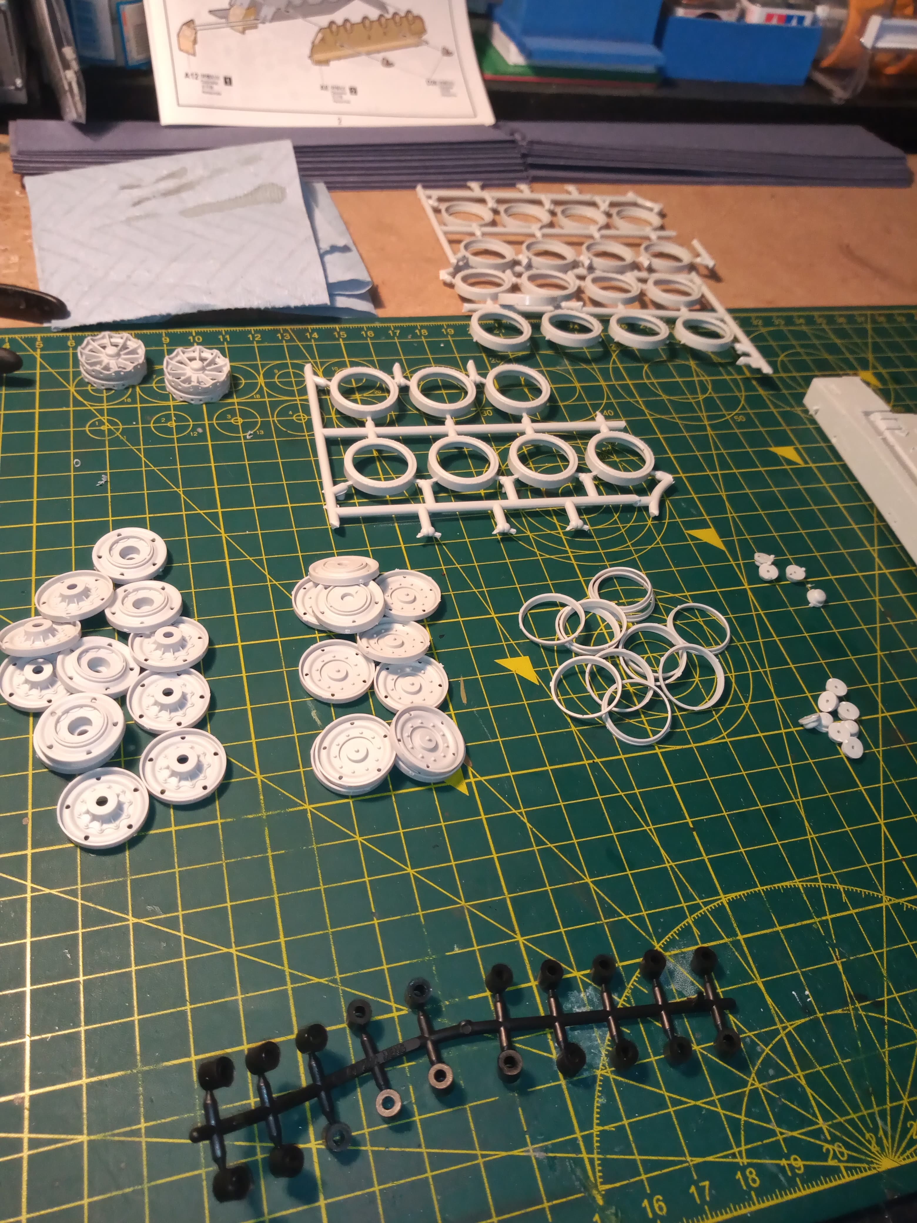

I mentioned only 2 parts per link ..
Let’s up that to 7 parts per wheel station … Yay :see_no_evil_monkey:
