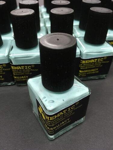

Now let me tell you about the second product — but first, a quick question: have you ever painted part of a kit, masked it off with liquid mask (like Mr. Masking Sol from Mr. Hobby) to paint adjacent areas, then peeled off the dried mask only to find a dark stain messing up the paint underneath? Well, it’s happened to me — and I found it incredibly frustrating.
I’ve also tried Micro Mask from Microscale, but honestly, I find it a pain to remove once it’s dry.
Then, on a Polish website I regularly order from, I came across a product that costs way less than the others (€1.97), doesn’t leave any residue (even on canopies), and is super easy to remove — just rub it with a finger and it comes off in one piece.
I’m sure many of you have your go-to masking products, but I really feel this one deserves a recommendation!
Here it is:
CHEMATIC 010

First of all: unfortunately, even when using Future, I’ve noticed fogging on the canopy due to CA glue, but also, unfortunately, with Tamiya green-capped glue. I don’t have an answer to your question at the moment; I’m using this wax for the first time on the Tempest canopy I have on my workbench. Given the results, I wanted to share my satisfaction right away. I’ll tell you, the same company Chematic that made the masking fluid I recommended makes a clear, liquid glue specifically for the kit’s transparent parts. It even comes with a very fine brush in the cap that eliminates any fogging issues.
