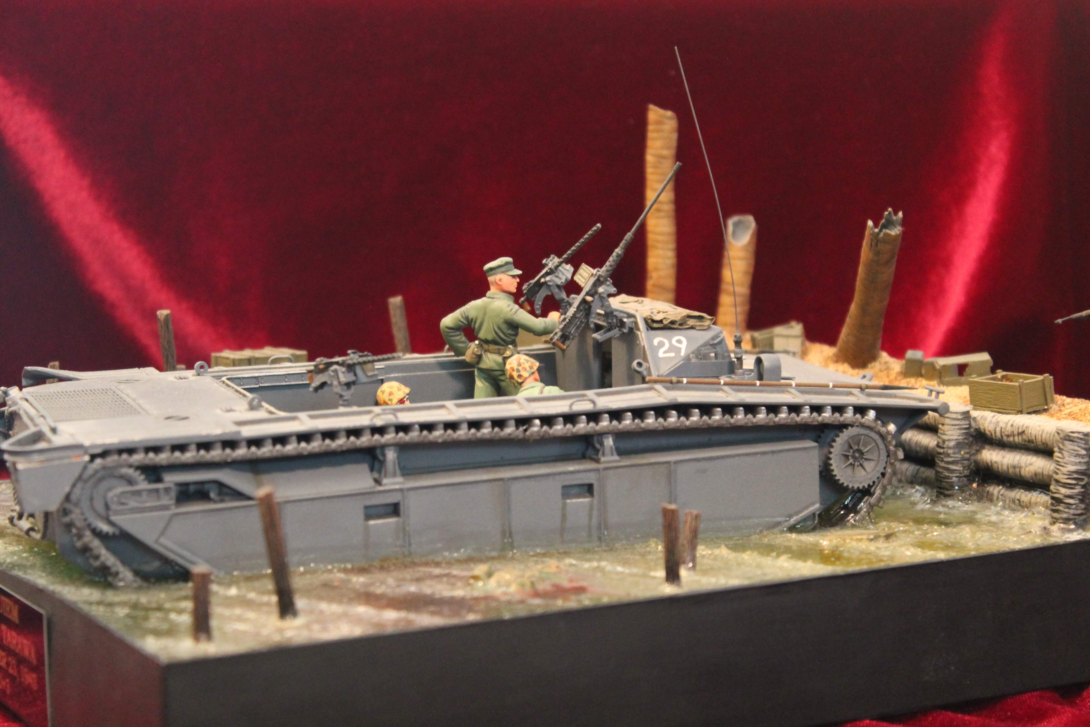

Two part clear casting resin is the answer for deep water. It can be tinted, but may darken with age. Be warned that it generates heat when curing and can damage a plastic model. Ask me how I know. Care must be taken to pour it in several thin layers and allow ample time between pours for proper curing, 24 hours at the minimum. It is self leveling so you can use the any of the other products that you mentioned, or artist’s acrylic gel to make waves or ripples. You also can suspend objects in it as you pour the layers. I used it in my Tarawa diorama.
Note that in the last photo you can see objects under the ‘water’. Hope this helps.
