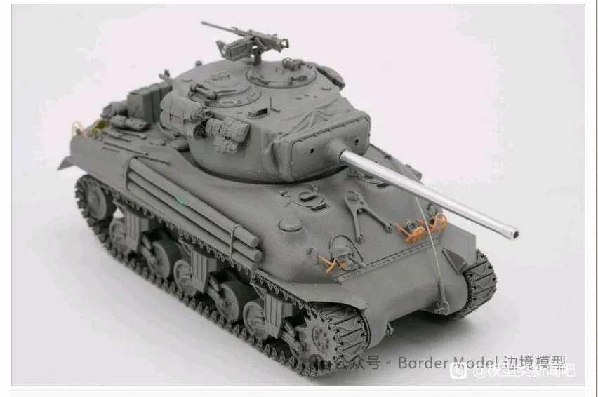

This does not surprise me:
That’s one of the initial images released for this kit about a year ago now.
These kits are just a hot mess everywhere you look. A total POS. Border can keep them.
And Border wonders why modelers keep slagging their kits…
The thread where I got the photo from is enlightening (or entertaining, depending on how you read it) in that regard:
@Jakko
Well, that explains a LOT. Especially if they originally planned to release it like that. I remember the uproar from the community. Perhaps the complaints caused the delay in it’s release as this was originally set to drop with the 75mm kit. Perhaps the complaints got them to modify their digital build of the small hatch hull quickly without regard to the proper angles of the big hatch hull. It makes sense that a company that was set to release a 76w on a small hatch hull would cut corners. I see why they pushed the gun crutch down without regard to where it was supposed to perform its function. Instead of redesigning the parts where the legs of the crutch hinge to the glacis they just slid the whole thing down to make room for the large hatches. They even reused the hideous metal barrel from this mock up. If you look at the image it has that lump on the end that’s supposed to represent a thread protector even tho the gun is not supposed to have one. It looks like they were even going to release it with the same tracks as the 75mm kit has. I’m glad they didn’t do that, the T48 tracks in the kit are a highlight. The turret has some things I like too and since it can be converted to an early version easily I think that’s its absolute best use. The second best thing to do with the turret is to blank off the forward antenna spot and use it as a mid tier between the early and the late versions. Some of those had the gun with the MB which is included. So with some mods the turret can be used to represent early to mid large hatch M4A1 76w as they evolved. The dust cover would never be useful for this turret. The turret as it comes OOTB it cannot be used to model anything that existed. I still like the turret if you don’t mind doing the easy mods, the molded on casting marks are really nice, the casting marks on the split hatch are nice, and with some work the metal barrel can be made nice too.
Also looking at the picture you posted they had to make an FDA for the 76mm which looks nice and also comes with casting marks. Both FDA the round and the sharp nose are cast as one whole piece and they look exactly like the Asuka FDAs once you put them together, but these are all in one piece.

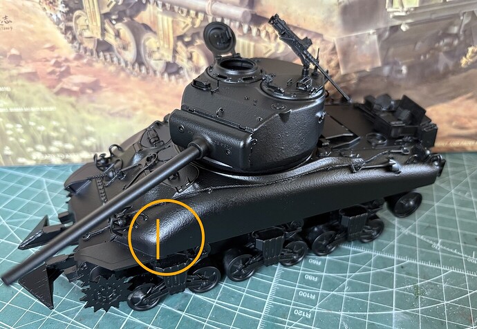

So I can illustrate the area on the front of the BM hull that shows clearly that they used the digital build of the 75mm small hatch hull to make the mold for the 76mm. They did this because they either didn’t know or care about the differences between the small and large hatch hulls which decreased the angle in the front from 56 degrees to 47 degrees to eliminate the old style hoods and to make up for the reduced slope and reduced ballistic protection these tanks had thicker armor in the glacis area than the 75mm tanks. I’ve read that it also created a bit more space in the driving compartment area.
I don’t even need to do a side by side with the Tamiya hull but I will take a photo later too. I can just use Lafayette Pool’s tank to show how that shoulder in the front of the tank has a sharper more pronounced shape than the gentle rolling slope of the 75mm hull. Here’s Pool’s again highlighting the area I’m referring to.
and here is the BM kit highlighting that area too.
the yellow line inside this circle illustrates that the upper corner should extend further up on the edge for the 47 degree hull.
So the BM is a hybrid of the 56 degree and the 47 degree hulls. In the center area underneath the gun crutch the angle is closer to 56 degrees because the hoods and the ventilator area spaced it out to that angle, but on the outside corners it tapers down to a 56 degree hull around the “shoulders”. Again, this would not have been outside the scope of what I can do, some putty and some sculpting and I could’ve had fun seeing if I could get it right. I guess I just gave up on fixing big stuff after seeing that the lower rear engine/hull plate needed to be scratch built to be accurate.

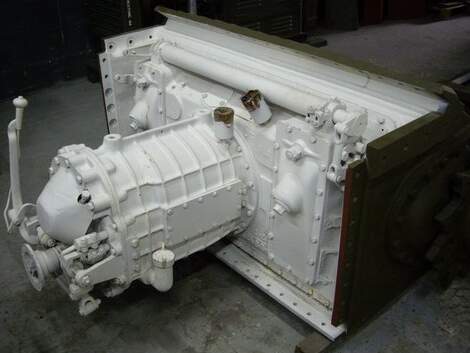

Et al:
I’ve often heard and seen the “bow” of the hull called the differential cover, and/or transmission cover. The FD (final drive) is as @Jakko describes it. The actual FD assembly is inside the cover, and the external teardrop on the nose of the assembly mounts the FD to the plate and provides a stable pass-through for the shaft to the sprocket.
Pics from Sherman Minutia website
The FD Is really a rather flat/compact gear set that converts transmission output to torque and power.

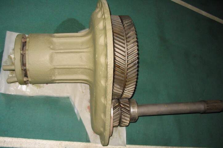

Here is a Final Drive: that shaft is the output from the differential.
Pic from The Sherman Tank website
