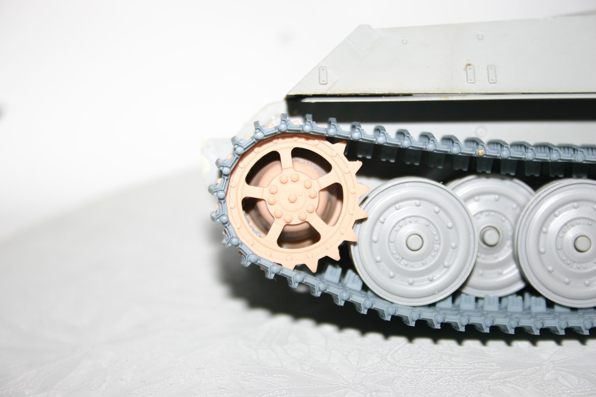

Well, not anymore! I discussed this situation with Przemeslaw Wojdas, proprietor of Panzerwerk Design in early January. So, what does he do? He hits the proverbial home run and produces a brand new, correct set of left-side Kgs 73/152/800 links! The new set, 35-PW046, is 3D printed to his usual high standard in blue-gray resin. The set contains 220 links and 440 pins. The links are highly detailed and require no adjustments for proper fit.
A little-known detail which is overlooked by kit and AM manufacturers is that the inner guide horns for all tracks designed for the Tiger II were 10mm shorter than the outer. The reason for this was to allow the guide horn to clear the rear of the drive sprocket’s surface. Przemeslaw captured this perfectly.
The track links are compatible with all 18 tooth late sprockets available for the Tiger II with no fit issues.No CA is required to assemble the track; the two-part pins lock securely into each link with a perceptible click.
