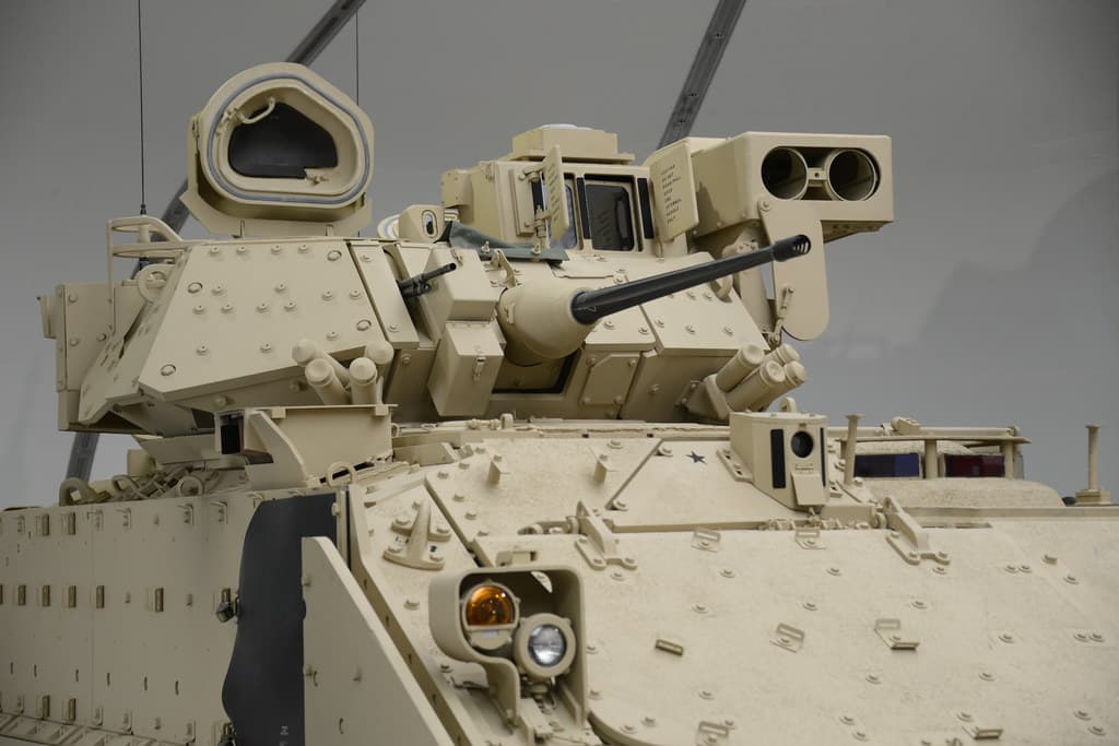

The groove in the gun for the ejection port was one of the 12 things that I had noted before I even had the kid in my hands. I had done a lot of photo reconnaissance prior to my kit arriving the day that I had to leave. Gino is right in that you can build other versions with what you get in the kit, but you would normally need five or six ammo can holders on the turret bustle and you only get four. (In the 3 in 1 kit) So you’ll have to come up with another one from another kid. I notified Magic Factory about this oversight and they thanked me, but didn’t say they would start including an extra one in the kit. That missing Ammo can holder was not one of the 12 deficiency I noted by the way.

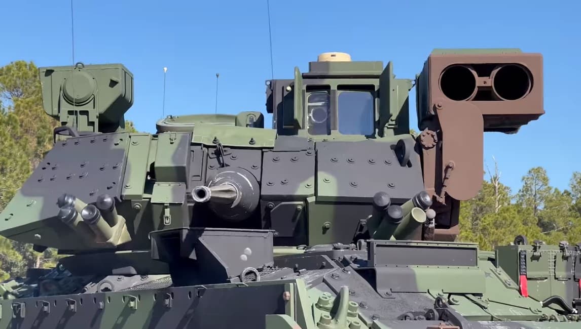

Yes. It should be at about the 11 o’clock position (when looking from the front) and is a hole that goes all the way in, but is flat (horizontal), so it looks like a groove.
I don’t believe the later versions uses it. It is not present on the ones below.
M7A3 BFIST
M2A4
Thanks. Does anyone make a corrected mantlet for the kit?
None that I know of. Meng did include it on their Bradley kits though.
It is easy to add, just start drilling a small hole vertically at the 11 o’clock position. Once you get a purchase on the plastic, turn the bit down to the front until nearly horizontal, making a teardrop-shaped hole that looks like a groove from the front.
It is not really incorrect. The M2A3 and M2A4 both have the CITV, which shortens the turret basket and they usually only have four ammo can holders. The M2A2 ODS-SA kit comes with extra parts that include a full length turret basket and two more ammo cans, all 3D printed.

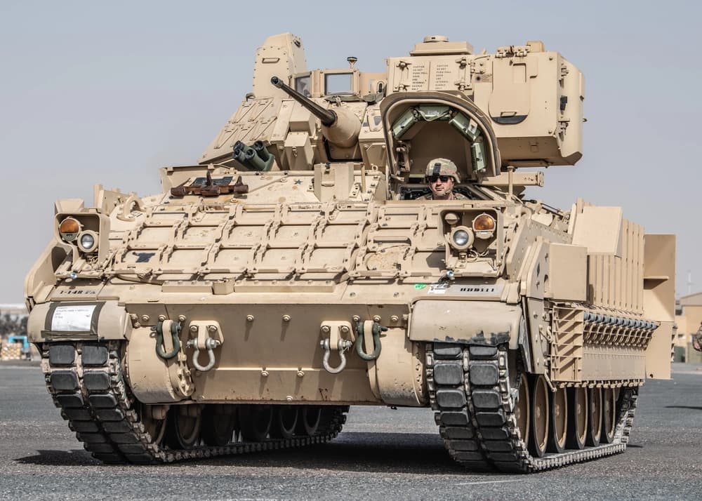

M2A3
If you want more ammo can holders, Jacques ā€œ@JacquesDā€ does a 3D set.

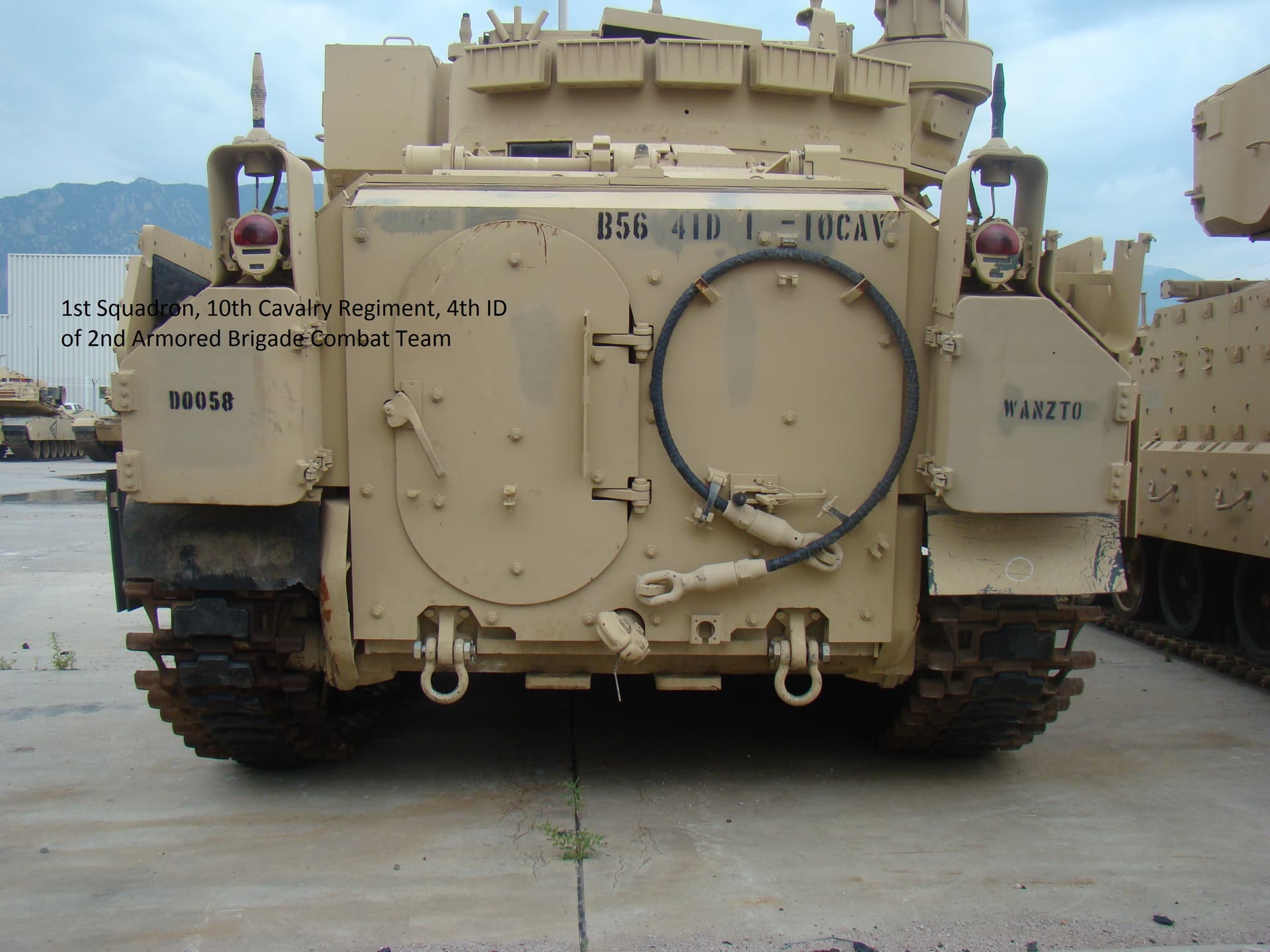

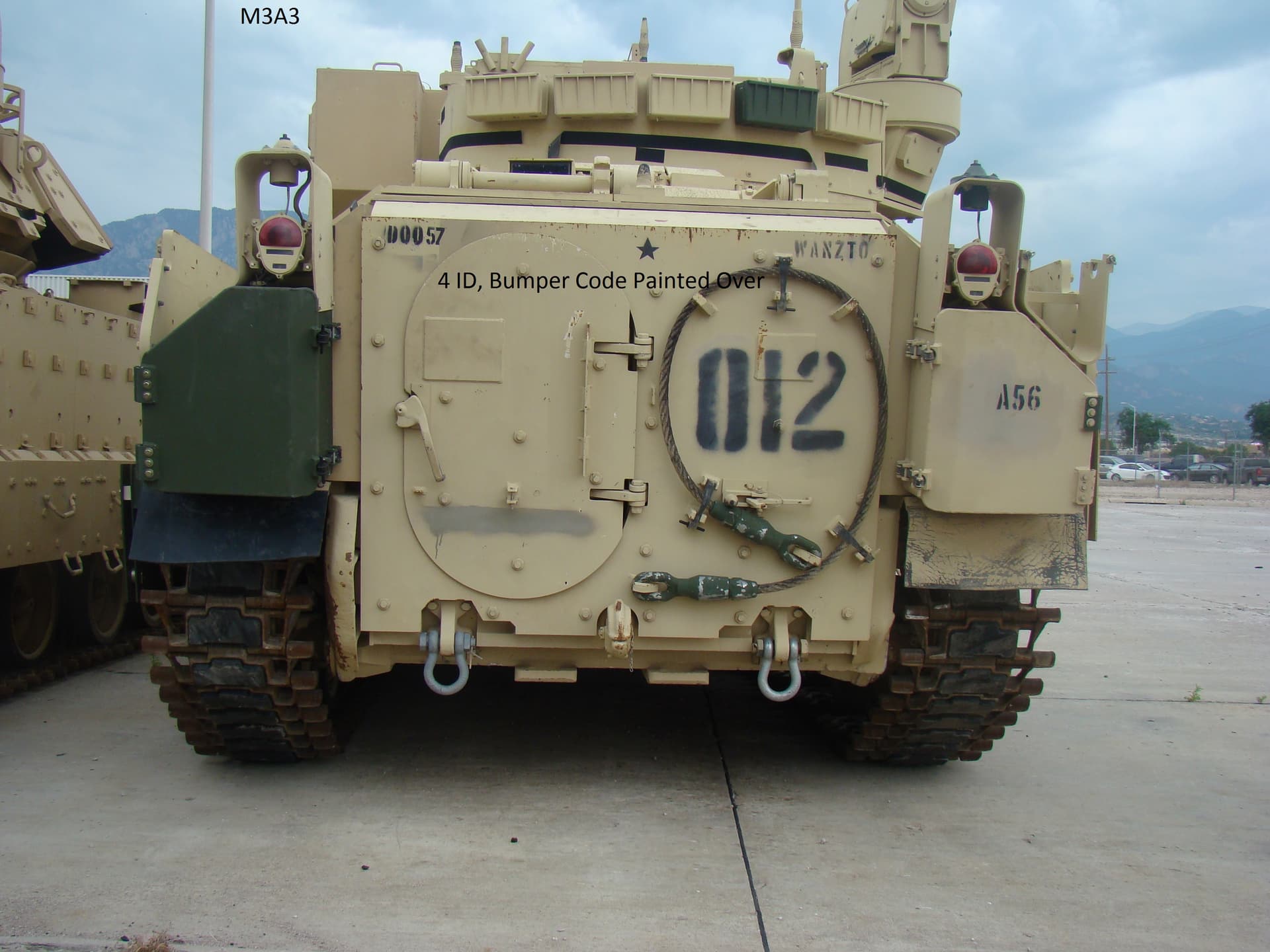

That’s not what I’m seeing:

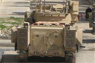

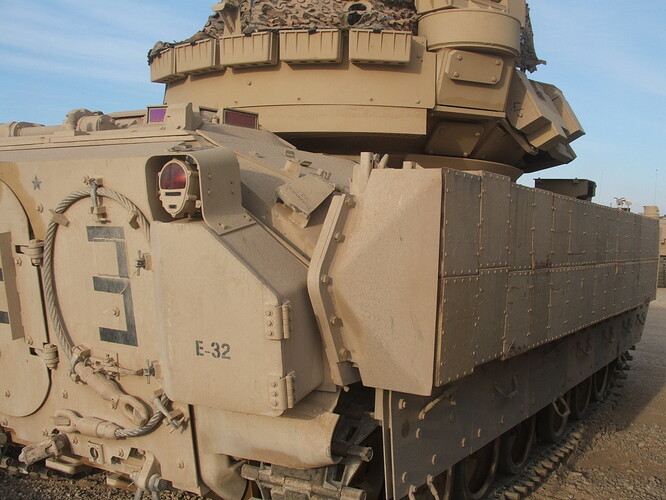

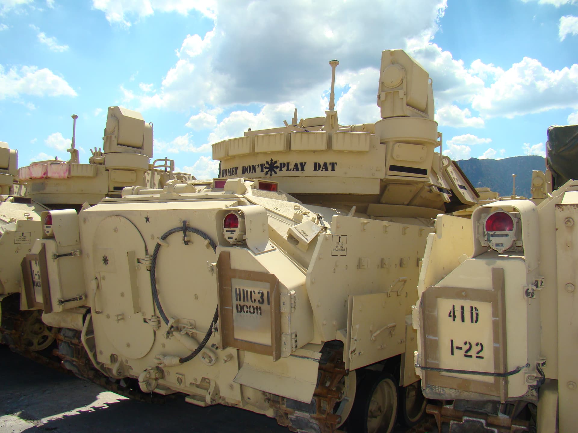

I even have one where the crew managed to add six to the bustle.
You may be confused because the Meng M2A3 and M3A3 kits only have four. That’s because the bolt holes for one box were utilized for a Duke antenna mount, like the one in your photo.
None of thre ones on my COP or in Tal Afar had the Duke antennae, and we were in EID alley up there.
Sort of. The outer perimeter of the basket doesn’t change much from what I can recall. I’d have to check some kits but I’m on the road. The big change to accommodate the CITV is how the right end is altered. The bustle ends usually face forward. For M2A3s the bustle end angles inward, perpendicular to the faceted portion of the turret at the right rear. It reduces the internal volume of the bustle but still leaves plenty of room around the rear perimeter for five and even six ammo can holders as in the photos above.

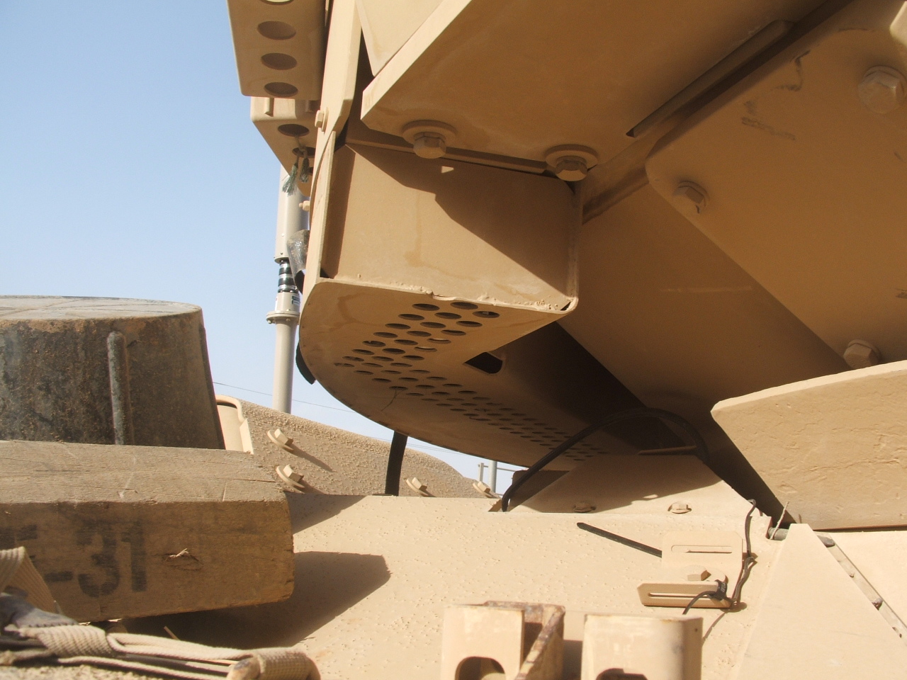

You can here where the original bustle was simply cut off at an angle.
