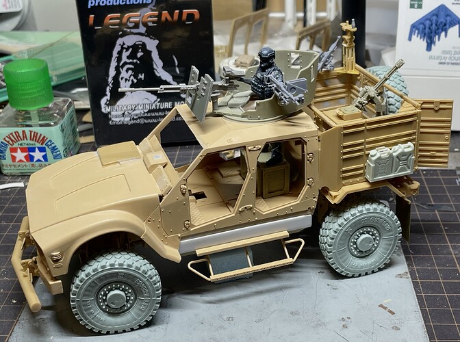

Hi,I combined RFM and I♡kit.
You’re right, the I♡kit is a disappointing kit, so I stopped making it here.
Oh my - that stowage box in the right rear of the cargo compartment looks nothing like the real thing. Same with the two cabinets in the front. And the floor detail is awful as well. Even so - it looks like you’ve done well with it. Why stop now? You can hide a lot of that with rucksacks and equipment.
There are no electronics on this cargo, and the mud flaps are on the inside because the taillight bars are narrow. So we’re making them in 3D CAD. That’s going to take a lot of time.
