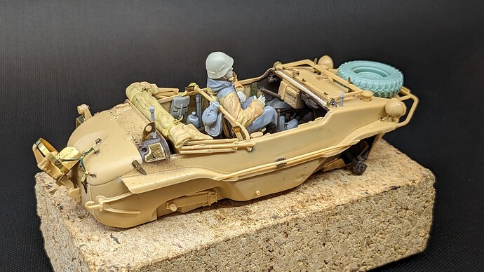

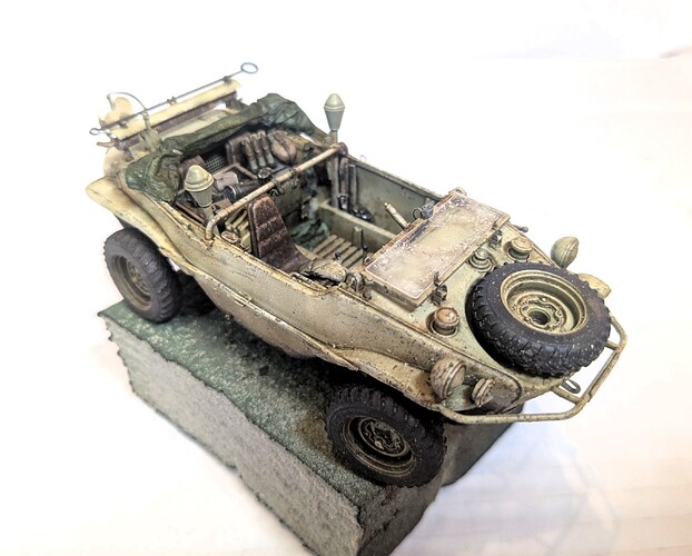

Just to finish the basics on the Schwimm… here are some shots of the finished model before the paint went on.
The figure was an early attempt at the driver, but I wasn’t happy with the pose so you will see him replaced in the later shots.
The only other part of the build that I found challenging was the fold-down top. The Aber set tells you how to make the supports from bent wire, but it looks like an absolute nightmare - and there’s still no tarp! The Tamiya moulded version isn’t bad, but it just looks too much like a lump of plastic. So I hacked it about a bit and then added to it with Tamiya putty and some photoetch buckles and straps. We will have to see how it looks once the paint starts to go on…

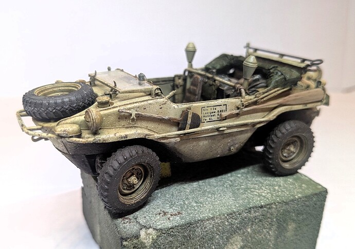

Although hardly new, this time I thought I would try out the ‘improved’ Tamiya Dark Yellow 2 XF-88 for German armour. Both the 250 and the Schwimm had a couple of coats of the standard colour (mixed with Tamiya Yellow top thinner and a few drops of Semi-Gloss Clear X-35 varnish. I then added a few drops of white and went for light overspray in a random cloud pattern, focussing on the highlights.
I’m actually very pleased with the result, with the Schwimm turning out looking slightly paler and lighter than the 250, which helps to make them visually more interesting.

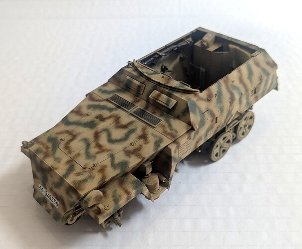

As I have said, my airbrush skills are rusty and I honestly don’t think I have attempted anything like this since I was in my mid-teens back in the 80s. Once again I went with the ‘new’ Tamiya acrylics, this time Dark Green 2 XF-89 and Red Brown 2 XF-90. Reminding myself to keep the air pressure as low as possible (around 5 psi), the paint as thin as possible (using Tamiya orange cap retarder lacquer thinner way beyond the 50% ratio) and the nozzle close to the model, I started…
Here is the outcome of my first attempt.
Now I have to admit, at first, that I was quite pleased with the results. Sure, there was plenty of blotching and some spatter here and there - but this is supposed to be a scheme applied, in the real world, with a spray gun by an amateur in a hurry… not an artist. It was also pre-washes and any weathering.
However, looking at it over a few hours and comparing it to the photos of the real thing, I grew unhappy with what I had done. Ironically, I think that it just looked too ‘artistic’: the gaps between the squiggles were to regular and the squiggles themselves too narrow.
So I took a deep breath and had a second go, adding to what I had already laid down. This time I was much happier with the way it turned out.
I finished this stage of the painting my giving the whole exterior a light misting of a lightened version of the base coat, as well as highlighting some of the panel lines, and then covered everything with a coat of semi-gloss varnish.
Now don’t judge me too harshly here. There is still a long way to go.
And yes, I know the number plate isn’t exactly right (I even lost part of the first number when I removed the masking tape). It was the best I could find from my spares stash. Also the loading stencil is clearly wrong - it’s for a Fiat! But that’s all I had and this side of the halftrack will be almost impossible to see once it’s on the diorama…

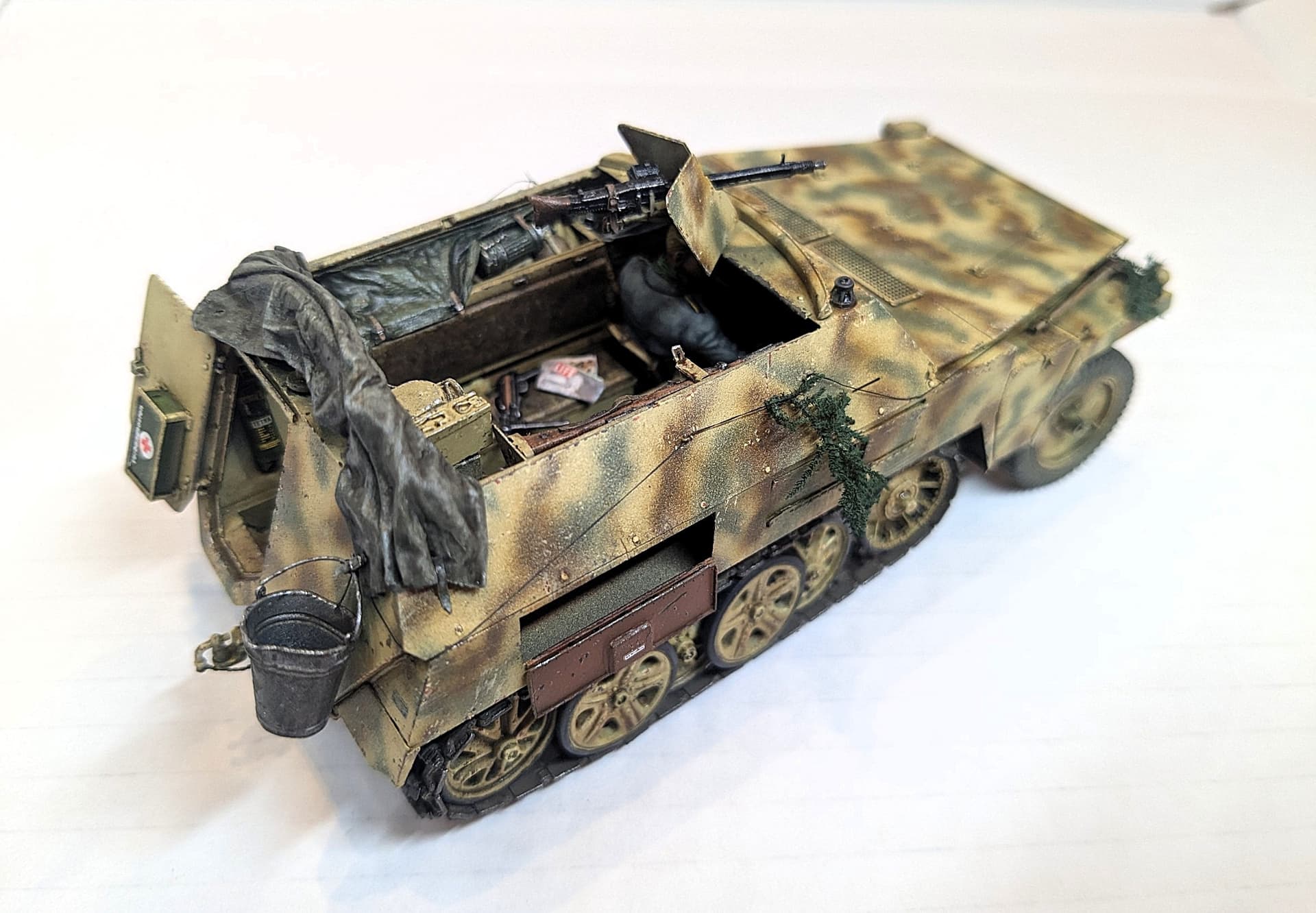

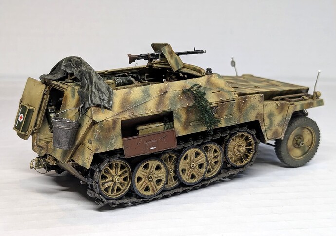

Although the 250 is not quite finished, as you see I have made a lot of progress. Best of all I have the wheels and tracks on and the tarp and MG mounts in place. Without these it looks a little forlorn (like many you see in Panzerwrecks). With them IMO it looks the biz! I hope you agree…
These photos aren’t the best - the model looks much better with decent all-round lighting - but they show the results of the weathering process. This was mostly textbook stuff.
I started with a wash of Abteilung 502 Brown Wash (over the semi-gloss finish) which was left to dry for a few days. After the wash, the model tends to look rather glossy and unreal, so I knocked this down with a light spray of Mig Matt ‘Lucky Varnish’. This stuff is great, because you can spray it straight out of the bottle and cleaning the airbrush has never been easier!
This was followed by chipping. Rather lazily I started with Mig Light Wood - it’s just a decent lighter shade (a sort of yellow/grey) that adds contrast to all areas, whether they be the original dark yellow finish or the camo colours. This was partly done with the sponge technique, but mostly with a fine brush.
It was then a matter of adding darker chips - some with dark grey to suggest chips through to the metal, others with red brown to represent shallower chips that only reached the primer coat. In a few places I then added a metallic element with Mig Gun Metal and a sharpened graphite pencil.
Sorry I couldn’t be bothered to take step-by-step photos of this process, but I hope you get the general idea. Although you cannot really see it in these images, I also added dried and wet mud to the underside using a variety of Vallejo acrylic and Wilder products (the latter sadly no longer available).
There’s still a way to go, but I don’t want to finish the weathering process until I get the Schwimm up to speed (already underway!). Also, it’s crucial to ensure that the tones used for the vehicles sit well with the colours used on the groundwork (which is still not complete). I’m going to wait until I have everything about 95% finished before I decide how dark to go with the terrain and - most importantly - how cold and damp I want it to look.

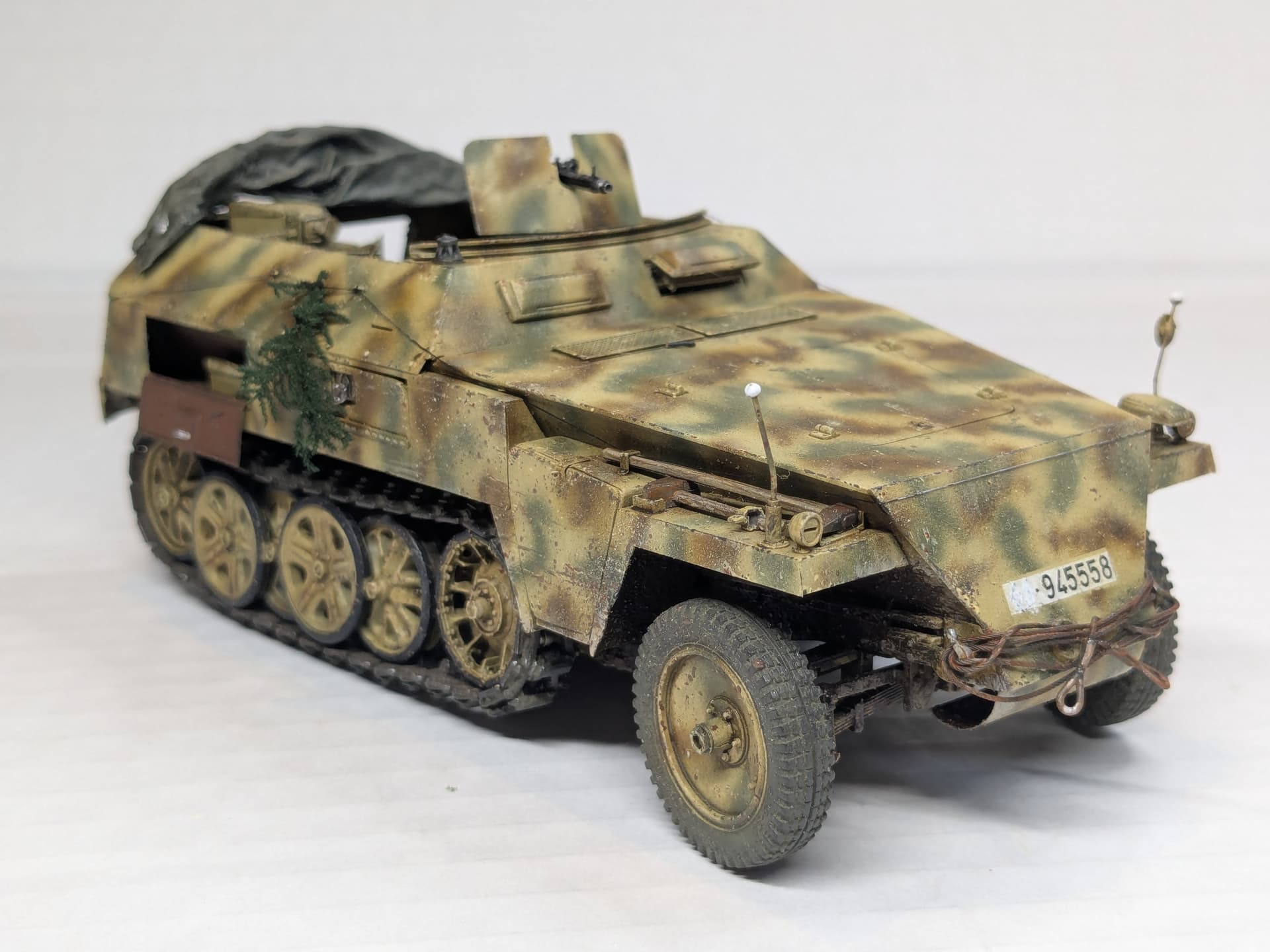

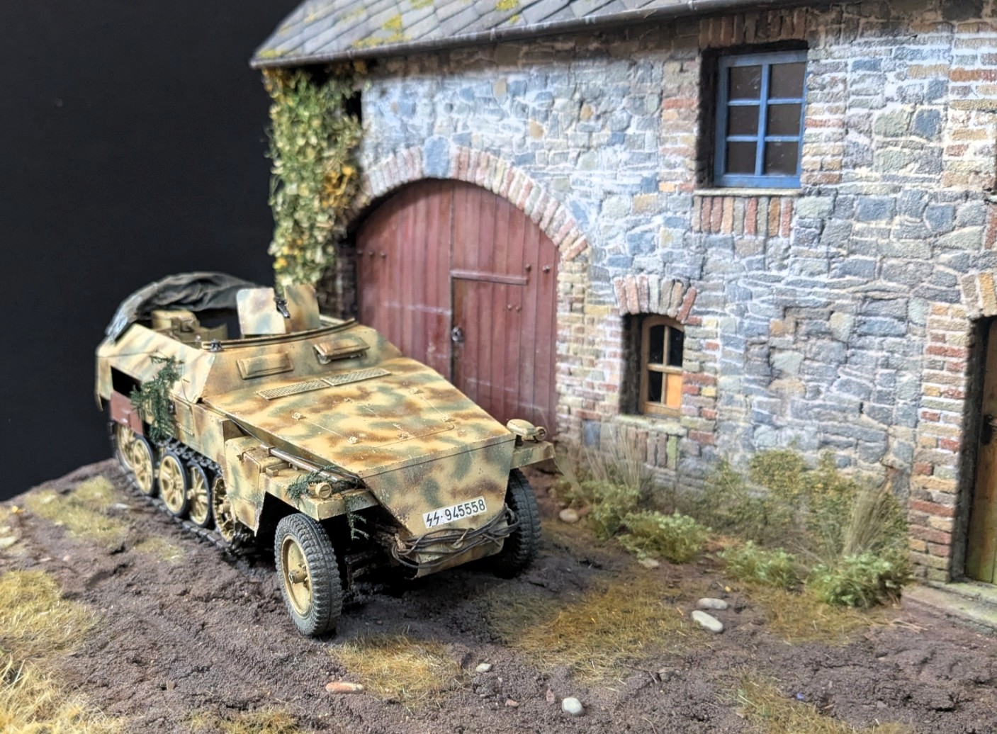

Before anyone gets too excited (including myself), none of the vehicles are fixed to the base and they have yet to be properly bedded in and weathered. But the 250 and Schwimm are more or less finished.
The Schwimm still awaits a painted driver (and hence a steering wheel).
The last bits on the 250 are a bit hard to spot…
The width indicators are from Aber. As for the towing cable, finding the right thickness of twisted wire was easy enough, but the towing eyes were a real challenge to track down. Eventually I found the right size in this excellent 3D printed set:
It’s clearly designed for Panthers, Tigers, etc - but the small eyes (presumably for the thin cable used to fit the track) are just right.
The aerial will be left to the last minute (otherwise I just know that I will break it) and there is still the rest of the foliage to be added.
It appears that 250s built this late in the war came with wires for mounting foliage as standard. They are clearly visible on the images I posted above and especially behind the handsome fellow in the shot below:
It’s also interesting to see how far the width indicators were able to bend!
