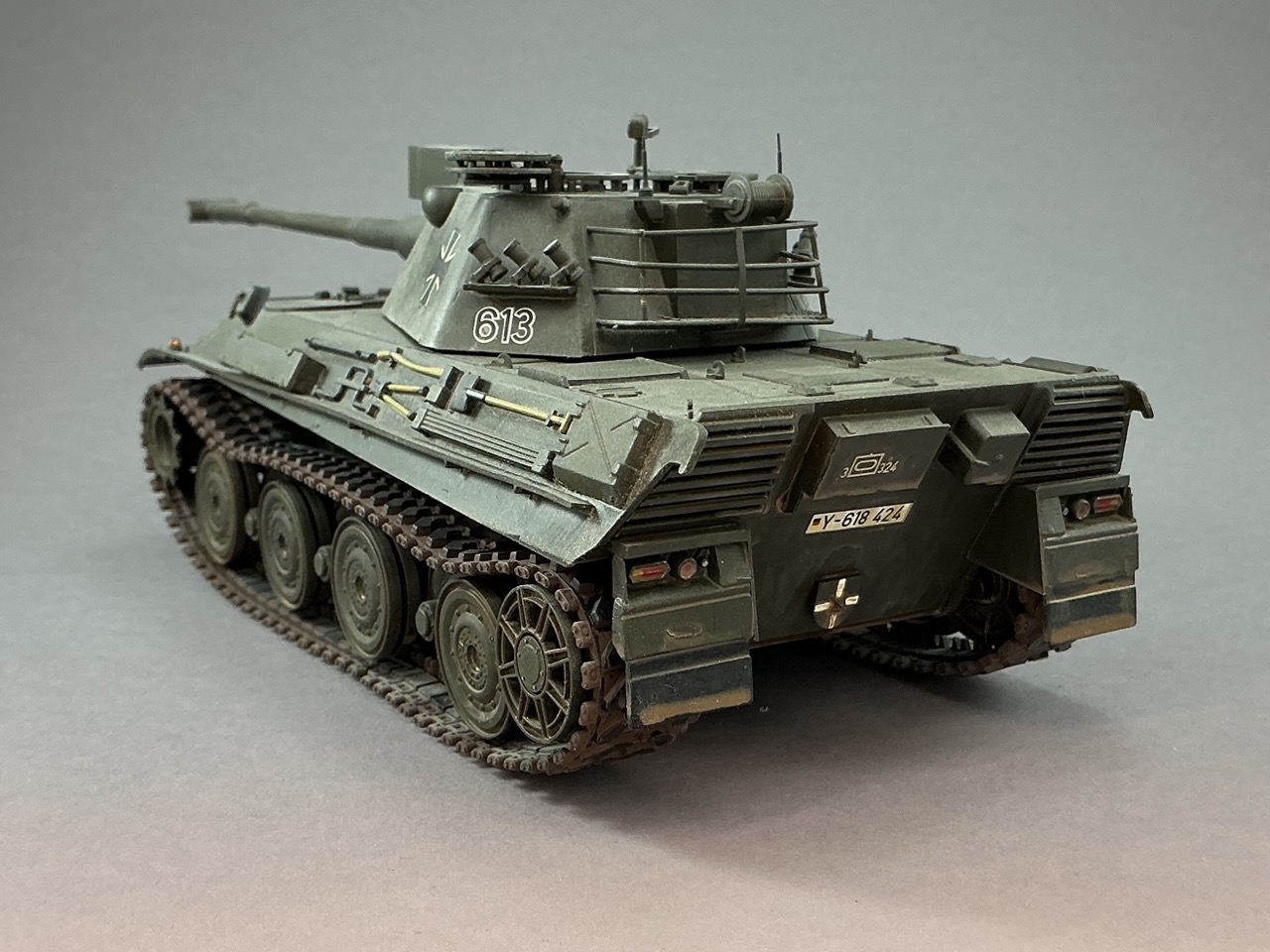

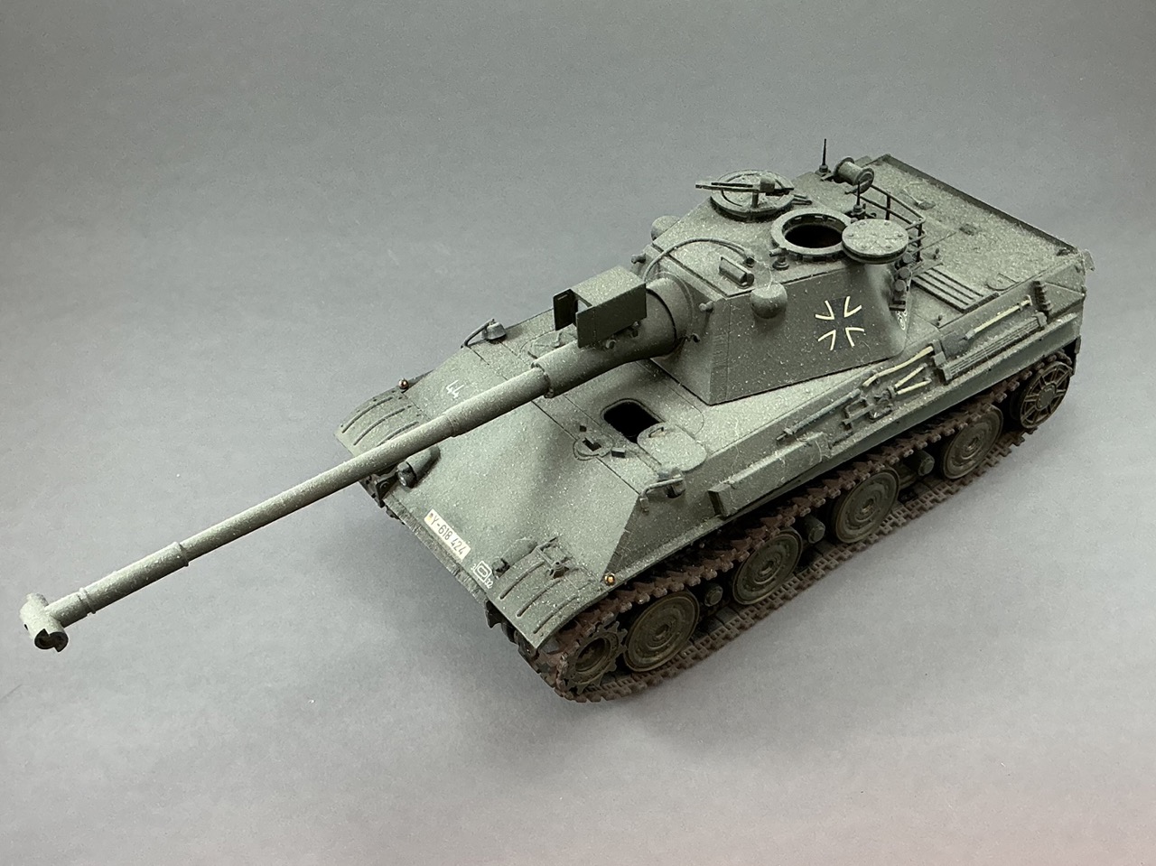

Aside from correcting the turret length and some minor stuff, I replaced the engine deck and hull rear by something reminiscent of a Leopard, the tracks by Leopard ones as well and added an M48 bore evacuator and blast deflector to the gun. I then painted it in Bundeswehr colours and markings.
Ye-ah - the tank that would be…
As per the one I did post :slight_smile:
I painted it as if it had been snowing.

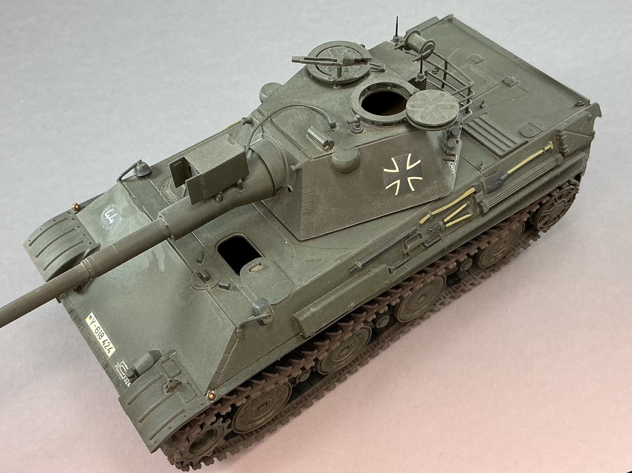

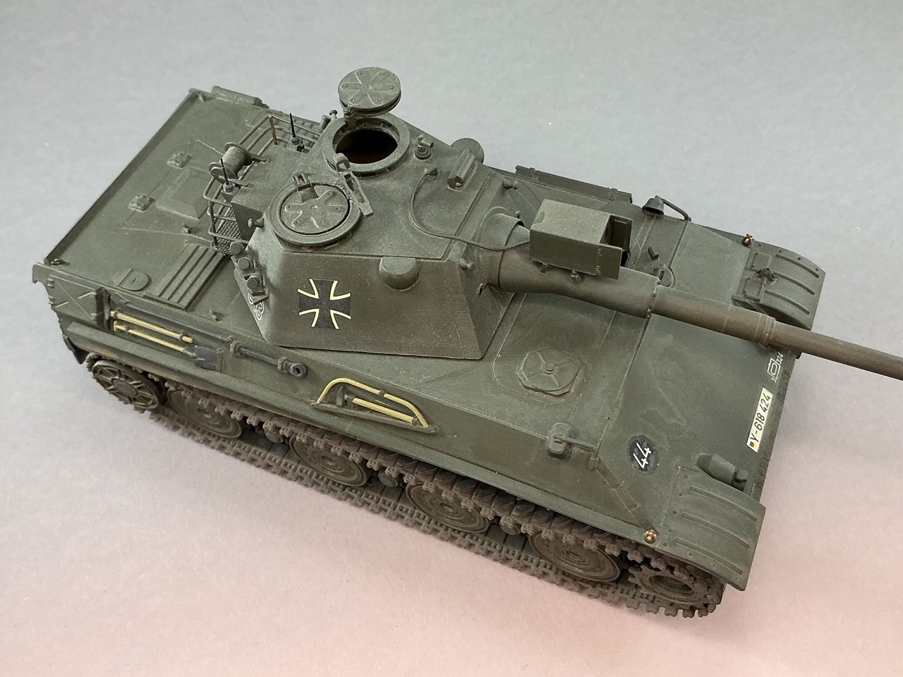

No, wait … that’s dust :wink: After some hard work removing the turret — it’s on very tight — and some less hard work with a soft brush, it looks a bit better:
I had done more work on this than I thought yesterday. The tracks and drive sprockets are not Leopard but from an Academy M48A5, whose tracks are far too narrow for an M48 but just the right width for a Panther. I got rid of the bow gunner, put Leopard hatches on the turret, smoke launchers from a kit I don’t recall, a gunner’s sight from a Tamiya Marder 1A2 (as it has a spare Marder 1 sight), tools etc. from a Leopard, Leopard 2 rear mudguards and lights, etc. The louvres on the engine deck are the cab window shutters from a Dragon MLRS, the fuel filler caps are headlight covers from a Dragon StuG III and the louvres on the rear are cut-down Leopard 1 parts. The vent above the former bow gunner’s position is the end of a Dragon T-72 or T-80 snorkel, the rack on the rear of the turret is scratchbuilt from plastic rod and some leftover kit mesh, the rearview mirrors also seem to be from a Tamiya Marder, and so on.

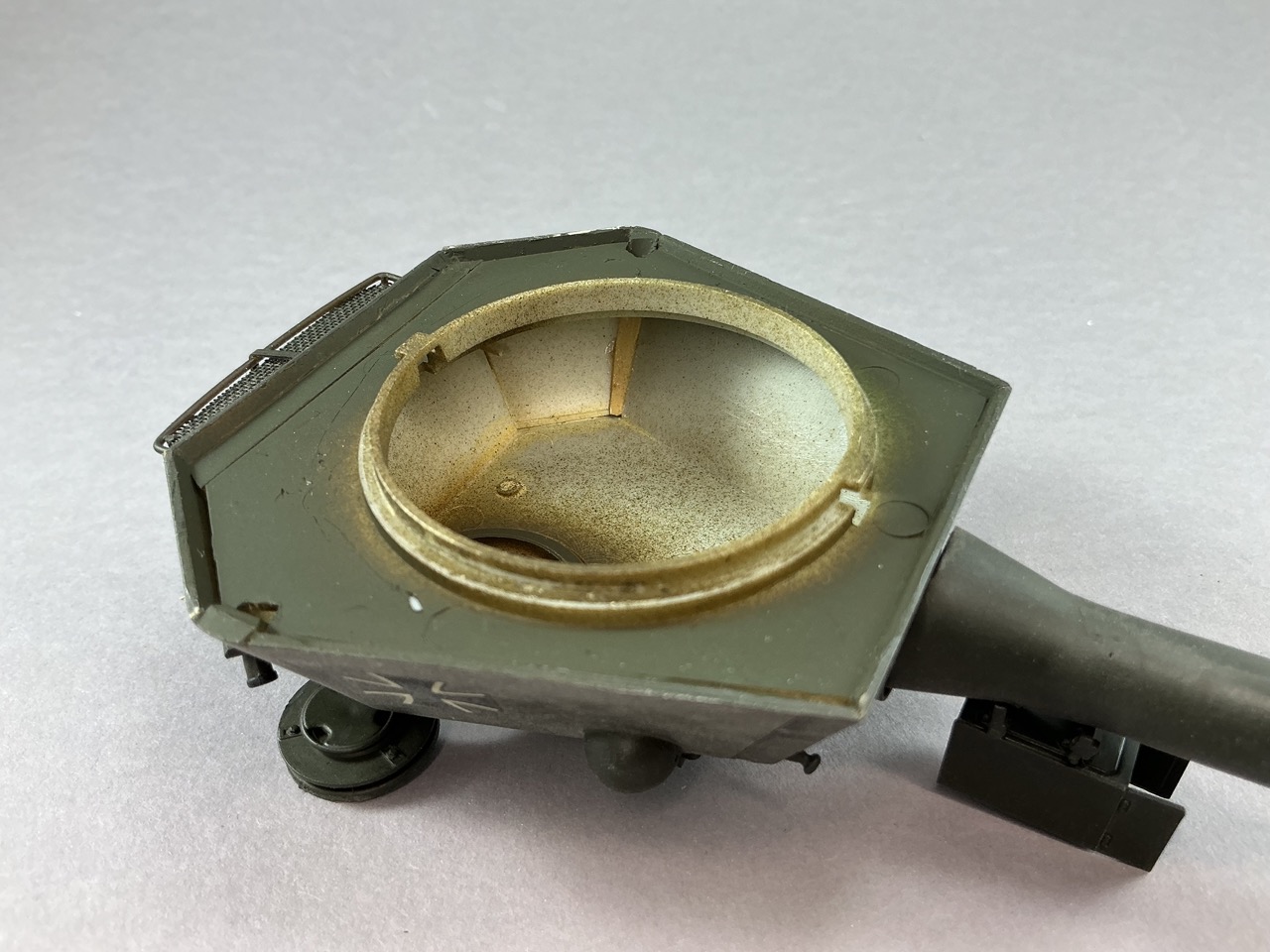

Here’s how I lengthened the turret:
I cut off the back just in front of the bend in the armour, used plastic card to make new rear sides and a rear plate according to drawings of the turret in an issue of Military Modelling and made the bend by glueing scraps of resin into the gap between the plates, then carving and sanding them to the necessary curve.
That really is excellent work - and I like the plausibility of it all; as though the Germans were saying to themselves, “Right, we’ve got a green light for a new Army, we’ll need some tanks, let’s see where we left off and what can be done with it”. So this re-vamped Panther comes into service to hold the ring while the designers at the drawing boards get on with the Standardpanzer Leopard.
Perhaps the Leopard is delayed - or there’s not enough to go round immediately - and this beast soldiers on until the mid to late 60s. Absolutely brilliant and well executed.
Well done Jakko - always with the plausibility(!)

What a novel “What if?” idea! All it needs is a Bundeswehr commander figure. :+1:

That was pretty much my idea, yes: What if they had upgraded the Panther instead of taking American M47s? The gun is intended to indicate this is an 8,8 cm that been adapted to American 90 mm ammo, BTW.
