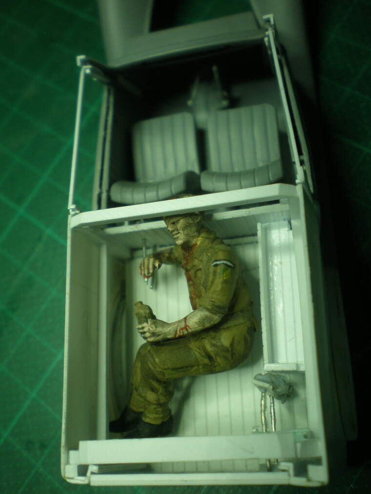

Meanwhile a wounded fugitive from Stalag Ersatzteil-box VIII chills out…
…an old timer from days of yore when Tamiya figures were more often 1:32 scale than 1:35, but he’s OK to stunt-double here for big Reiny…except there’s barely enough room left over for a box of trial-offer vials of floor polish, let alone crates & bottles. So perhaps the “Tatra van” identification is a myth after all, it just seems way too small.
Or… maybe I’ll concoct narrative item # 936, the lost detail from witness reports: “The driver shifted crates onto the passenger seat/floor in order to make room in the cargo space for Heydrich to lie down on his side.” Ffffornicated if I’m trashing all this scratchwork now :hammer_and_wrench: :tumbler_glass:
Genius! As far as the bum hitching a ride, there’s plenty room, he just needs to go fetal.

That guy must get a rather big headache when the car will drive over those cobbles…
Big dude,small car. Another alternative could be the cargo was hastily thrown onto the street to make room? That would be the field expedient method to me?
