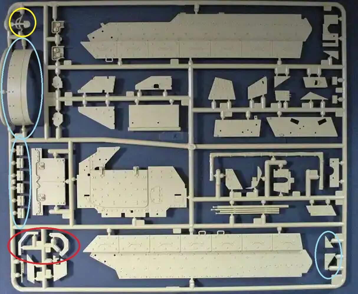

All the update parts for an A1 version are on the E sprue from the Tamiya M2A2 kit (35152) and M2A2 ODS kit (35264) but are not in the original M2 kit (35132).
Tamiya M2A2 E sprue.
The Red circled parts are the guards for the driver and TC vision blocks. The Light Blue circles are parts for the larger turret storage basket. You can also add the turret antenna guard circled in yellow.
Good; then Sprue E is what I need. Not just for the vision block guards, but also for the bigger Stowage basket. So I’ll have to add the covers, then rip out the older stowage basket and add the bigger one, then repaint. Nothing too difficult to do; still have plenty of XF59 paint.

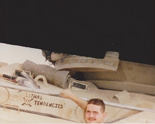

You can see the barrel sticking out of one port in this pic (yes thats me with the captured Ak
As far as upgrading the kit, I mainly added the guards over the periscopes and antennae guard. We still had the original turret basket as seen in this pic.

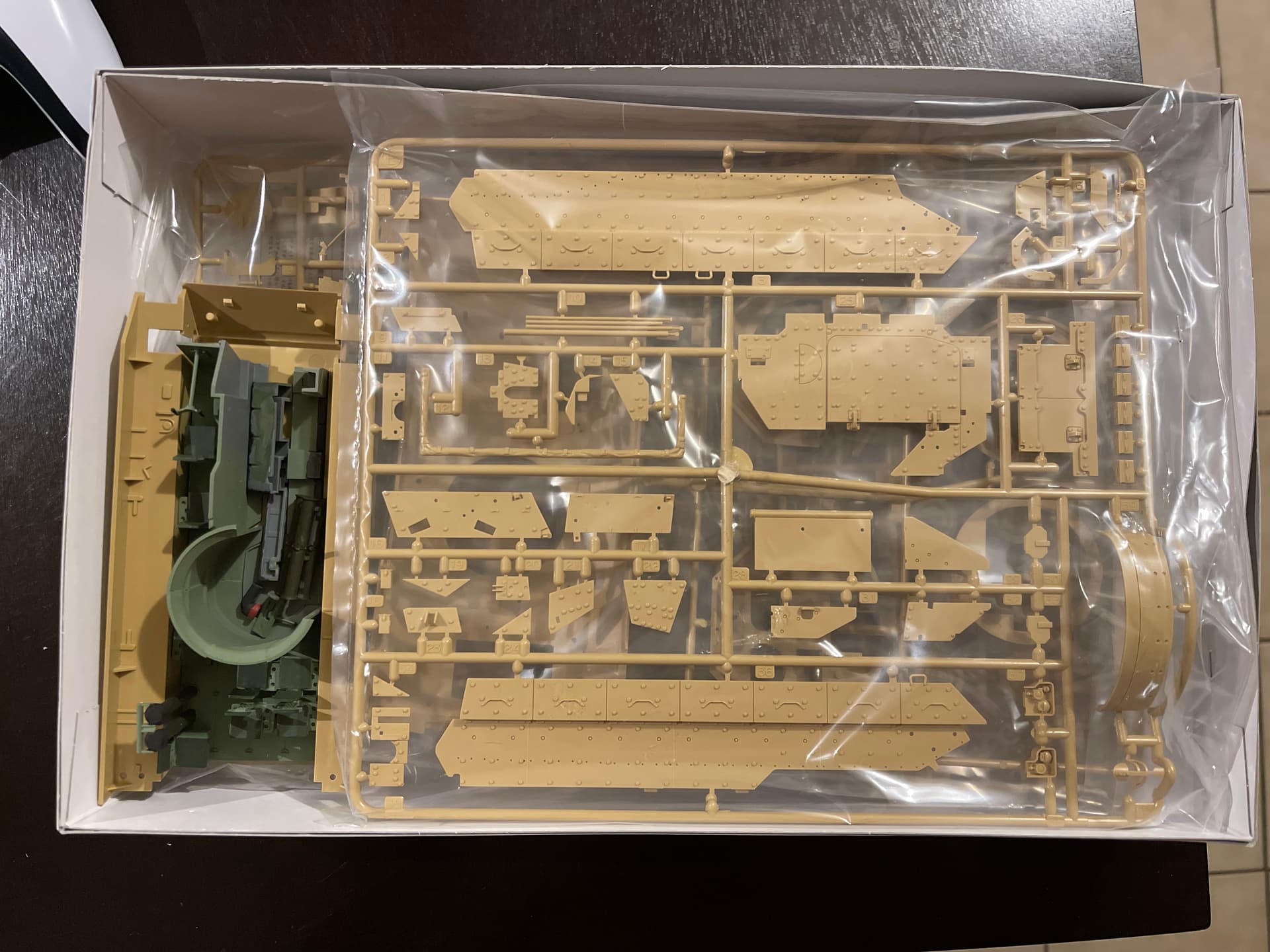

Found the kit in my stash.

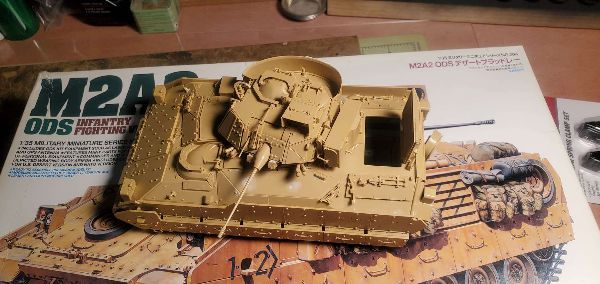

And the parts tree needed for the M2A1 update. The painted interior is from the base M2 kit I built. Went “buttoned up” on the kit and will use the interior on the M2A2 build.

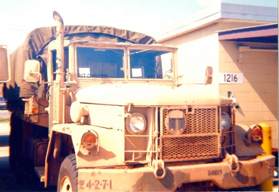

As for my personal ride while with the division; I was a supply clerk, so I drove an M35A2 truck, which I built using the AFV Club kit, long ago. Sadly no pictures. I may yet to build it again.
