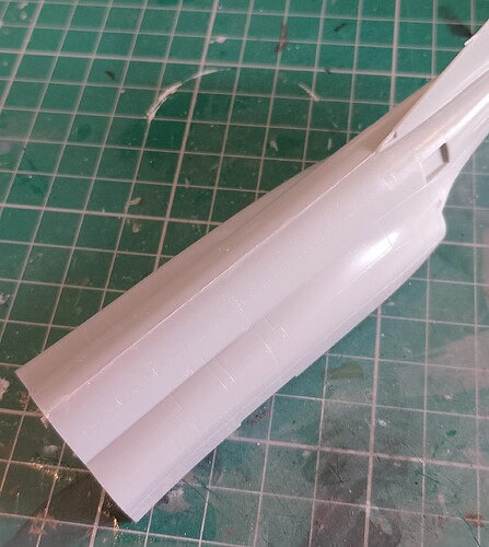

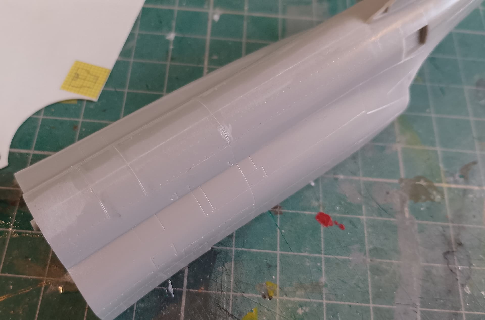

A little tidying up the rear fuselage today.
The details along the spine are quite poor compared to the rest, a limitation of the moulding process. They get so far and vanish! Ordinarily I wouldn’t worry, but the refueling socket hatch is quite prominent on the Air Force versions. I have a plan though.
First step, rescribe the panel lines.

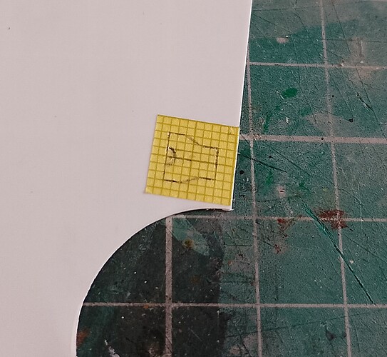

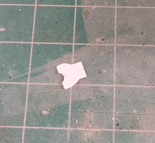

Then, draw out the hatch on some Tamiya squared masking tape, using some plans as reference. Then stuck to the thinnest plasticard I have.
Cut it out and sand the reverse to thin it out even more.

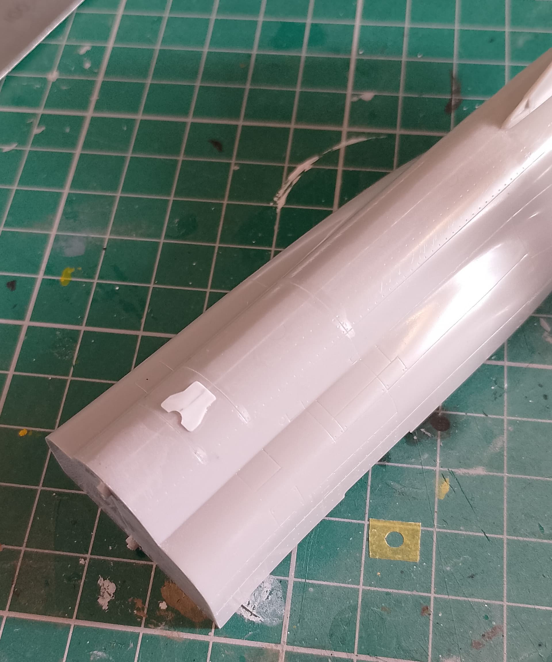

Then stuck to the fuselage with Gunze ultrathin.
It’s sitting a little bit proud so I’m going to leave it overnight and give it another sand.
It does occur to me now though that I could have fixed it with a more temporary glue and just scribed around it, but you live and learn. Will do that the next time.

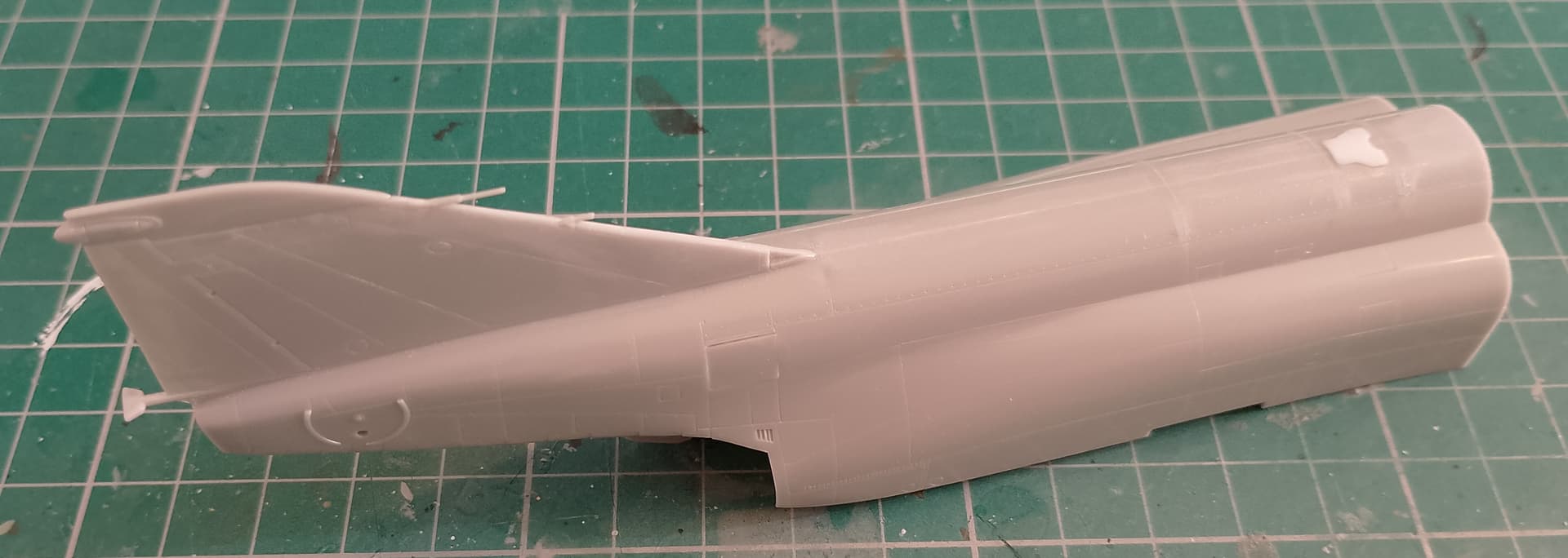

Managed a bit of work on mine tonight.

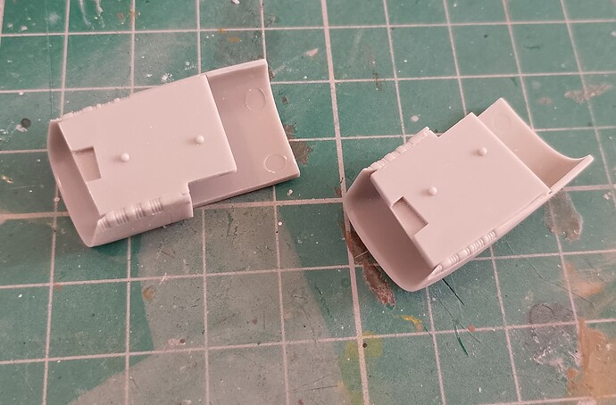

Got the fin top and covers for the RF-4 photoflash ejectors in place. Fit was a bit sloppy, especially on the covers so they’ll need a bit of work. I remember having the same problem on the J boxing a few years ago.

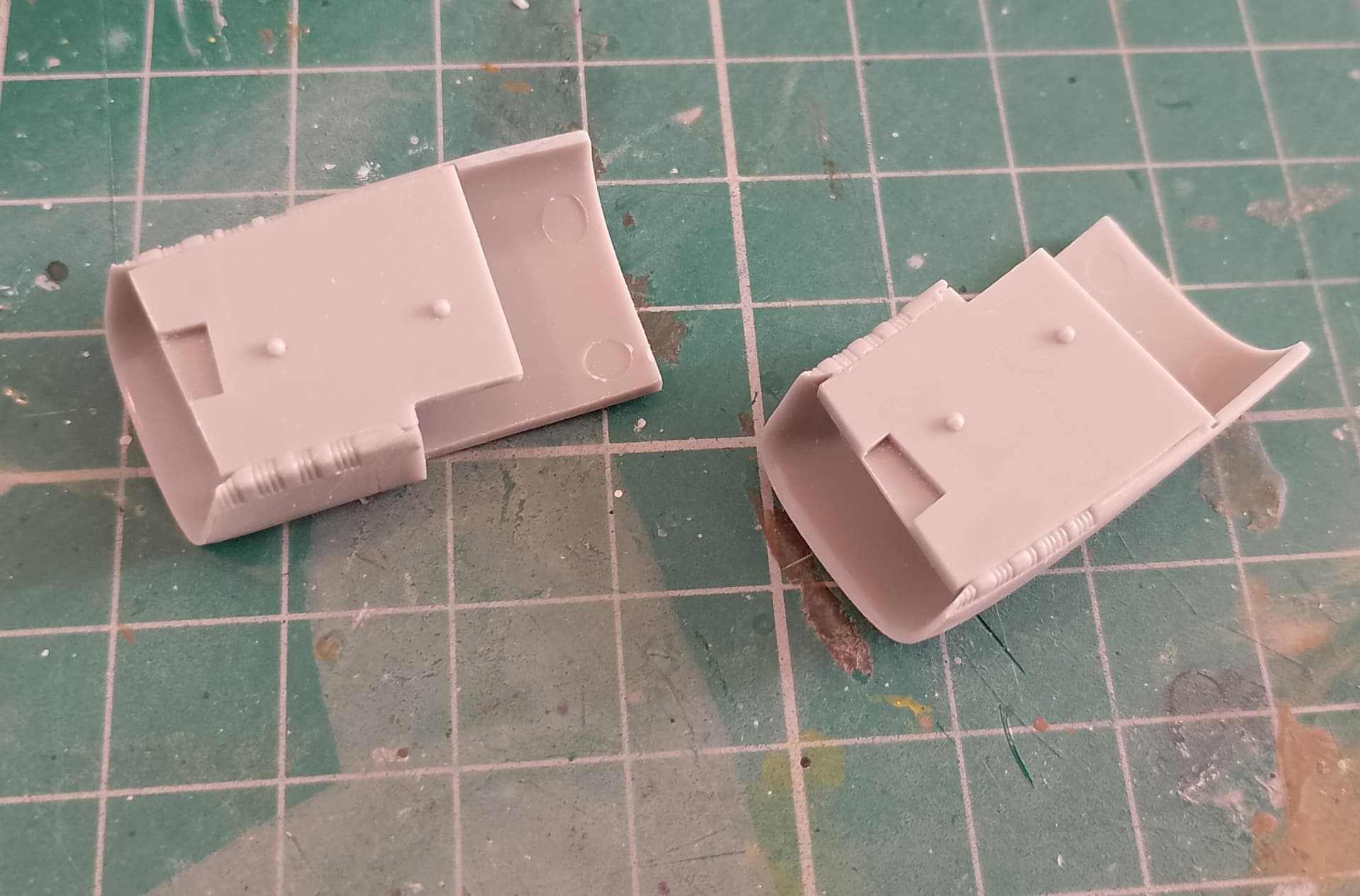

And got the intakes cleaned up and together. As I’m fitting FOD covers, I didn’t do anything more than necessary here. I’ll fit the splitter plates during final assembly as it makes painting behind them easier.

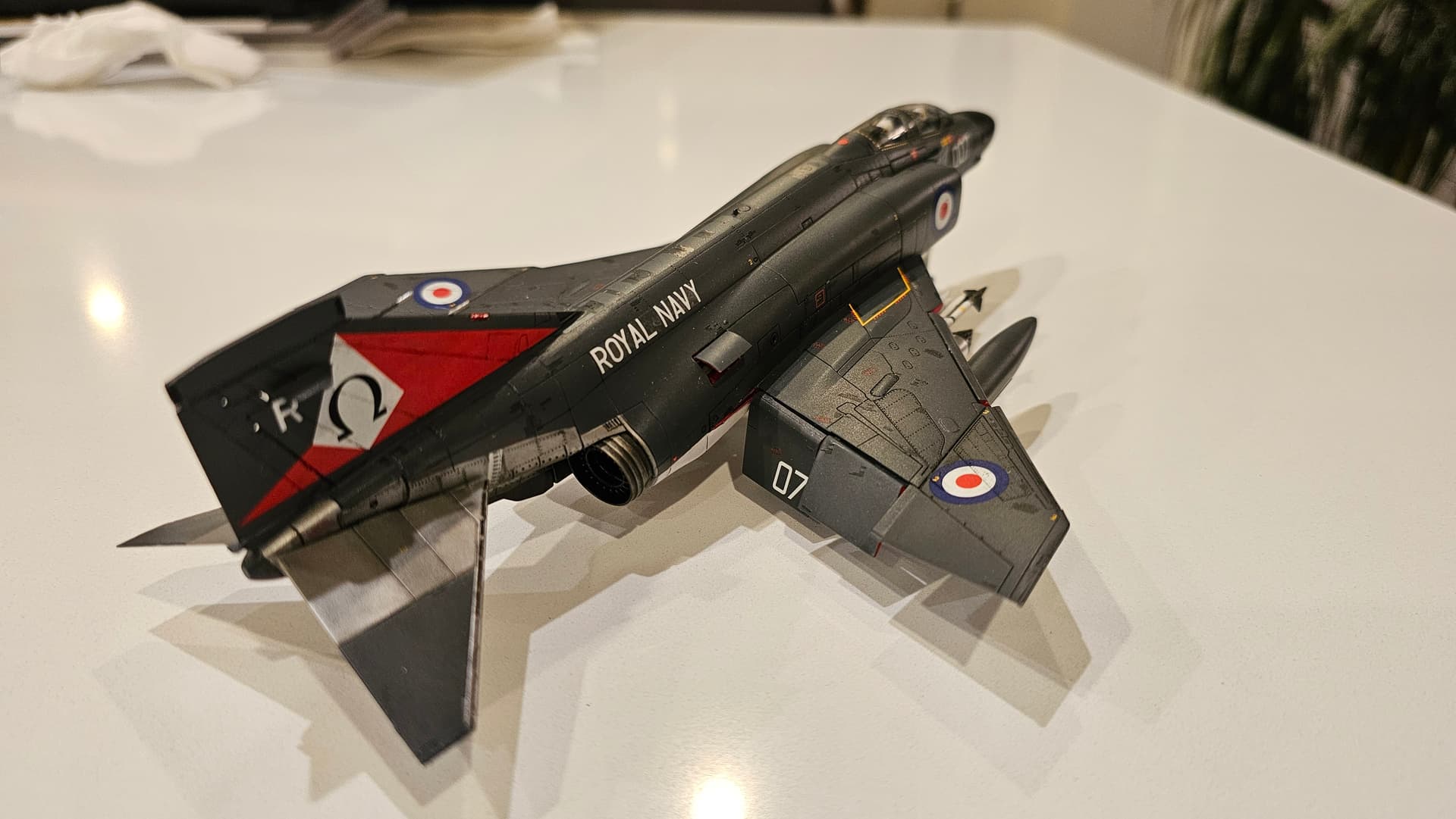

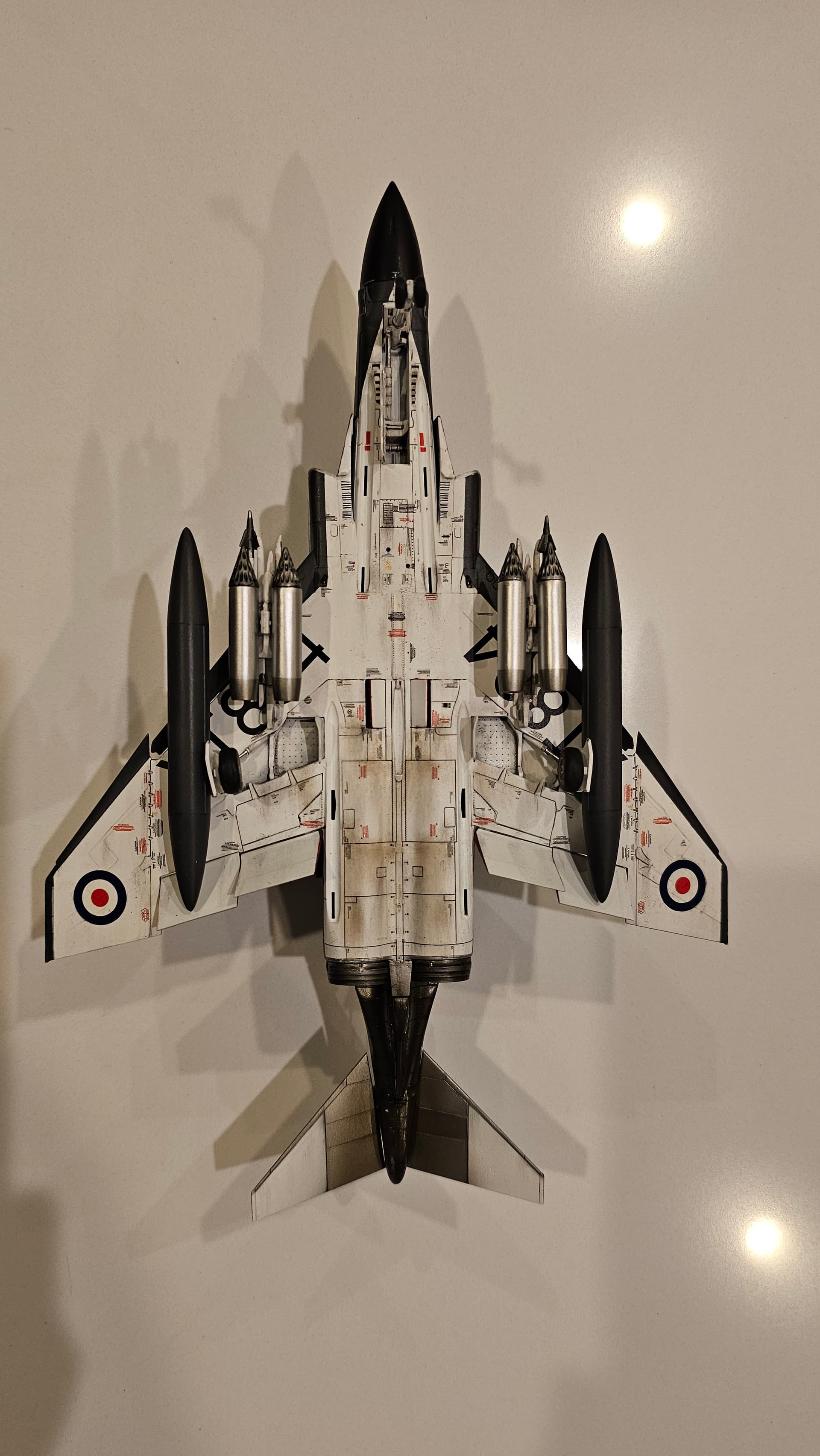

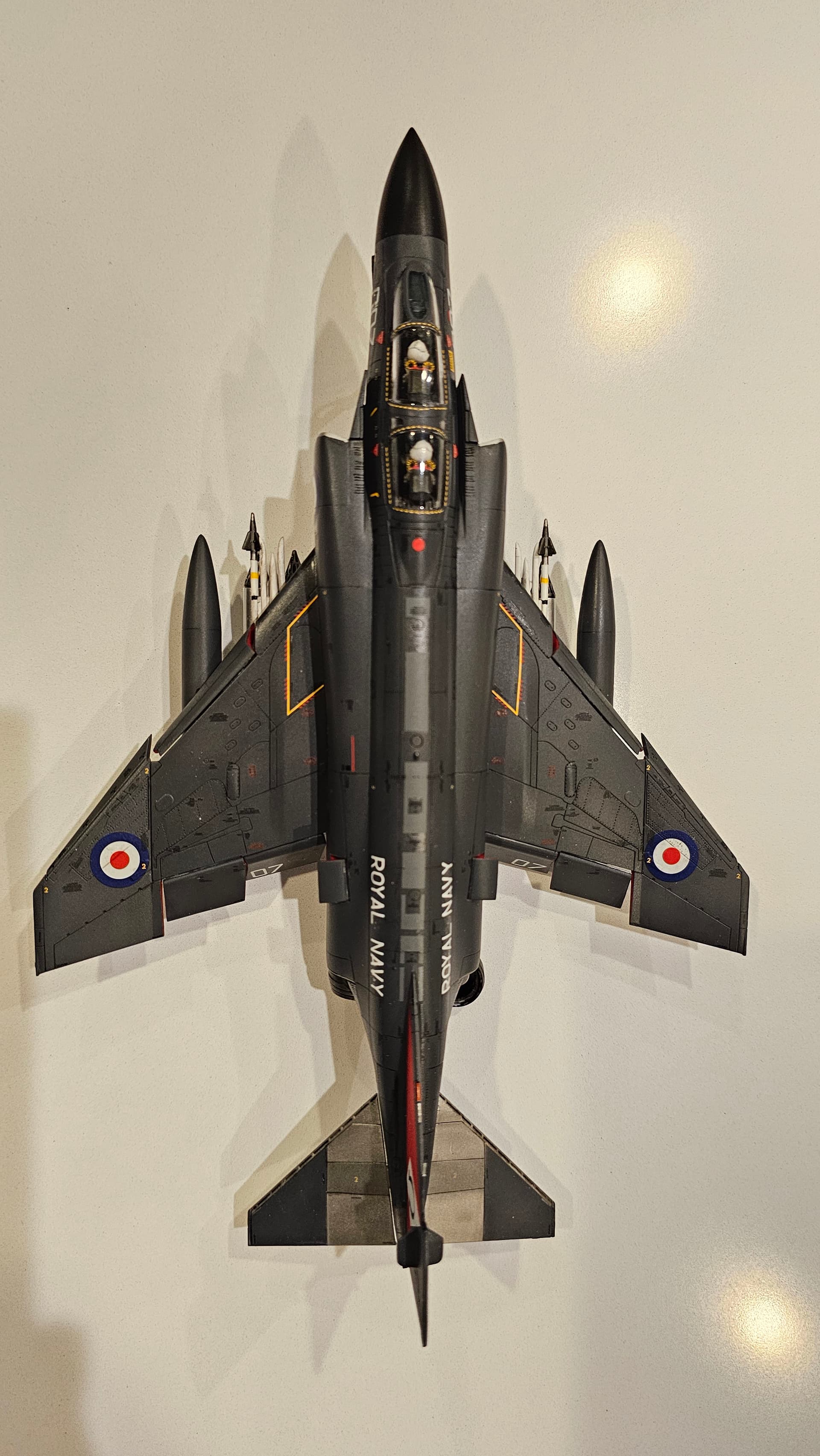

The FG.1 is done in it’s launch ready position. Since I have a little time left, I might be able to add a hooked up launch bridle, but still looking around for a good photo reference. If I don’t get to it in time, I’m still pretty happy with the outcome.
Nice!!!
