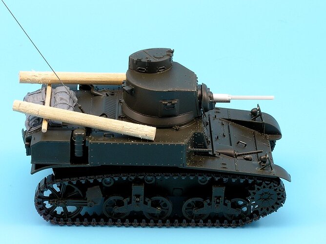

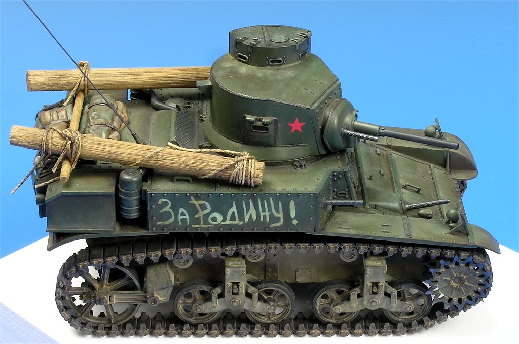

Over the last couple of months I assembled three older Tamiya kits so that could practice painting and weathering techniques and try out a few new ones.
Here are the three Stuart based kits that I’ll be practicing on…As you can see these are quick Out-Of-the-Box builds with only minimal additions for stowage. I did have to scratch build two gun tubes as the originals where lost somewhere.
First up will be the M3 done as a lend lease to the Russians

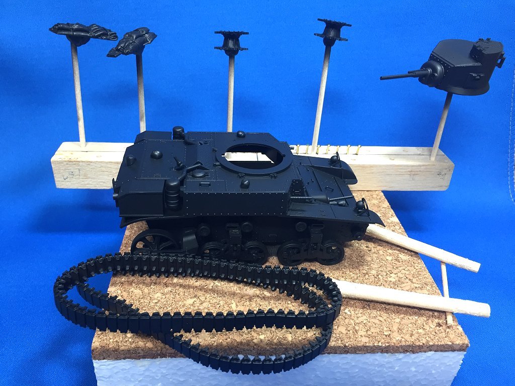

I primed the kit with a flat black rattle can picked up from my local Hobby Lobby. This stuff is actually really nice and self-levels. Just had to make sure not to flood the surface with the paint.

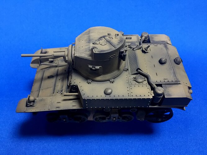

Next up I laid down a base color with Mission Models OD. After letting it dry for about an hour I did some lite chipping with water and a brush. The chipping looks more like paint rub which is how OD reacts so I was generally happy with the effect.

Stuart, Stewart & Stewert :slight_smile: That’s a Honey of a collection:)
Very nice with the paint and look forward to seeing more.
Your approach with the water used for chipping (w/o magical chipping fluid) is really good. I wonder if similar technique would work using MiG, Vallejo, Gunze or AK acrylics.
Nice result so far, waiting for your next uploads.
Tamás
@Armor_Buff: Thanks Sir… :laughing:…I see what you did there. :partying_face:
@Agriamodeling: Thanks sir but I can’t take credit for coming up with the use of water that goes to Master Mike Rinaldi. Not sure if this will work with other brands but it might…results may vary.
Those kits are perfect for that sort of project. Quick simple builds and ideal canvases for weathering projects.
I think that is for Mission Models. Many club members have talked about MM paint lift off applying decals if they are coated or not. Only adding their binder did it prevent water lift off. Hairspray and water can be used to create chips.

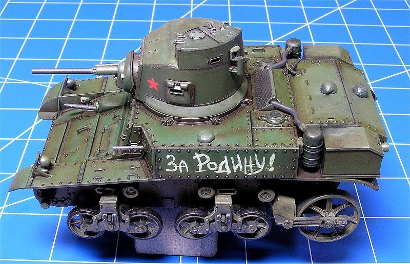

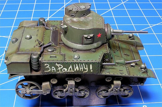

Did a bit more work on my Practice Stuart. Repainted the upper hull and turret a 4BOish color then added a slogan and little red star for affect. Applied a pinwash using a couple of Ture-Earth products. Then started the oil rendering on the turret top.

What does the slogan translate to?
“Death Trap”??
@joepanzer: :grinning_face_with_smiling_eyes: It could for all I know but I use this to pick the slogan

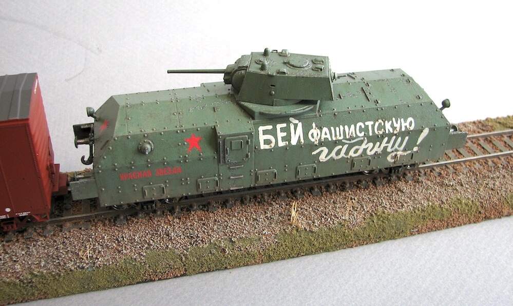

I’ve hand painted one of these slogans as well. 1/72
It says “For the Homeland”
But I think it’s closer to “For Russia”???
Such a clean, tidy and organized work space- I always end up working on a tiny corner that isn’t covered in tools, paint, plastic and any number of other bits and pieces!
I have to say I really like the weathering work you’ve done on this- the green has a lovely hue and the pin-wash has brought out the details beautifully. It should look ace with the oil rendering.

@Karl187; Thanks Sir…but it doesn’t always stay that nice and tidy :grin:
@KoSprueone; Nice work on your slogan, it look better then mine :+1:
@joepanzer; I wouldn’t be surprised if what I used wasn’t correct. “For Russia” makes more sense. :thinking:

Very kind words, Thanks! Your weathering/filtering skills is expert level.
This model looks yummi! I like very much how you achieved a “metal subject” look - it is very impressive.

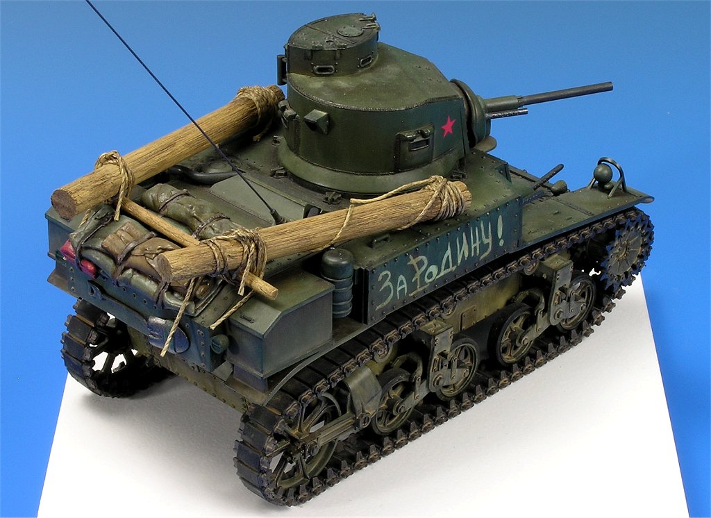

Wrapped up the first Practice kit and overall happy with the way it turned out. Moving on to the next one which will be an M5 Stuart so stay tuned.

Very nice and realistic looking model! Your arsenal of colors is amazing.
Thanks Sir!!
I think I could do the same effects with less stuff and that’s the goal for the next Practice kit. Going to focus heavily on the bacon on weathering…Oils!!
