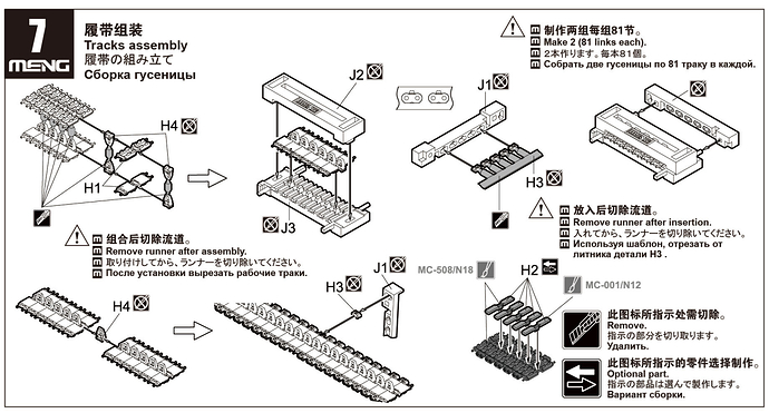

I’m starting on a T-90A kit from Meng in 1/35 scale. It will take me quite a while since there’s nearly 1,500 parts. I’m working on the tracks as relaxation. Below is an illustration that clearly shows a “pad” of some sort, presumably steel. I have been watching some youtube videos of this kit being built and there are not many, even fewer in English, but the ones I’ve seen the builder is leaving these off.
It is clearly an optional part, I assume it was used on roads/highways that the crew would remove when offroad? In the instructions (below) it is part H2. If I use them these will not be “cement free” :slight_smile:

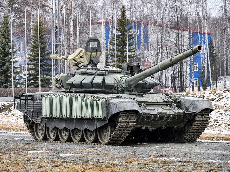

Usually rubber pads are used on hard (paved) roads. All steel tracks do just fine when off-road and on soft-surface roads. It appears the rubber pads can be removed when not on roads and are listed as optional in the instructions.
Double pin tracks is what most modern Russian tanks use now; like the T-72B3 and the T-90MS.
as Gino pointed out, the rubber pads are used mainly for driving over paved roads.

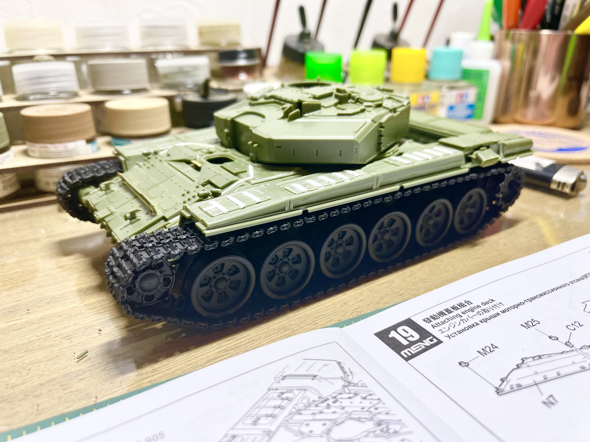

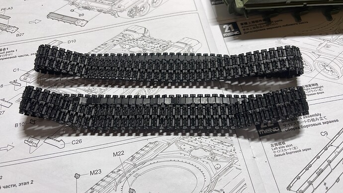

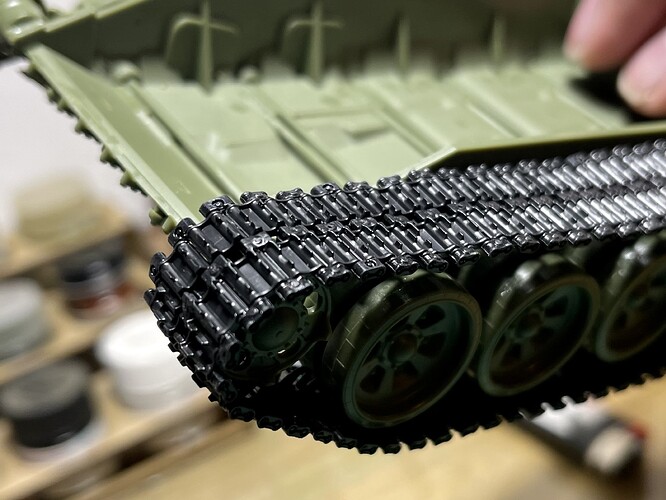

However, I will add that my experience with Meng kit tracks has not exactly warmed me to wanting to build more of them. These look like the end connectors don’t need glue, but you’ll want to build a section to test that before cleaning up all of the parts and only then discovering you need two drops of glue on each connector, or something. Because if it does turn out that way, you can still ditch them for something easier without having put too much effort in :slight_smile:
From the limited sections I’ve built they seem to stick together pretty well. Maybe not if you are playing with them like the GI-Joe dolls. The end-links are a flexible black plastic, they slip pretty well over the hard plastic “pins” and the tension (rubber-band-like) holds them in place.

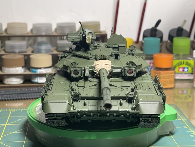

I built the Meng T-90A and i used those tracks. They do build neatly.

See what I mean Jakko? Those end-links really work well.

It does look like it, yes. AFV Club, Trumpeter and others do much the same for their track sets but in hard plastic, which works really well if the dimensions are just right. OTOH, if they’re off, especially if the holes are too big, the best solution is to buy a set from a different manufacturer. Soft plastic solves that problem, but I do kind of wonder how they will hold up in the long term. I kind of fear some will tear from the tension eventually, or go brittle and break.
Oh, BTW, they’re called “end connectors” :slight_smile:
As far as tension,they’re not tight, they just kinda lay on the wheels,like Fruils.my T-90 is at least 8-9 years old with no problems yet.
Speaking of track tension/sag.
THis is how the tracks sit on the tank. If you like some extra sag? Just add one track shoe and it should sag nicely.
