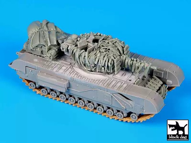

Question for Blackdog 1/72 Churchill tank
Which specific Churchill variant is the Black dog resin model kit designed to represent? Apologies for my lack of knowledge regarding the Churchill tank series…
It’s supposed to be a Mk IV…
ahh I got it, thanks
Quick Churchill recognition lesson, then :slight_smile: It has rectangular side doors, which makes it not a Mk. VII or VIII, as those had round doors. It’s also not a Mk. I, II or V because the gun is a 6-pounder[1], so that leaves a Mk. III or IV. It’s hard to say from this photo, but if the turret is angular it’s a Mk. III while if it’s cast then it’s a Mk. IV. From the full box art, I conclude it’s a Mk. IV :wink:
You could add a muzzle brake to the gun to make it a Mk. IV* (with 75 mm gun), or add a muzzle brake, a small plate on the lower right side of the turret and an extra antenna mount on the rear turret roof to make it a Mk. VI.
(Note also that whoever built the kit for the Black Dog box art, put the air intakes upside down … And the amount of stowage on the back deck is ridiculous. The crew would never be able to service the transmission and have a difficult time with the engine. Even more importantly, they can’t even refuel the tank or top up transmission and engine oil without removing half of that pile of junk.)
  1. The gun has no muzzle brake, but is too thick for a 2-pounder ↩︎
AFAIK, Black Dog stuff is not renowned for its accuracy :roll_eyes:

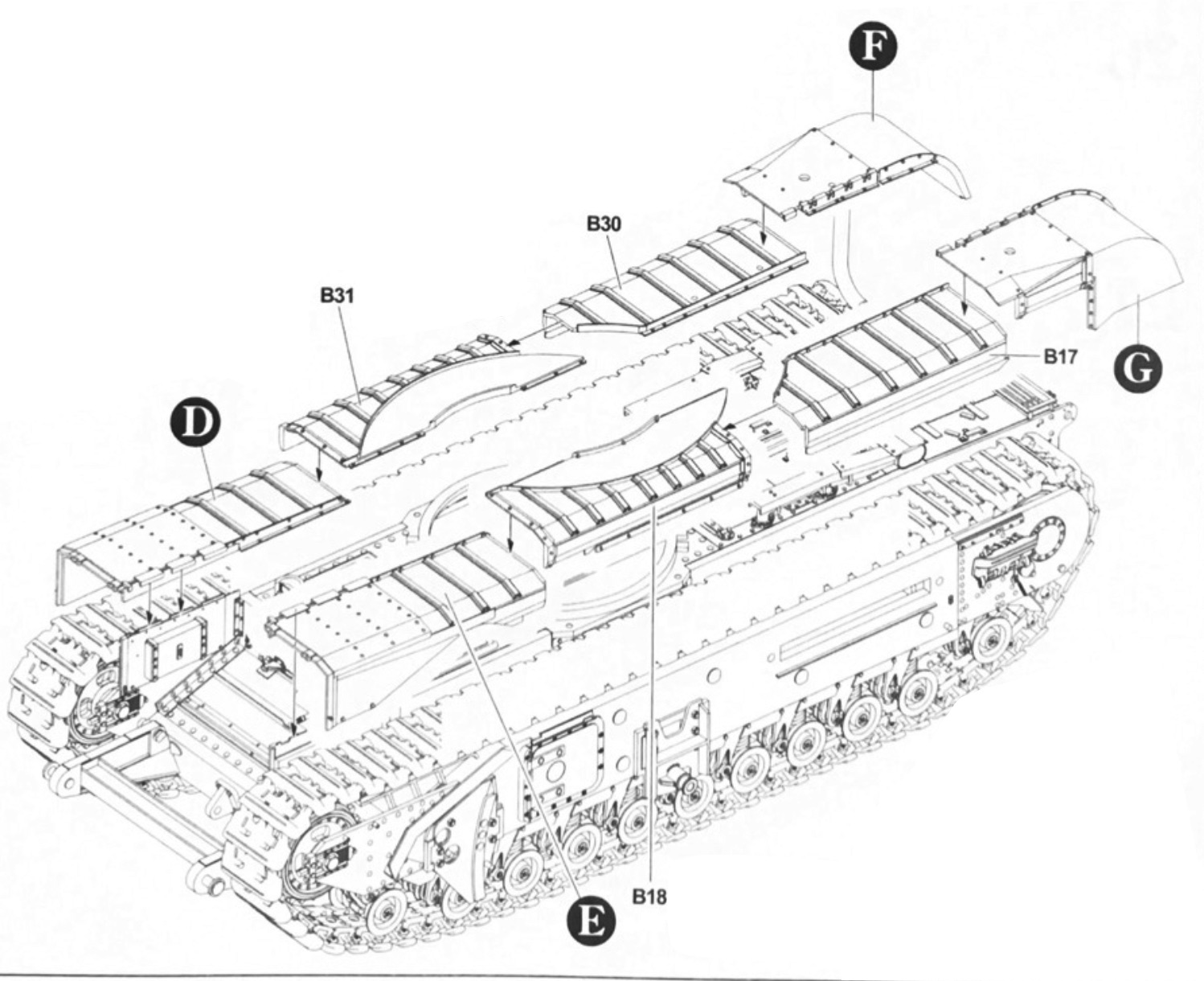

Churchill mudguards are very complicated things :slight_smile: Rather than try to explain it in words, I’ll just show this diagram from the instructions of an AFV Club 1:35 scale kit:
There would normally also be rounded sections at the front, like in the box art for the Dragon Mks. III and IV NA 75 you posted earlier, but crews often removed them. The centre sections, parts B18 and B31, were also often removed in muddy terrain, because mud built up under them, which eventually would push these sections upward against the turret, jamming it.
