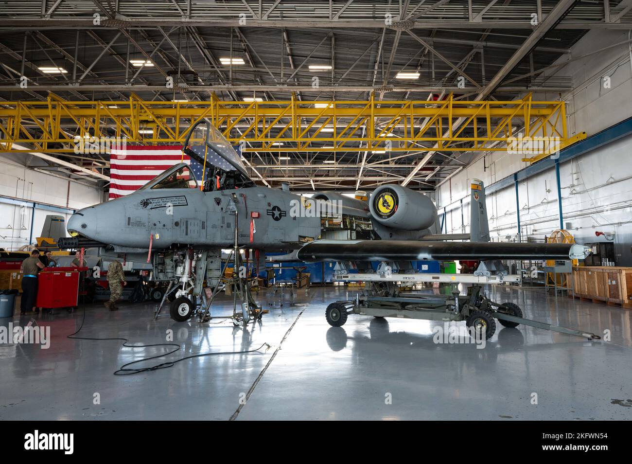

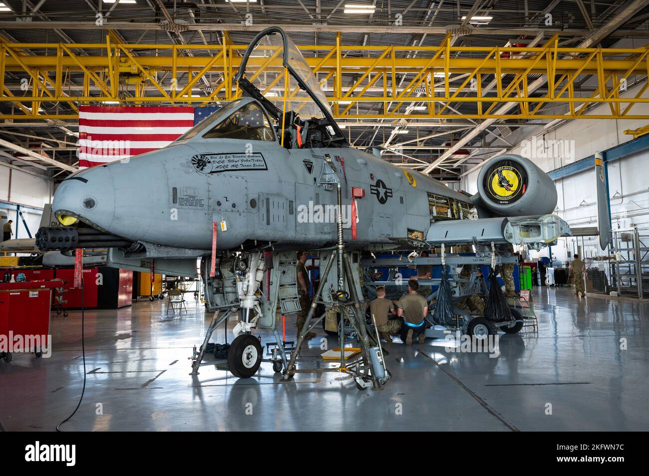

I’m building a diorama of a Maintenance hanger with an A10 warthog being serviced in 1/72nd scale.
But unfortunately I’m trying to scratch build this item and I don’t know what it is, can anyone please explain to me what it is called and what it’s used for?
It’s the yellow structure.
Thank you.

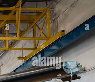

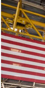

Looks like a gantry crane to me but I could be wrong.
Yellow to make it visible.
Travels along those hefty girders on each side.

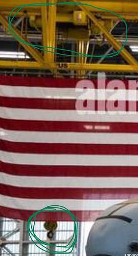

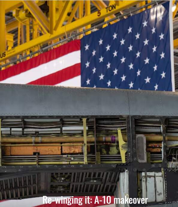

Wheels are “hidden” inside the yellow box structure:

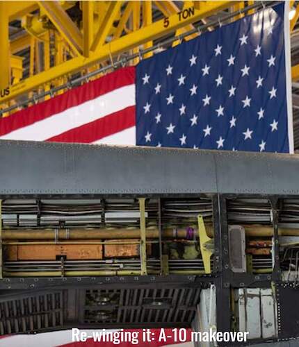

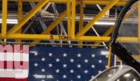

5 ton lifting capacity??

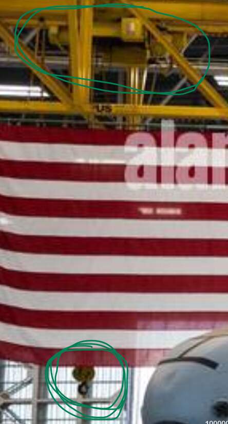

Winch and hook:
Better view of the winch
Yup. 5 ton capacity

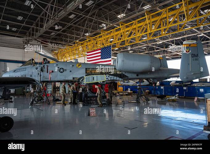

it’s a crane, no doubt. It is a common feature in many factories. The crane itself (the big yellow structure) moves in one direction on pilars along the wall. Then there is a trolley on the yellow structure that can move in the other direction. This way, every position in the hangar can be reached.
have a look:
