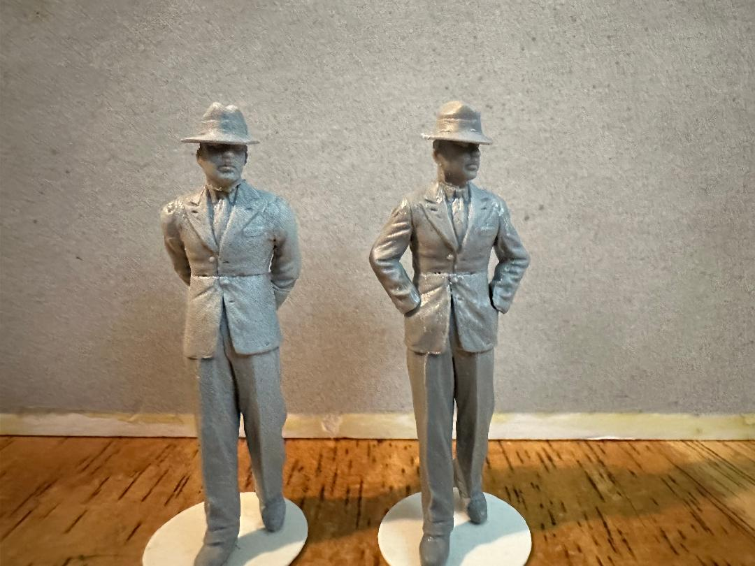

Anyone recognize Mr. Selfie?
Edit: Once again the camera helps. Did this one late last night. I forgot to do his left shjoulder completely, and still need to remove a mold seam.
You can see the process better in this photo - the guy on the left has had the goo added. Now all I need to do is file off the excess. There were some huge joints to fill because of the different arms.
