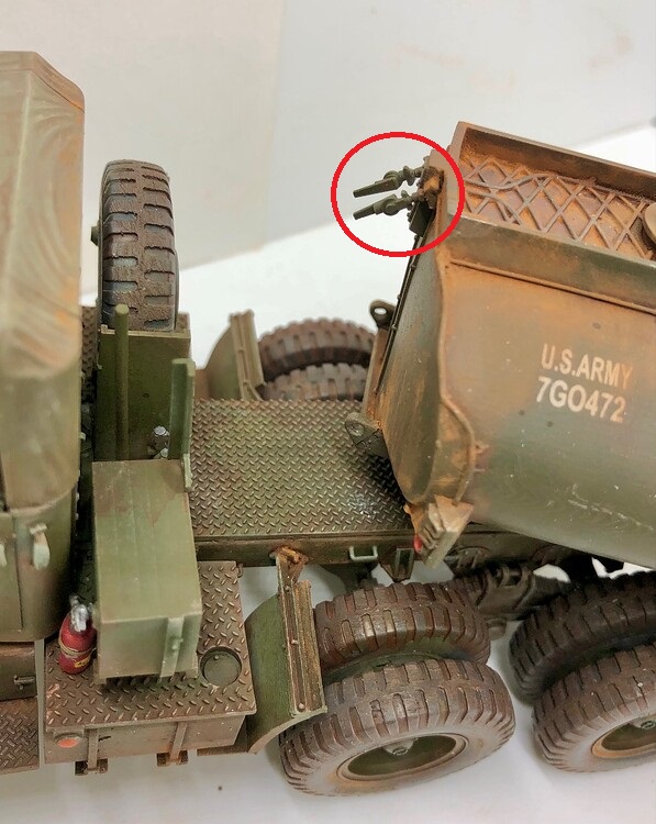

Currently building the AFV Club M51 Dump truck converted to a M52 (Hobby Link Conversion) with the M132 Tanker trailer. Stuck as I know there are connections of various types (air hoses, electrical connectors, chains, etc), but I can find little reference photos showing how they attach. Looks pretty empty. Hobby Link has end connectors, but no instructions how to connect. Found plenty of modern truck pictures, but no Vietnam War era photos.
Any suggestions? Thanks in advance.

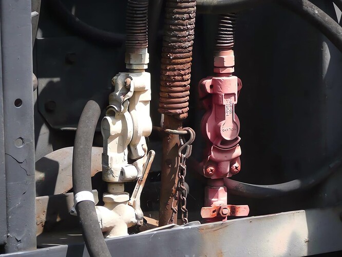

Frenchy’s photos show it well. There are two air lines with end connectors. They were usually red and yellow on Vietnam era trucks.

These ends attach to the two sticking out of the trailer front. However, the two on the trailer have caps on them which have the long handle pieces. These need to be replaced with just the ends like on the hoses.

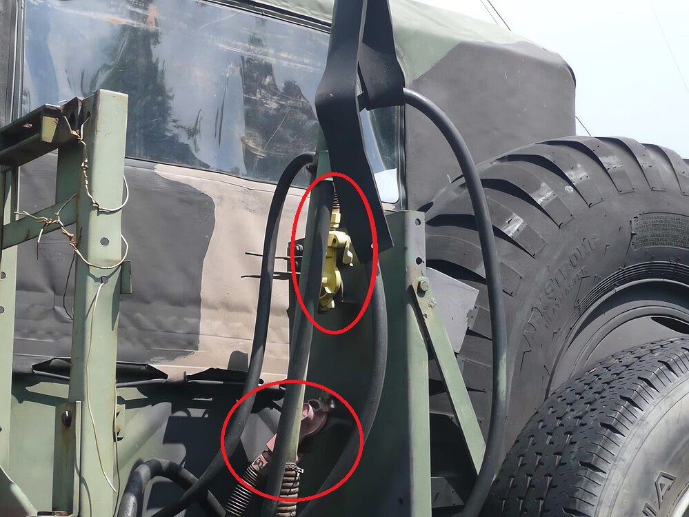

There is also a cable for the rear lights that attaches below/between the air lines on the trailer. This cable comes out from under the deck next to or between the air lines.
3
It is the cable hanging down below.
Looks like this connected on a similar M932A2 and M872 trailer.

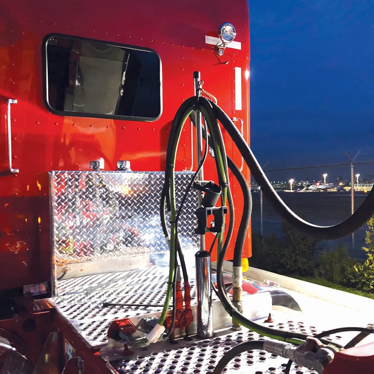

And let’s not forget the “pogo stick”. Very fashionable among truckers in the seventies, the civilian trucks don’t use it much anymore, but the military trucks do. It’s that vertical post behind the cab with a spring in its base. Air lines are clamped to the top of the pole and then go to the trailer. In a tight turn the pogo stick bends to extend the air lines, and when the trailer is straight again, the pogo stick straightens and takes the slack up.
I believe you have it on your model, too:

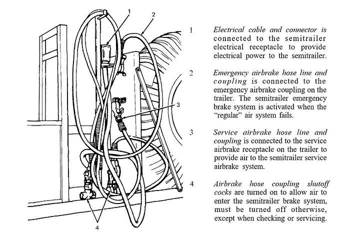

Did you look in the technical manuals, like TM 9-8028 orTM 9-2320-211-series?
You will probably have more success looking for an M131 semitrailer than M132. It’s TMs were the TM 9-2330-208-series or TM 9-2330-272-series.
