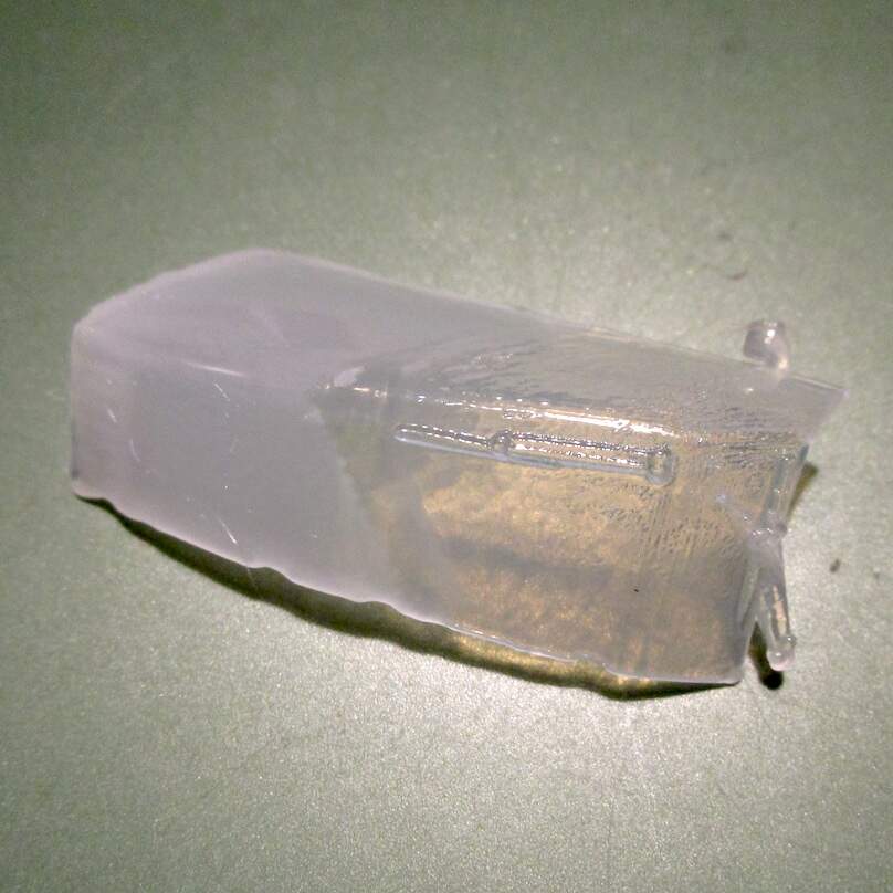

I’ve recently used lacquer thinner to remove and control some Future during weathering on a current model project, successfully. So I tested some on a spare IM canopy from, I think, a helicopter kit.
Now I know what to tell you NOT to use :anguished:
Oh man! Yeah lacquer thinner is quite hot.
The IPA seemed not to affect some test sprue. Will give it a try on the canopy
