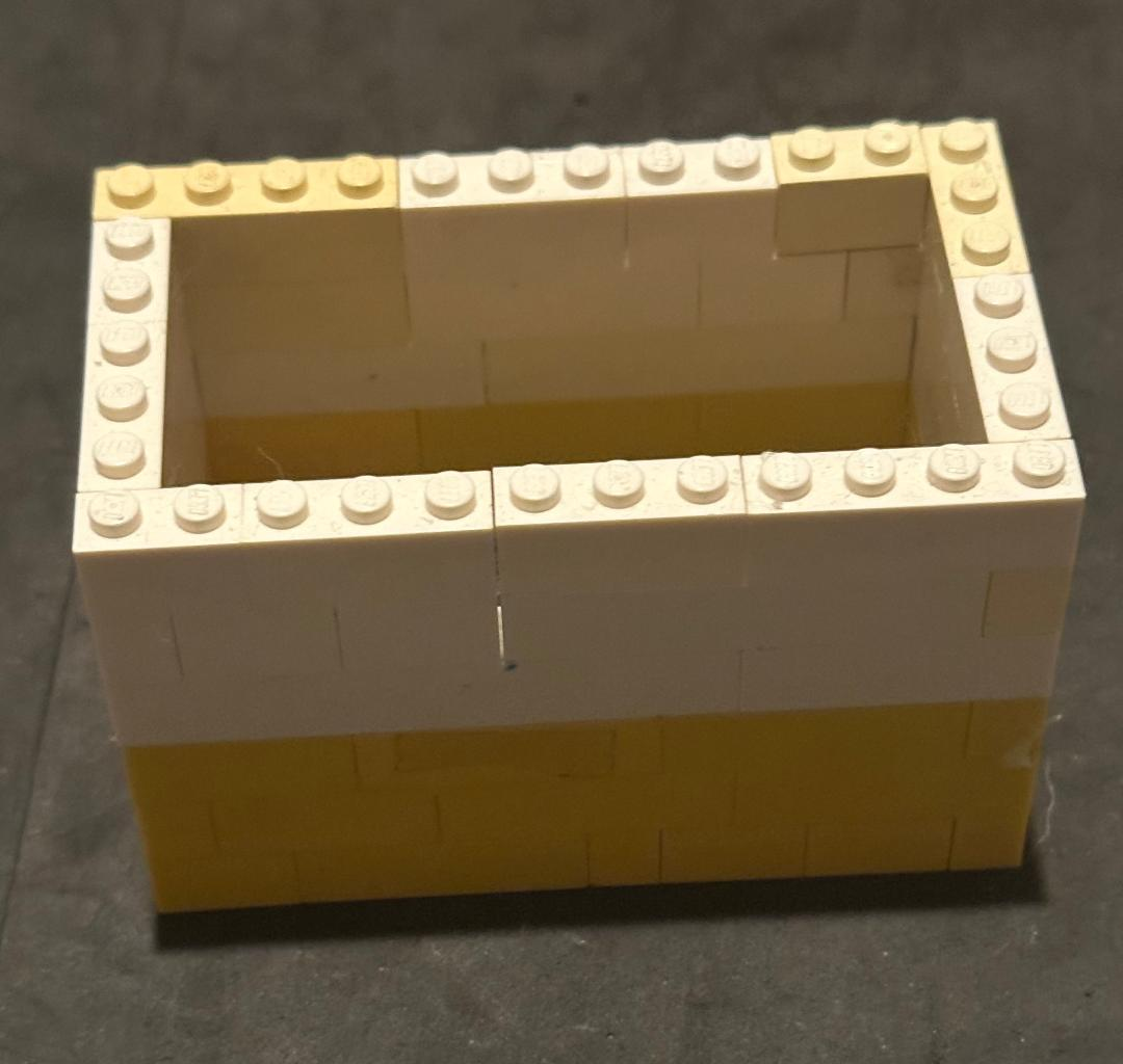

Working on it. Hobby Lobby has been out of RTV. I can’t guarantee this’ll work - there are deep recesses for the wheel wells which will make the sponsons difficult to remove without harming the mold. I may be putting out quite a few bucks for something that only works once. The piece will be fine, but not the mold.

What I could do to insure better quality and reusability of the molds is fill in the wheel well most of the way, leaving maybe 1/8 of depth so the modeler could see the shape. Then take a thin Dremel router and route to proper depth using a provided depth gauge - piece of Evergreen with a notch in it. :sweat_smile:
That would work.
Yep, I was thinking something similar when you first mentioned it. I thought about filling it but just off the edges.
Can they be molded separately?
Each is three pieces. I could mold each separately but that would just drive the cost of materials up, and also increase the chance of problems. Even very slight shrinkage or warpage would make it hell to glue all three pieces together. Casting the assembled sponson is a much better option and makes it much more stable in the mold.
