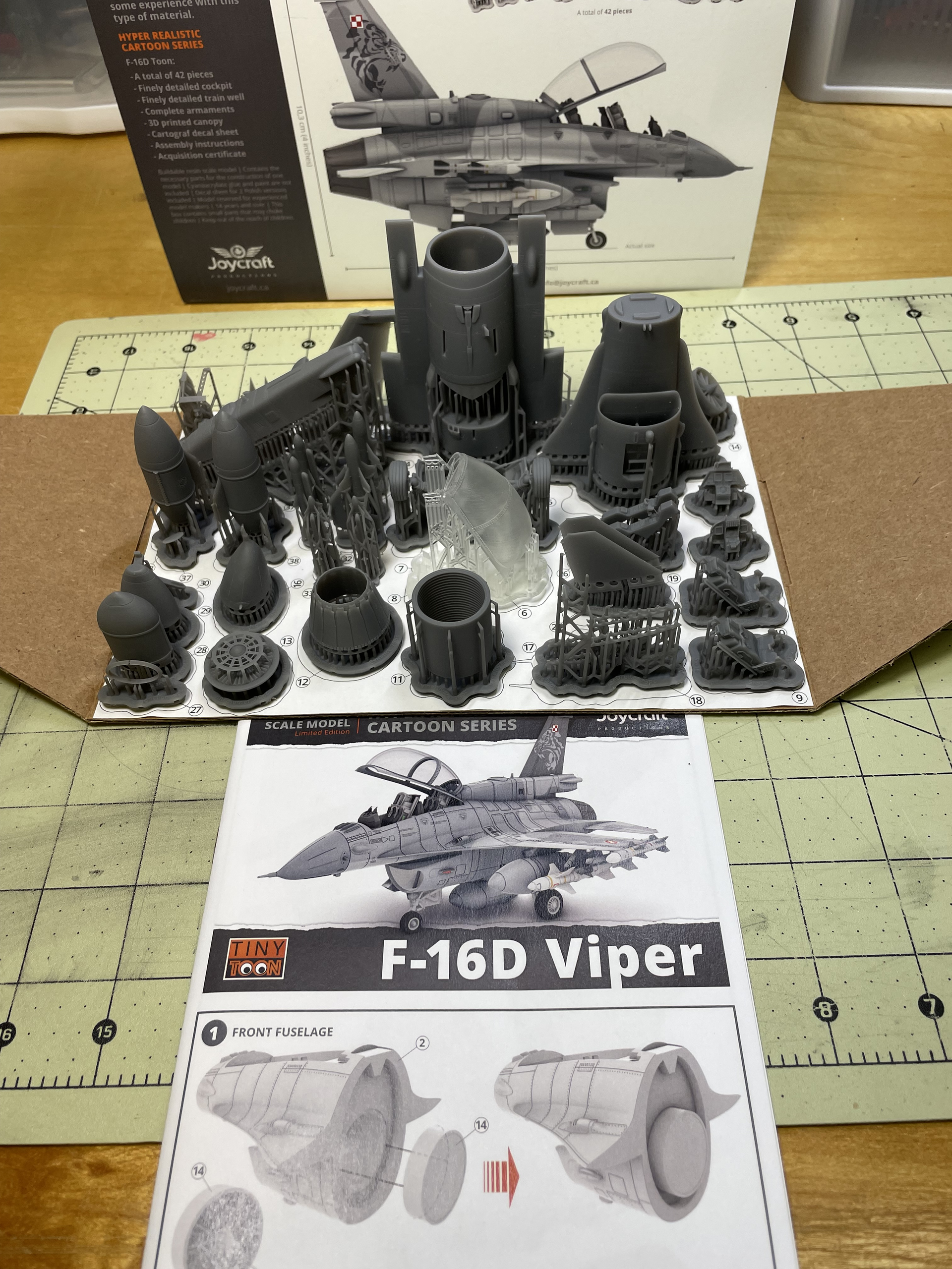

I am starting this kit for my club’s group build. I have never built a resin kit and would like your recommendations on which CA to use both for joining and filling gaps. Thank you kindly.
That is a 3D printed resin kit and not your traditional resin kit. Might help when looking for glues as it’s a different material.
In my experience, any CA glue will do. I would maybe recommend a slow-setting one, but if you take care checking fit before glueing, even a normal or even fast-setting one will do. For filler, if needed, I’d recommend a two-part epoxy filler such as Milliput.
That is going to be so cool.
Yup, a slower setting CA so you have some manipulation time. There are two kits of this. Which scale are you building? I like the larger scale but it is pricy.
Any good CA intended for modeling should be fine. However: clean the parts very thoroughly before assembly. Both mold releases and the resin used can result in surface “contamination” that will cause problems with any adhesive.
