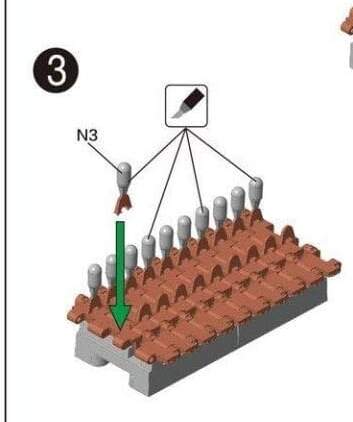

FWIW - The RFM Pz IV early tracks are easy enough to build. I’ve done three or four sets with no issues. Took about three hours to do one pair of tracks. I doubt the osketten version is any more difficult. The key is a very small pointed brush to very lightly apply liquid cement. The Tamiya Extra Thin brush is ideal.
The pins for the osketten side appear long enough, that would be my only concern.

It is annoying to do. On the Tiger, the pin is not the big deal. The teeth on the tracks is the real killer.
You have to put on every of these little things. Too much glue will makes the track rigid. Not enough and these things will fall all over the place.
They changed the tracks now that the middle section with 2 teeth are now 1 piece, making it easier.
Now, looking at the Panzer IV winter tracks, unlike the normal tracks, with these little pieces, you likely have to use glue on… it is not fun.

Valid concerns on the winterketten that one can likely work around without too much hassle.
Small droplets of super glue those ice cleats or whatever they are called, every~6th link shouldn’t be too bad. Attaching to link and let dry before pinning would probably work ok.
Leaving off the ice cleats could be an option they weren’t always available.
I’ve found that using really small dental microbrush to apply CA to glue those Ice Cleats (proper name) works well…
