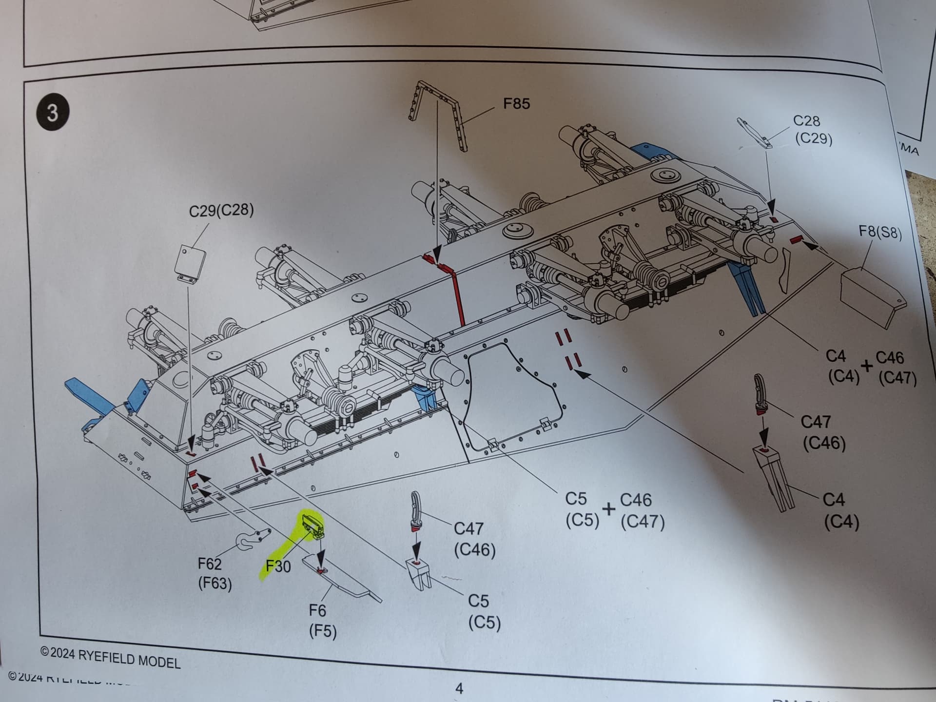

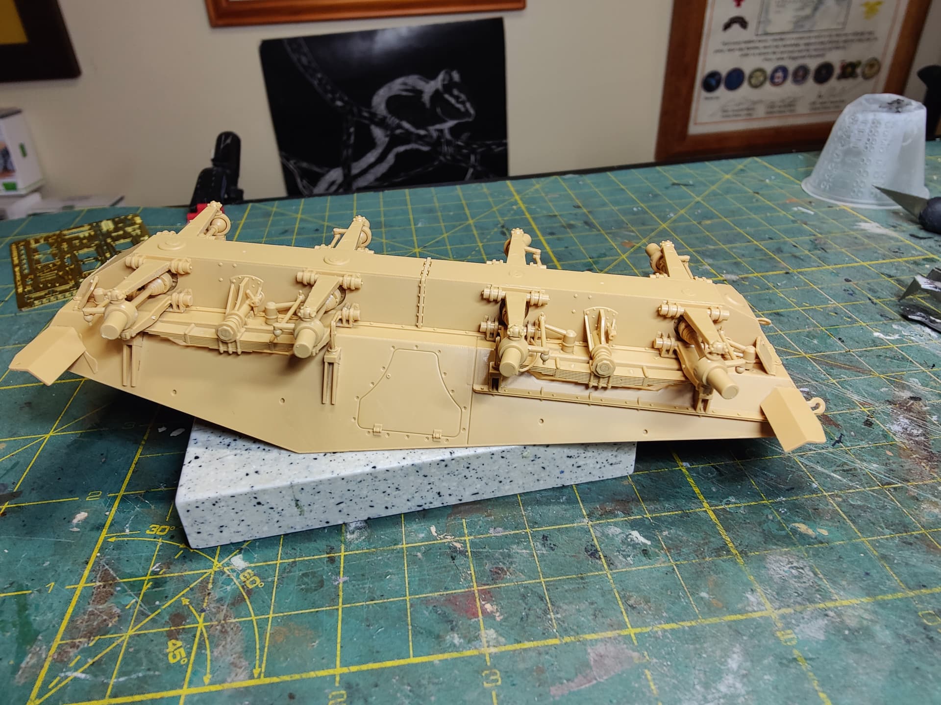

Step 3 done.
I lost a suspension part and hope that I stumble on it later. I actually did that yesterday for another part.

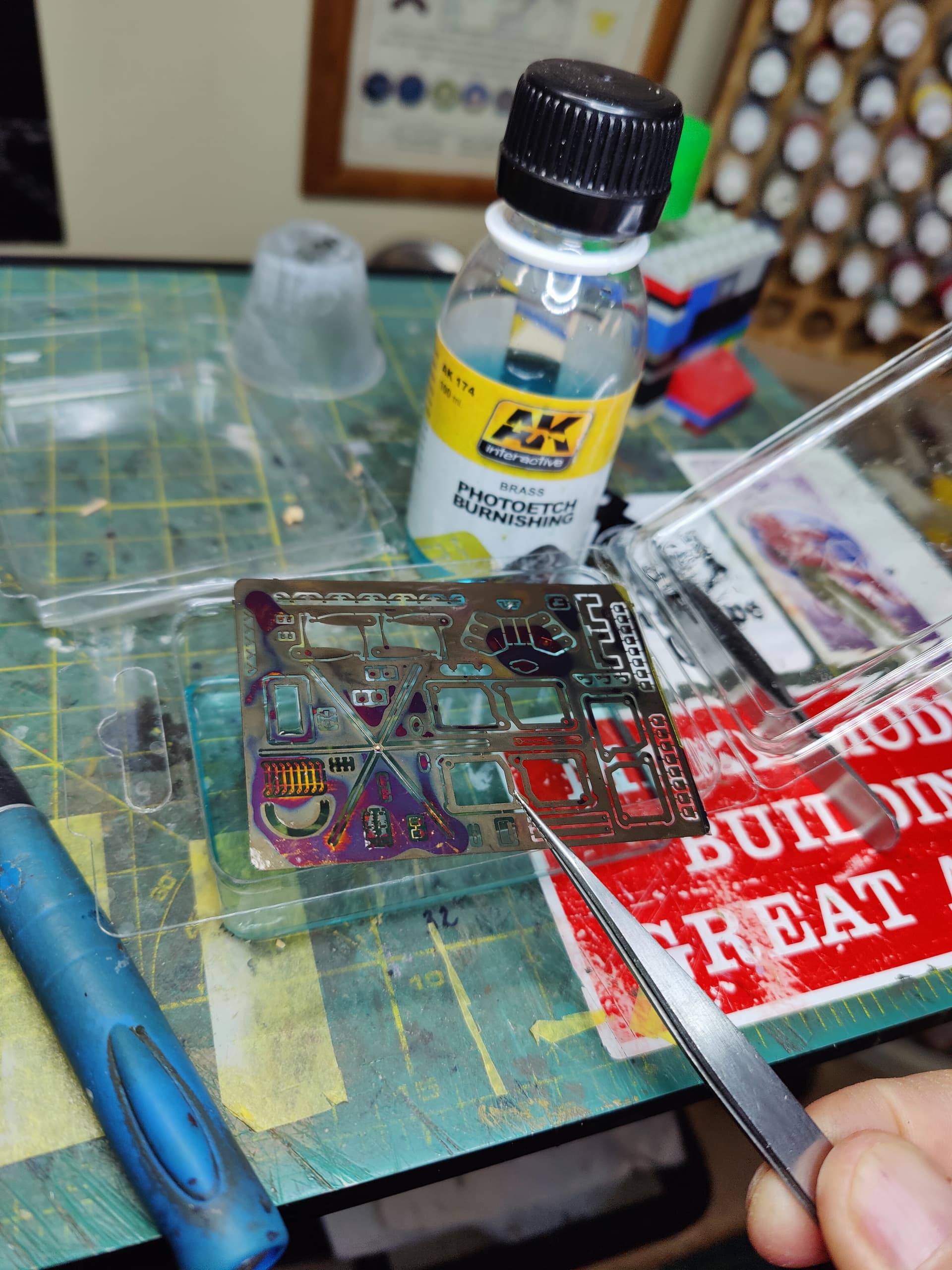

Darkening up the PE.
I think that part is the blackout driving lights
No, that isnt put on yet. That’s why the part is highlighted.
Aha!
Tricky
What’s bad is that I need to vacuum the floor but want to find the part first!

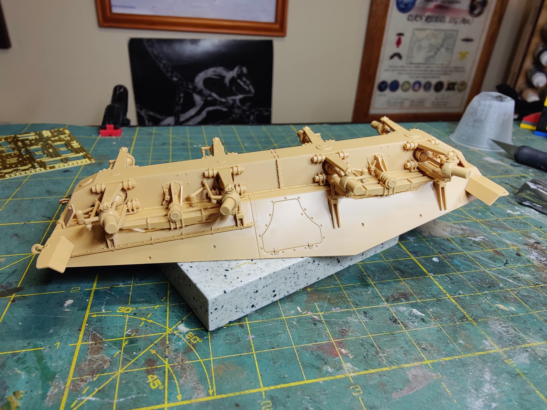

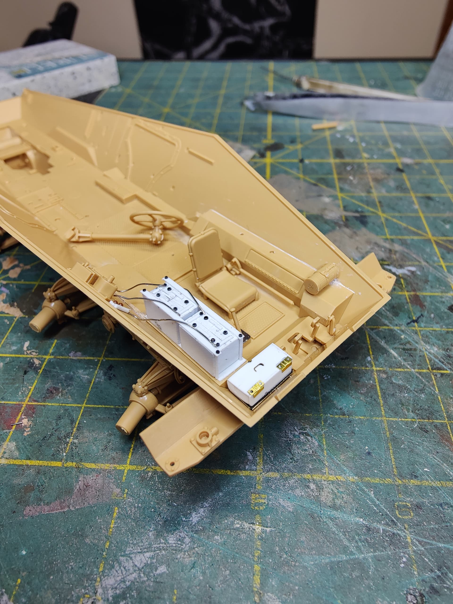

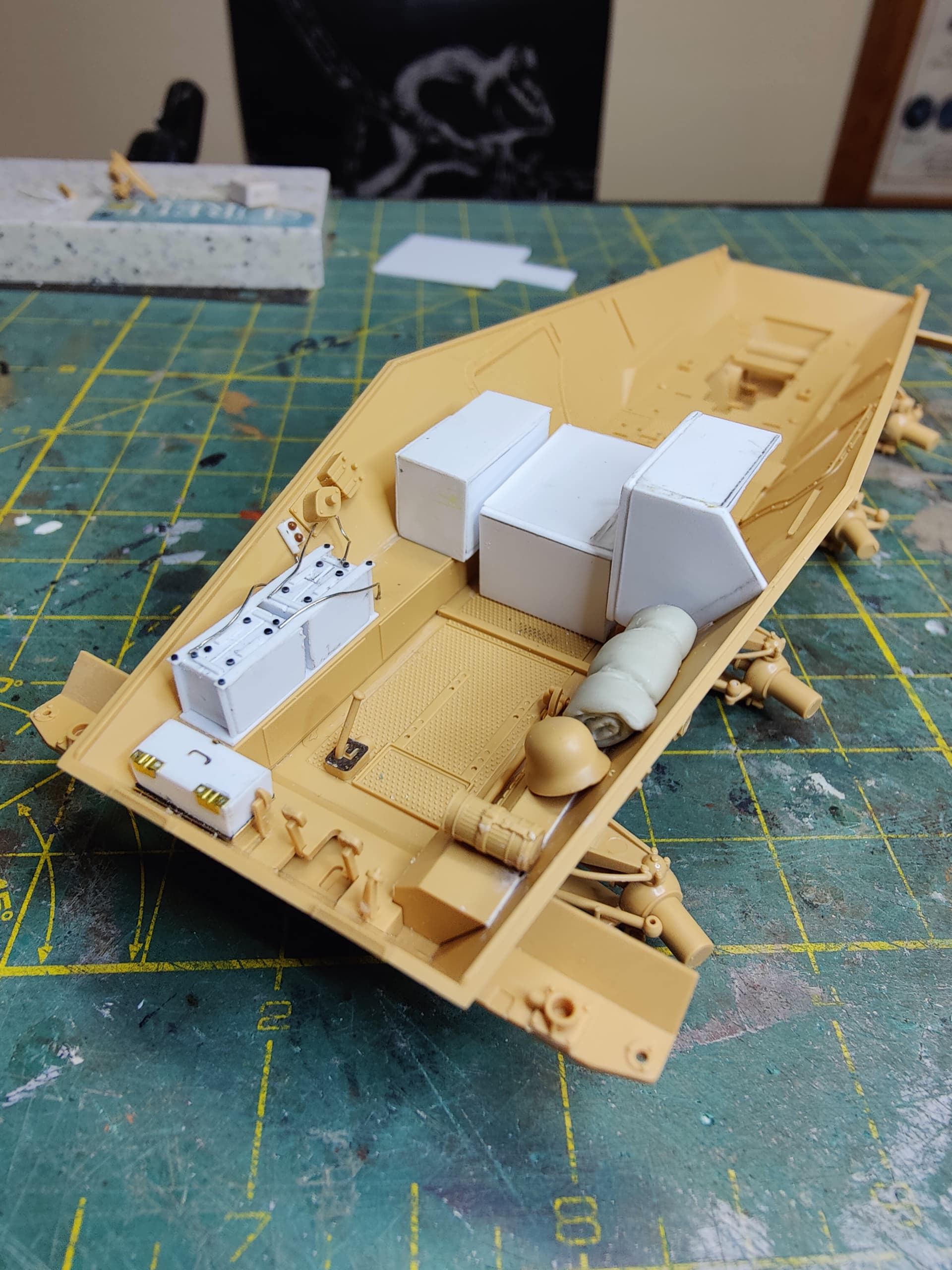

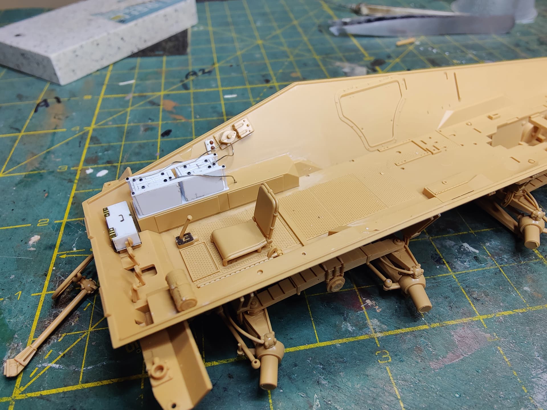

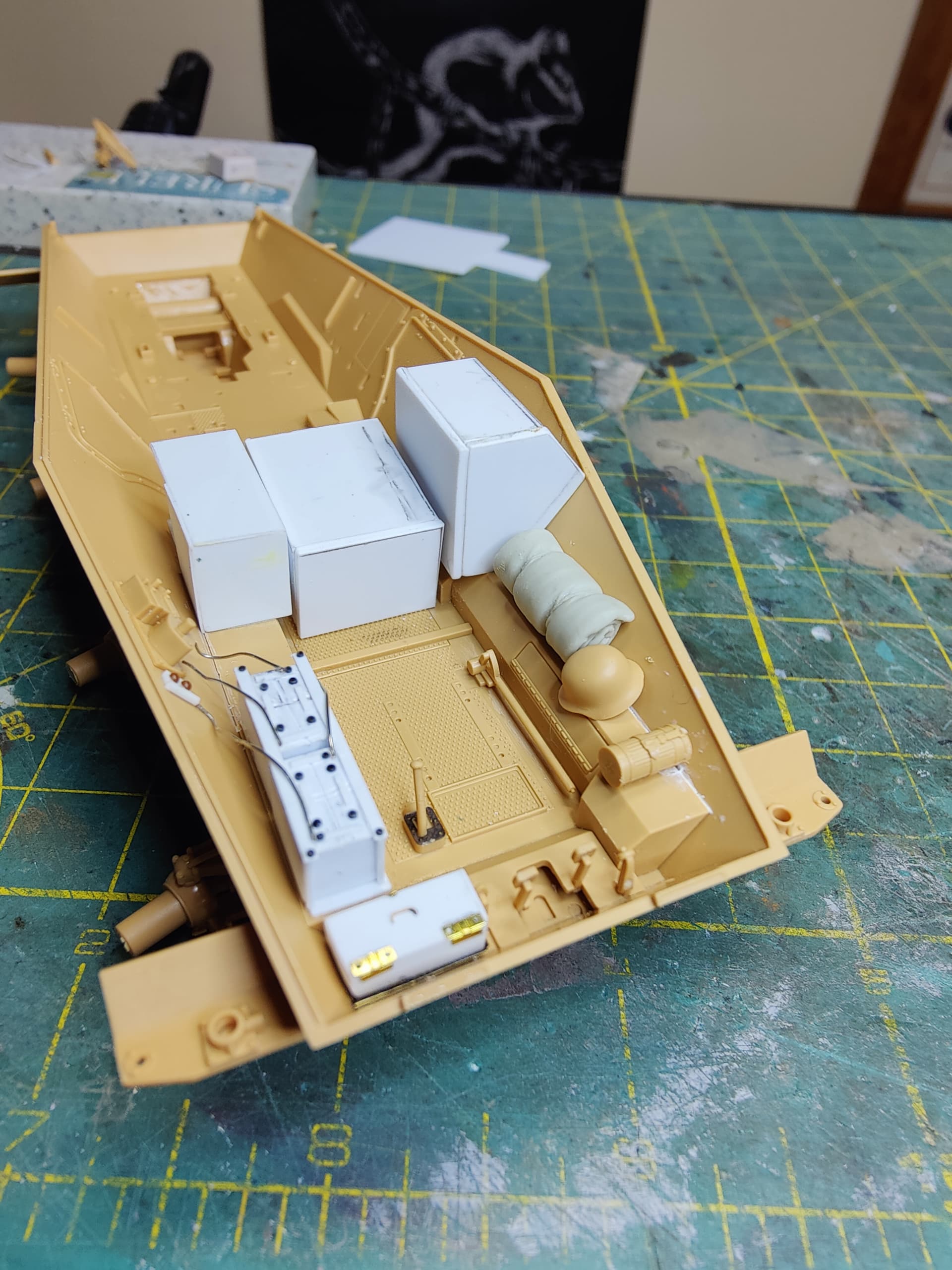

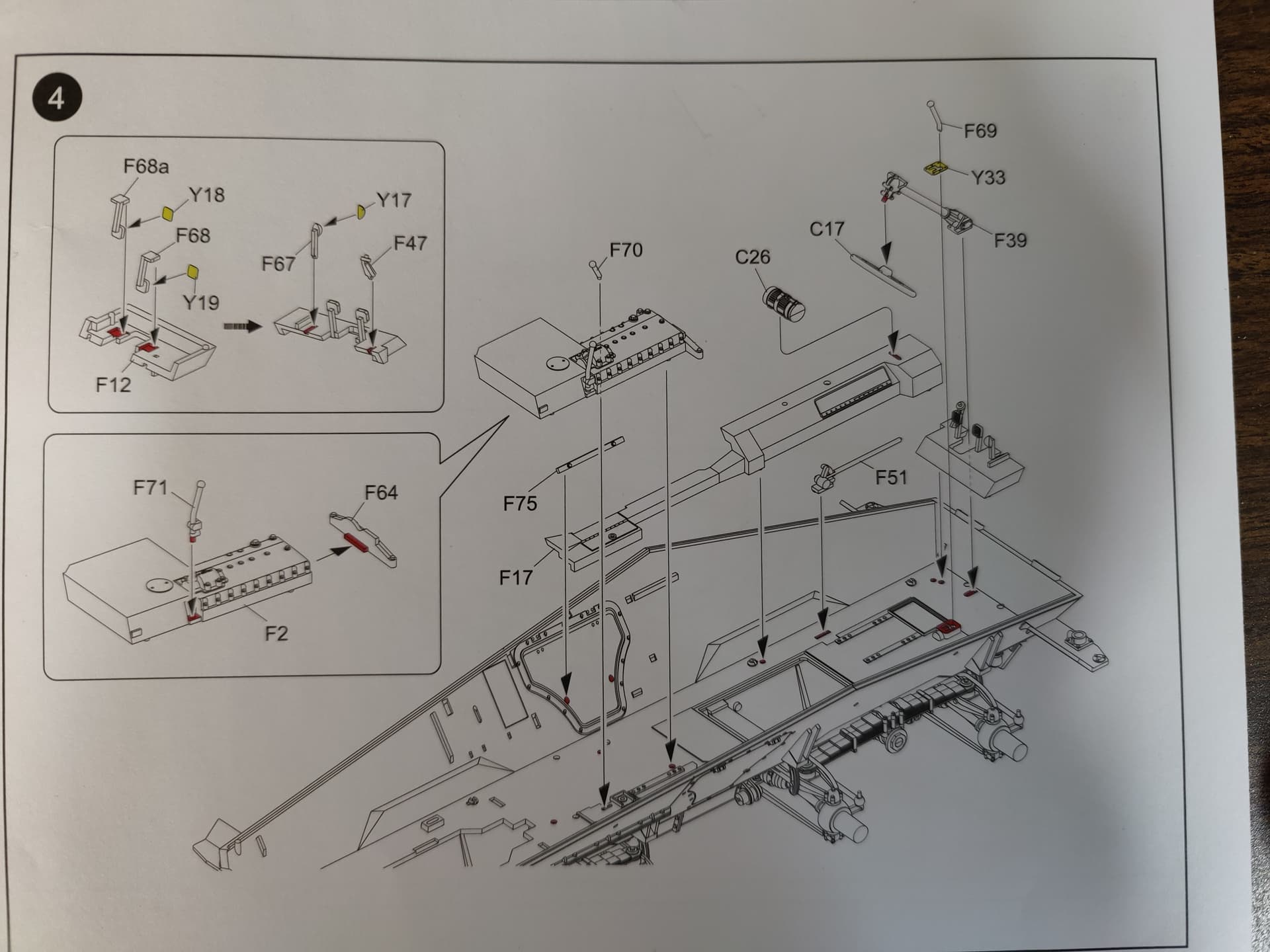

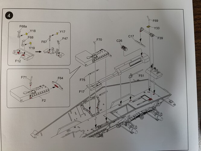

Worked on step 4. Added some extra detail using the Miniart kit as a example.
I might leave the drivers hatch open.
I just realized that I need to add those ammo boxes.

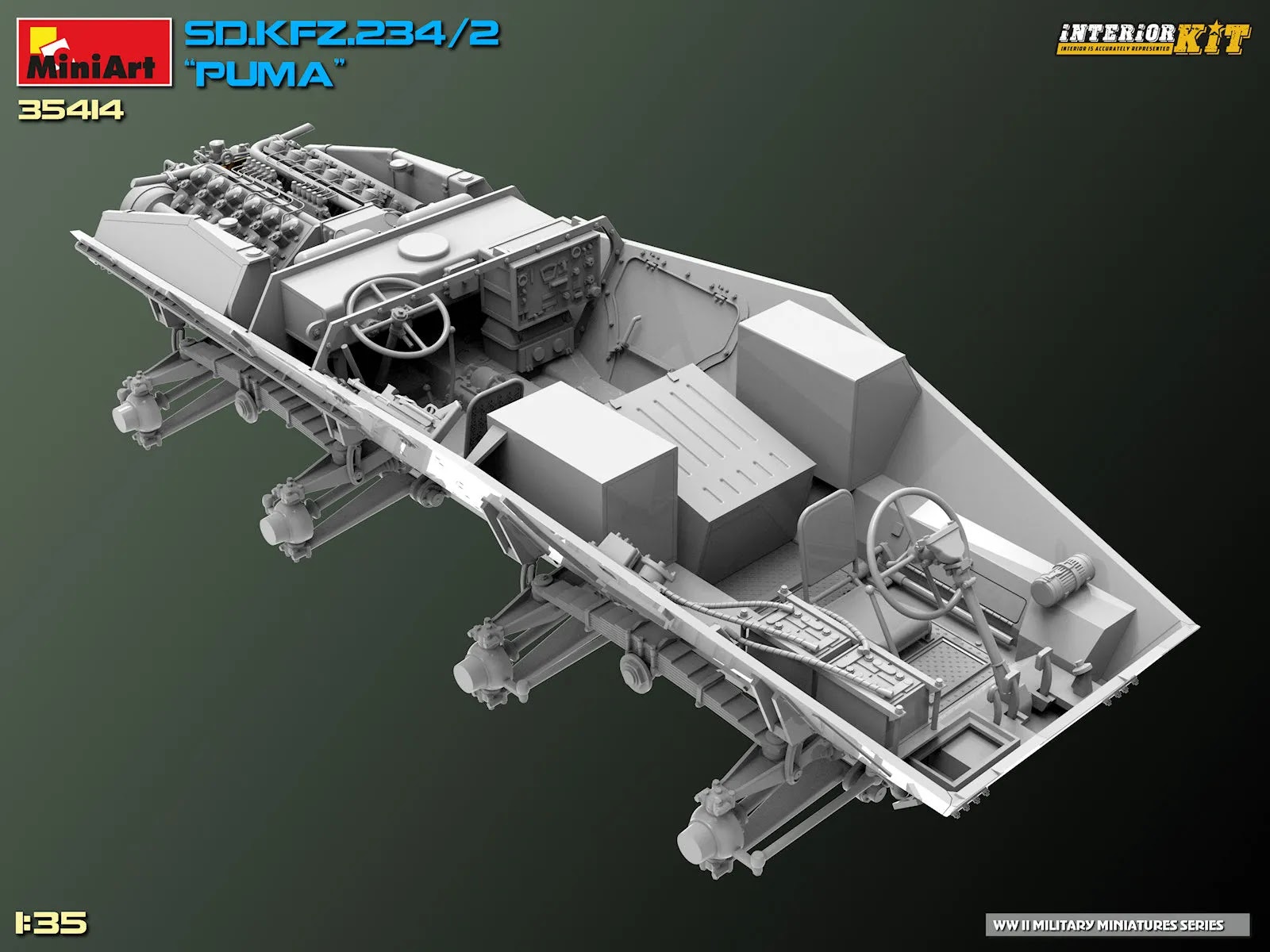

Worked on this on and off all day based on Miniarts CAD drawings.
Not much can be seen thru the drivers hatch.

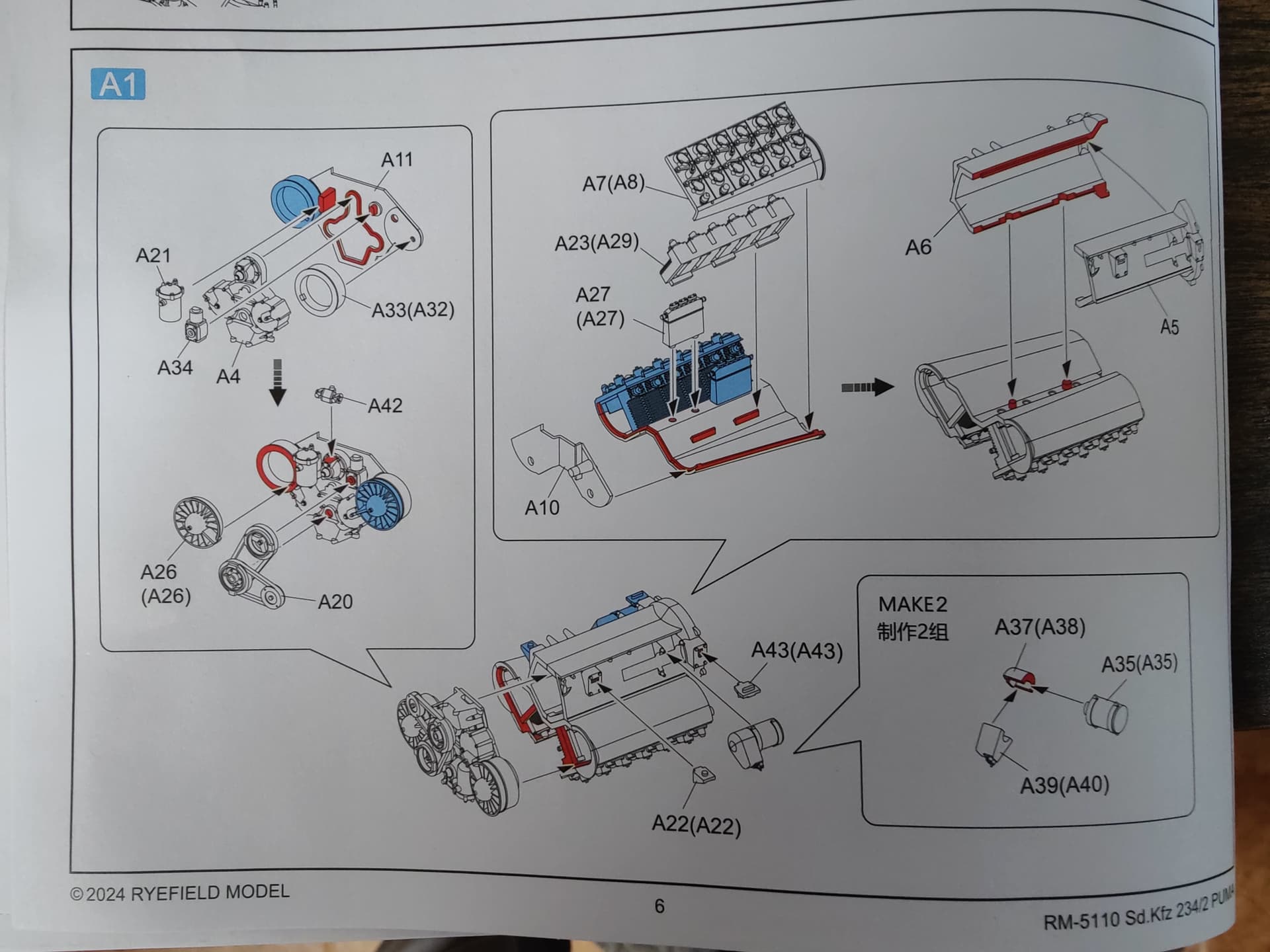

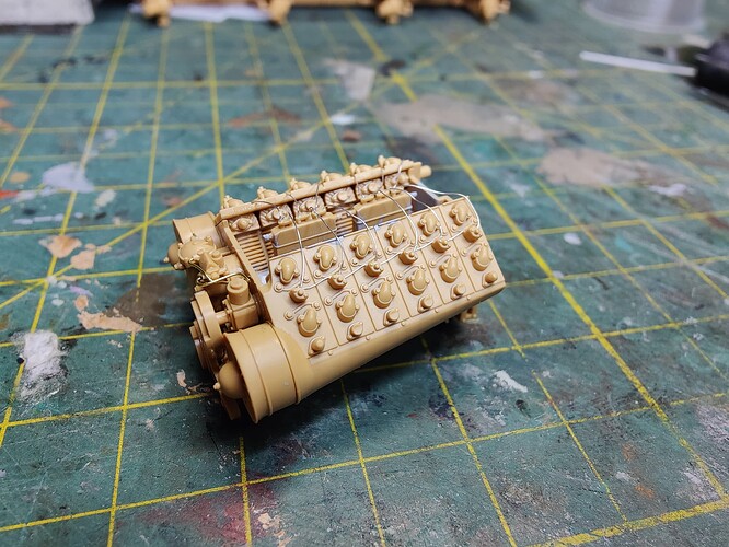

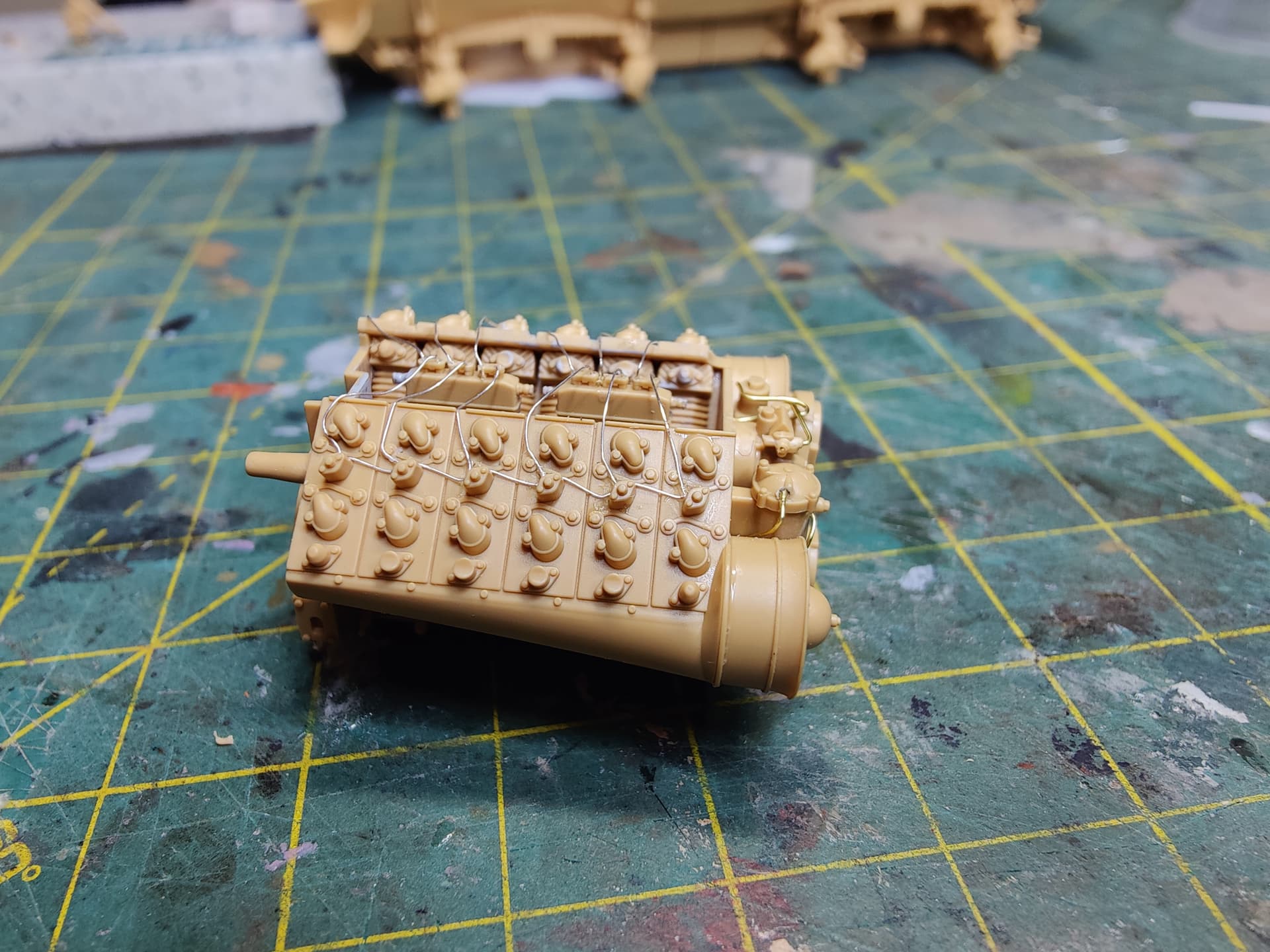

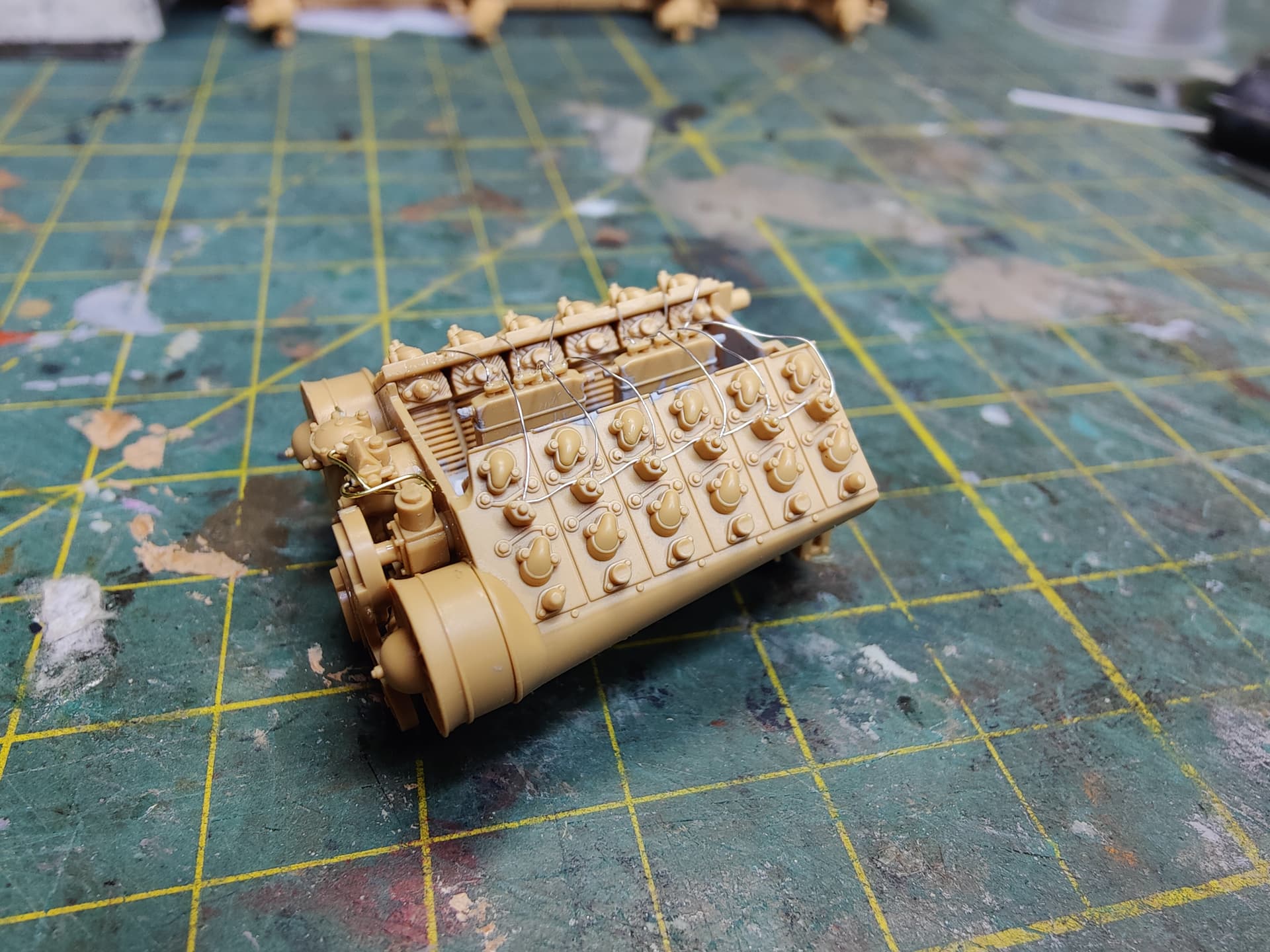

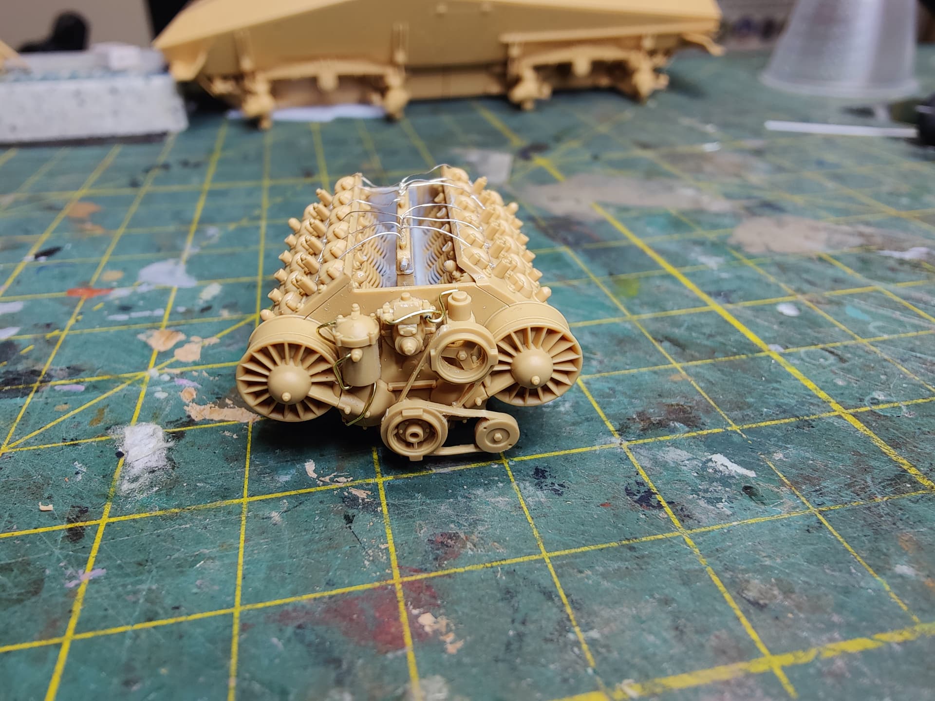

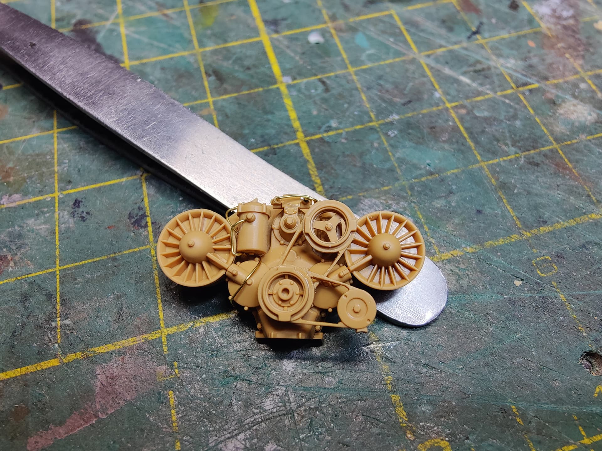

Started on the engine in step 4.
I added the fuel lines which took a bit of time. I hope they can be seen later!

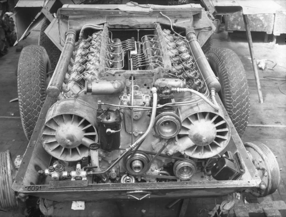

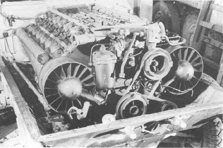

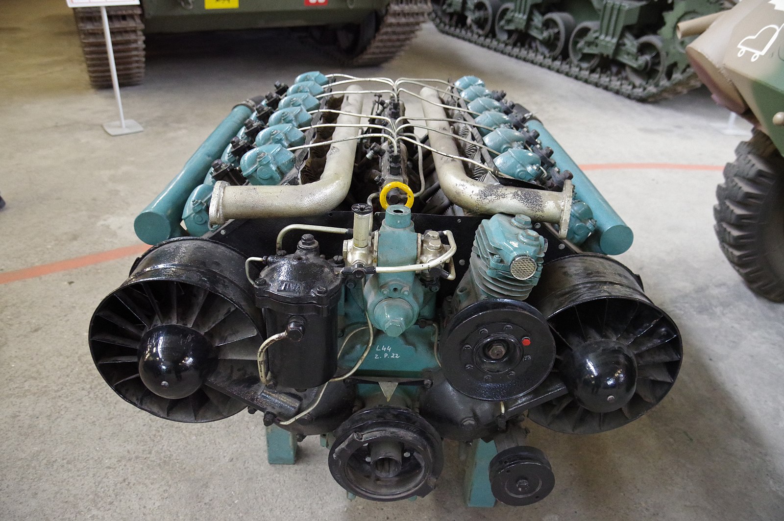

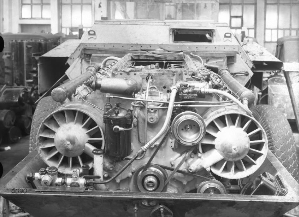

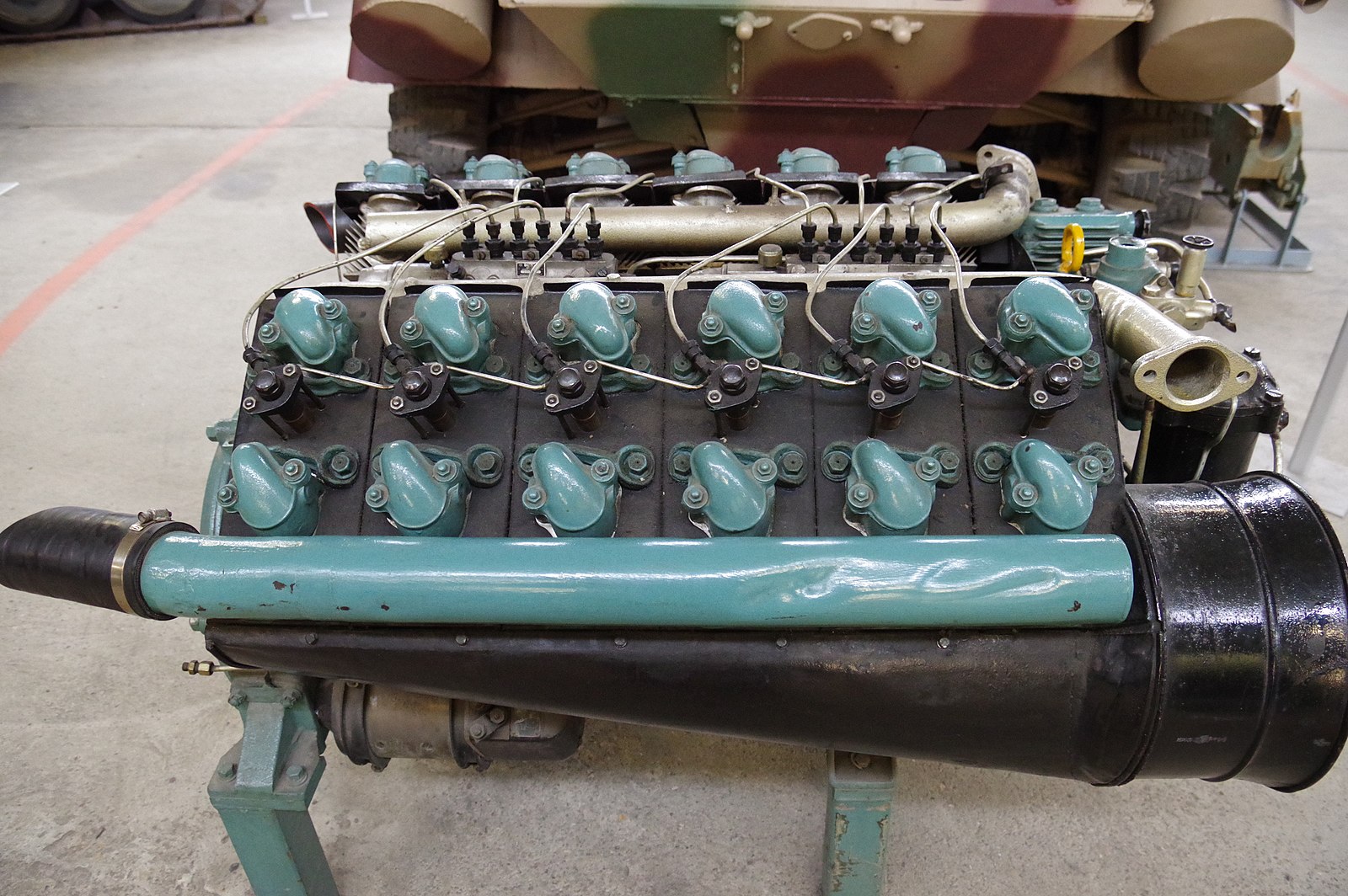

Some pics of the Tatra 103 diesel.
