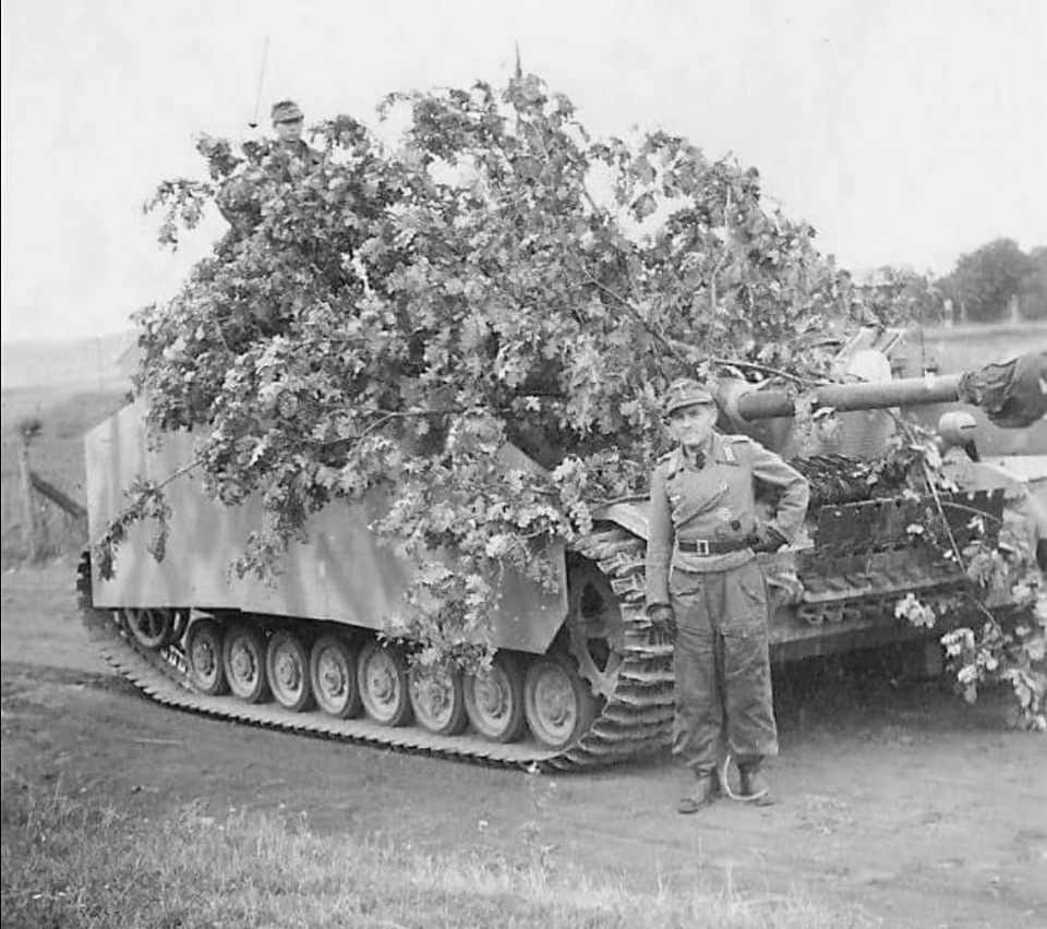

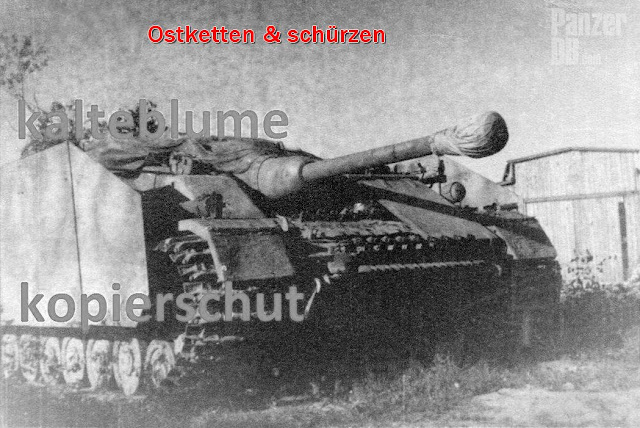

This blog includes photos of Stug IVs with ostketten and schurzen.
It’s interesting that the two Stugs pictured with schurzen and ostketten didn’t appear to be operating in winter conditions.
Bob
From following the link posted by @Tommi_Lukkarinen you will notice that the Schurzen front hangers are reinforced to hold the Schurzen away from the tracks, just. There are at least 5 photos in that link so on that evidence yes they did fit Ostketten and Schurzen just not often and it would seem with a bit of modification.

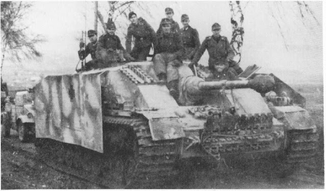

You won’t see that many stugs (or panzers) wearing schurzens with the Winterketten tracks installed. There are some exceptions; where the mounting brackets are extended in order to allow the Schurzens to stick further out.
But a lot of the images I’ve seen either have Schurzen and no winterketten tracks or viceversa.

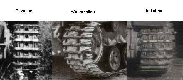

It is worth remembering that Winterketten and Ostketten are different,
the Winterketten have longer extensions.
In case someone had forgotten …
