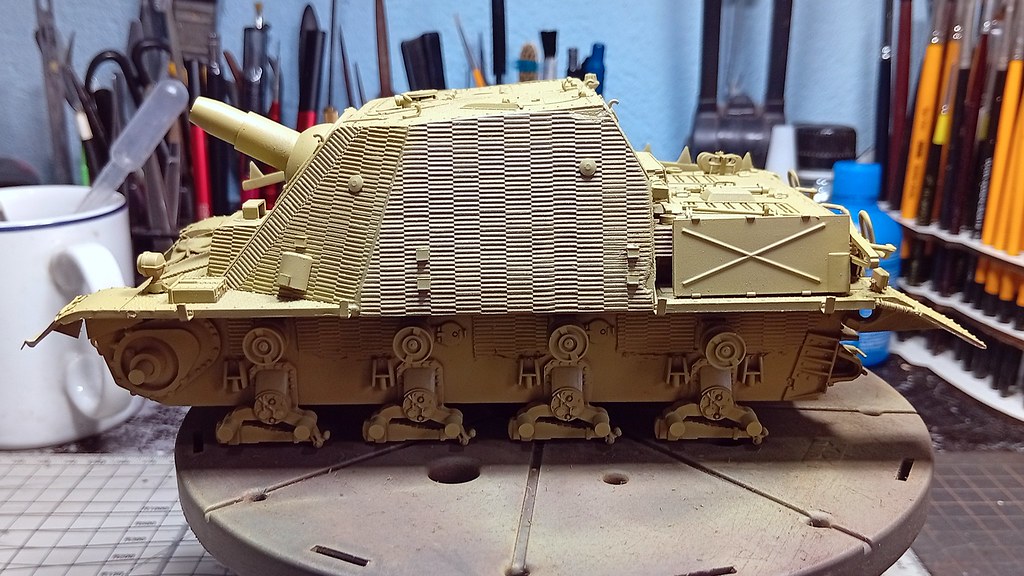

Painting with RAL 7028 Dunkelgelb from Ammo (a.mig-0010). This color was replaced by ATOM-20012 DUNKELGELB RAL 7028, and Ammo Brazil only has this one in stock now. I chose this shade because it would be the most suitable as the standard base color used in German army vehicles from February 1943 until the end of 1944. I used a dilution of 60% paint to 40% thinner and a pressure of 30 psi.

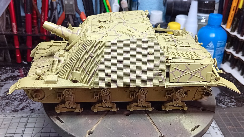

I employed the AK Interactive cane in the colour RAL 8017 ROTBRAUN-RED BROWN (RCM020) to create the camouflage guide lines.
