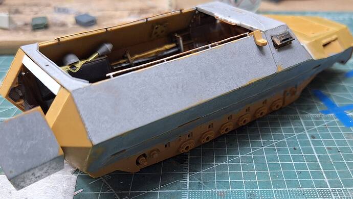

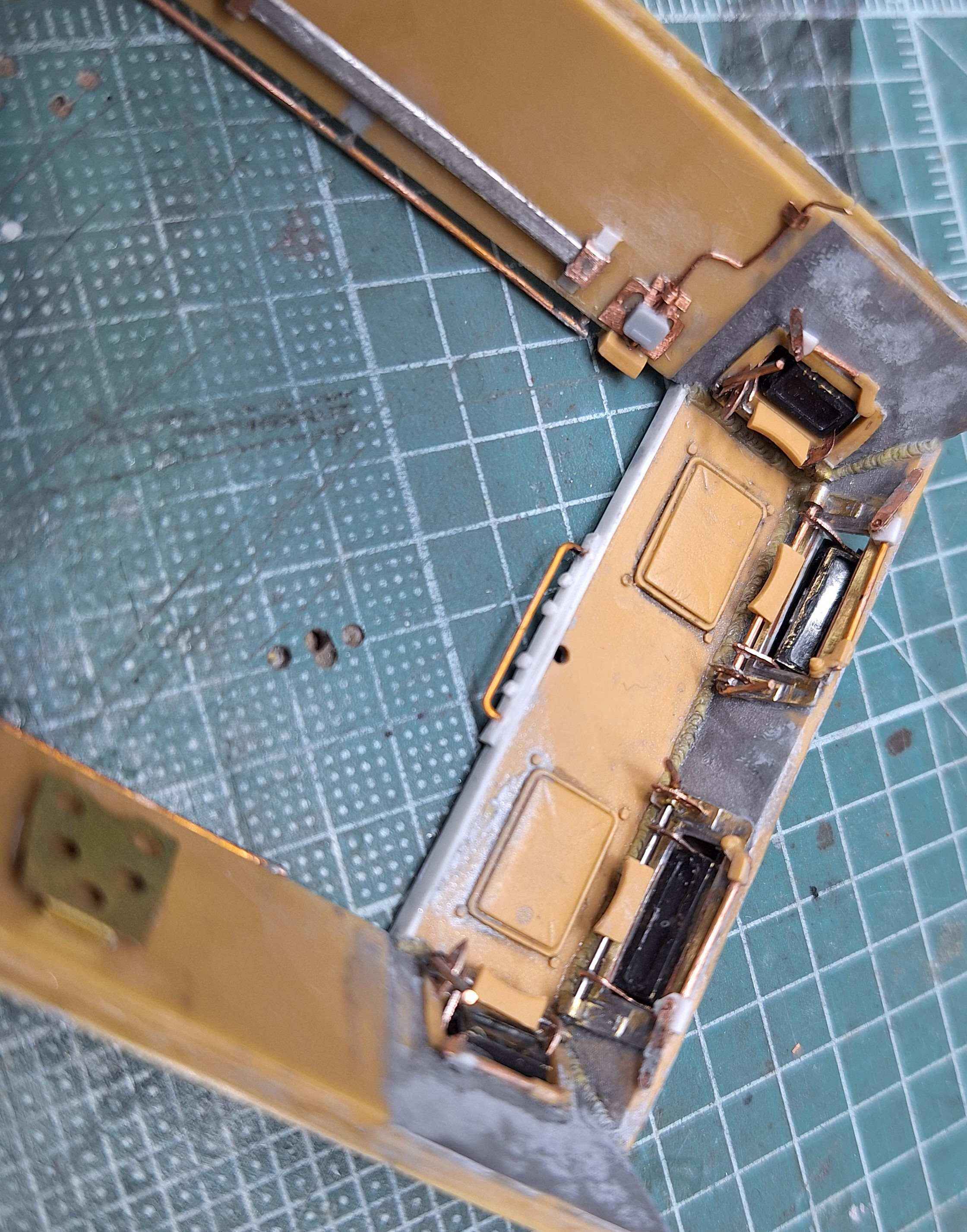

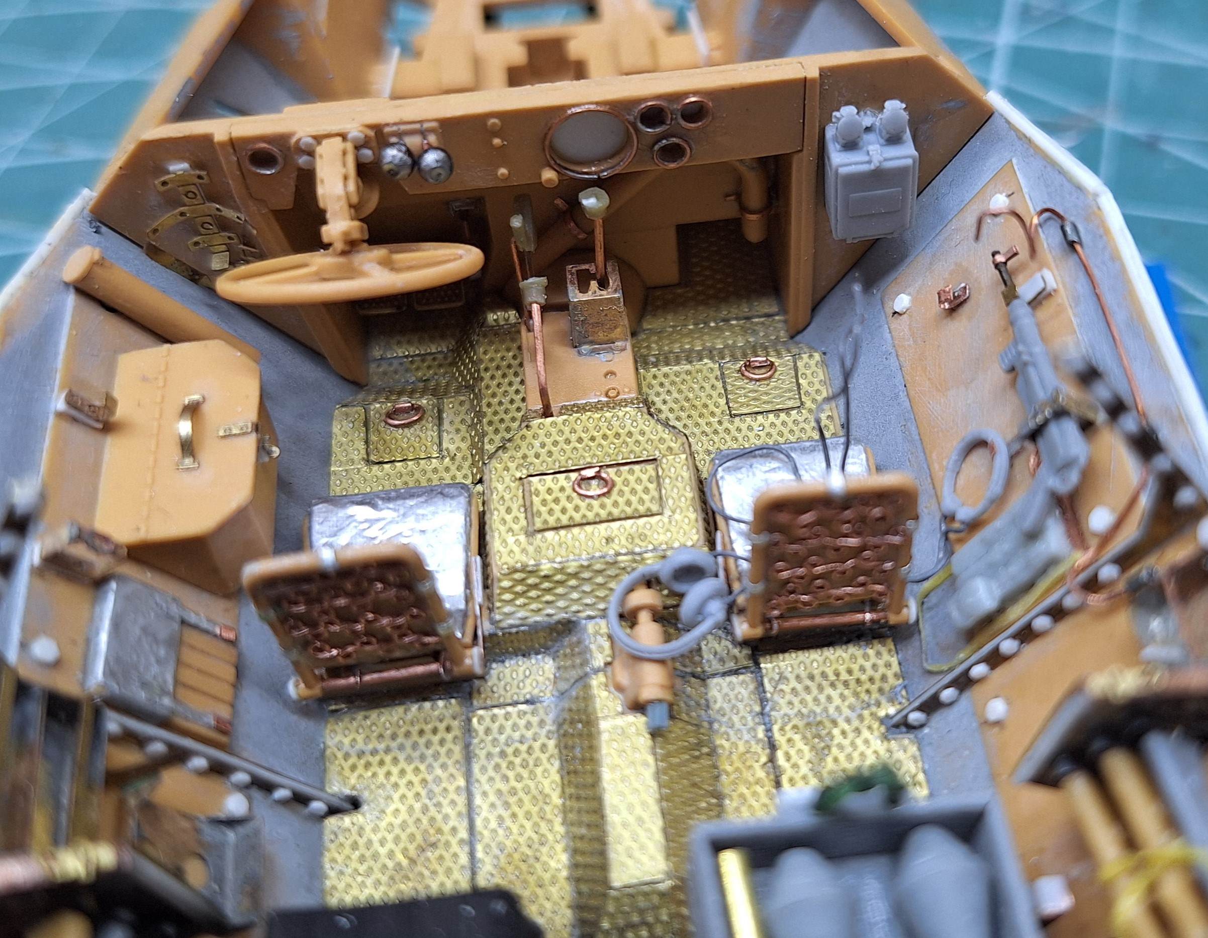

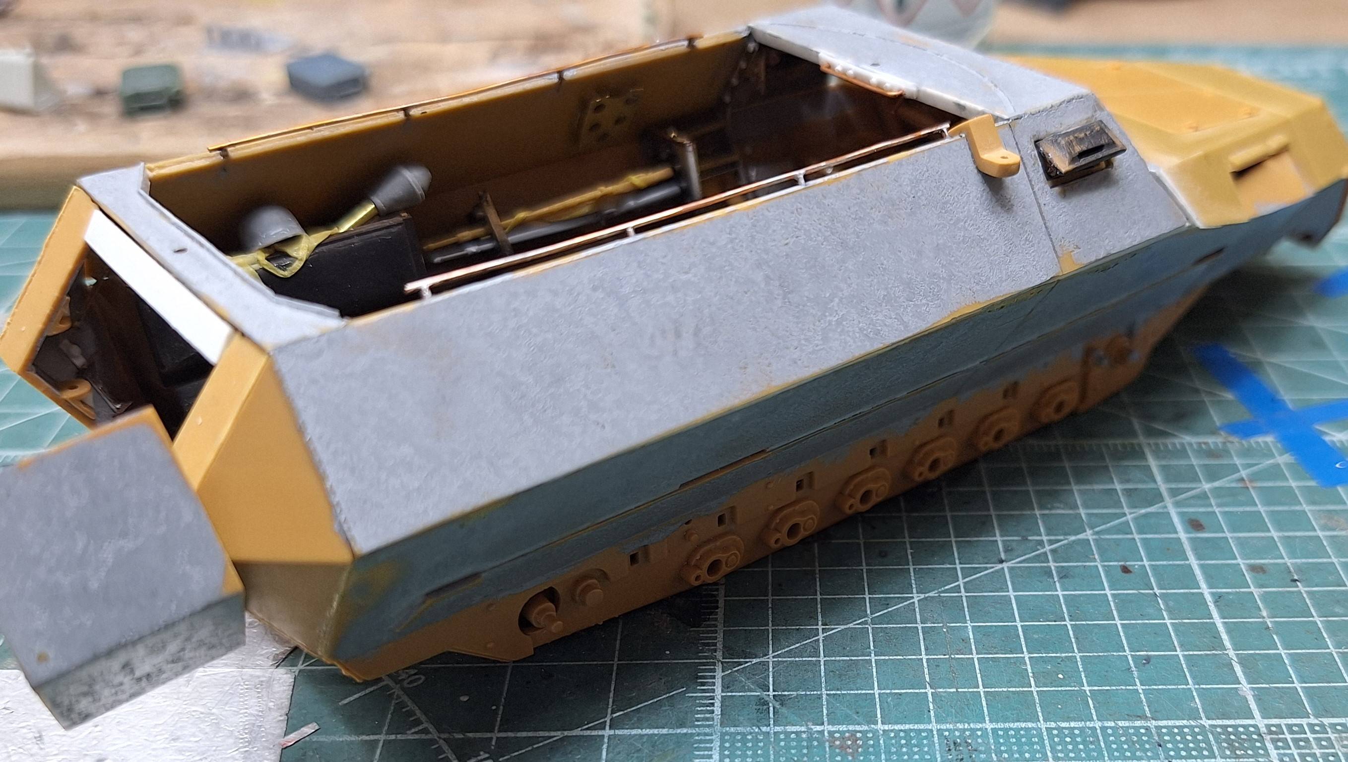

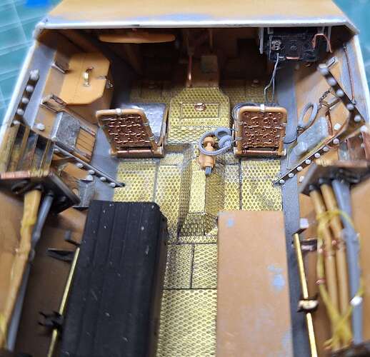

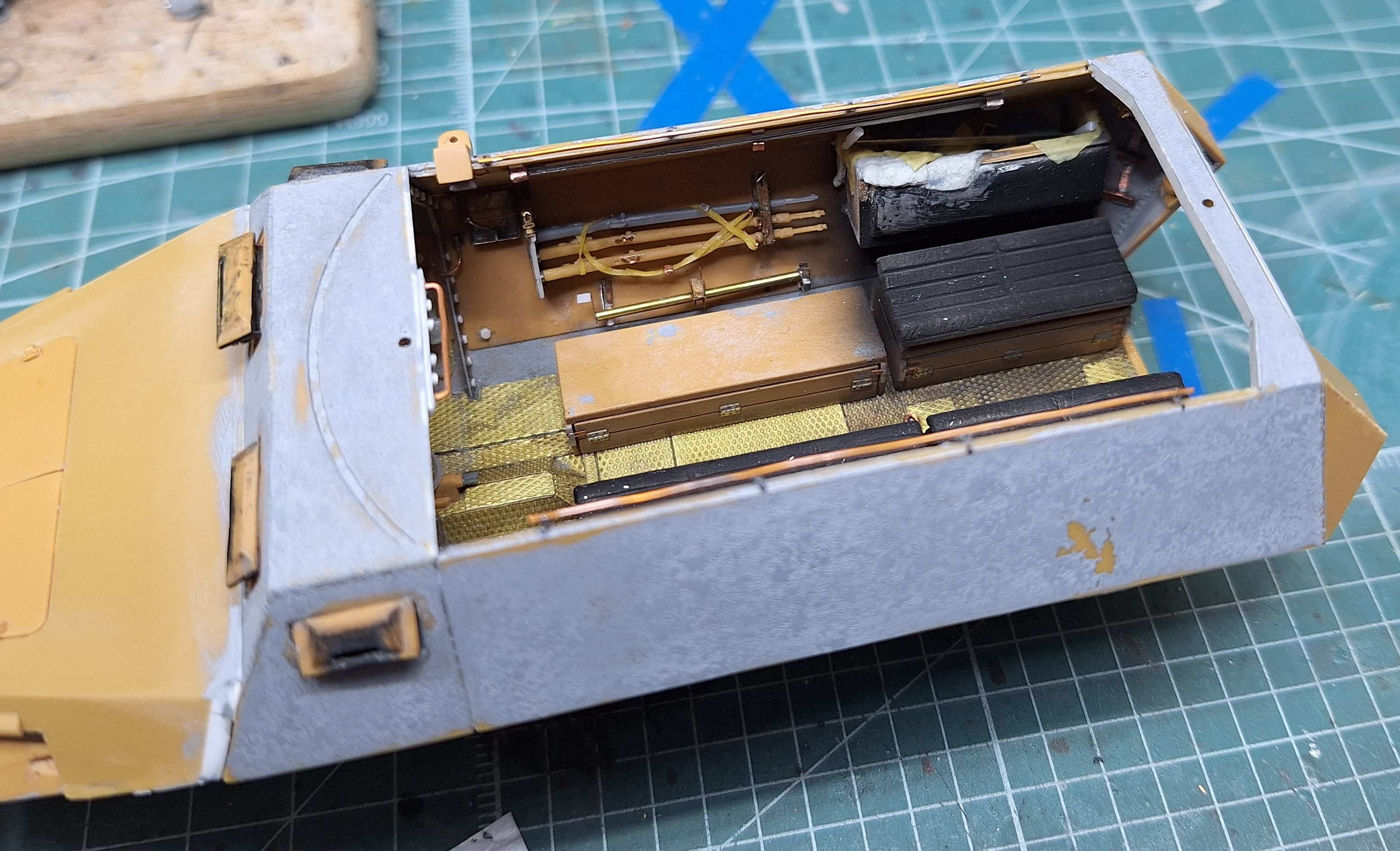

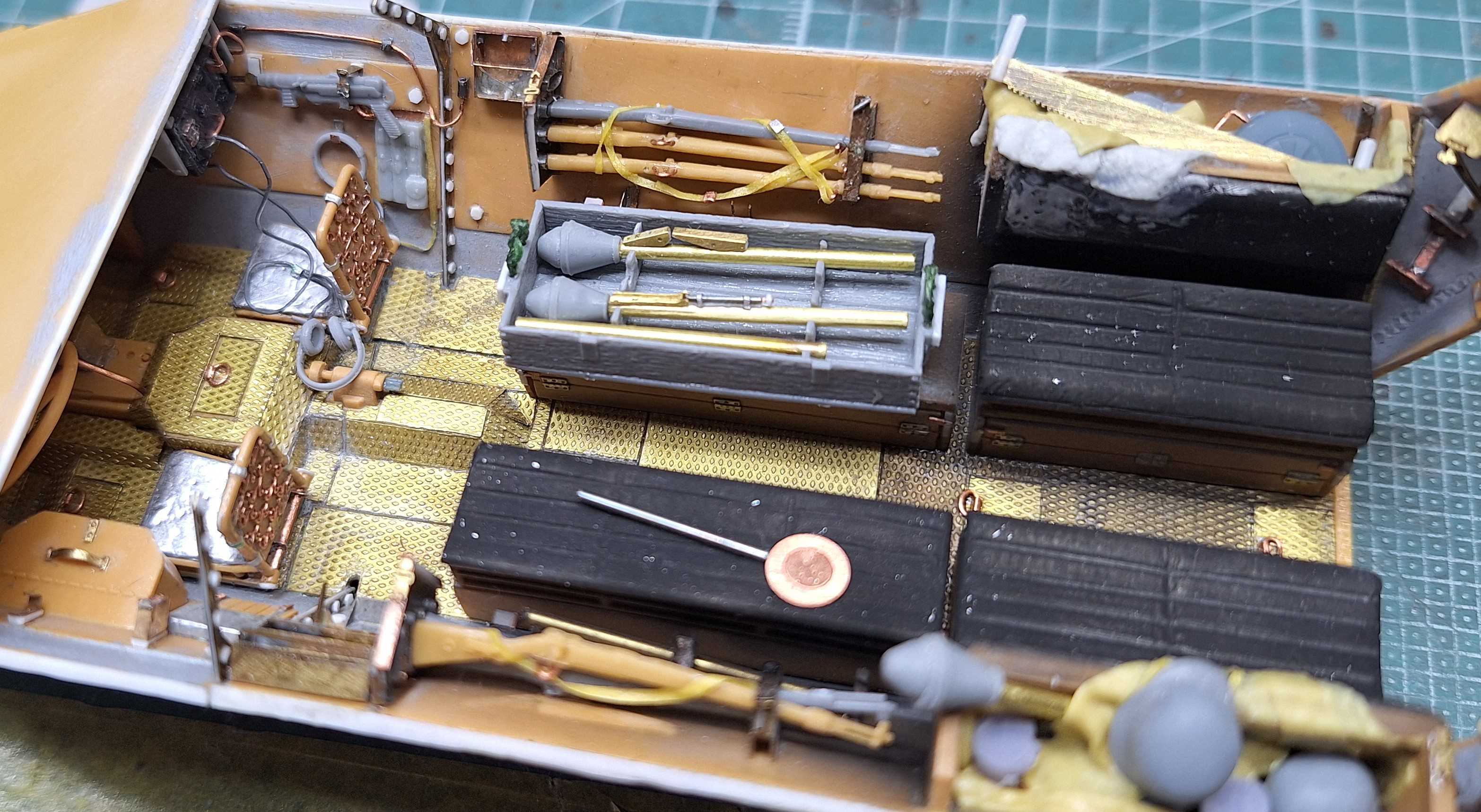

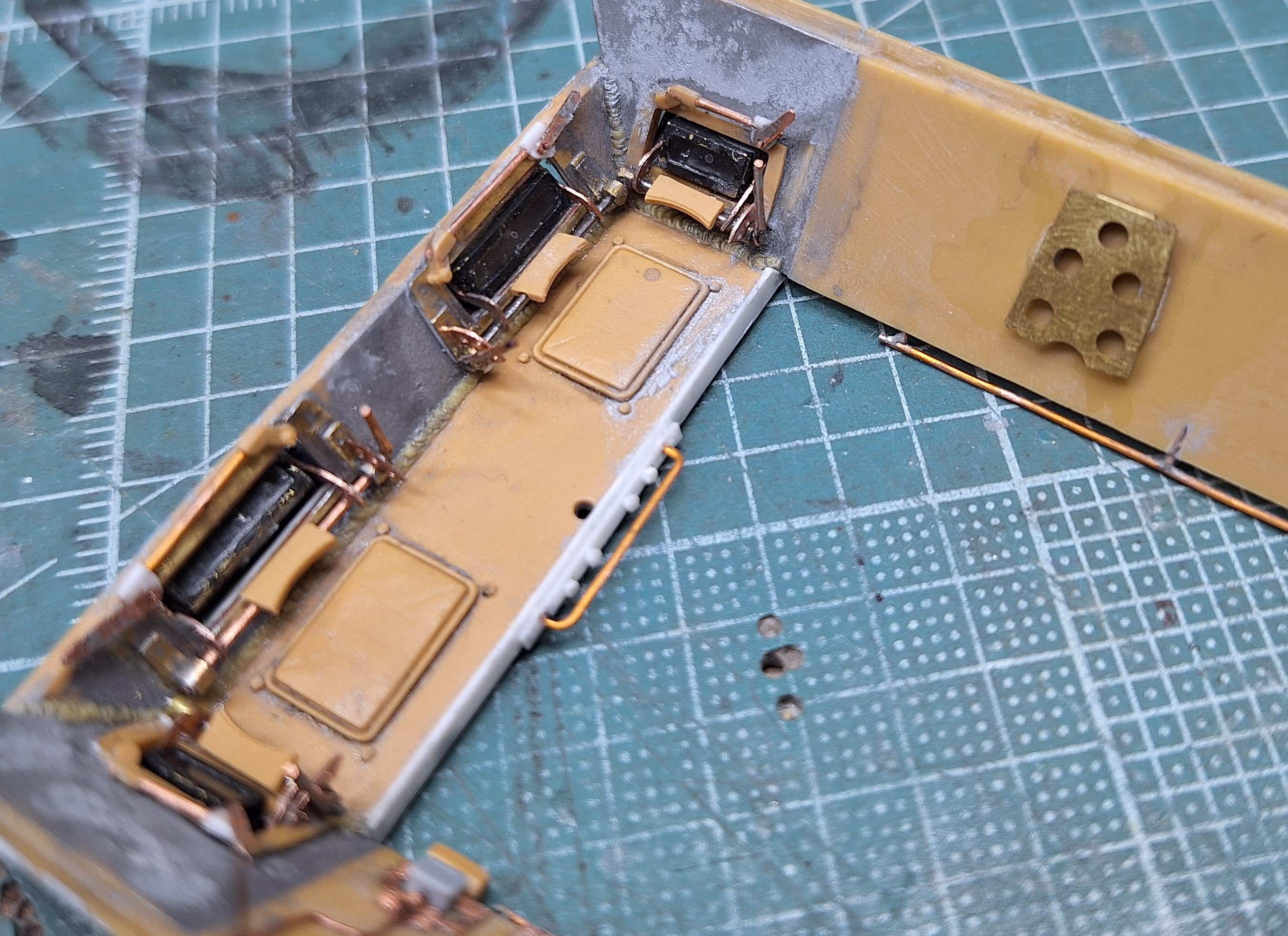

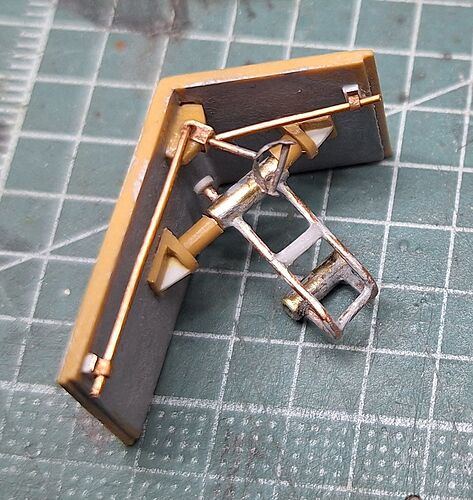

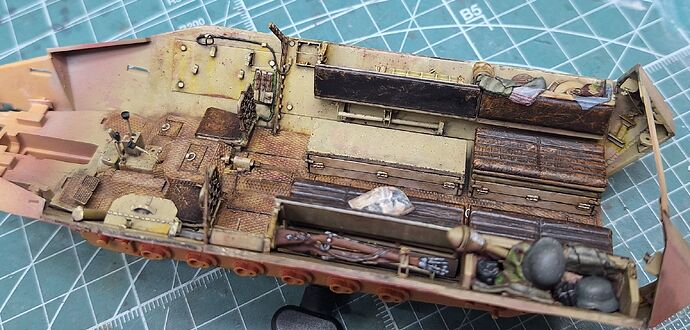

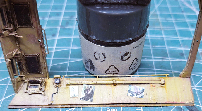

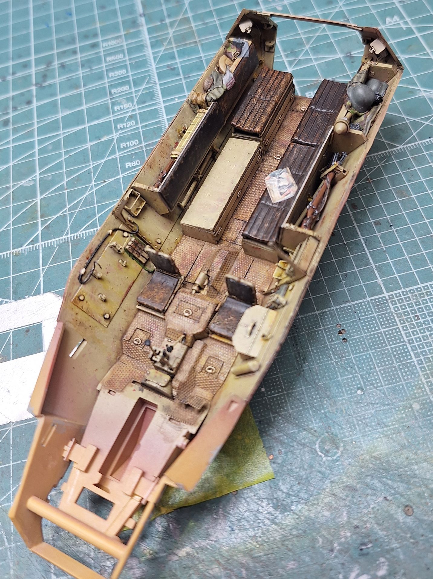

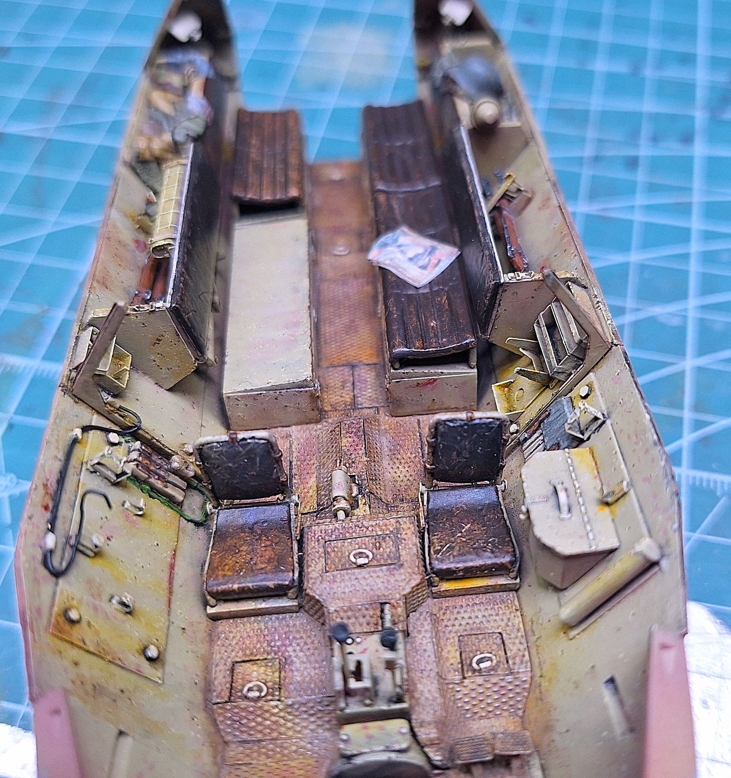

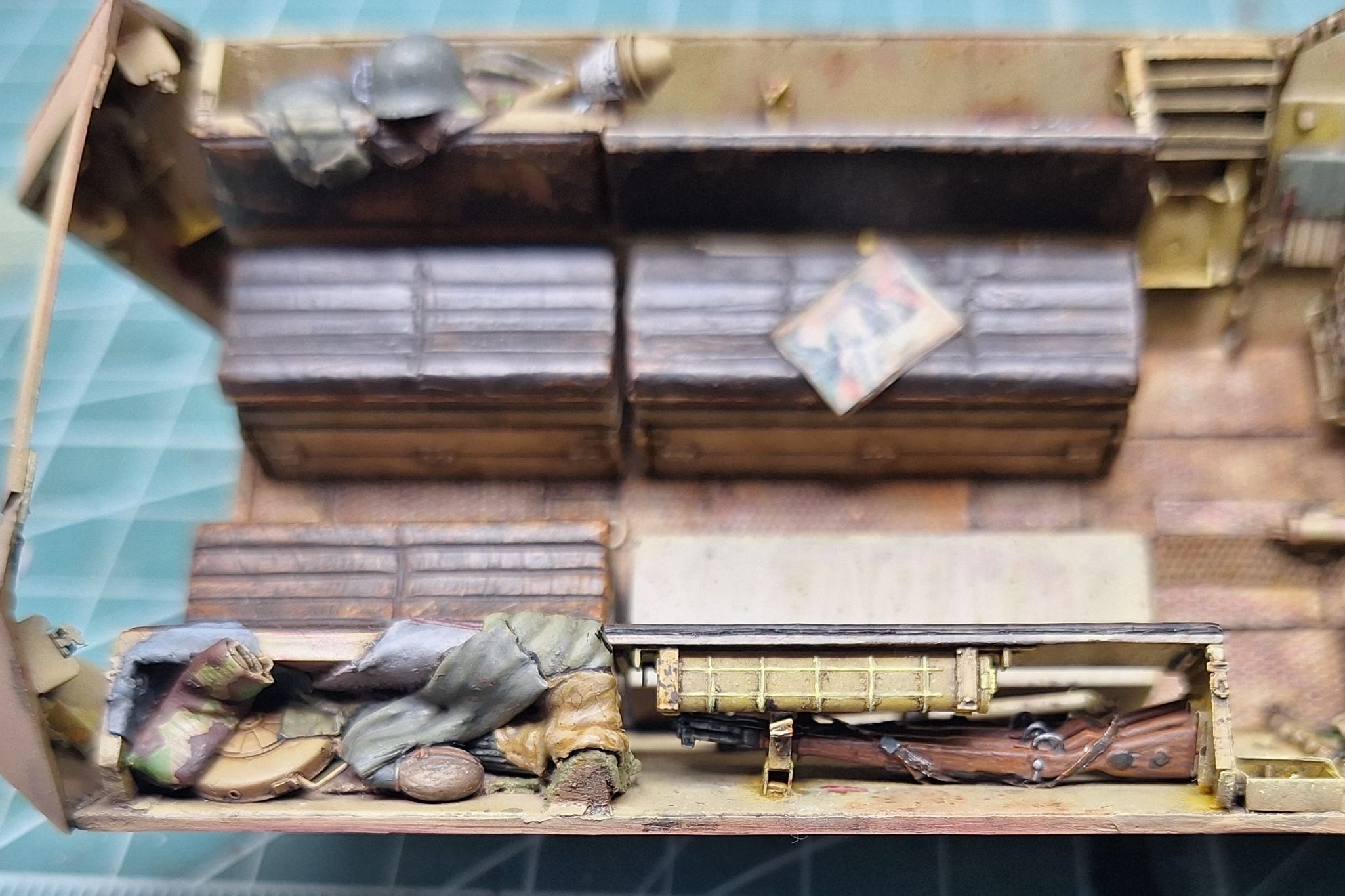

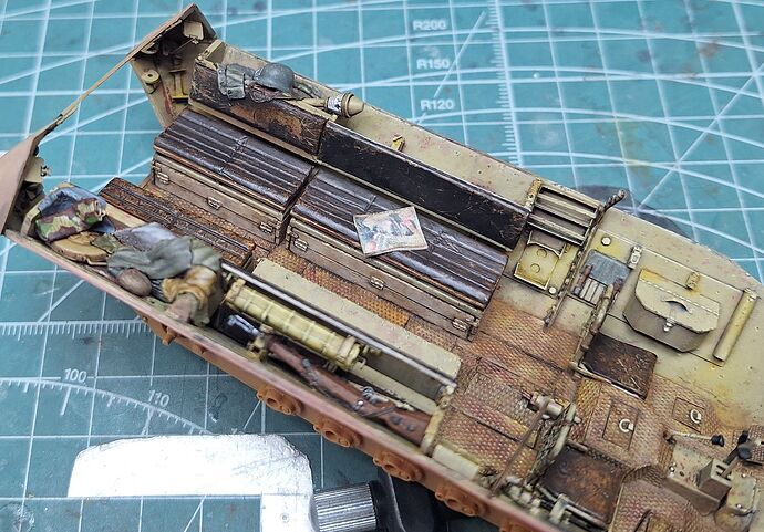

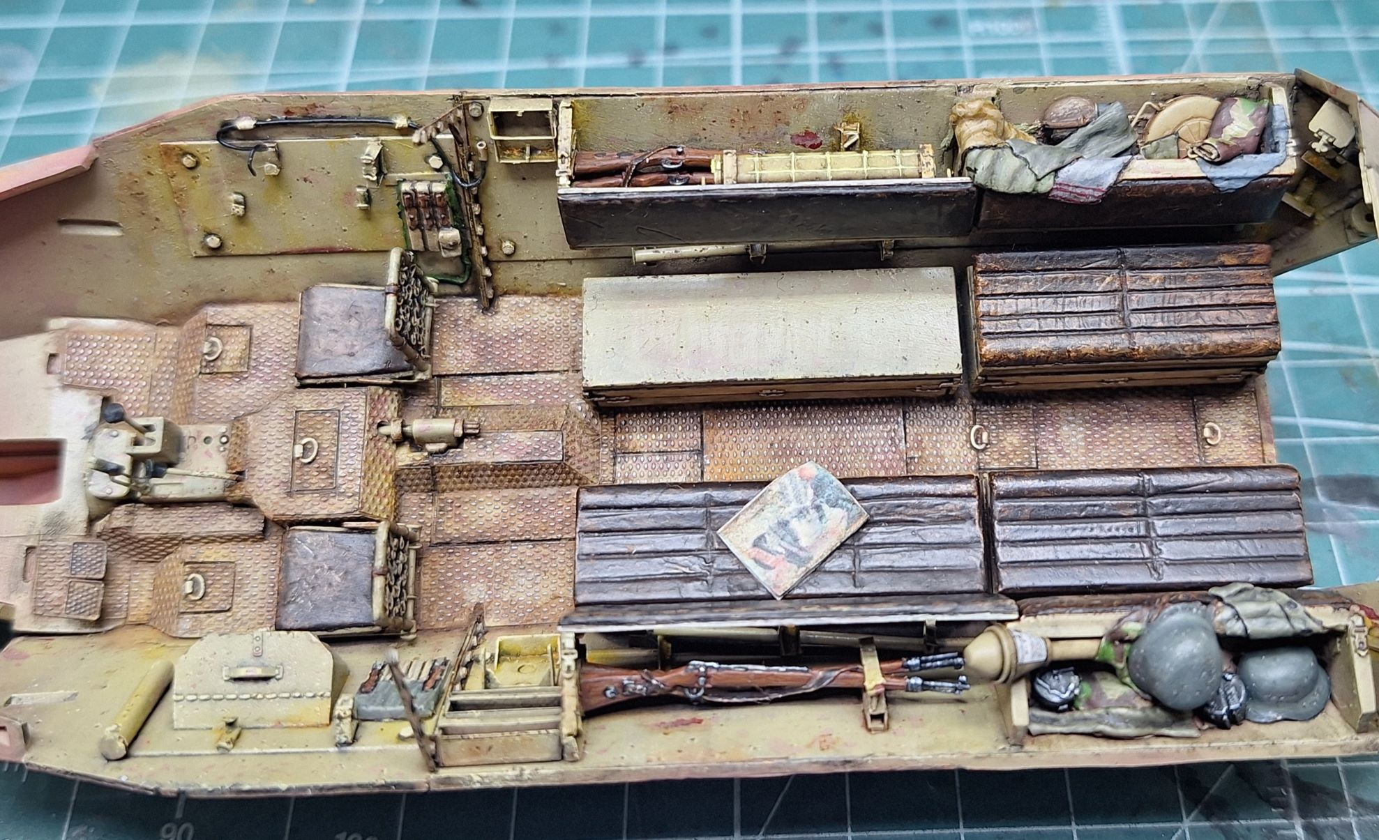

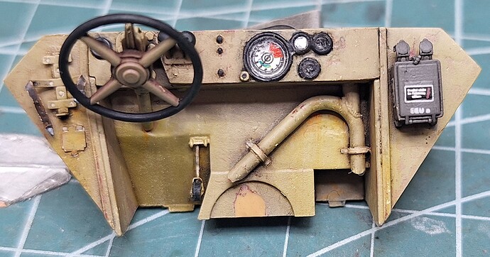

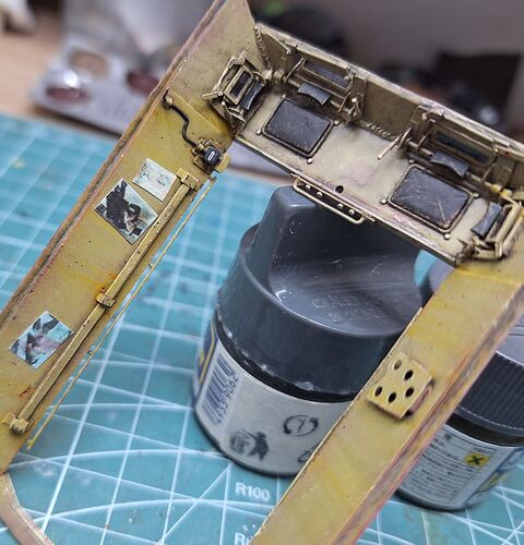

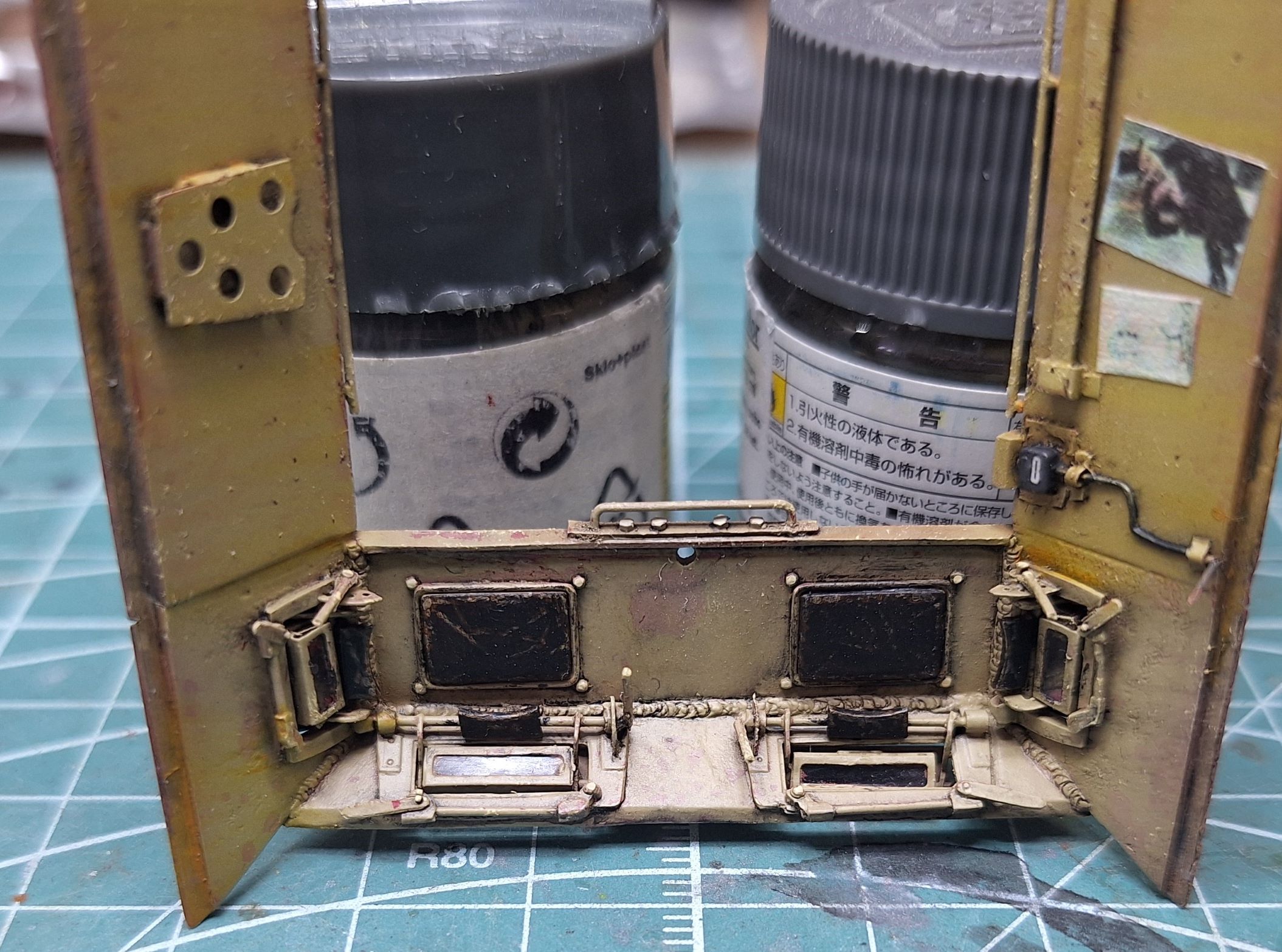

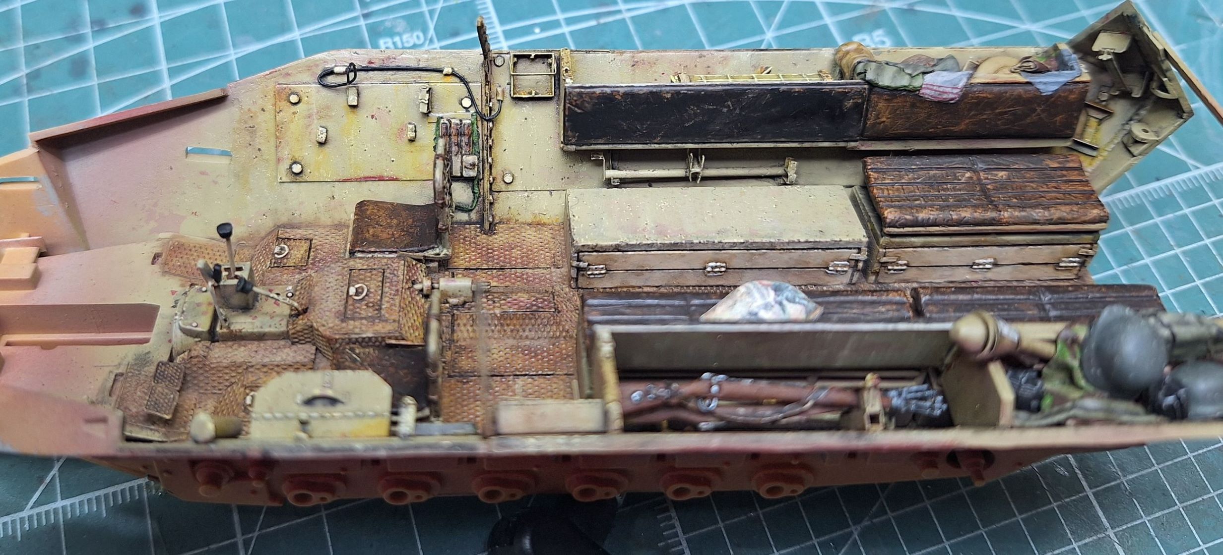

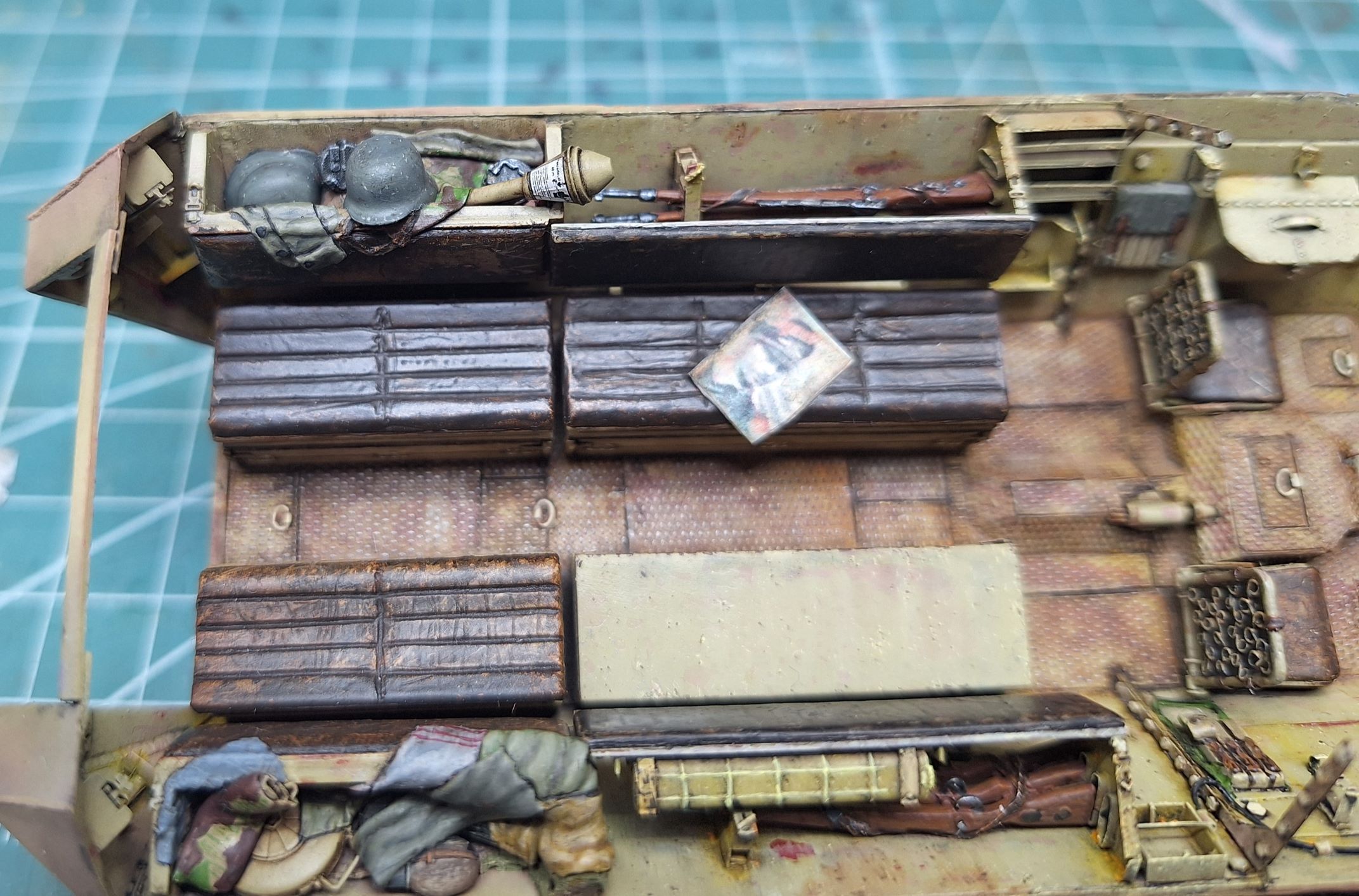

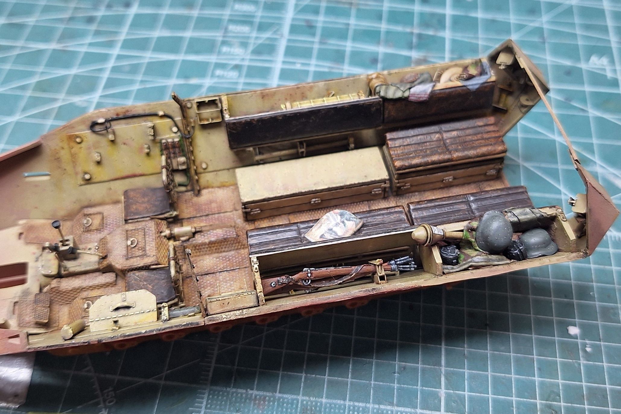

Here is my current build. After one year continuous process it´s almost finish for interior painting. Just only few details need to be added. My idea is vehicle deployed in France (Normandy) 1944. I´ve found some camouflage scheme for this version (Pz.Gren.Div. Lehr., decal.set STAR DECALS/35-C 1130). What was the biggest issue it´s fitting top and bottom part of body. That´s why I decided to cut out front and rear top of body. I also have some troubles with soldring 0.3mm copper wire. Well have a look on the pictures. Any of comments will be appriciated.

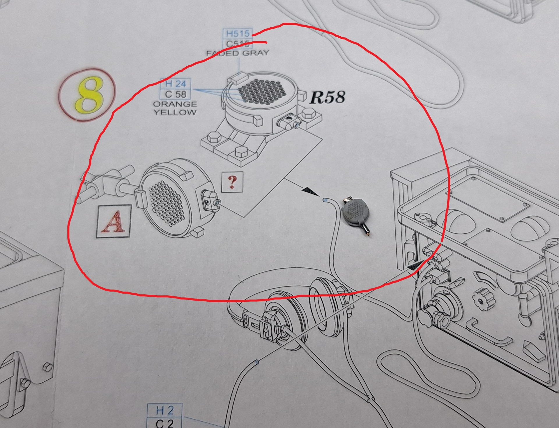

Now I´m thinking where to place loudspeaker L.S.Fu.a

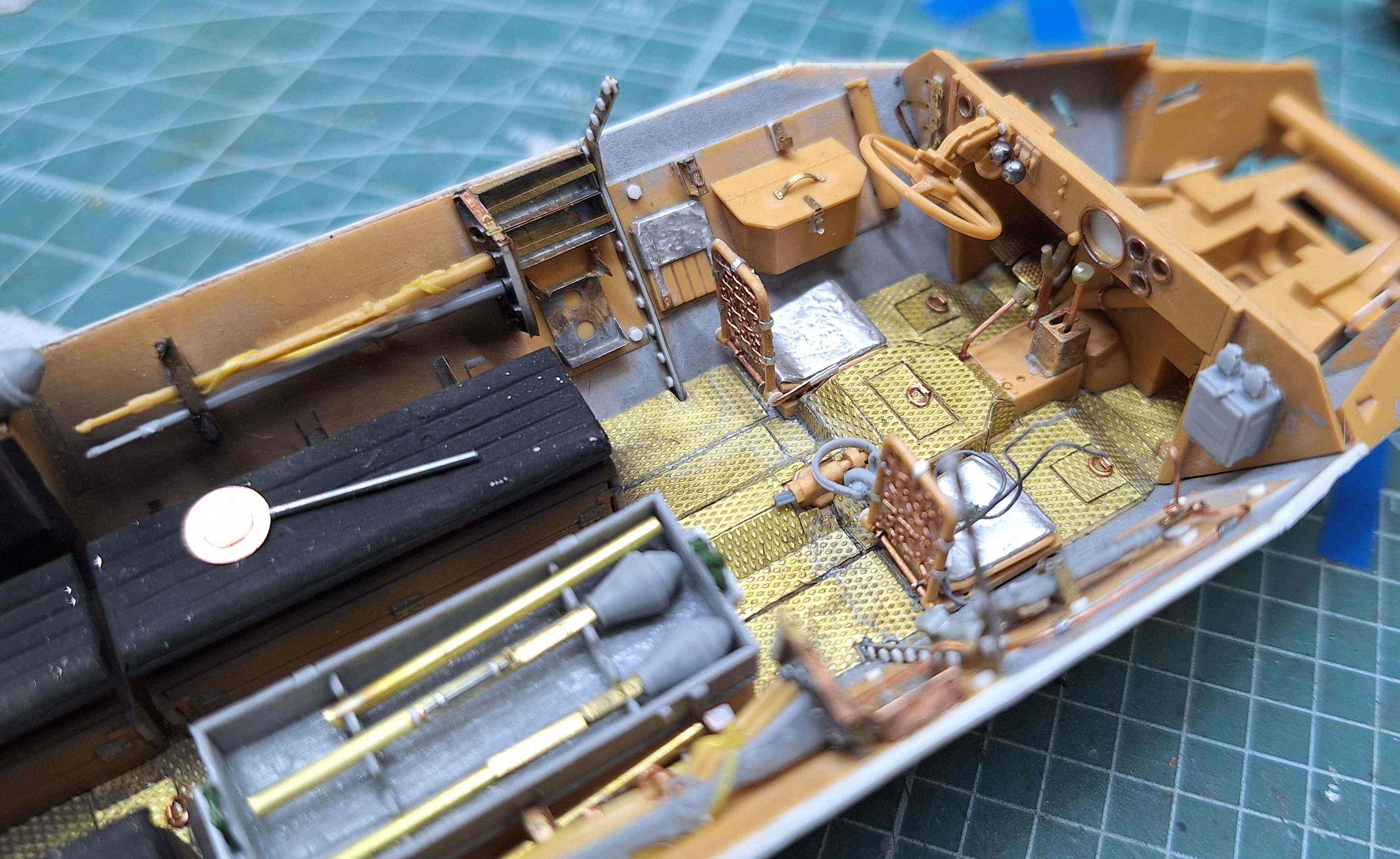

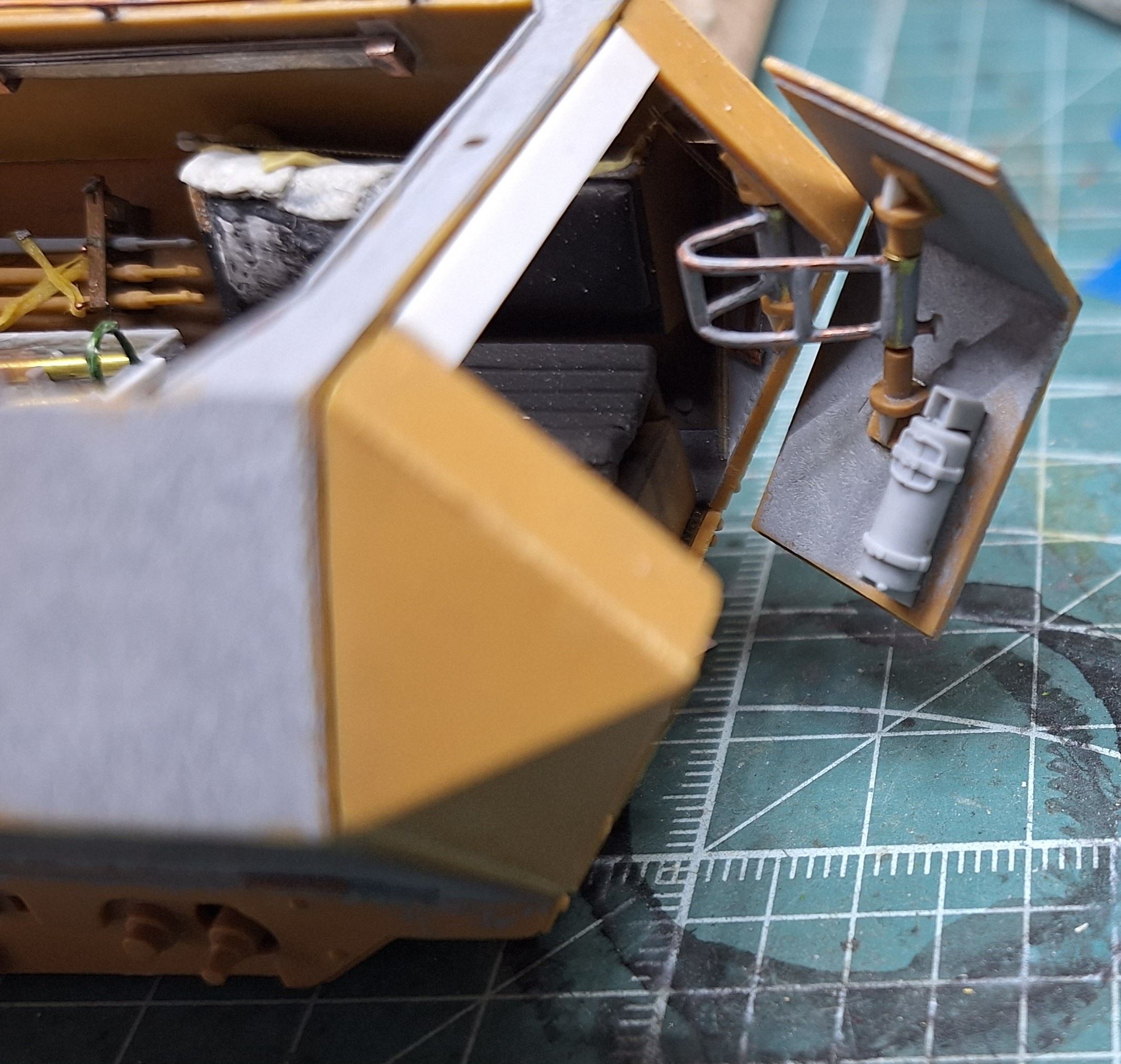

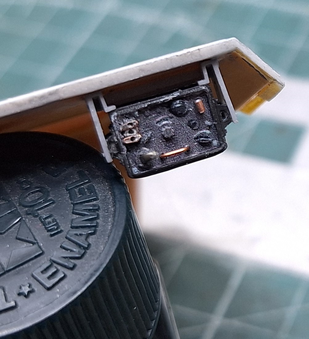

WOW! Did the folding handles for the anti-slip flooring come with the etch or was that something you added to it? I was particularly amazed by the etch for the armored window covers which I did not think came with the kit nor the handle and locking mechanism for the rear doors. Where did they come from?
Folding handles for the anti slip flooring were made from the scratch. Handle and locking mechanism were made from the scratch. Armored win.covers is particulary by Eduard photo etched set and particulary made form the scratch.

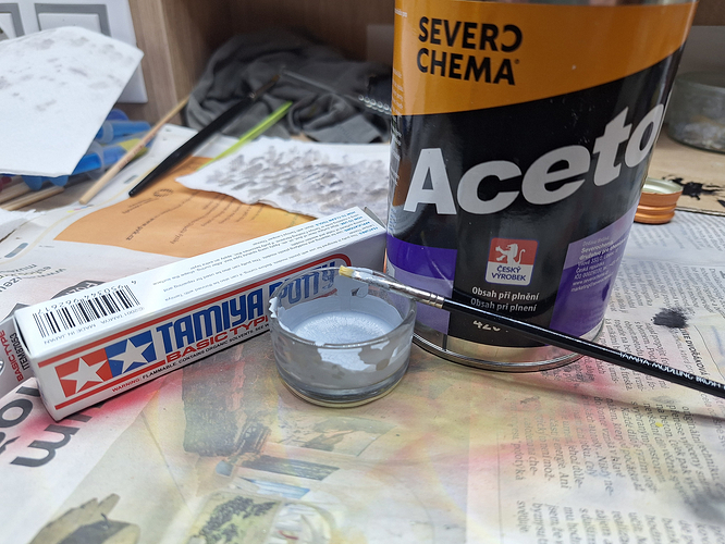

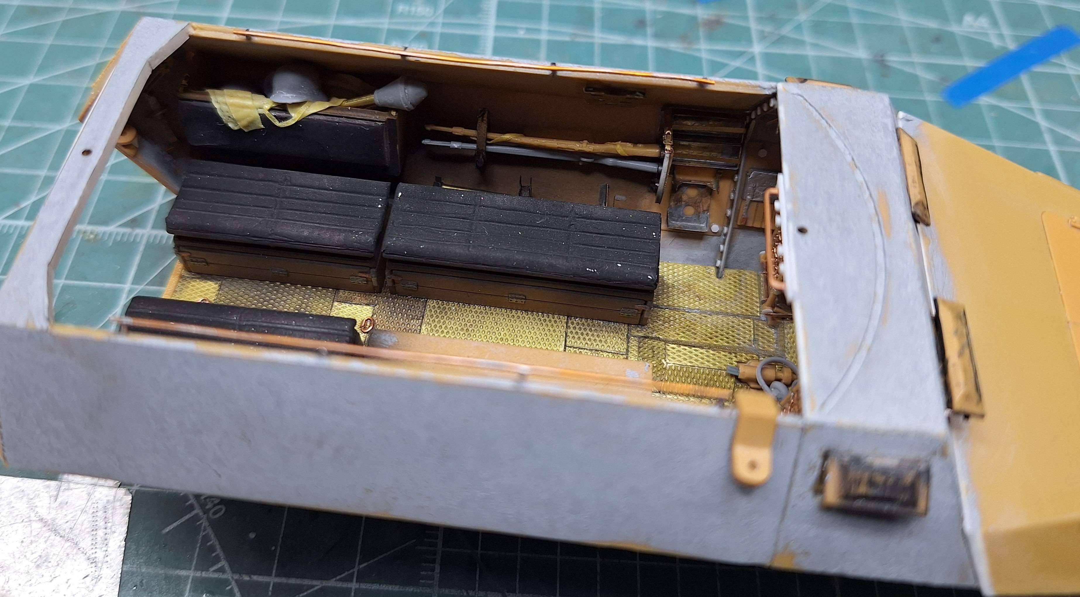

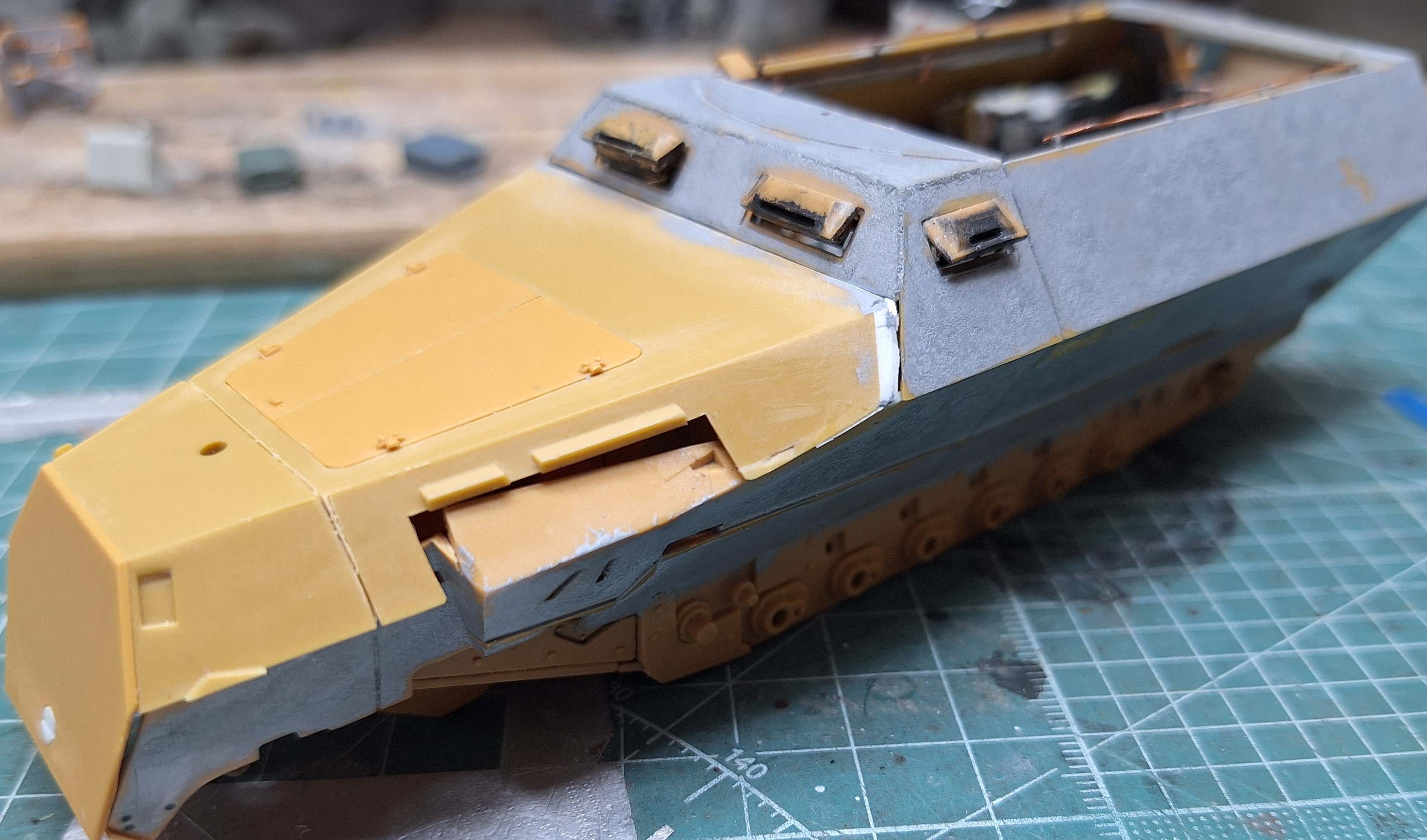

I’ve seen this method/application around the site onn builds and always have wondered; The grey material you apply to gain different texture on the hull body, what is that and how do you apply it?
I have recently bought Mr. Surfacer 5000 putty and love it for some things, but I’ve never been able to apply it as cleanly as seen here.
What surface product, and what do you use to apply it?
Hi Nate_W. Thank you for your post since it motivates me much. Yes AFV Club requires more effort then I expected but stil feasible.
Well grey material represents Rolled homogeneous armor. I use tamiya grey putty, diluted in aceton to obtain a dilute solution. Than I apply it by the old brush direct on the surface of a model. After drying up I send it by “water” sandpaper 1000.
I would say You thought Mr.Surf.500 this is not bad as well but may be more suitable for creating surface of casting parts.
Thank you very much for your reply.
Yes, my mistake, I have Mr. Surfacer 500. I had seen it used to modify textures.
Although I want to try the Mr. Surfacer 1000/1500, I am definitely going to try what you outlined,
Taking Tamiya putty and diluting in acetone and applying with an old brush.
Thank you very much for the helpful photo.
One last question: What did you mean by “After drying up I send it by “water” sandpaper 1000”?
I understand you let it dry and then sand with 1000 grit but what about the water? Just curious what you meant by that water bit.
Thanks again!.
Hi Nate, sure thing, anytime :slight_smile:
I thought like this, that 1000grit sandpaper normaly works together with the water. Sometimes it,s called like water sandpaper and its tipical thing for higher level of grit.
Better now?

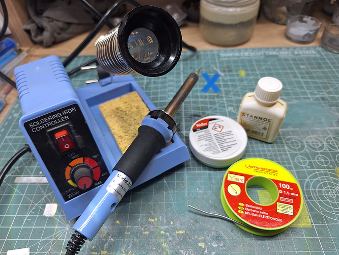

I have both a WinWing URSA Minor joystick to repair (USB-C port broke off) and a bunch of Legend and Lion Roar PE sets I need to build.
I want to get into Micro Soldering but am really intimidated by it.
Your PE soldered parts look phenomenal
What soldering tool do you have, and do you recommend it for someone starting out?
Any micro soldering advice you wish you would have known starting out?
Hi, there is my soldering tool. I,d say nothing special. The most important is setting of the temperature. Soldering of any possible sheetmetal is usually with no problem. But in case I solder copper wire it’s always trouble to me.

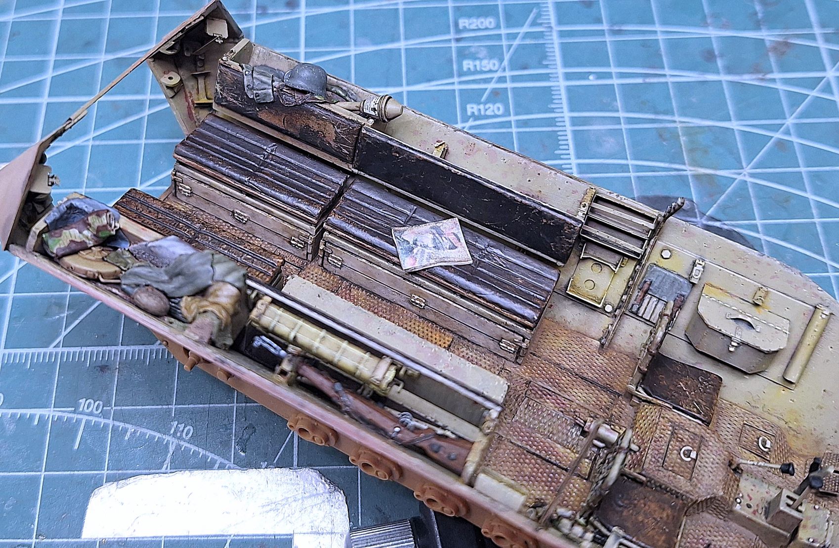

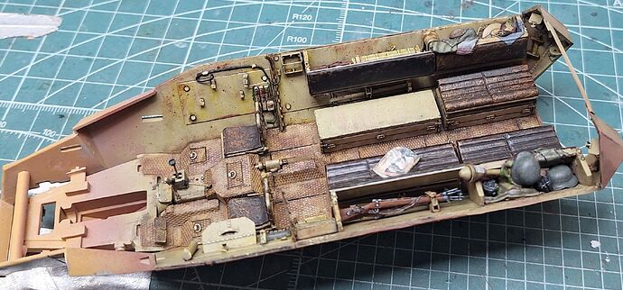

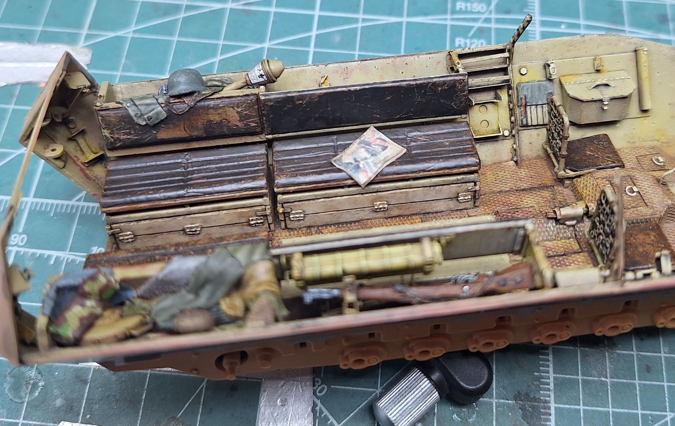

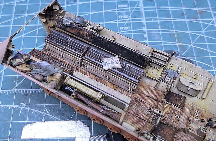

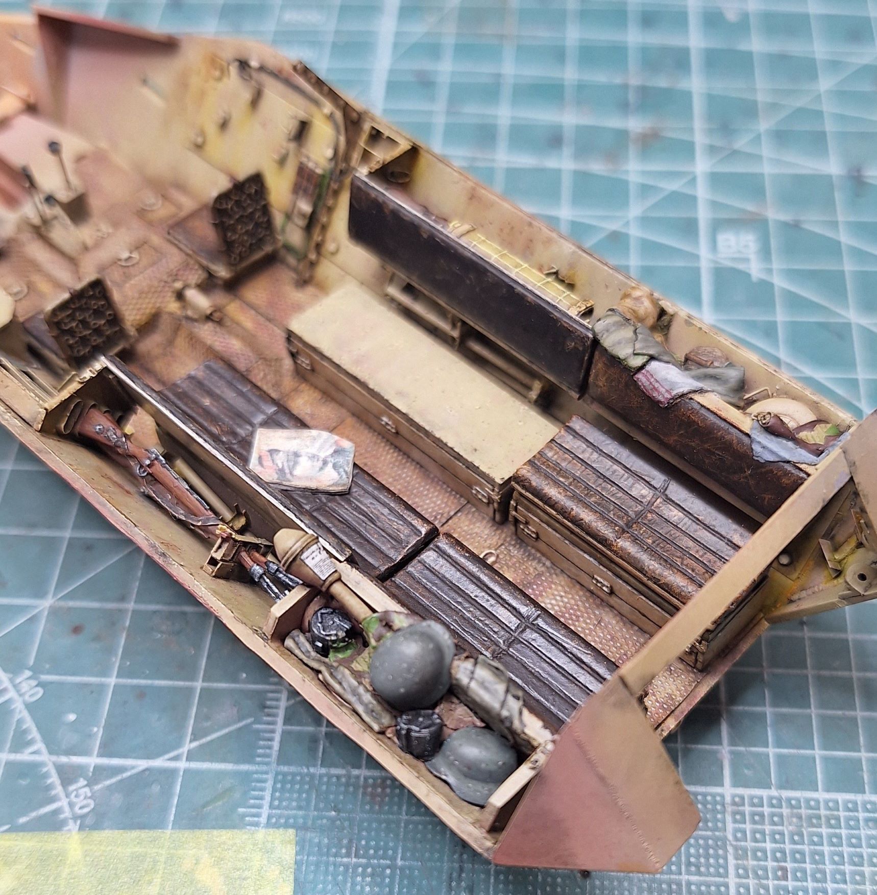

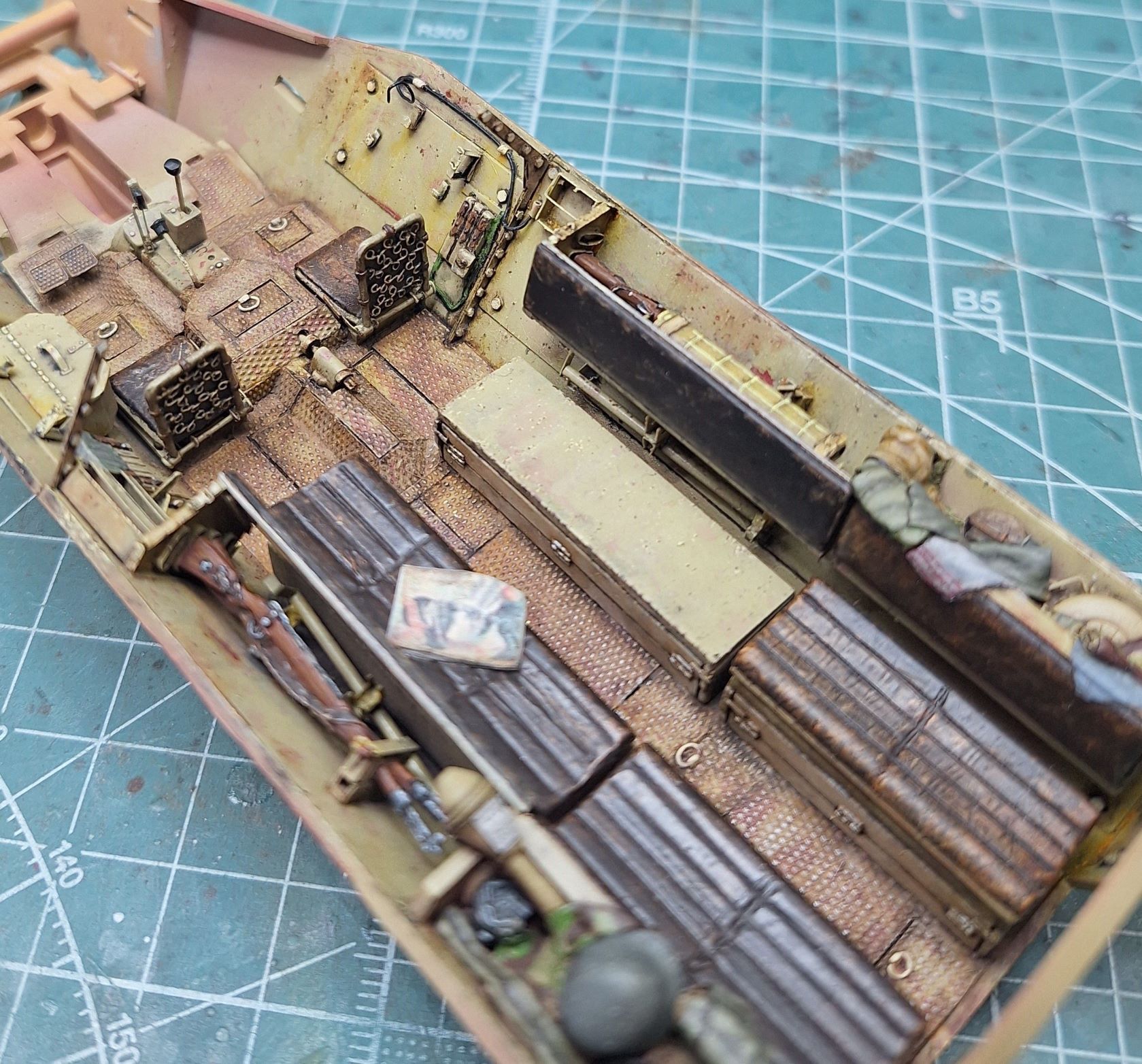

Hello, after two months there is a small progres in my work. So interior is already painted. And wedding party comming up, that means assembling parts of car body together and looking forward especially for chassis montage.
