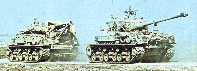

Yes. Dusty bare scoured steel.

The tracks and even the belly of the hull depending on the sand are often near polished during movement and after a nights non use they magically show rust.
It’s not really “magic”, it’s just condensation from the cool night air. The moisture then forms a thin layer of rust.

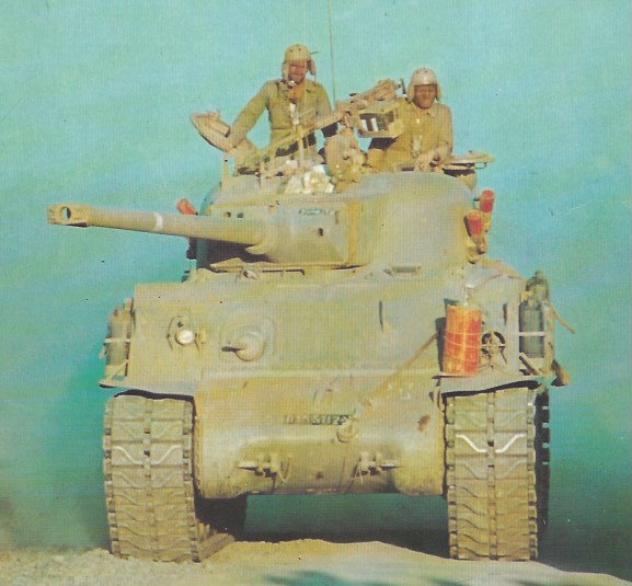

I like this picture……it shows very clearly the top of the tires black from the tracks…and the front of the tires dusty.
