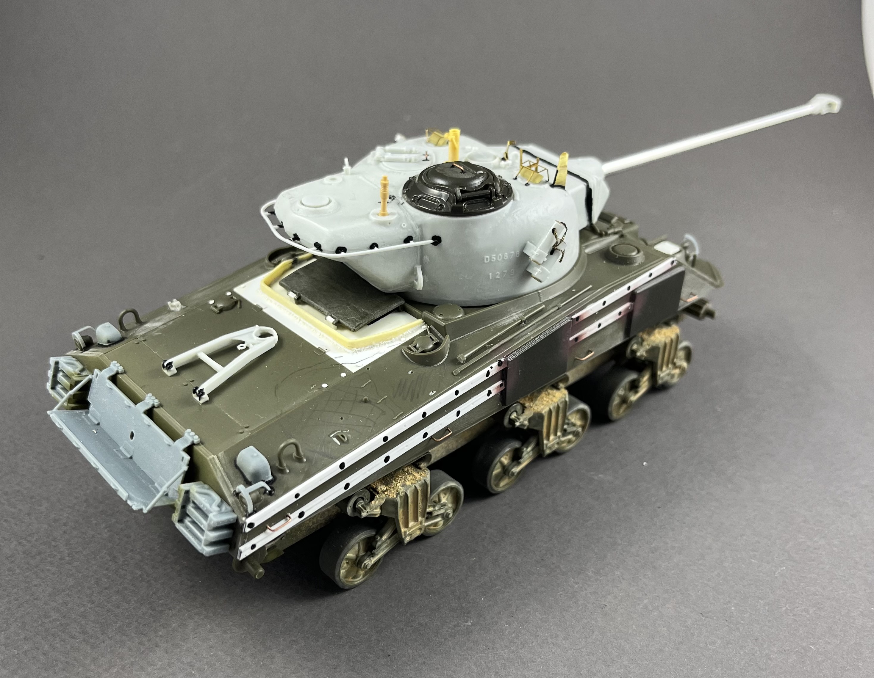

Started painting too…but might just find a late cover then and do some surgery. Rather it be correct.
@Tiger_III_L
I’d leave be unless if you’re modeling a specific vehicle that had the late housing. There must’ve been some that had a mix of the earlier FDAs, no?
Here, found one! This is clearly a Firely IC with the same FDA as on yours
Interesting tracks on this one. They look like T-41?
Problem is, I don’t have any really good frontal pics of the one I want to model. The crew is standing infront of the cover and its dark. Though, on a closer look now, I think I see the little horizontal bar connected to the smaller shackle mount.
@Tiger_III_L
Does that mean late FDA? I edited my previous post with a clear shot of one with the same combination of features as yours.
Yes, looks like it would be the later type having the 2 shackle mounts and the bar foot step.
@Tiger_III_L
The only positive I can say about you having to remove that FDA is that you’re working with an Asuka and the FDA goes on like the real thing so using extra thin trick on the bolt strip area on the top, sides and bottom and it should slide right off.
Thankfully it was an easy process. Already done switching them out. Primed and gotta paint the FDA now. Then back to where I was.

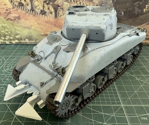

Update on the Border Models M4A1 76w
CUTE!! This is the way!

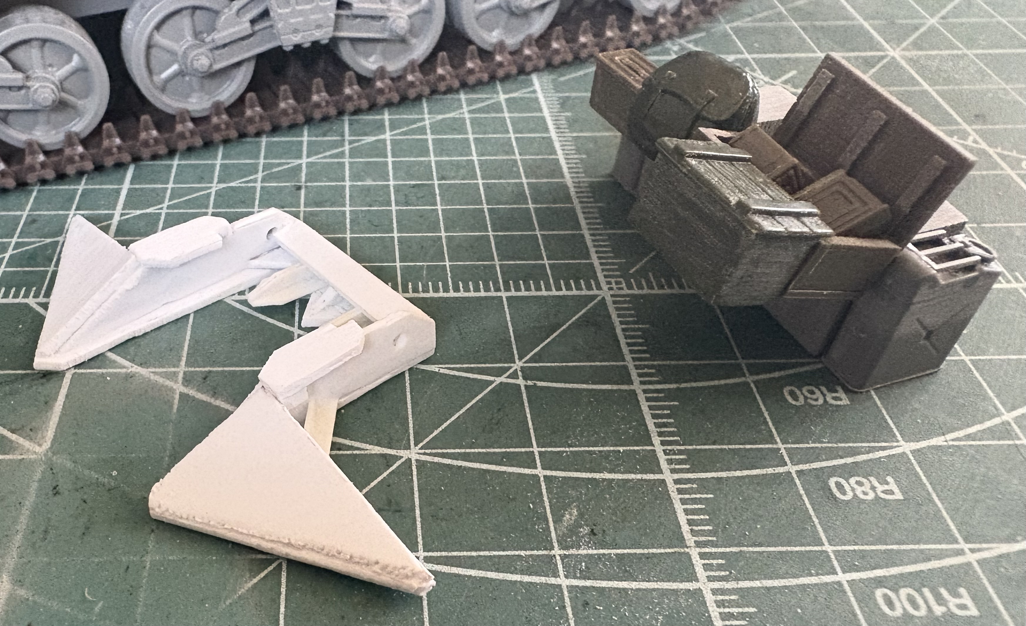

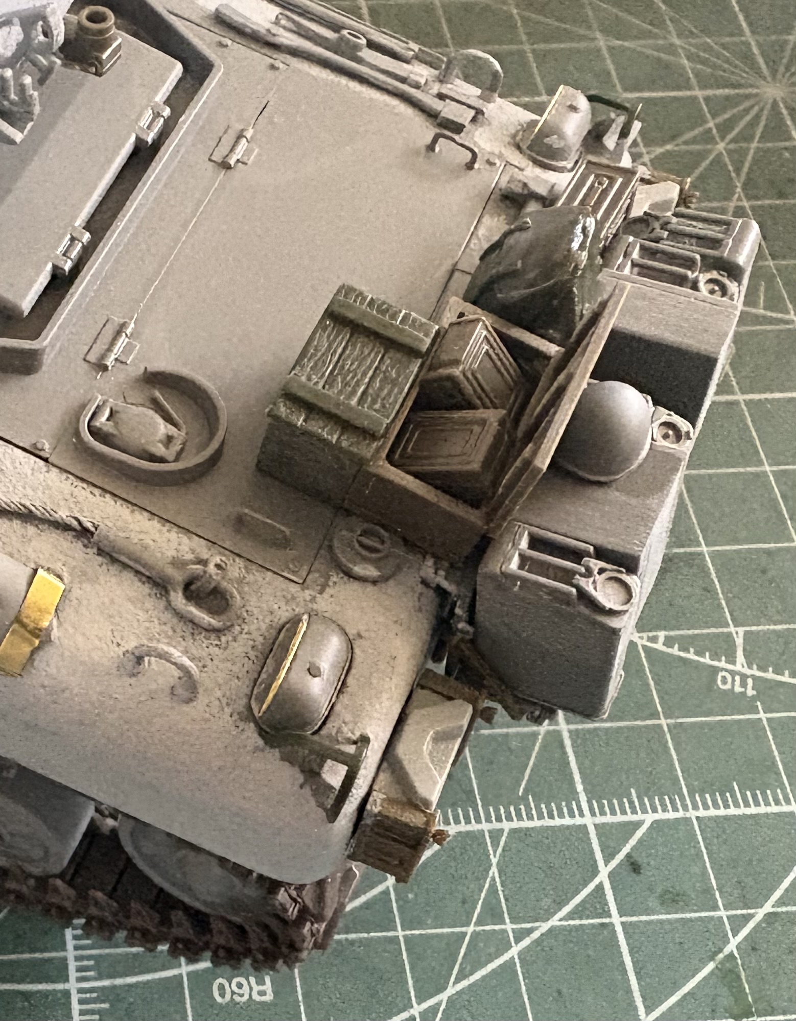

Adding stowage and weathering the hedgerow device. Also corrected the gun crutch as the kit has you mount it 3.5mm too low.
Some more detailing, almost ready to receive painting:

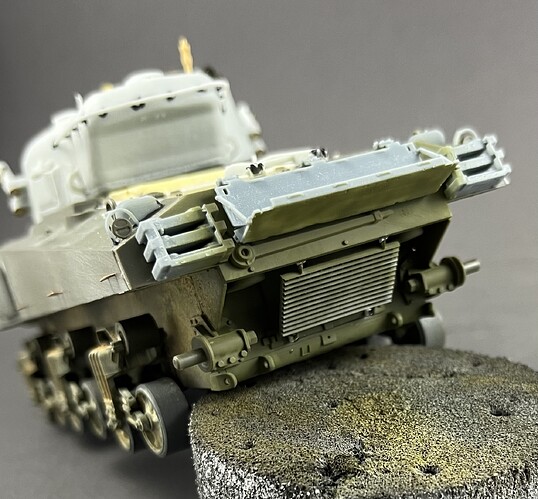

Next time I convert a non-radial Sherman to Continental I’ll be less picky about the engine doors as they get out of sight once the grill is on (or no grill at all)…

I have to admit that this kit has exceeded my expectations. I just wanted to see if it would build into a decent “operation cobra” M4A1 76mm and I think the answer is definitely yes. Who makes decals for these tanks? Unfortunately and despite including some nice stuff like link to link tracks that clean and build like RHPS clones (good thing), resin brush guards, metal barrel, some fun stowage, PE, and other details. Even after that BM gets an F for decals and an F for leaving out details like the spare track holders, the sand shield brackets, and not one single crewman to work with. The sand shield bracket thing is really odd considering that their 75mm Sherman includes that detail.
Just a word of caution. The Cradle on the .50 is wrong.
That’s a glaring error in the assembly instructions.
you attached it to the location where the front mounting pin goes through the front of the machine gun.

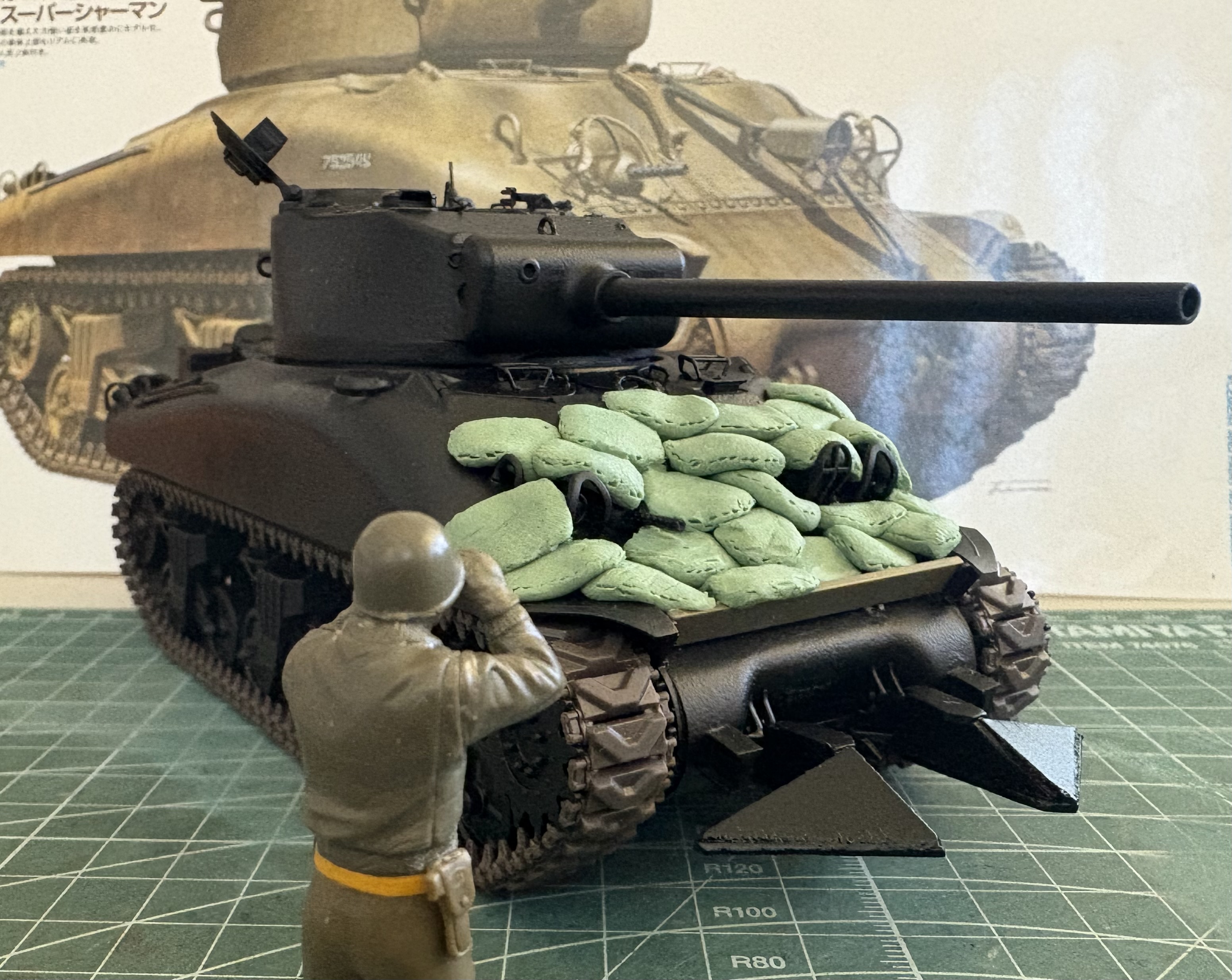

Small update on the BM kit.
Some of these had sandbags.
If your guy is that close to the tank, does he really need binoculars to see it? I thought that’d make him 4F… :rofl:
You’ve done a great job on that kit - I love the sandbags and hedge-cutter device.
