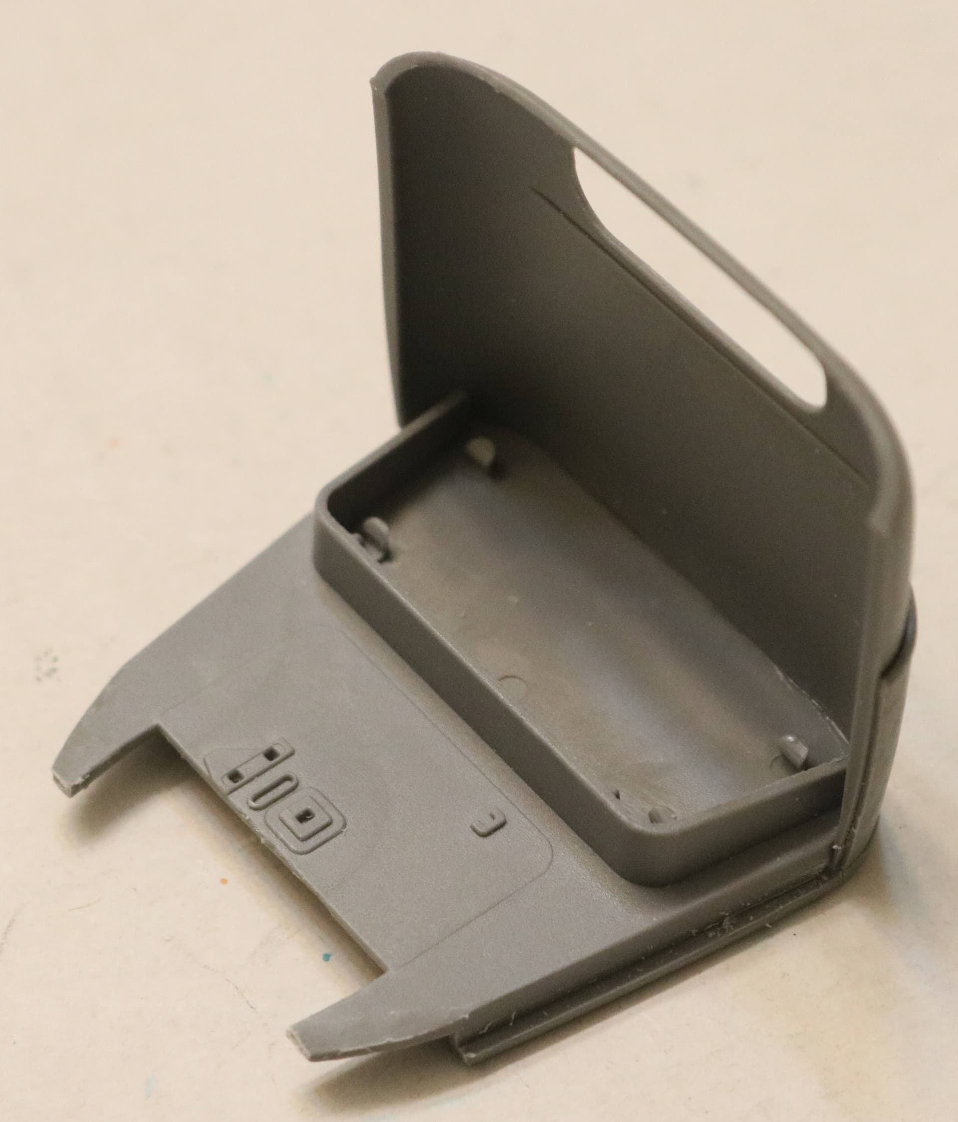

Here are the first three pieces of the cab glued together:
The very nice floorboard which includes the seat base, the lower outside back of the cab and the full interior rear liner of the cab.
And now here are the next three pieces: Firewall, [exterior cowl + windshield surround + roof] and finally the interior headliner with overhead vents.
And unlike most other manufacture’s cabs (can’t comment on the ICM) this one does not fight you while going together!
Here it is below sitting nicely together, just dry fitted and also precisely aligned on the chassis frame, no muss, no fuss, no fight!

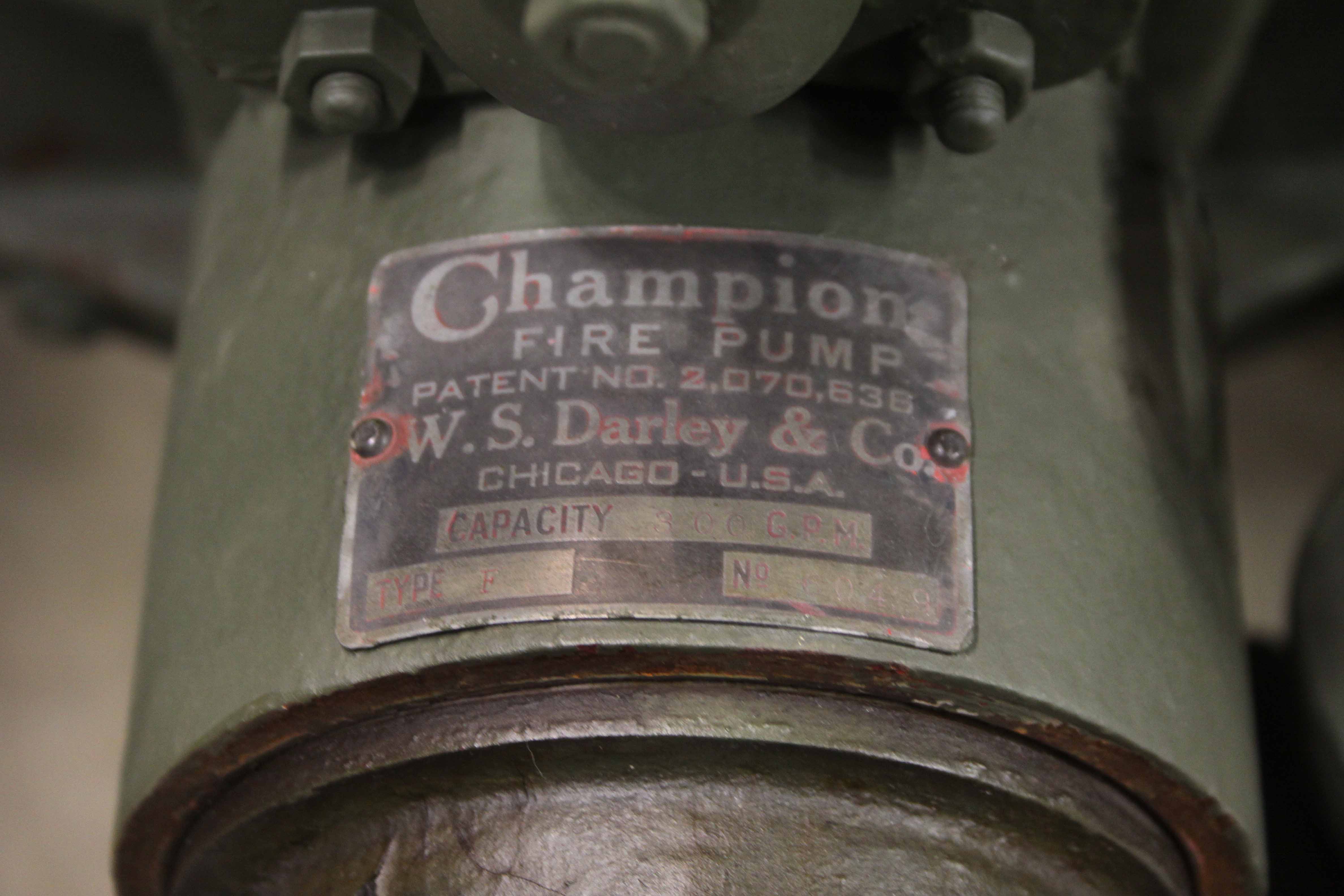

Before I go any further I also want to give honors and accolades to Tom Cromwell for his 3D creation of the Darley Champion water pump that I am featuring here on this model.
He endured many months of my encouragements and reference submissions while at the same time I provided NOT ONE definitive measurement for him to work from. I had the vehicle right in front of me at the MVPA show and it never once occurred to me to take a measurement! So Dumb!
A mistake I will not be making in the future!
Here are more shots of Tom’s creation:
I need to find some “white background” dial decals.
Also here is the link to Tom’s page on the Shapeways 3D site:
