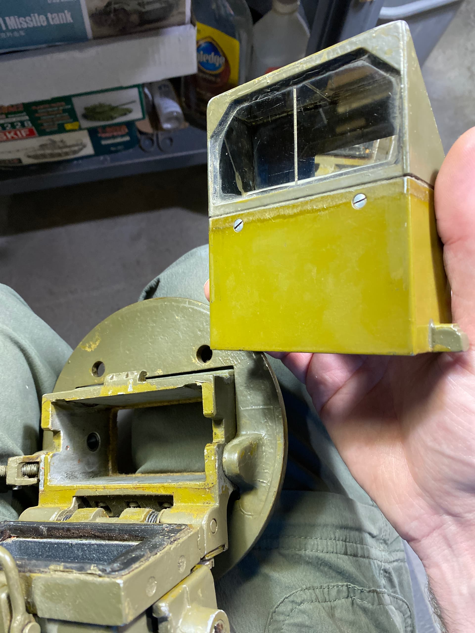

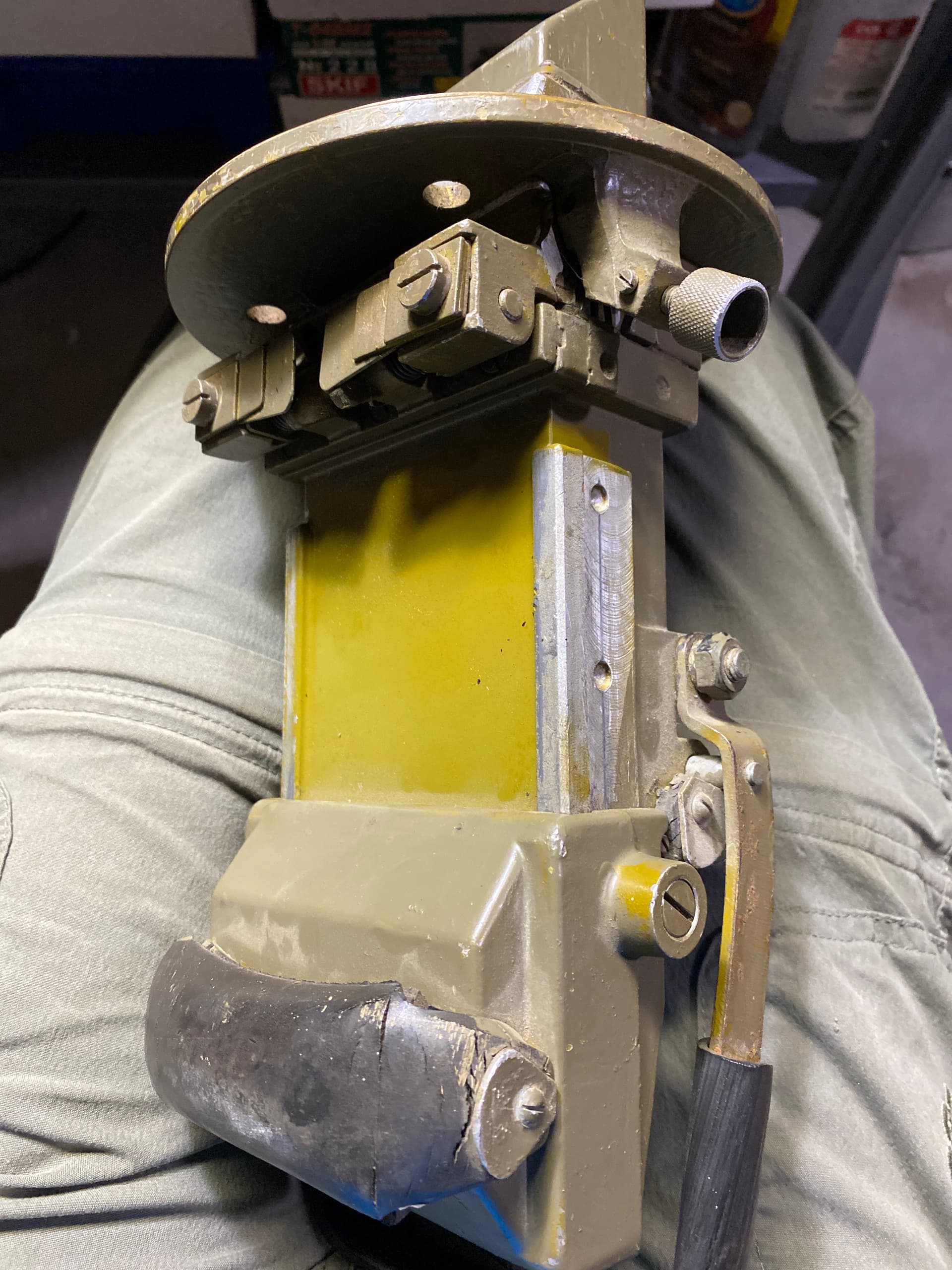

My particular Mk 4 had a repaint at some point and sports two different greens, I’ll get a photo when I return home.
This means that the MK-4 was part of a tank undergoing major repairs/modernization at one of the armored vehicle repair plants (BTRZ). The tanks were repainted, and their observation devices were repainted accordingly.

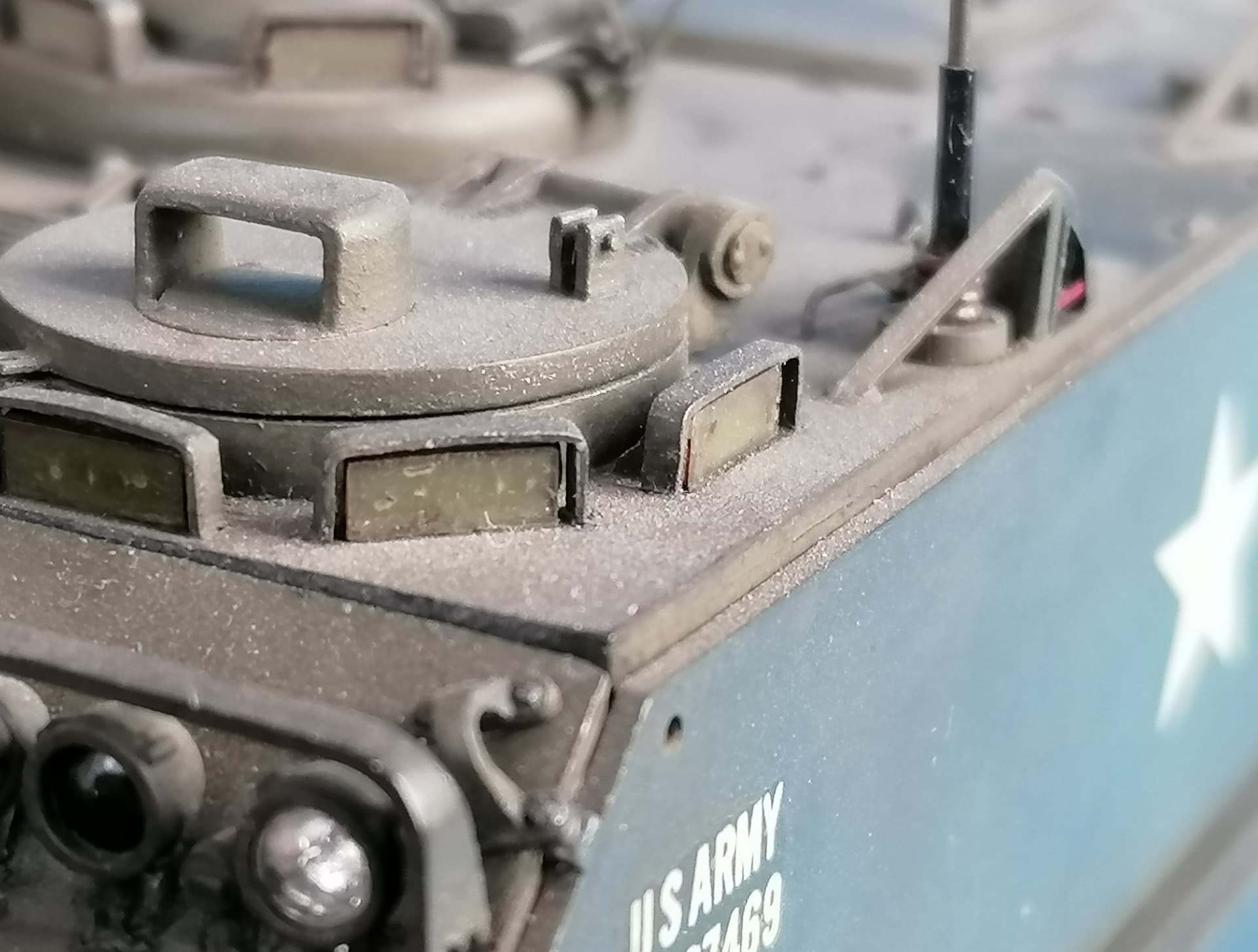

Rather late to the party, but here’s what I do for periscopes and vision blocks:
I use slices of acetate (bubble packs) and stick them to the kit’s “glass”. My first attempts were on olive-colored styrene, and I used plastic cement to “melt” them on:
Then I started painting one surface of the acetate black and using the wet paint as glue:

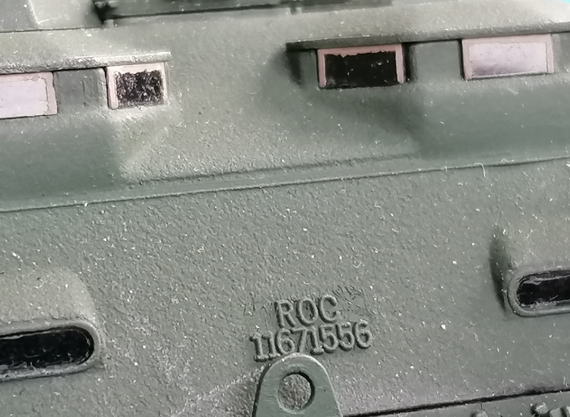

For the only anti-laser coating I’ve made, I used pieces from the outer wrap of a pack of cookies (sorry, forgot what brand):
