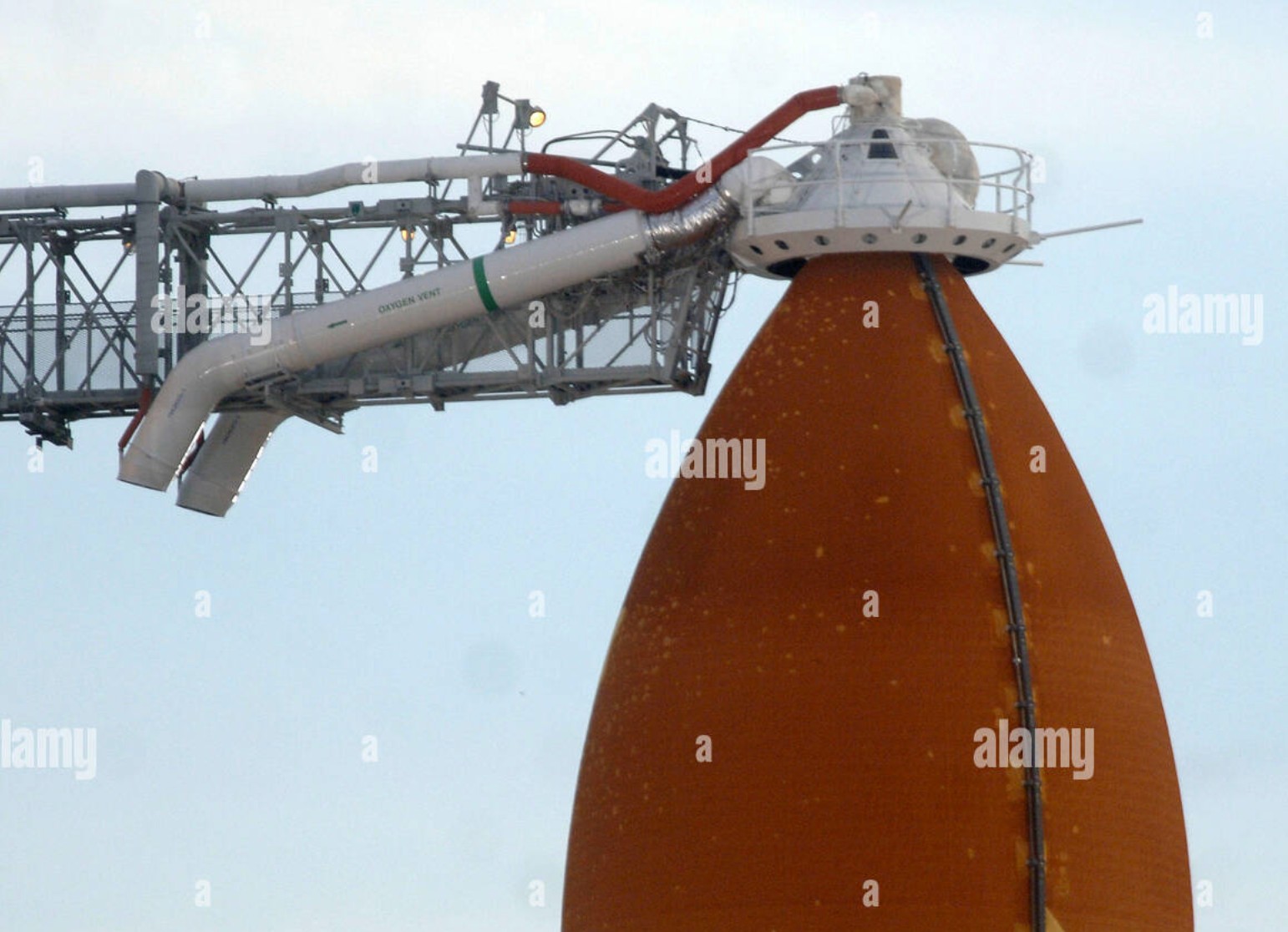

do you know what ET this is, I think one of the later missions, right?

Manfred- No. Sorry. I do not know which tank this one was as I just liked the beanie cap image.
Yep Stuart, it’s really an amazing cap.

And finally still the comparison of the three Mix color shades with the reference photo, whereby the Mix-1 fits best to the brighter areas of the Closeouts.
In contrast, in my opinion at the Mix-2 for the LH2 tank,
and even more so at the Mix-3 for the Intertank is still missing a little bit of Orange.
These two color shades came out much better on paper, https://forum.raumfahrer.net/Smileys/yabb/huh.gif
wherefore I have still to modify their mixture by adding a bit more Orange.
