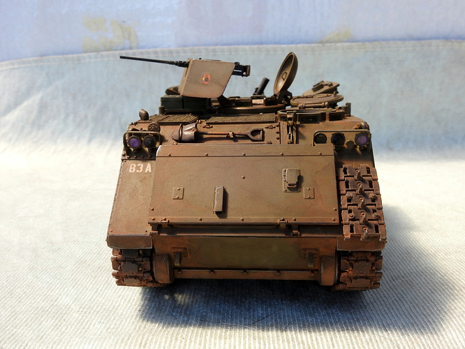

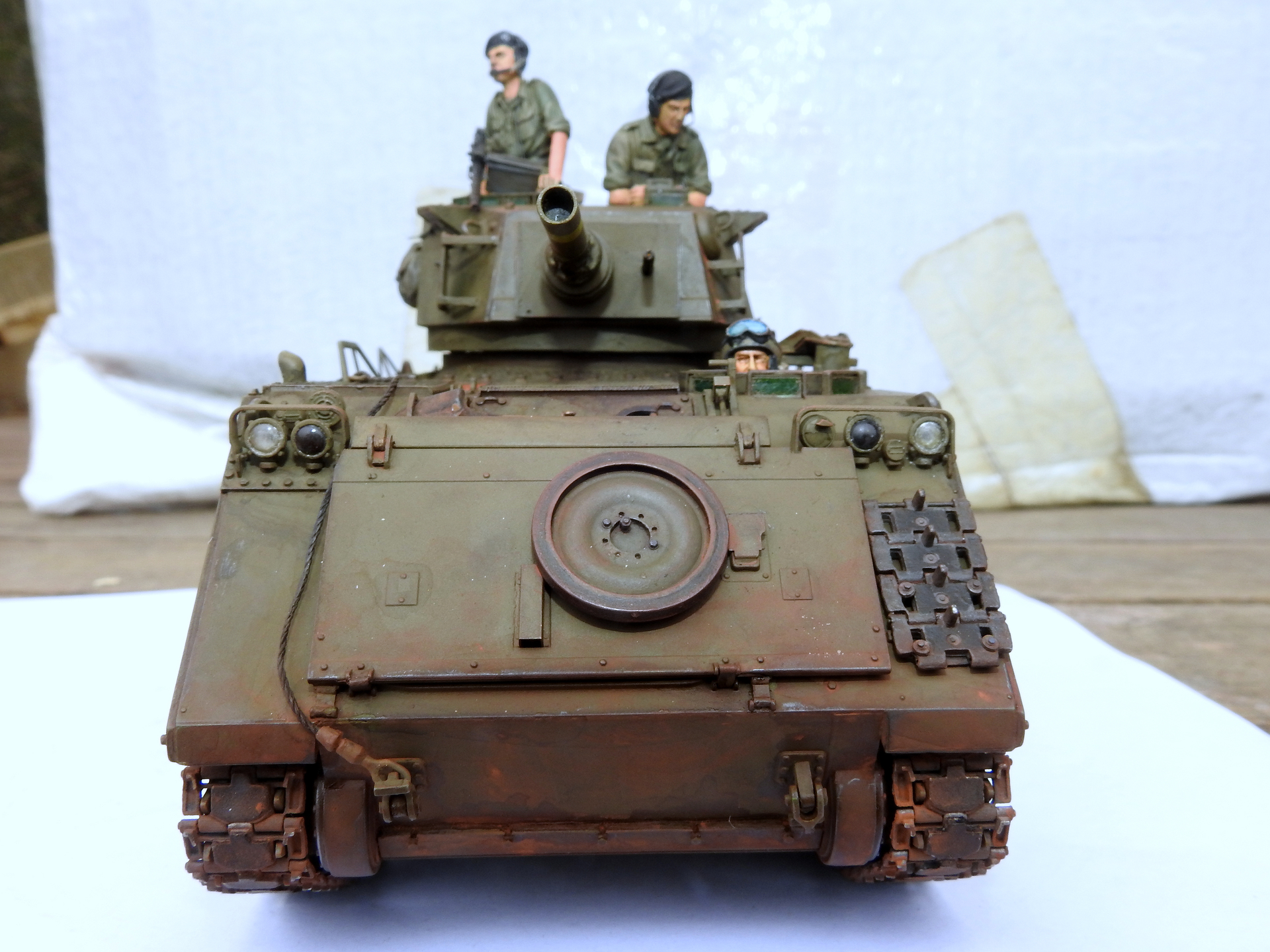

As has already been mentioned personal choice. I usually swap out the kit rubber band tracks and use individual links, currently I like Quick wheel, M113 tracks primarily as they do a damaged set which look good but also I like Friulmodel sets as they lend weight to the kit and look good. I have a set of Friulmodel Centurion tracks for an Aust. Centurion and compared these to the styrene set that came with Amusing’s STRV 104 and used the kit set as they looked fine to me and was a click together track. I am personally finding the the individual link sets contained in kit (while sometimes fiddly to put together, I have a 1/16 M5A1 Early and this requires 5 parts per link but that’s the hobby) quite acceptable and only buy a replacement if the replacement improves the look. The M113s in following photos are a couple of my recent builds and the first has Quick Wheel 3d printed tracks and the second (if memory is correct) has R Model metal links, to me both look good.
