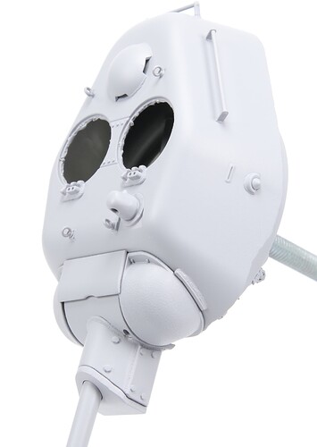

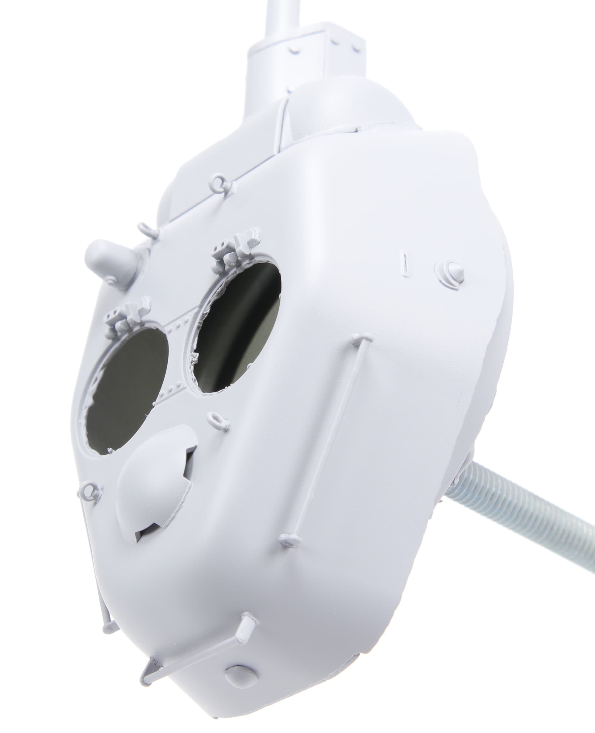

Today I want to talk about the method of applying primer. When I paint or prime, I choose a certain part of the model, which is a separate element, and paint and prime only it. If there is another element structurally next to this element, and pollen falls on it, then I prime it too. I start with the most difficult-to-reach areas and then finish painting the easy areas. According to the principle “paint over the difficult, the rest will be painted over on its own.” This approach allows you to apply paint and varnish material relatively evenly, without flooding small parts and without making puddles.
I usually prime and paint “fat and wet.” That is, quite a lot of primer over the entire surface of the part (element or part of the model). And I apply several layers. Sometimes a lot of layers. Not just “pouring” it on once, but evenly layer by layer. I do it so that the surface becomes wet over its entire area. The effect of this is obvious. The paint material dries evenly, and the surface tension film becomes uniform and smooth after drying. I work quickly. If the paint has already dried in some place on the part, and I have not finished the work yet, then I return to this place and apply an additional layer, “connecting” the dry place with the wet one. That is, I try to make the entire surface wet throughout the entire area.
Here are a few photos as an example.

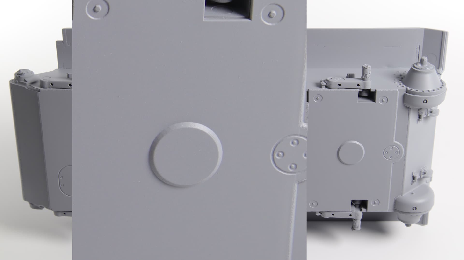

“Fat and wet”. The surface is uniformly smooth.

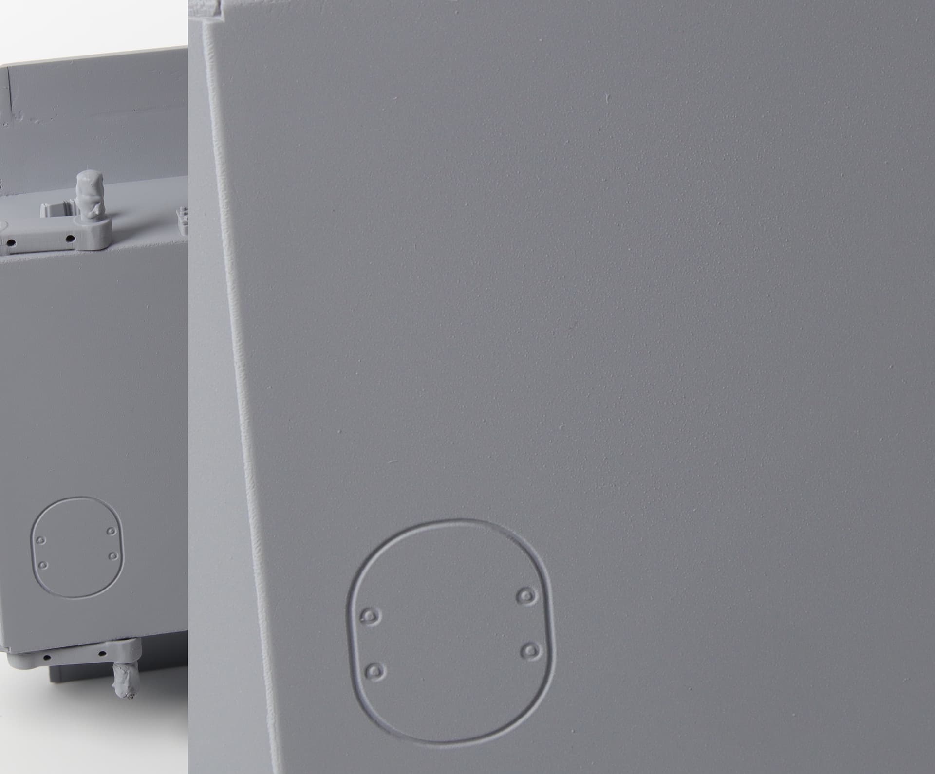

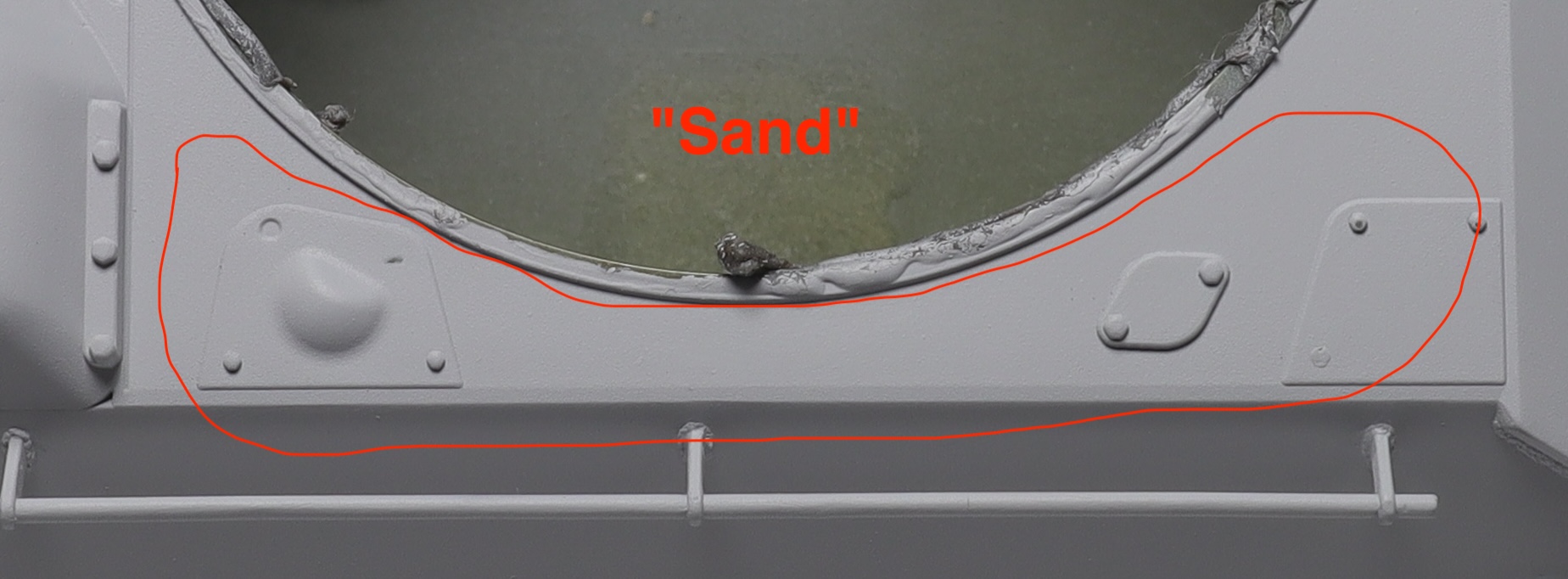

“Thin and dry”. It is clearly visible that due to the low density of the primer mixture, the primer particles do not merge with each other and have time to dry before a uniform film is formed. “Sand” appeared, the surface became rough.

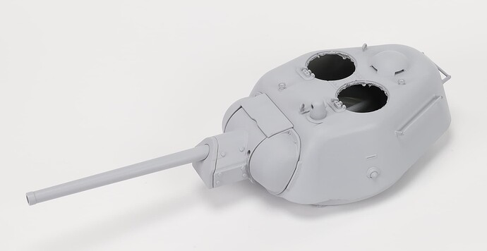

“Fat and wet”. The entire tank turret was painted as one element at a time. Many layers, high air consumption, high consumption of primer material.
“Fat and wet”.
The conclusion here is obvious. The most optimal method of application is “Fat and Wet”. And it is absolutely necessary to use a drying retarder.

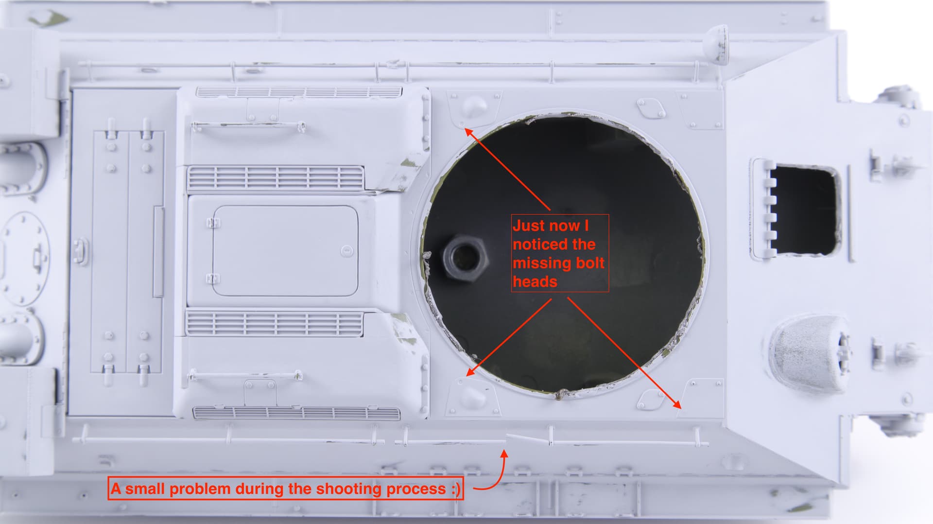

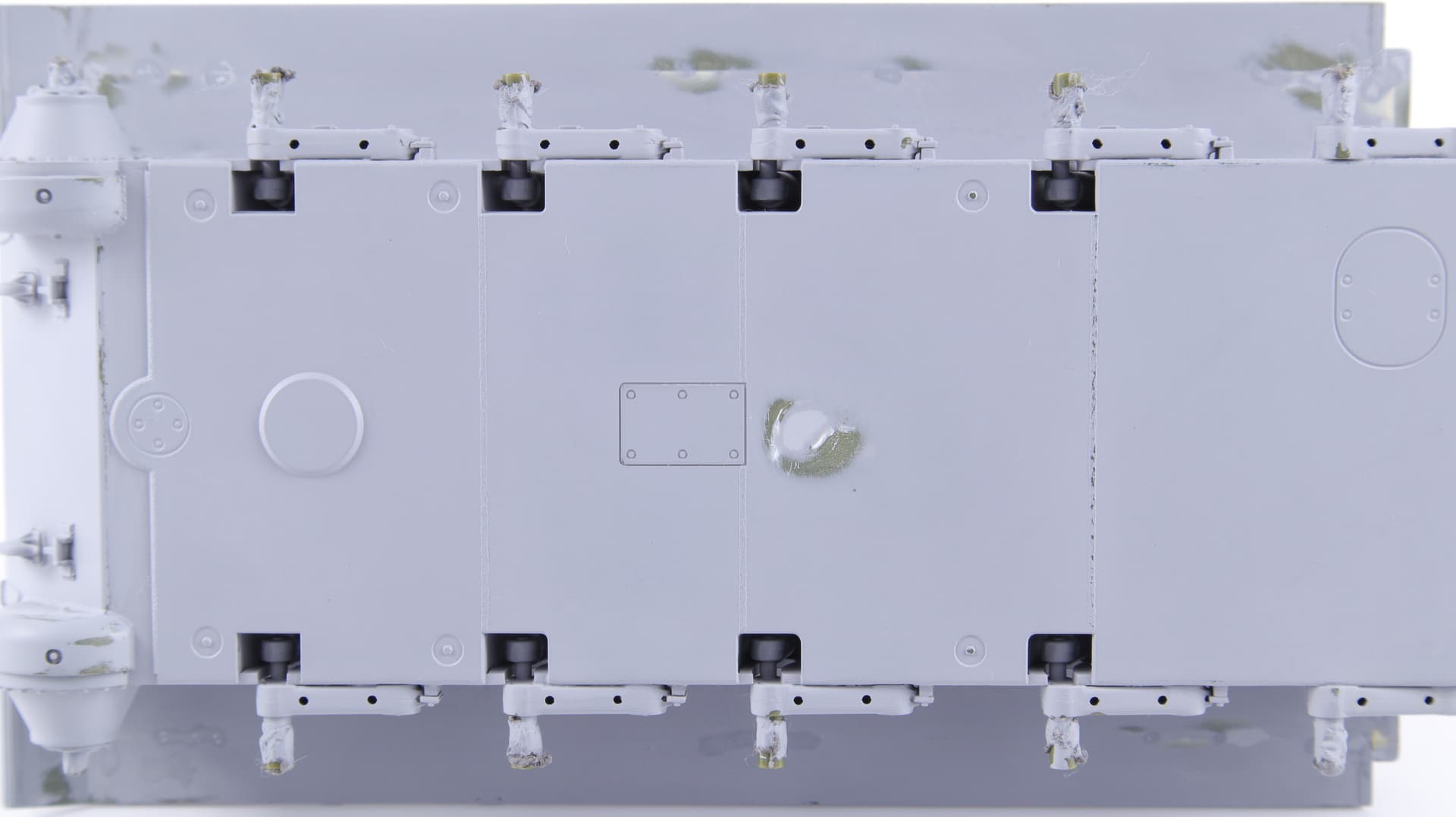

Primer, like nothing else, simply perfectly reveals all the inaccuracies in the work, all the casting defects, defects in the processing of parts, and the assembly of the model itself. What I missed or what I did not pay attention to during the assembly process, immediately becomes visible after priming. And some shortcomings simply scream - “Fix me!” :smile:

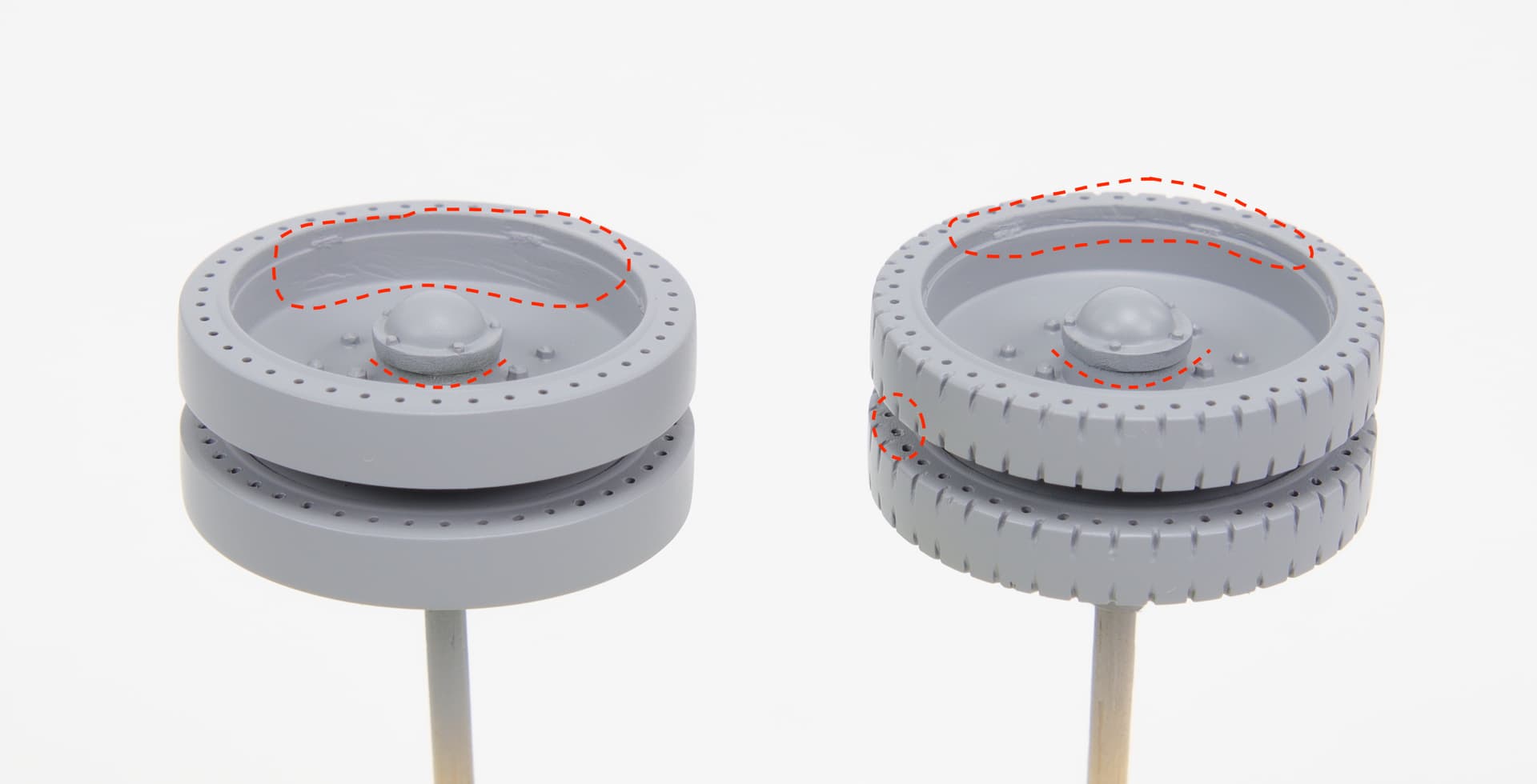

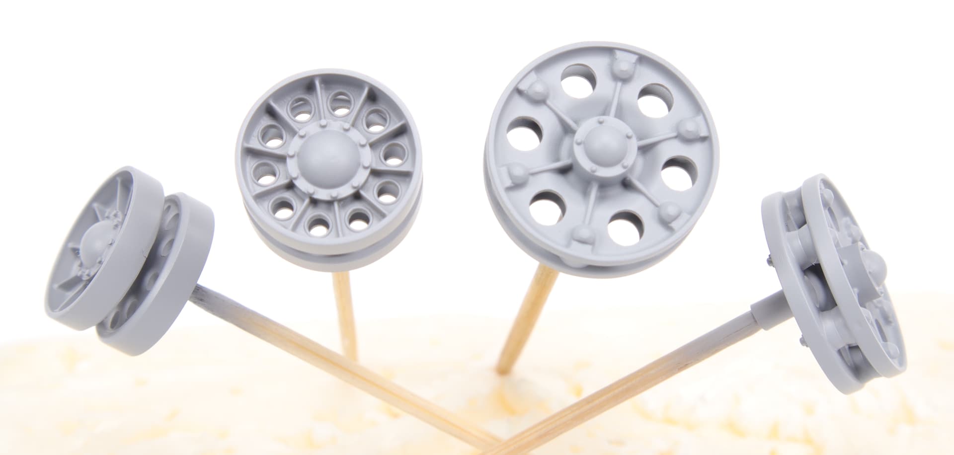

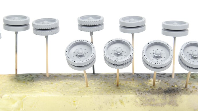

At first glance, everything seems to be normal. I see that from the front side, the perforation holes look quite normal. The tread cutting also looks good.
But upon closer inspection, I see that I very poorly eliminated the casting defects of the road wheels. There are too deep scratches from the knife. And it is difficult to fill them with primer so that it levels the surface. There are also small defects left after drilling the perforation holes on the inside of the road wheels. The hub caps are not completely primed.
And there are many such defects in all the details of the entire model.

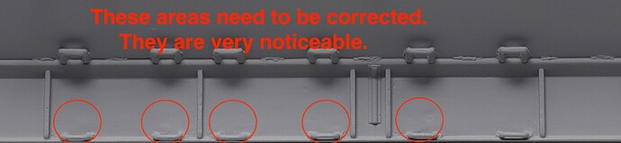

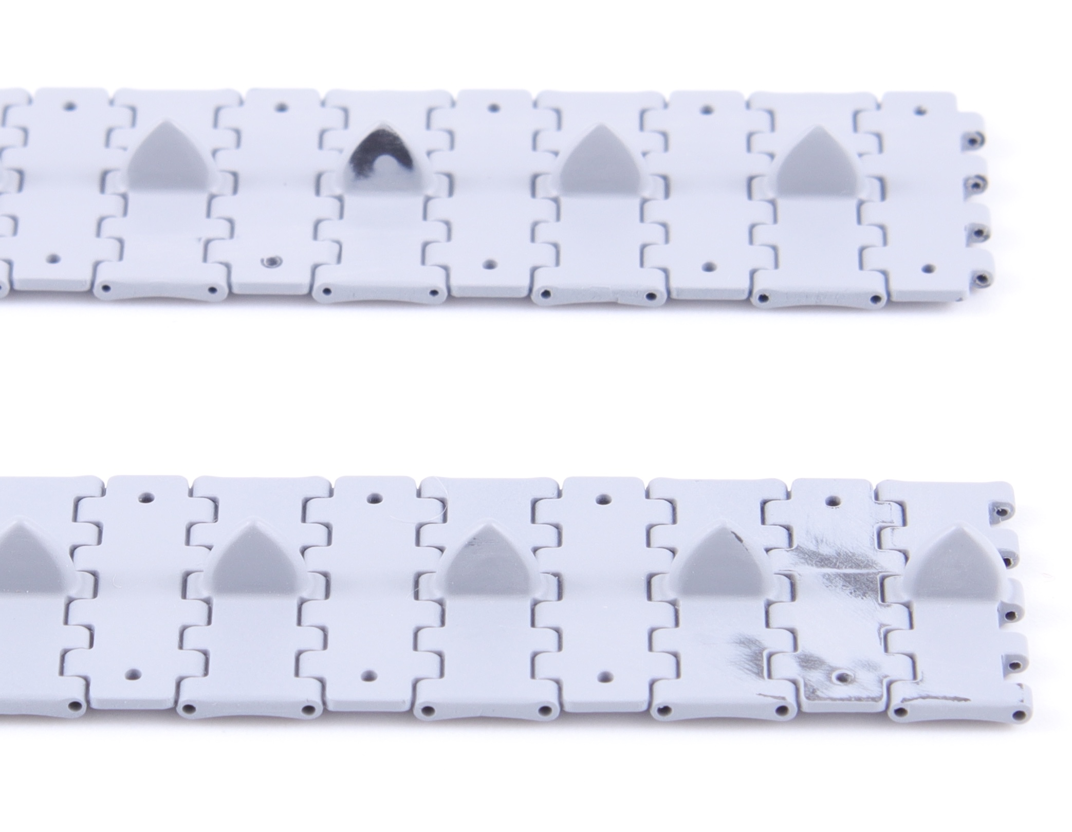

For example, on some tracks, sink marks are still visible.
On other parts of the model, there are casting defects and processing defects, some places are poorly puttied.

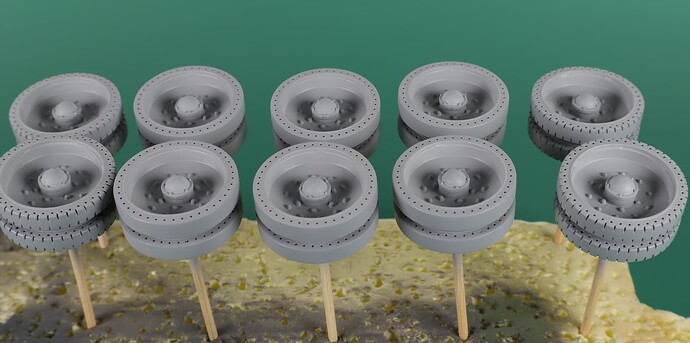

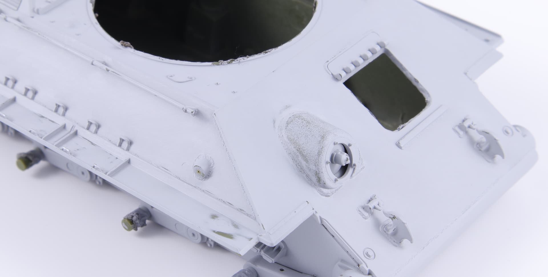

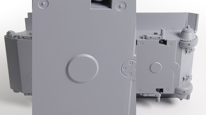

I applied primer to all the areas that had been corrected. This time, I used Mr. Hobby 1500 Gray primer, drained from an aerosol can. I further thinned the drained primer with Mr. Color thinner and drying retarder until it was very thin. Applied “thinly and wetly”. Some places were literally flooded. This mainly concerned the road wheels. Not everything was corrected with primer. There are still some areas that need some work. Overall, it’s more or less OK.
I’ve given myself a quick reminder when working with any primer:
  1. When working for very long periods with frequent breaks to change parts, it’s essential to clean the airbrush needle frequently. Even short breaks can cause the primer, especially thinly diluted primer, to dry quickly at the tip of the needle, significantly degrading the spray quality and potentially creating a “sandy” (grainy) surface.
  2. And don’t blow out every last drop of airbrush fluid from the airbrush cup, to avoid blowing small debris and undissolved particles remaining at the bottom of the cup onto the model.:melting_face:
I also took a few photos on a green mat. I don’t know what’s better - a white background or a green one. But as I continue to learn photography, I understand more and more that it’s not just about the background, and not so much about the background, but about light and shadow, about the quality and quantity of light.
I also want to somehow structure all the work. Instead of writing down random thoughts, I want to clearly and structure everything in a clear, organized manner, like tables or diagrams. Don’t know.
“Sand”:
Failed to fill with primer:
Some of the road wheels still need some work. It’s not visible in the photo, but there are still some defects:

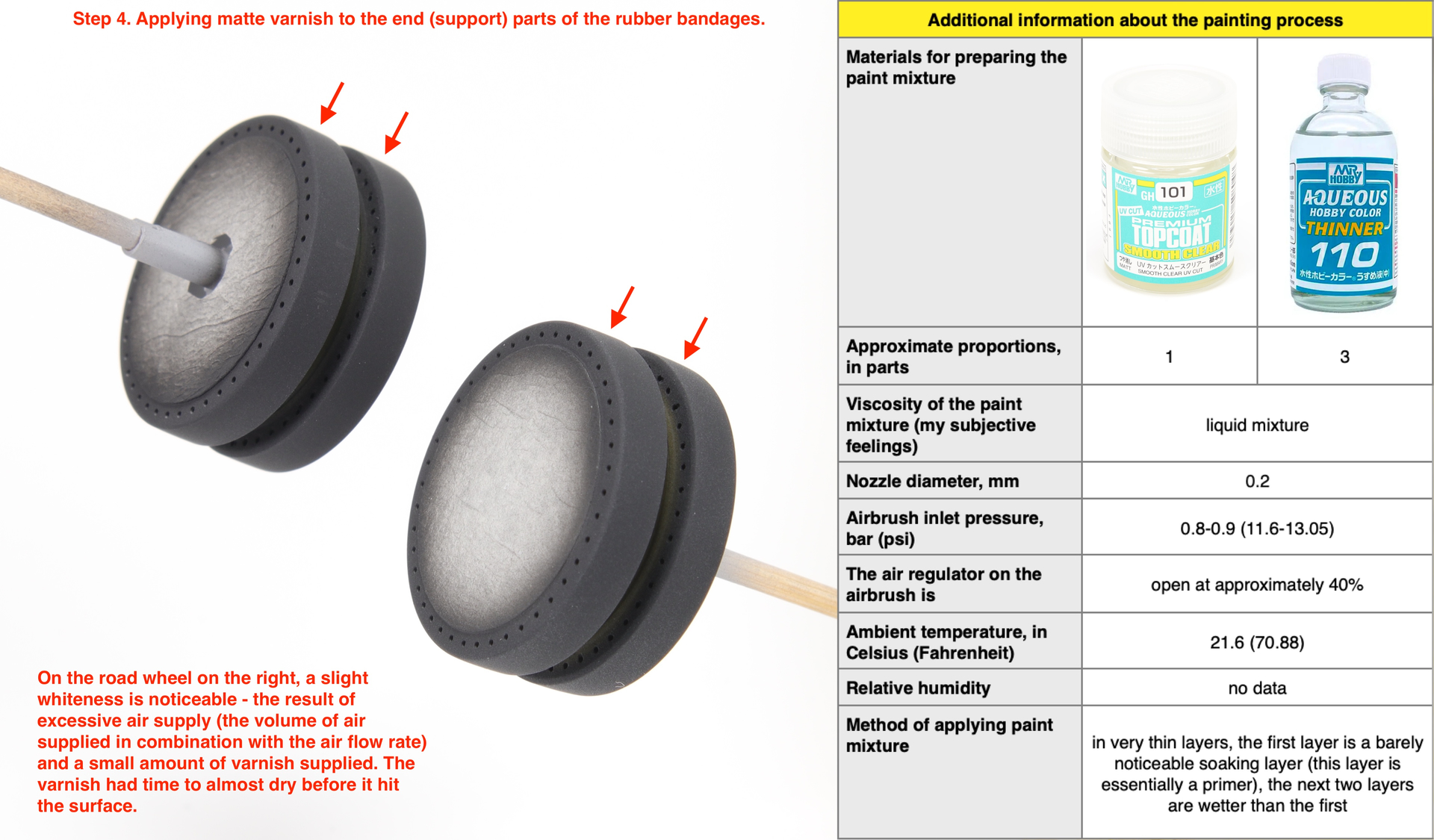

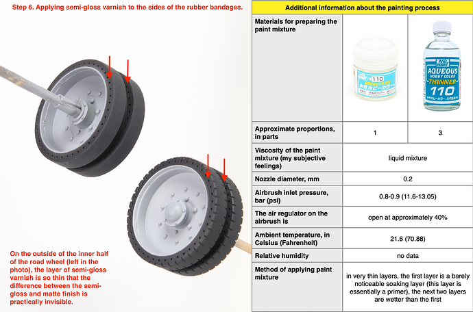

Started working with road wheels.
A small update.
Continuing work on road wheels.
A small update.
A small update.
I’ll add a small note. I won’t be using cheap masking tape for such an important job again. The fibrous structure of this tape prevents the edges of the mask from sticking tightly to the surface. The edges of the mask were peeling off slightly and paint was getting under the mask. This could only be seen after removing the mask.
In the process of re-gluing damaged masks, I used masking sticker sheets from Tamiya.
