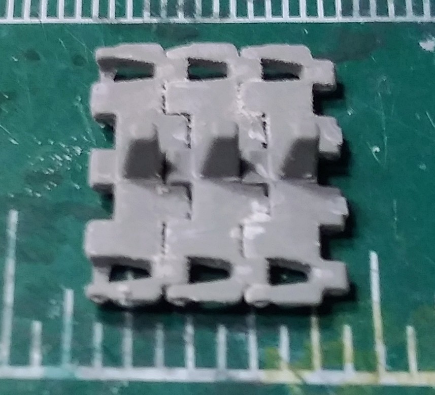

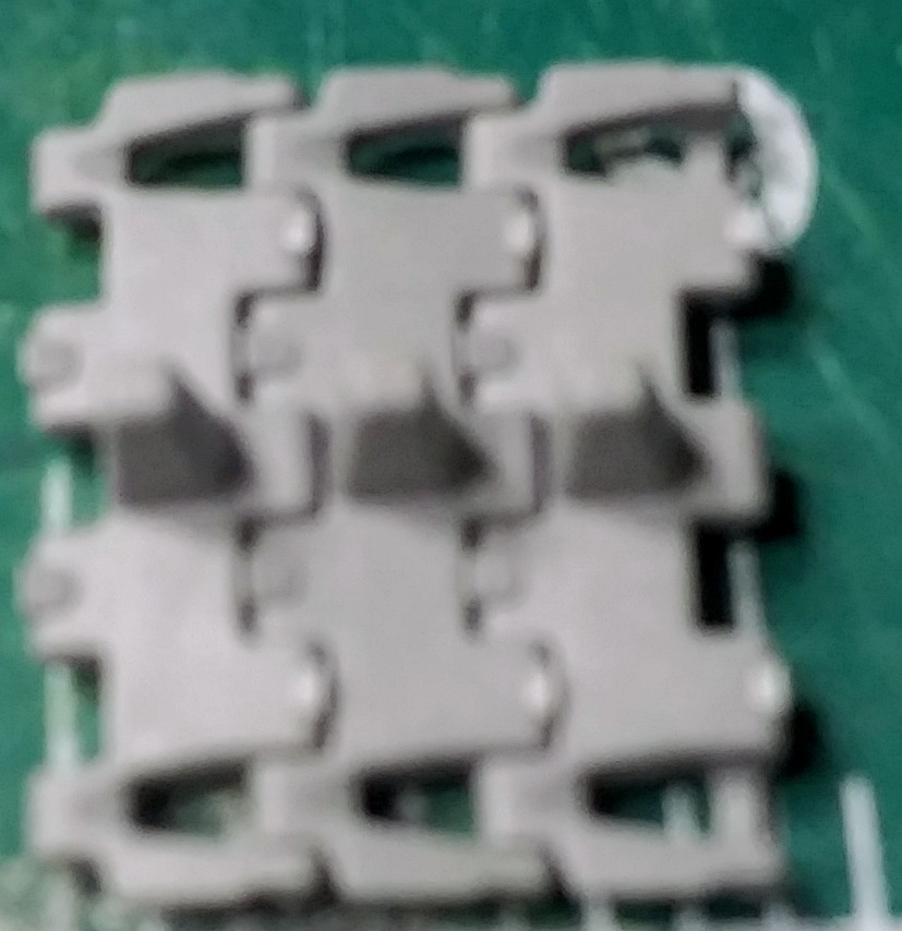

Hi @Jrobinsonusaf, I have the set of non-workable below and checked on the Tamiya T-55 Enigma kit. Sorry for the picture quality.
The fit is good in my opinion. I would use based on fit.
The parts clean up is excessive in my opinion as well. Four attachment points each link. Clean up required top & bottom if cut away from tree perfectly flush. The six nasty nubs on top show even in this poor picture.
Rough clean up for fit test.

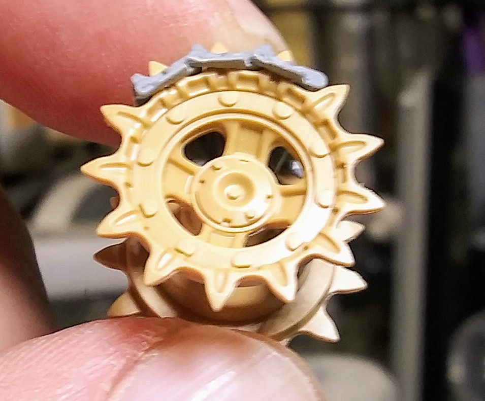

They fit and mold quality is outstanding so that’s a nice plus. My opinion, they fit very well but will be un-fun and time intense to clean up and use.

Happy to share any info I have. I did realize I maybe should have cleaned up eight links to see how they all wrap around the sprocket vs just three.
