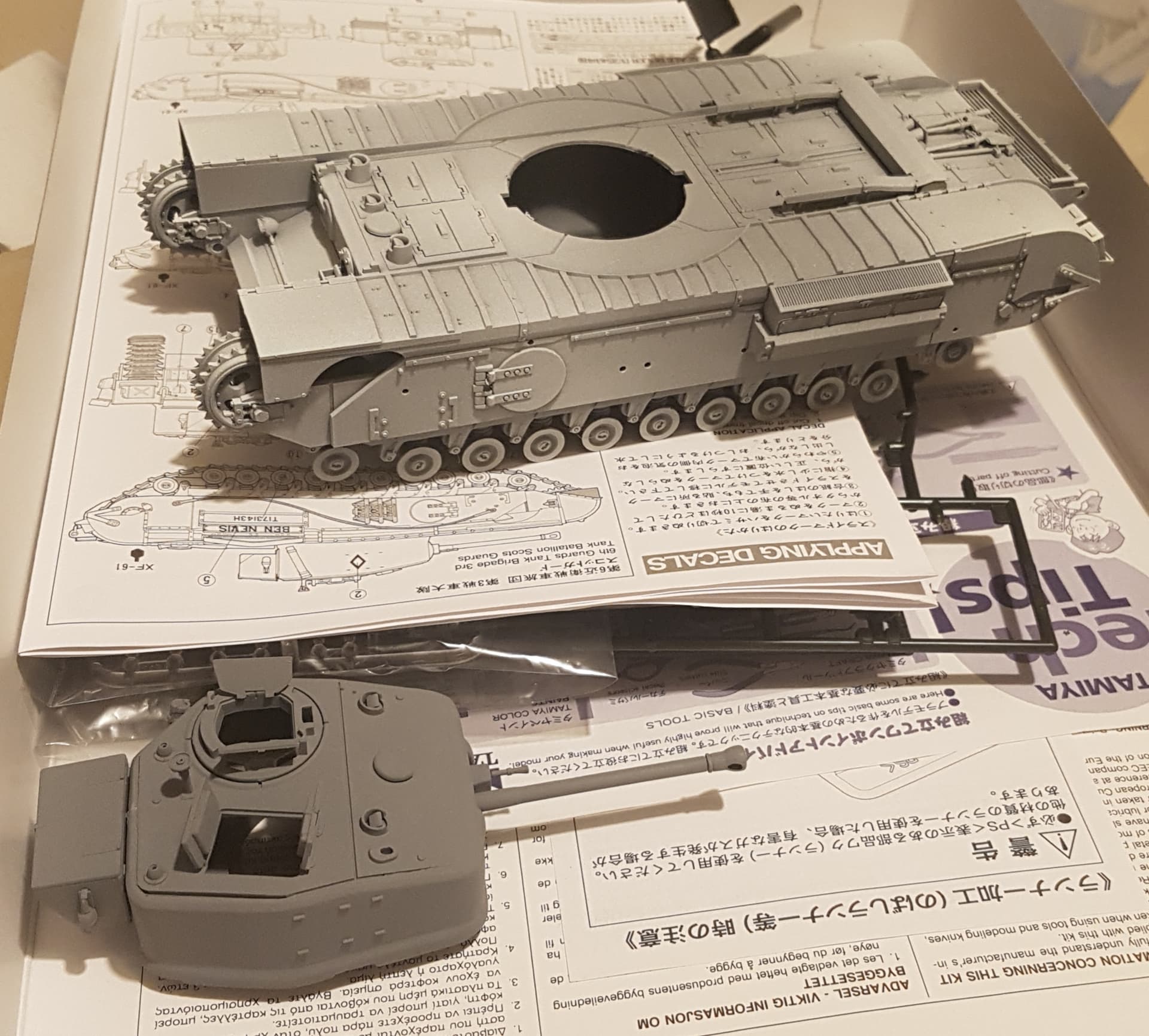

35167 is the one that I have. Looks good on the sprues. I think it might need wading trunks if you’re building it shortly after hitting the beach. I did start looking into that, but it was a good few years ago now and can’t remember what I found.

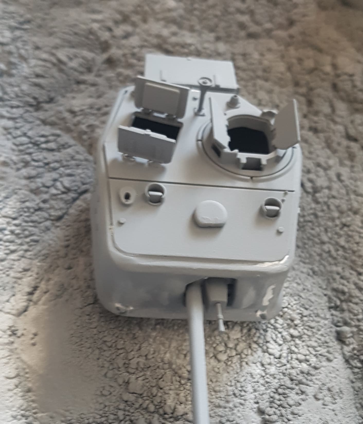

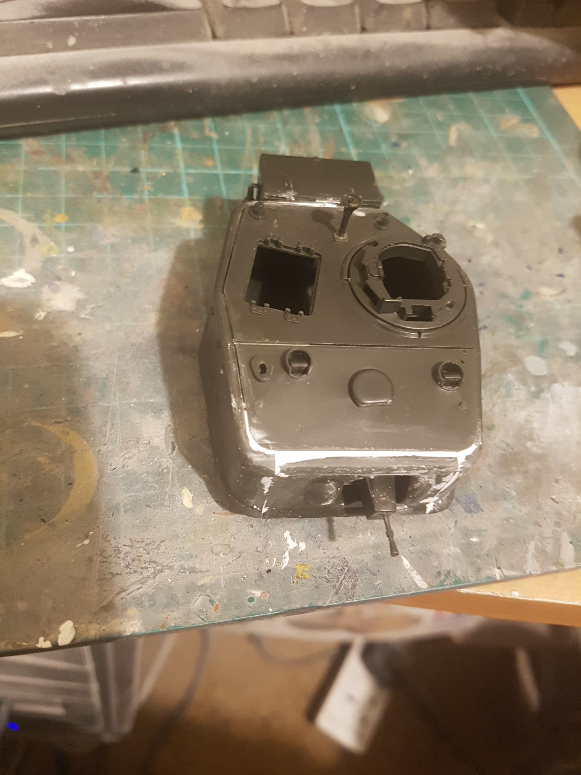

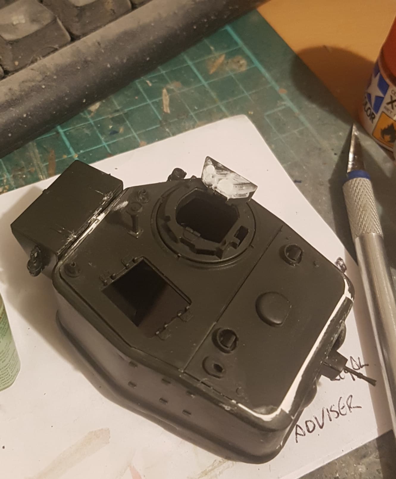

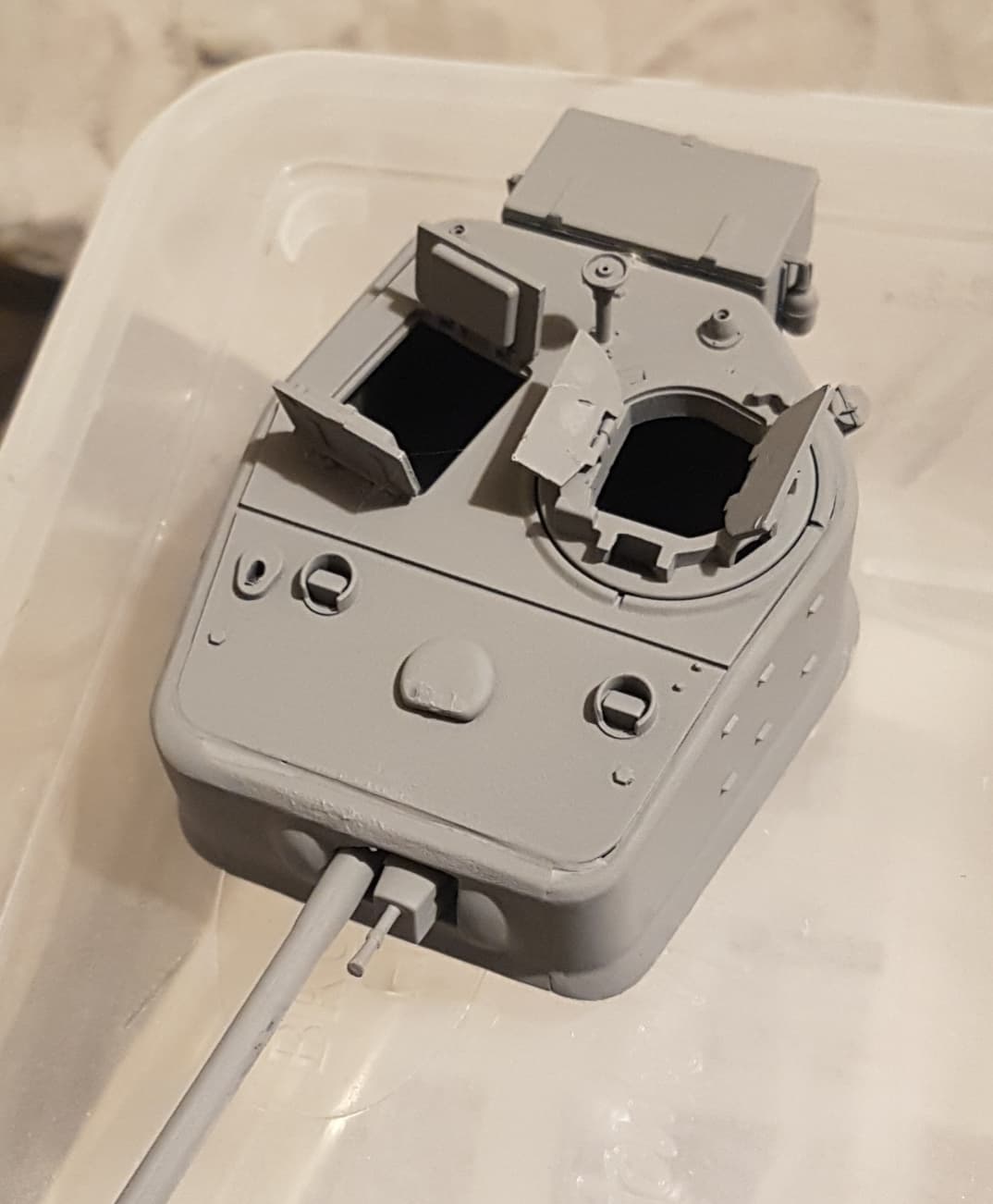

ok, so I’m trying to salvage the original turret and thanks to YouTube it appears to be the only issue the kit has. turret is poorly designed and could have been pruduced in a similar way to a sherman, instead their are to halves and a top section and a separate gun mantle and requires a fair amount of filler.
just a quick update, i started to add the turret hatches in the open position and ive just discovered after glue tve first one in pkace that they all have injector pin marks on them, so i have to fill them and sand them so this is another set back because of the turret.

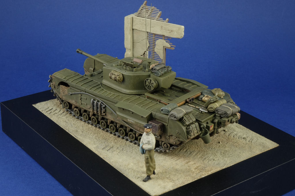

The last images are one of mine, based on Tamiya’s 1/48 scale Crocodile kit

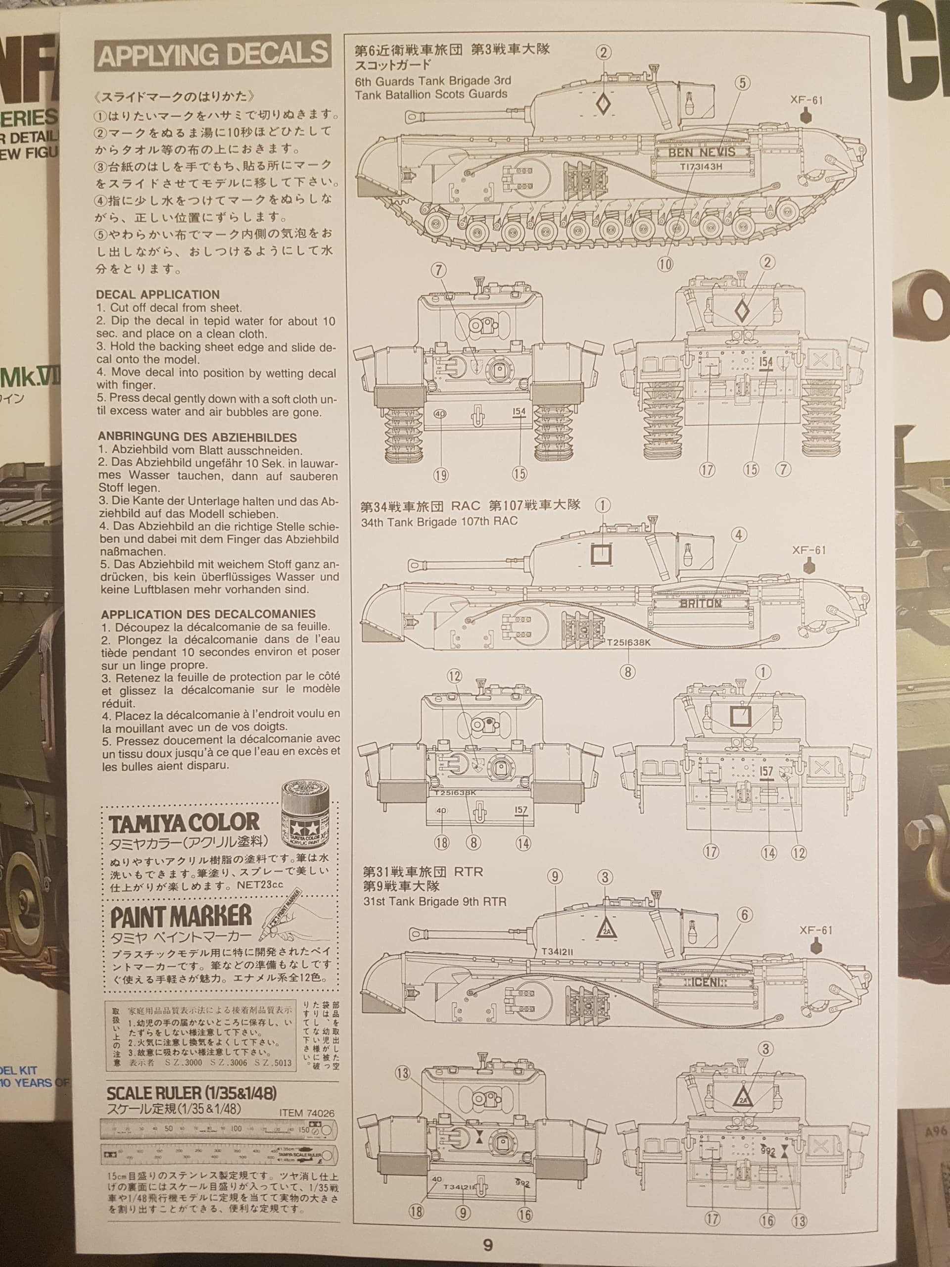

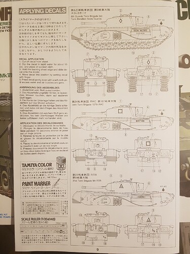

these are the marking options in the instructions of this kit, i would be grateful for your input.
Sorry - this became a more rambling answer than I intended :slight_smile:
Any of these decal options might be appropriate for Normandy but it’s probably too early in the campaign for that to be likely. The bulk of the Churchills used in Normandy were reworked and/or upgunned earlier versions and Mk VIIs didn’t really start to become common until later in 1944 and 1945.
Guards Tank Brigade (not to be confused with the Guards Armoured Division) was active in NWE from 18th July 1944
31st Tank Brigade from 19th July
34th Tank Brigade was a bit earlier from 3rd July.
Ignoring 79th Armoured Division and their specialised Churchills, the only units operating Churchills in NWE were the three Independent Tank Brigades listed above.These were not assigned to a specific armoured division. Instead, each independent brigade typically supported a specific Infantry division. They were not part of the division but were placed ‘under command’. However, it also meant they could be transferred elsewhere as and when necessary.

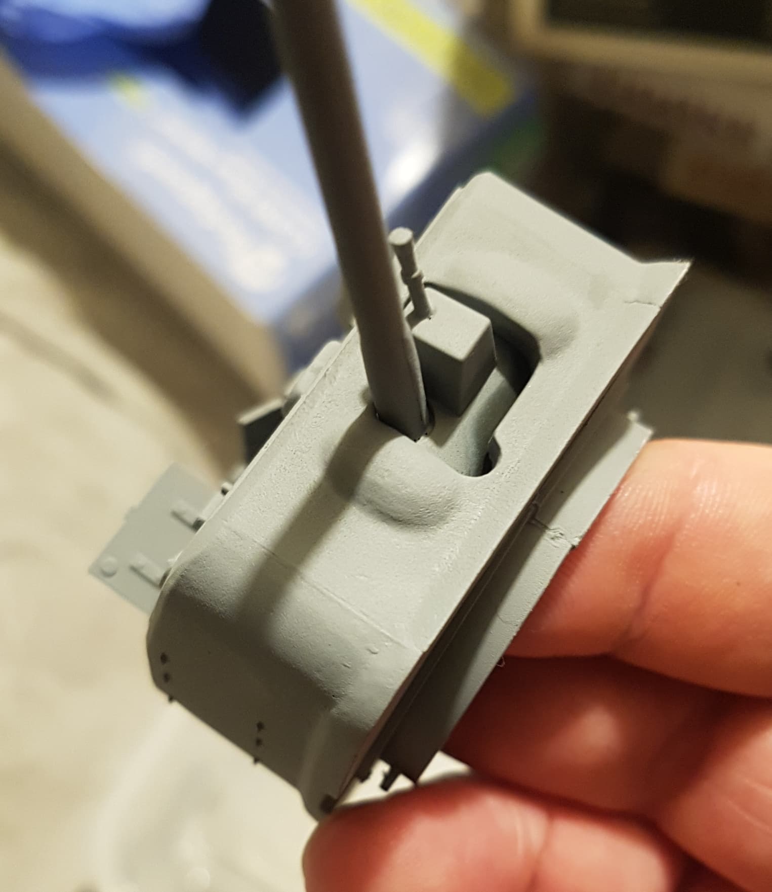

the turret does have issues and it feels like it was out sourced to some company like Panda due to its poor design and fit compared to the rest of the kit.
even after filling, sanding an primer coat being applied you can still see the join liness but i was warned about this in a YouTube video and it advised covering them with Mr Surfacer and stippling the surface to give a cast turret effect
day 57 of filling and sanding, ok possibly a slight exaggeration but it sure feels like it!
this time i think it’s as good as it’s going to get, time for another coat of primer paint.
You’re building a kit that was first released some 50 years ago and has been re-issued regularly since then. It’s still a good kit by modern standards but it does have a couple of assembly quirks that you’d probably not see on a more recent kit.
yes it’s easy to forget how old some of Tamiya’s kit are, they haven’t really released much in the way of new items. they seem to like repopping older kits with some bits and bobs in them, figures and PE etc. I would certainly like to see a repop of their 1/35 Herman firefly but i think it was another company’s work just reboxed like Italeri’s M109.

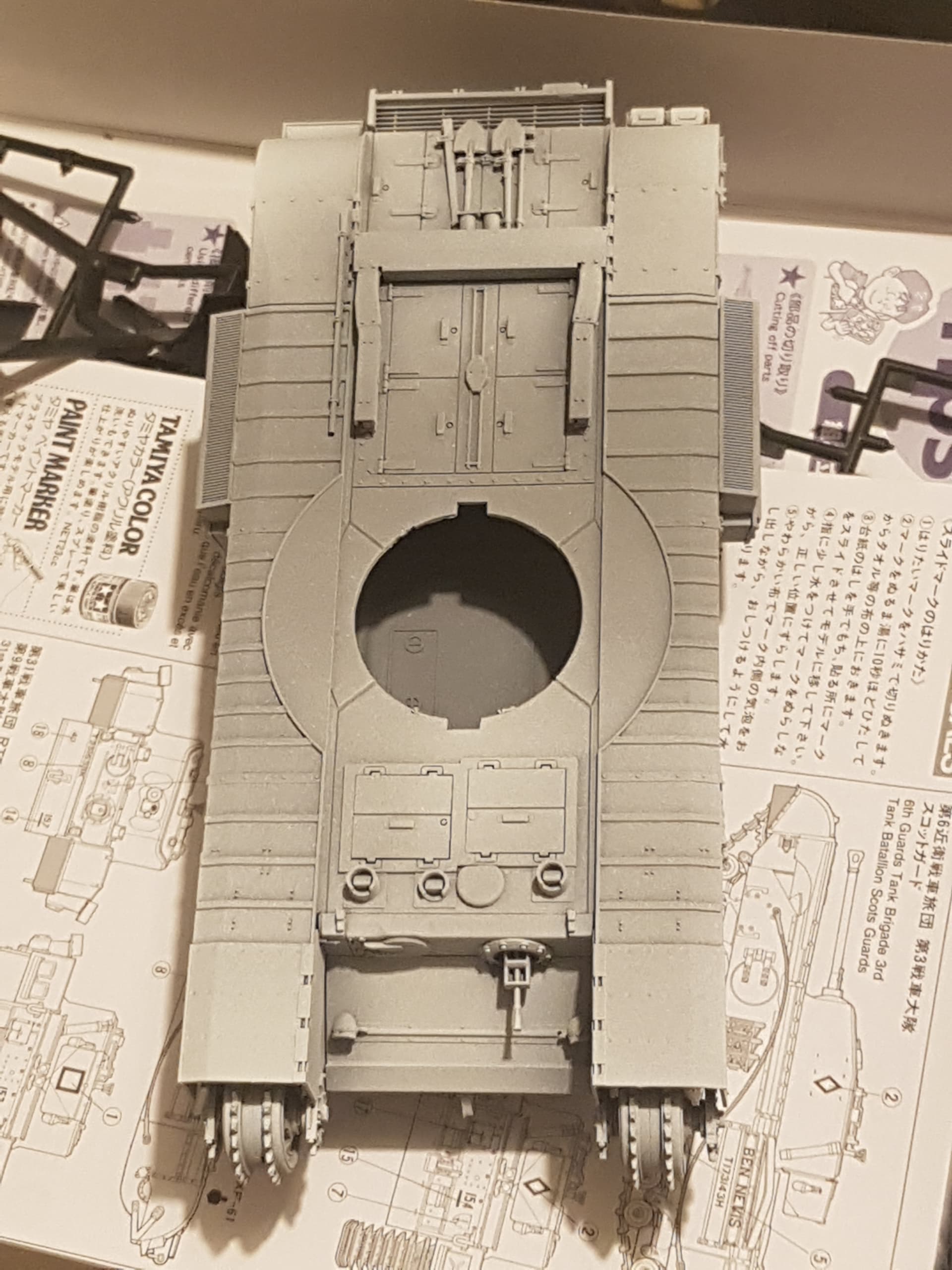

ive given the kit a blast of primer paint and did a spot of highlighting on the upper hull.
Looking good David. It’s built up nicely :grin:
