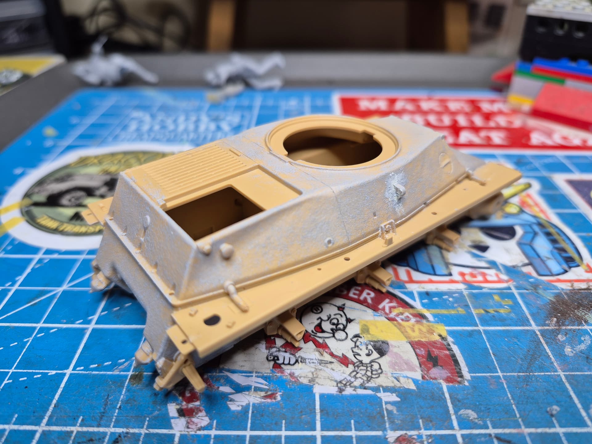

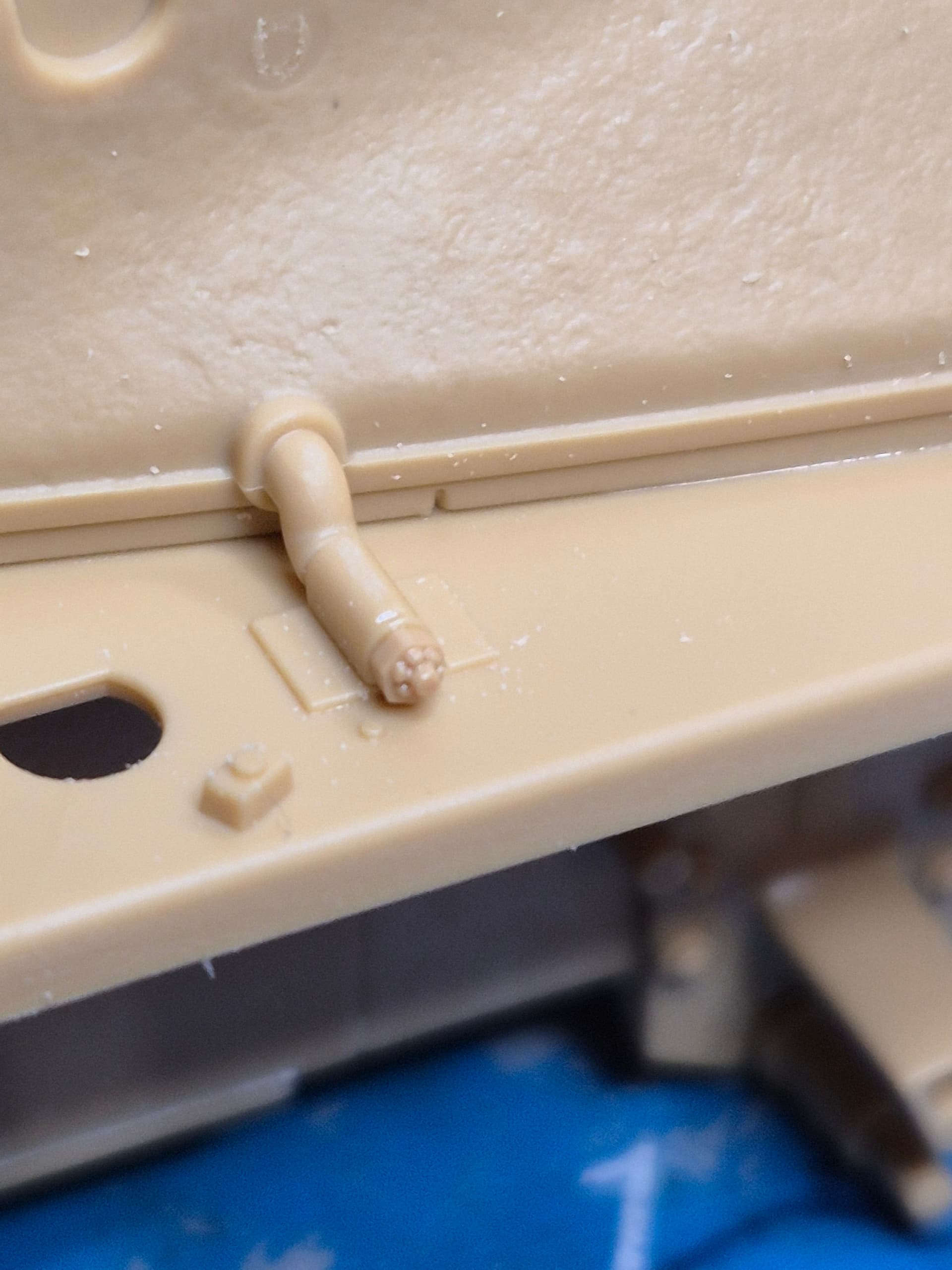

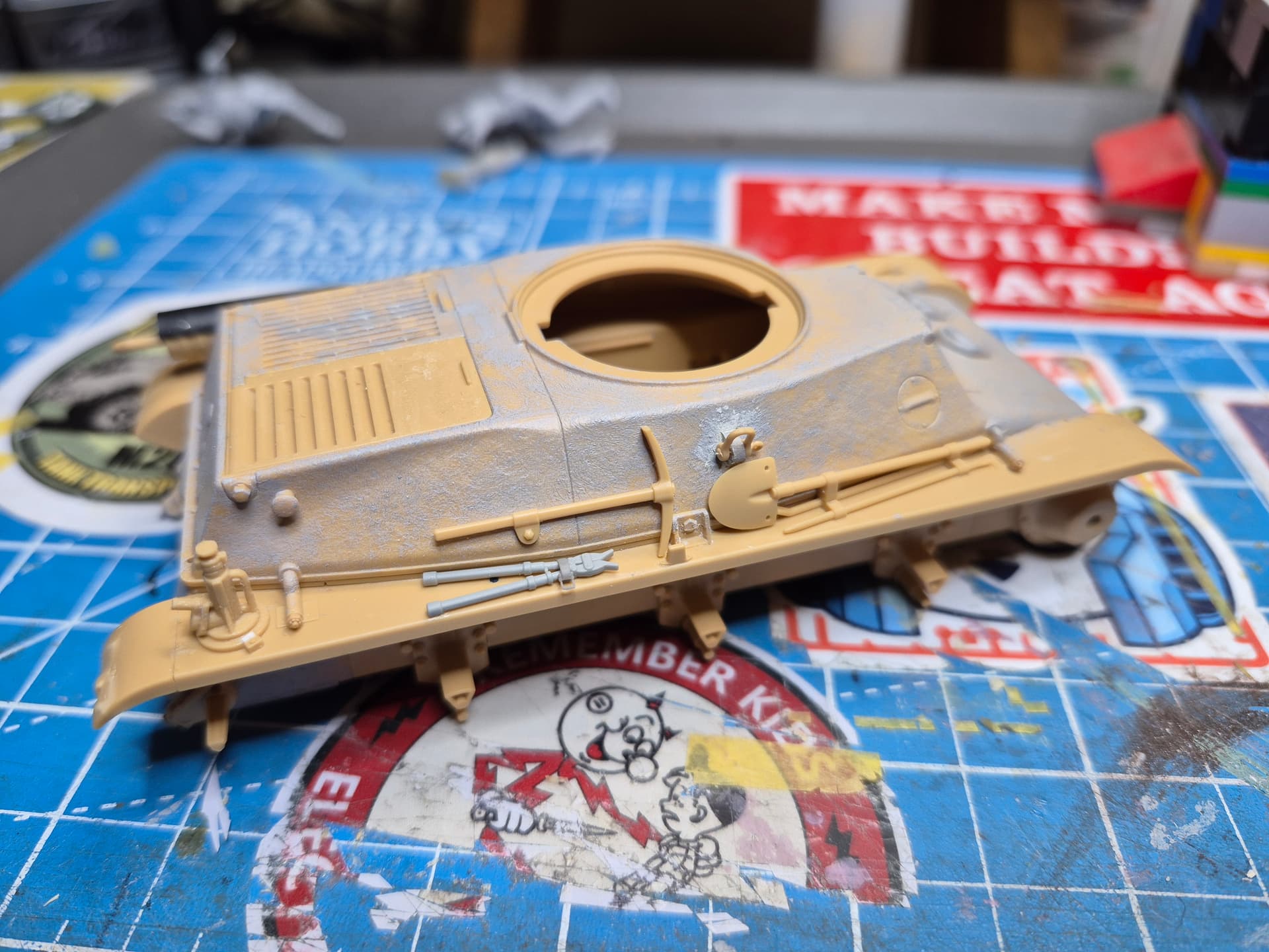

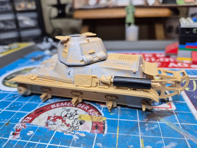

Just noticed that many knock out pin marks on the hull sides. Thankfully, they are not too deep.

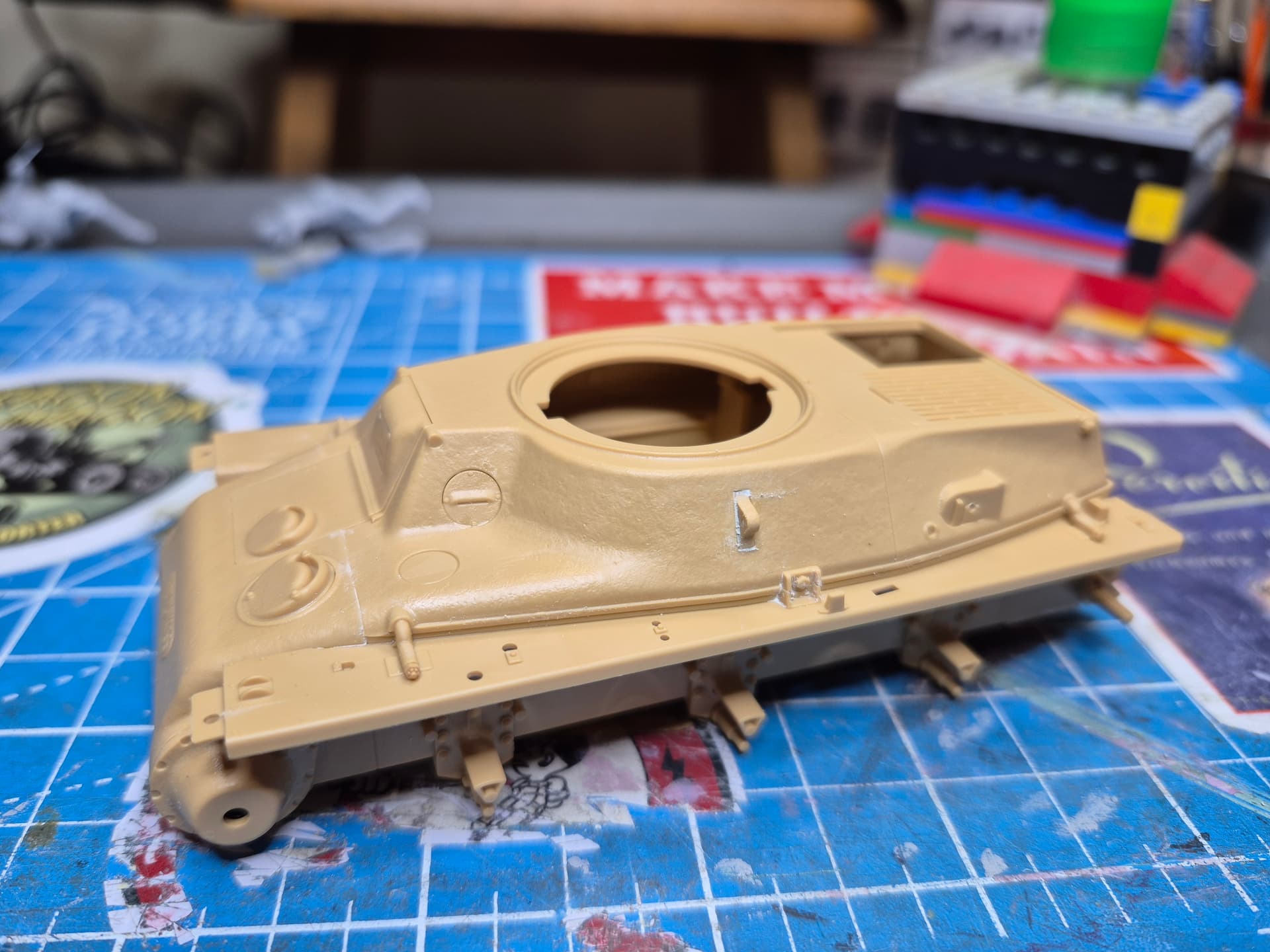

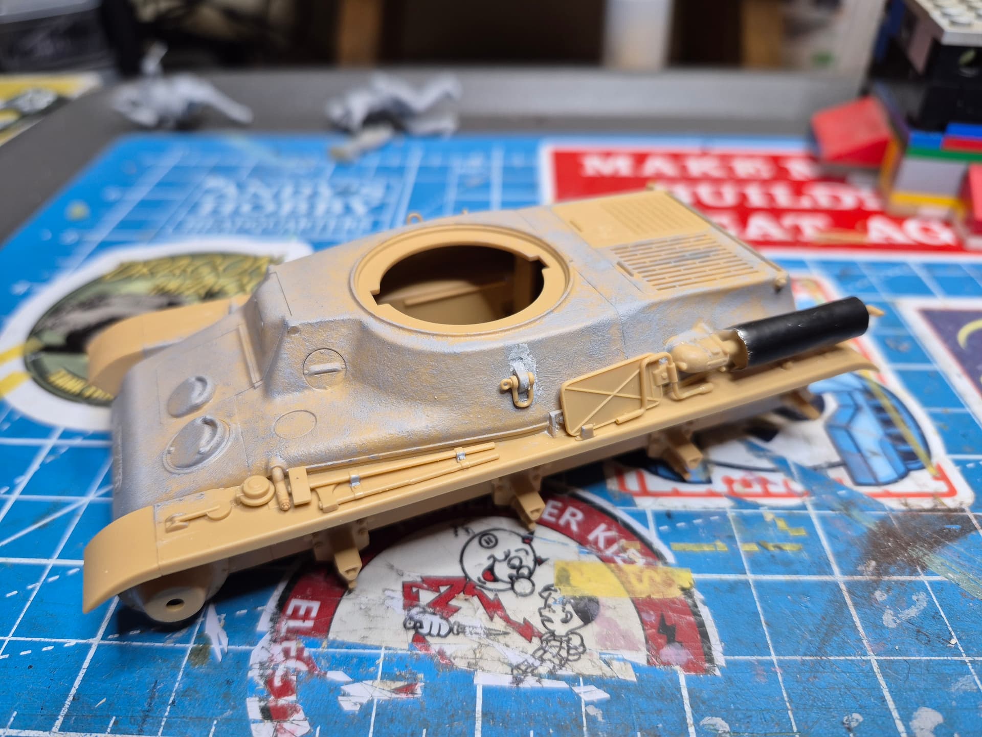

Top is on and I replaced the fender support bolts with castellated nuts that i found in the spare parts box.

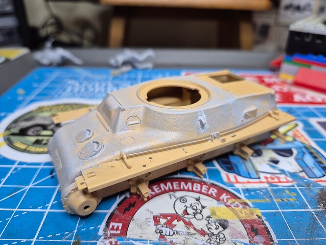

Some cast texture courtesy of Mr. Surfacer 500.

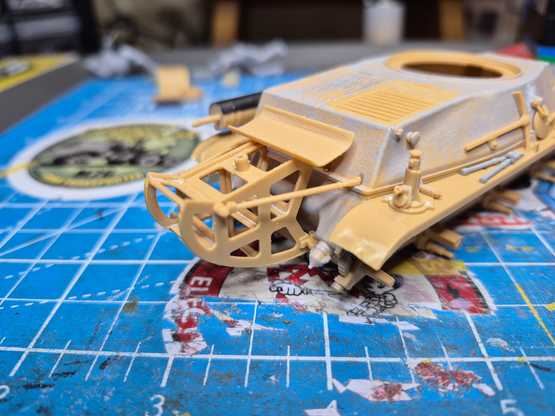

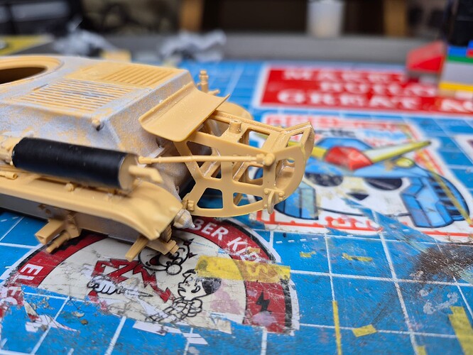

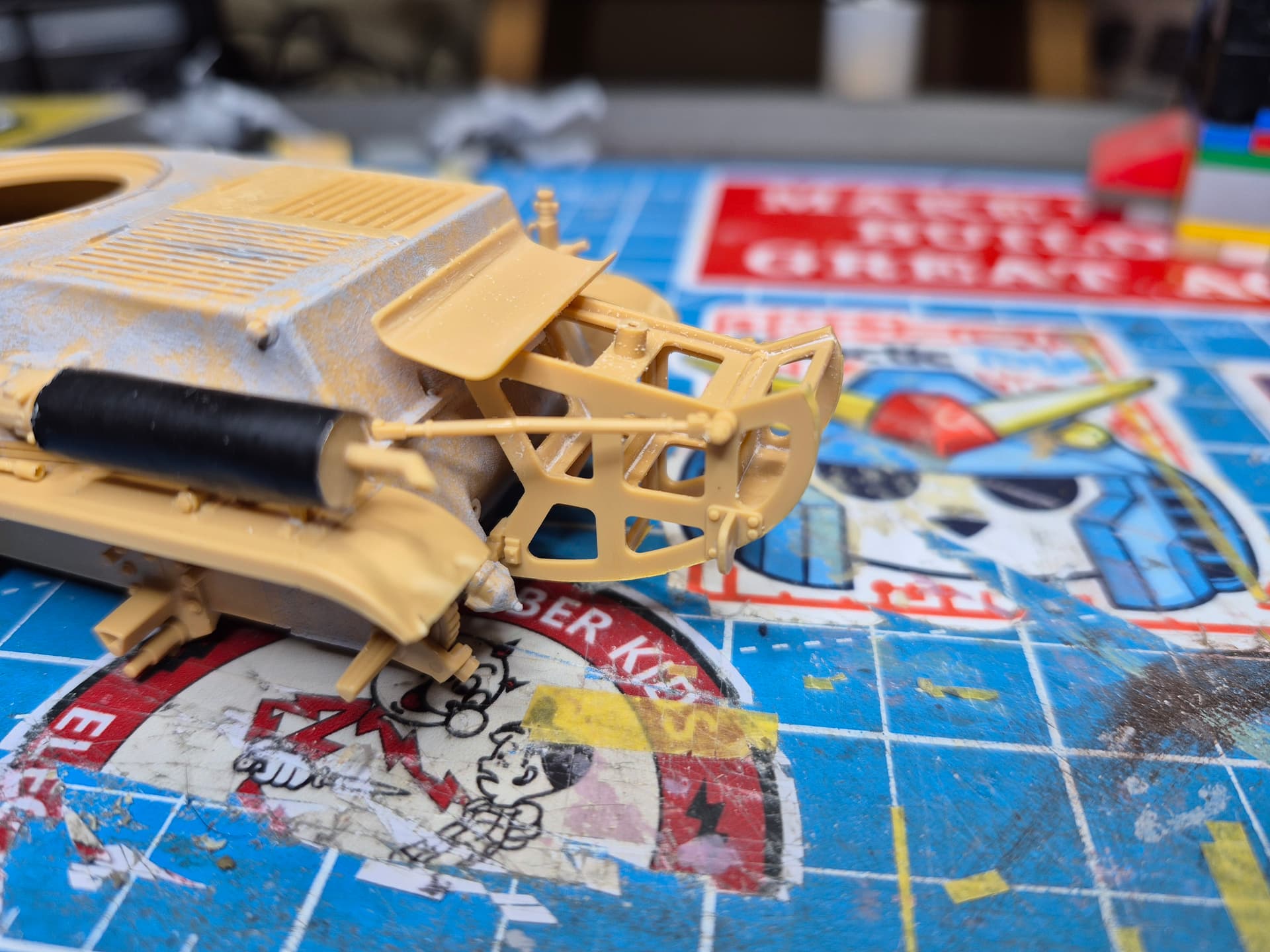

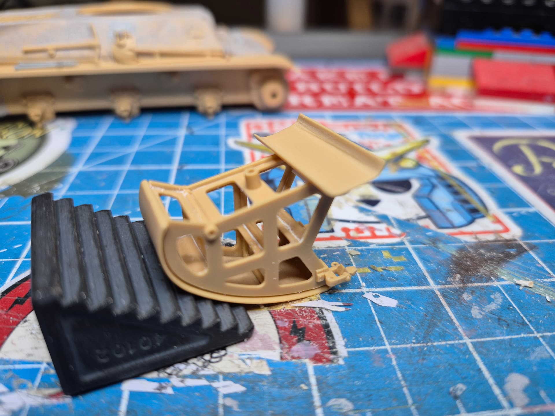

Tail skid done, bottom piece not glued on. Lots of knock out marks here and there.
Temporary mounted.

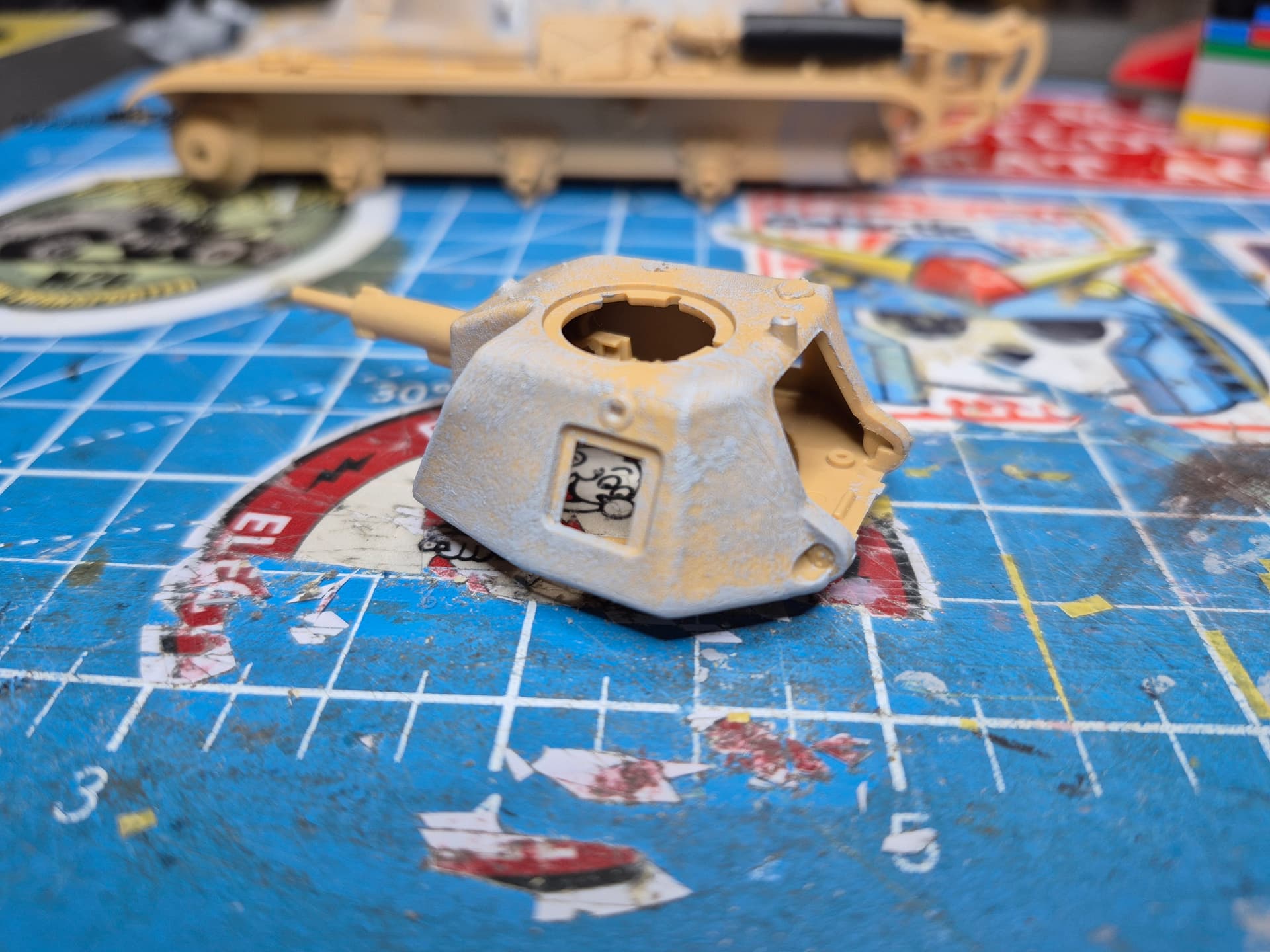

Started on the turret.

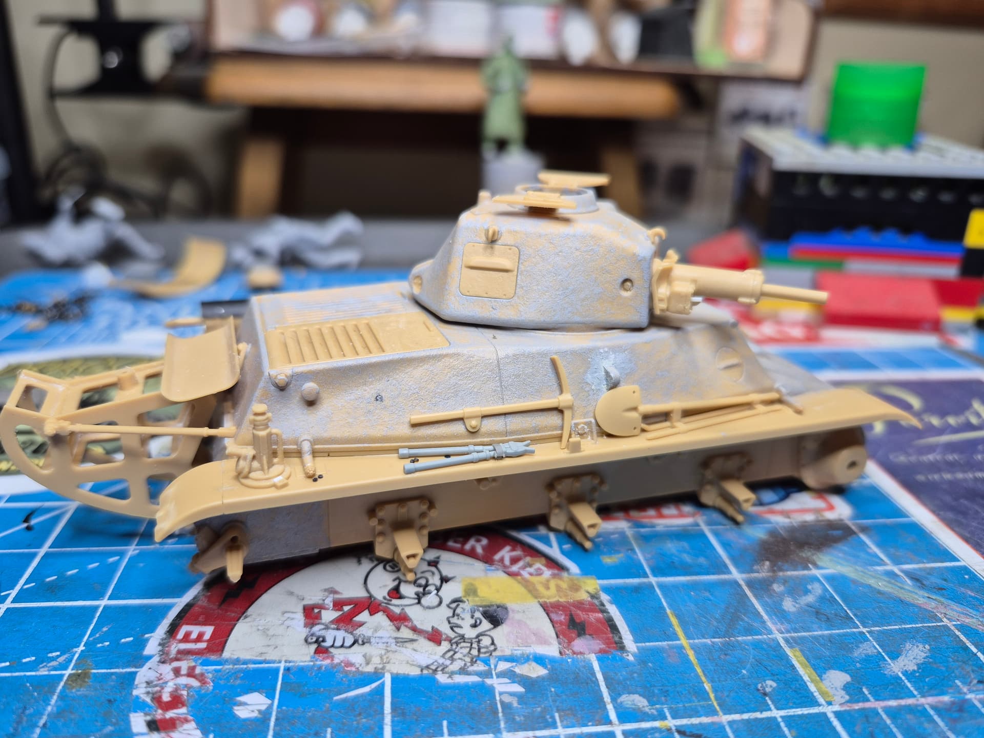

I think I’ve got her done.
Any particular reason for adding Mr Surfacer?
