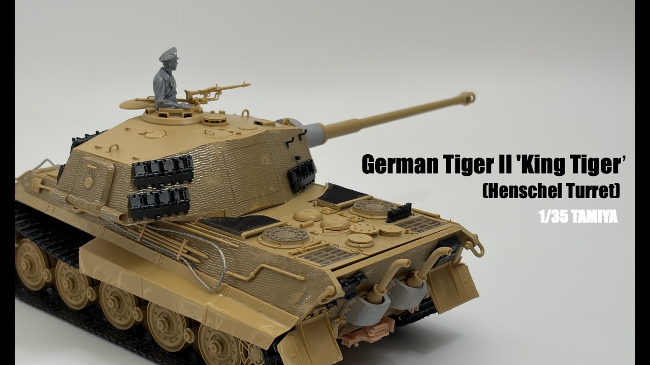

Hi everyone — I’ve been building 1/35 Tamiya armor and posting the full process on YouTube.
Latest build is the King Tiger (Tiger II) Henschel Turret with some detail upgrades — zimmerit coating sheet, 3D printed parts, Tamiya photoetch, stainless steel wire, and individual track links. Paint is next.
Would love any feedback from the community!

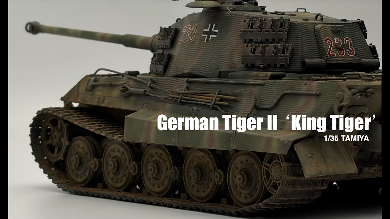

Part 2 is up — paint and weathering.
3-colour camouflage, decals, oil wash, chipping, pigment weathering on the roadwheels, and final shading.
