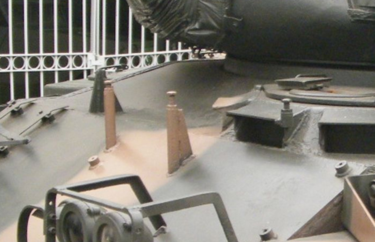

Something you might consider adding are the drivers hatch supports, right & forward of the drivers hole, where the hatch sits when it’s open. On the 2nd one - there are 3 - the support wing angles toward the 3rd support.

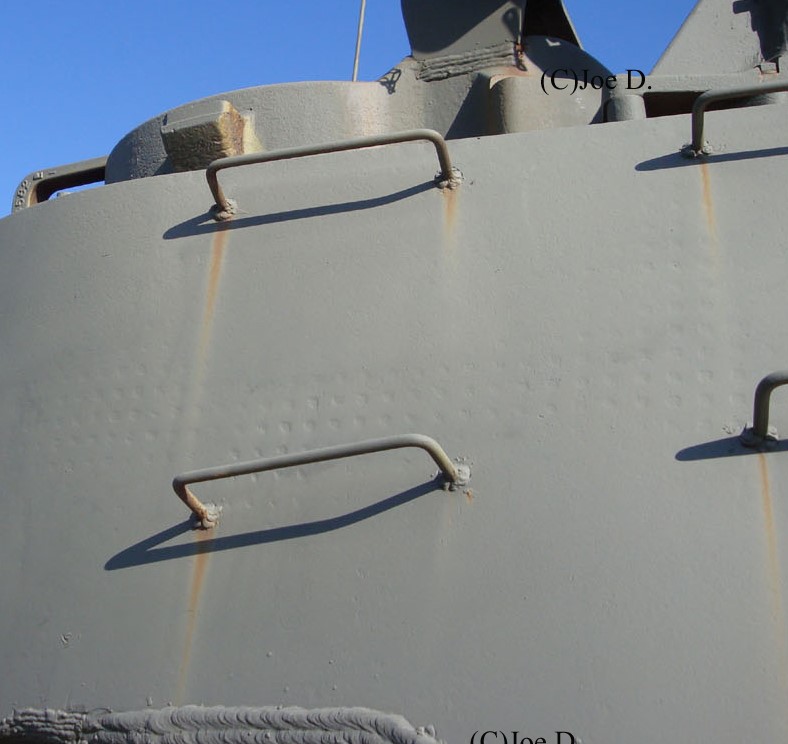

One thing about the M41, the turret side plates are made of rolled armour plate that has ‘dimples’ caused by the rolling process, they’re quite noticeable in close photos.
I figured out a way to do these - use a pounce wheel. - Pounce Wheel Set | 3‑Piece Craft Pounce Wheels | Micro-Mark

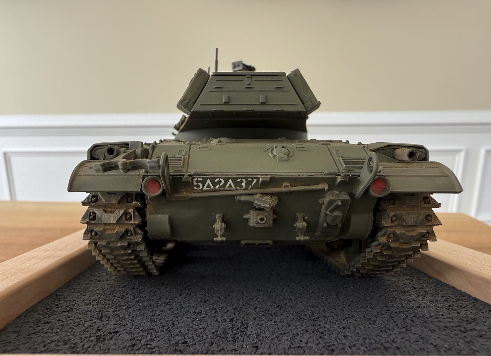

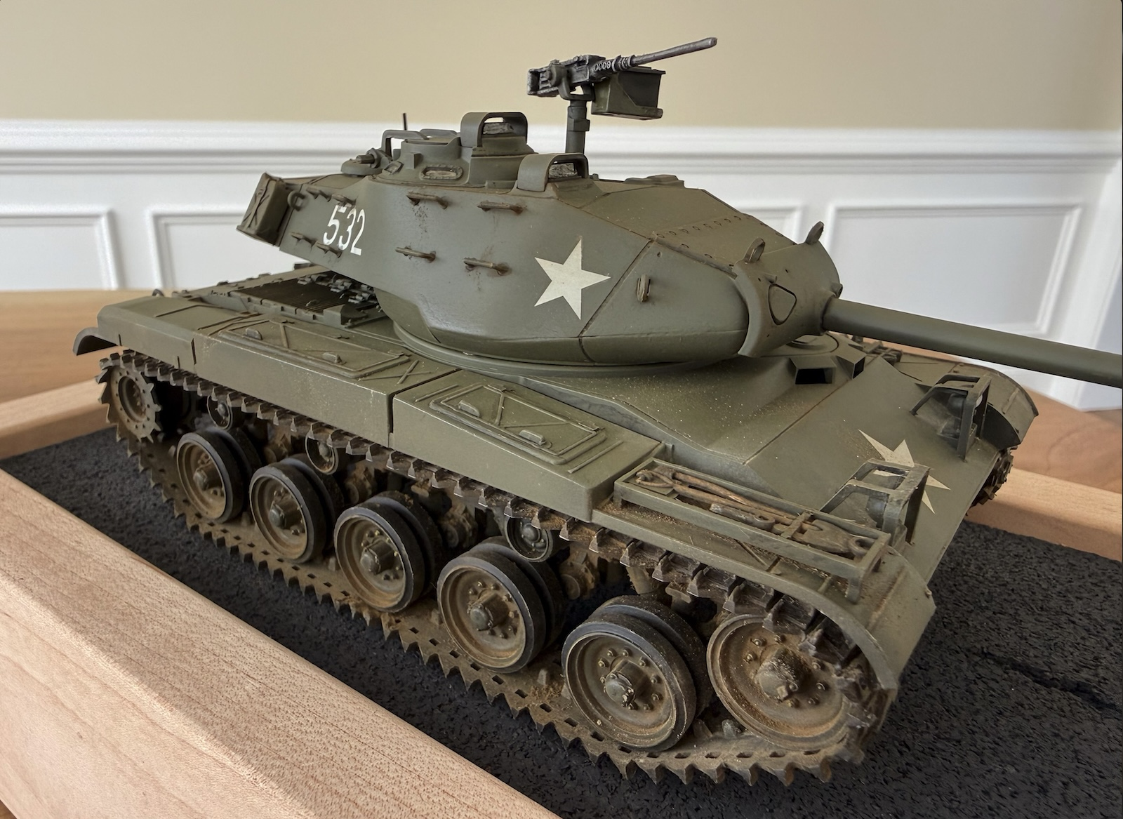

Attached are the photos of my finale result. There is a chance that I may still add and/ or change some of the dust pigments but I would say over all I am done. I am aware that my weathering and dust work isn’t the best. I think the tracks look good but the over all appearance of the tank needs some improvement but I am not sure if I am going to risk it before the event this upcoming weekend.
Please leave me some feedback with things I could do better! Thank you :slight_smile:

A fine job ! Looking forward to seeing it. The base really frames it nicely as well.
You’re off to a great start. For a first effort, that is damn good! Keep it up, don’t be afraid to ask questions, for advice, and for help when needed, and you’ll go far. :+1:t3:
feel free to say “hi” on Saturday! I love to meet new people and people within the hobby :slight_smile:
Looks good

You did a really nice job here, well done.
About the tracks; and this is fore your next model; this one looks just fine. Did you paint the tracks? Pigments need something to hold onto, especially the vinyl tracks that come with this kit.
You can touch up the pigments after the tracks are installed. Handling them, especially stretching them over the sprockets and wheels, can cause a lot of the pigments to call off.
