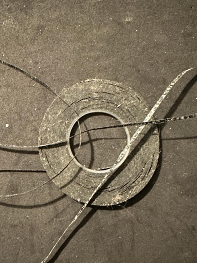

I would use none of the above simply because they do not look prototypical. The nets are actually made of flat nylon webbing. I have been using Chartpak graphic tape for things like this for decades.
Unless of course speed and ease are your goals - then by all means use what you like. It’s easy to use the graphic tape - it’s self adhesive, comes on many useful widths, will last you forever, and maintains a correct width, so no tedious cutting of masking tape.
That’s certainly closer in looks to webbing. Seems you could lay out the strips grid like and go from there. Wonder what one could use to eliminate the adhesive on the part you don’t want it to prevent a tangled mess once you get where you want to go. I spose the ammo crates would do it. Hmmm
Stick it on your forearms and remove several times - that’ll get a lot of the adhesive off.
I may just experiment with some masking tape placing the sticky sides together and cutting strips. I see that the cargo nets are indeed just squares with an attachment point in each corner. I only ever saw them already rigged and being lifted.

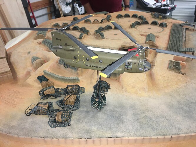

When building our FSB RIPCORD museum diorama, we cut 1/72 scale cargo nets from paper using a plotter-cutter (Silhouette or Cricut).
One of our club mates (Ralph Nardone) built a CH-47 hovering while delivering a sling load of 105mm howitzer ammo.
Here’s a picture of Ralph’s Chinook during one of the many test fittings of components and features. You can see that we cut a large number of the cargo nets to illustrate the logistics operations on the diorama.
We also used the same paper nets to depict logistics activities at the 155mm howitzer position where the sling loads were delivered directly onto a small area immediately adjacent to the guns.
We colored the paper nets by soaking them in Rit fabric dyes. To form the nets, they were later soaked in dilute white glue (actually Scenic Cement) and allowed to dry flat on waxed paper. Once dry, the flat nets could be formed around the various cargo items using a paint brush wetted with ordinary water. Once formed, they retained their shape and were glued to the cargo for later placement on the diorama.
