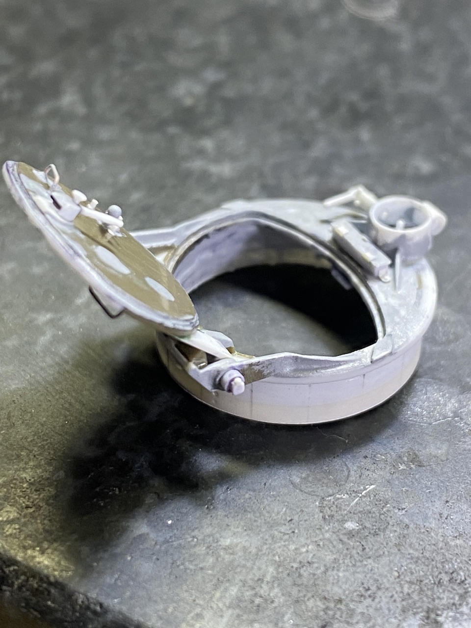

Used to add fillets/blend in the webs on the pintle and hatch hinge bases on this t-62 cupola

@Seanmcandrews that came out great.

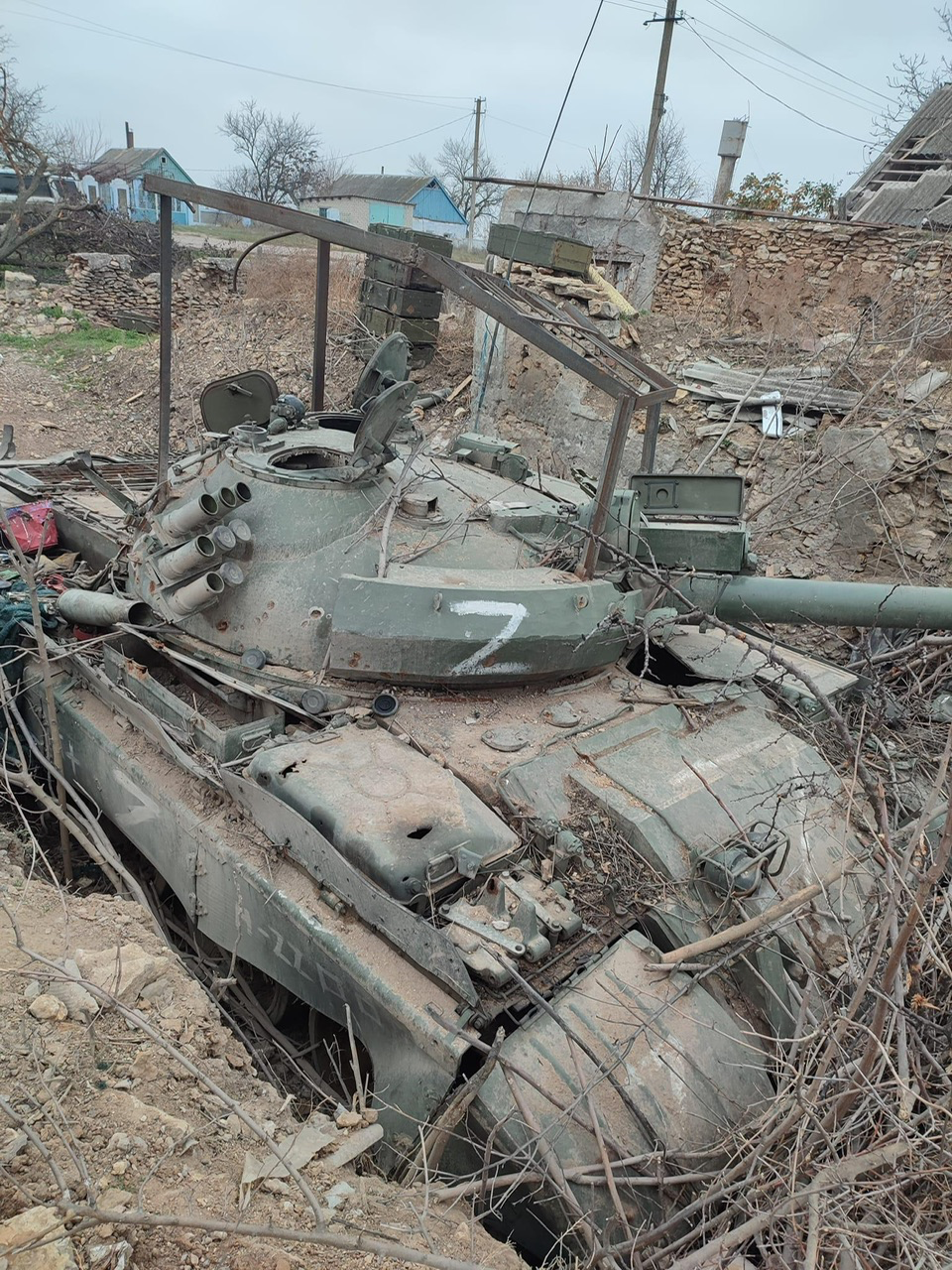

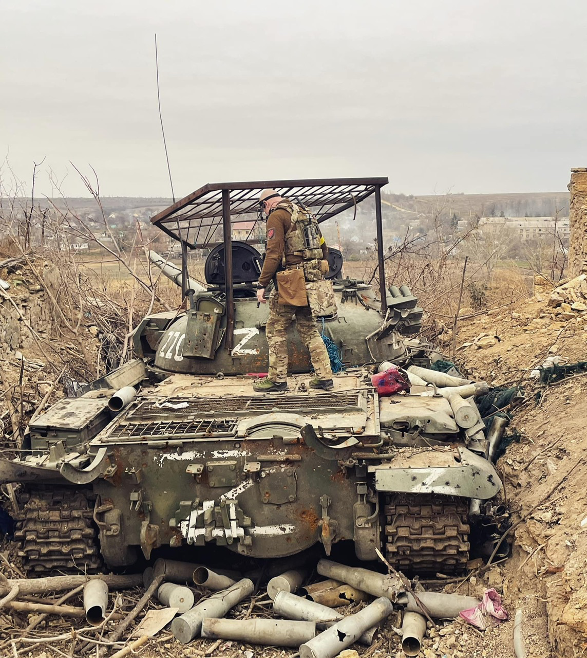

Thanks! I’ve been hugely inspired by him as well and my current T-62M project is an attempt at what I would say is his signature style with the vehicle really integrated with the scenic base, lots of dirt and debris in nooks and crannies.

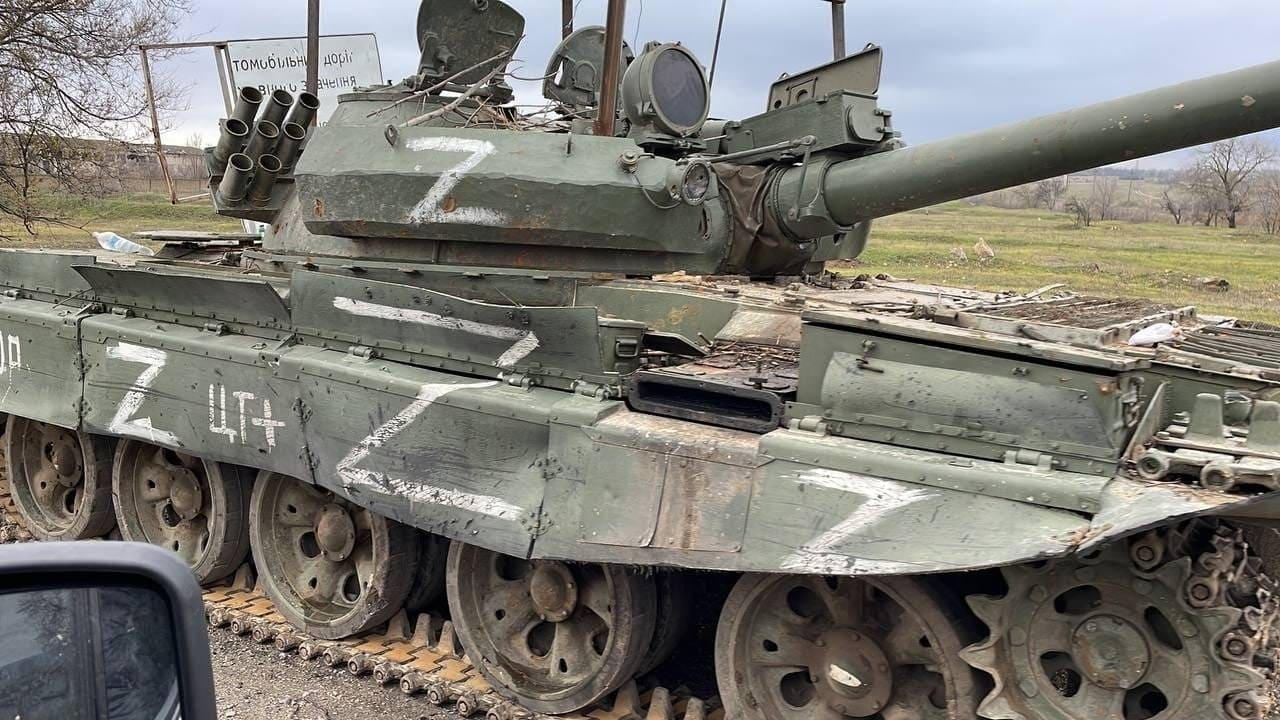

Cool, i just now found a new image of this same vehicle
