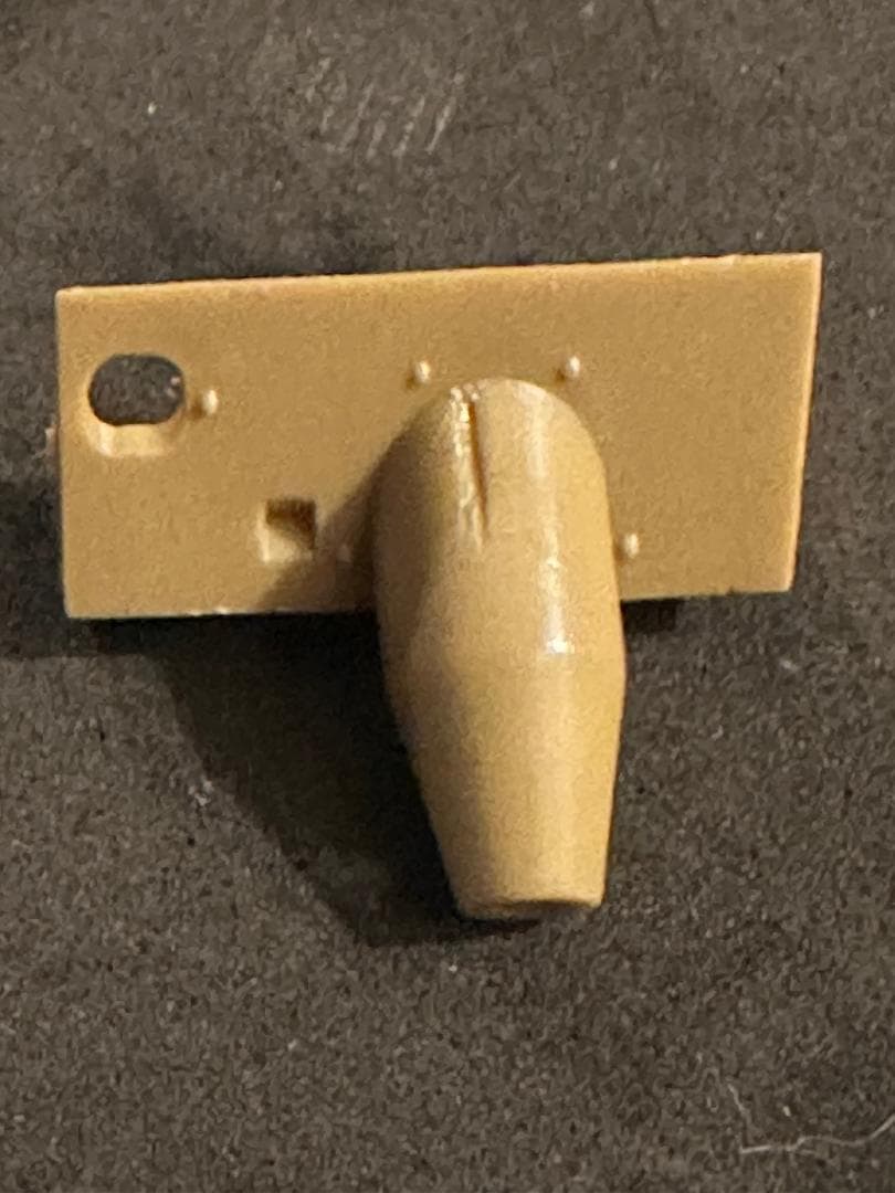

The shell ejection port isn’t difficult. You don’t even have to drill it first. In fact, I find it easier to drill it afterwards. Comparing the Tamiya/Academy piece to the above photo, they did get all of the bolt detail correct, and in scale no less, but often after painting the only way to see it will be by dry brushing them, There is a weld missing where the barrel shroud begins to taper. I usually use motor armature wire for that.

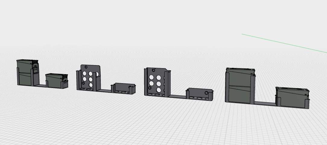

I designed the mentioned Ammo-storage for the back and side of the turret (with and without Ammo boxes).
I identified two different types for the side storage.
The prototypes fit well to the Academy/ Tamiya kit. I will soon be posting pictures of the Resin printed mount.

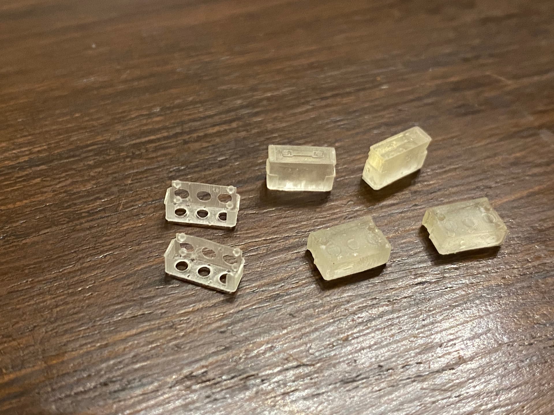

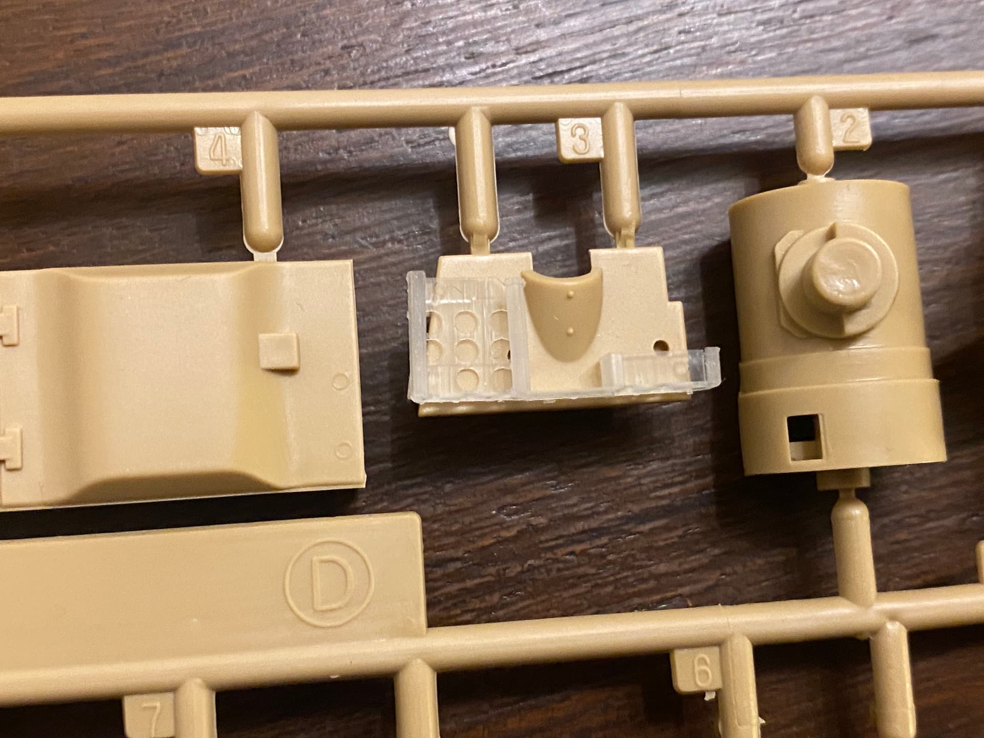

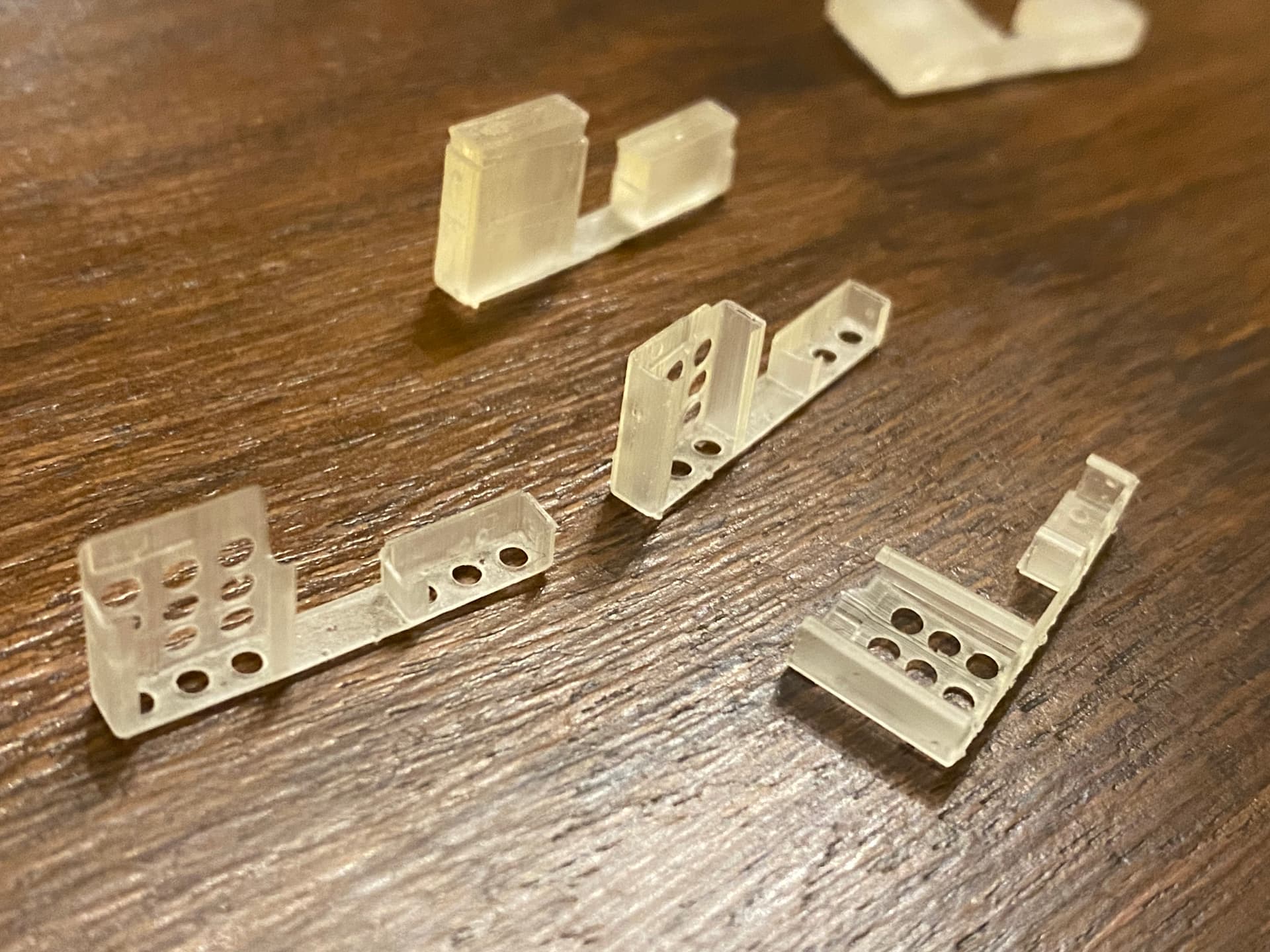

Hello,
as promised, here are my first prints. They are not completely cleaned up yet but the fit perfectly to the Tamiya/Academy sides.
I also printed empty and loaded storages for the turret’s back.
Best regards
Lukas

The ones with the cans are better than the Tamiya parts.
